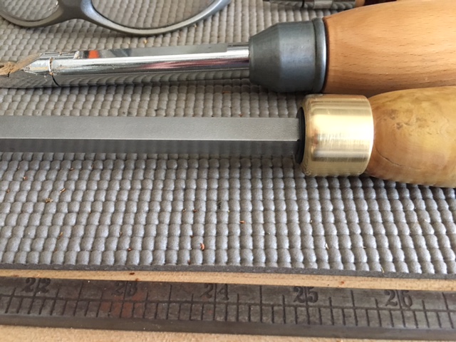

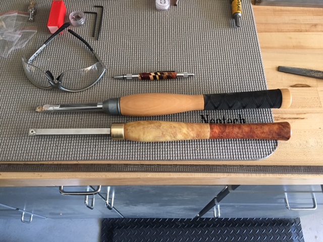

    I set out to make a Carbide Wood Lathe Tool better than the one I purchased. Photo contains the purchased item on top and home made tool on bottom.

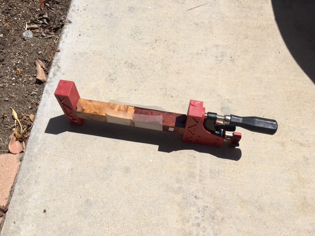

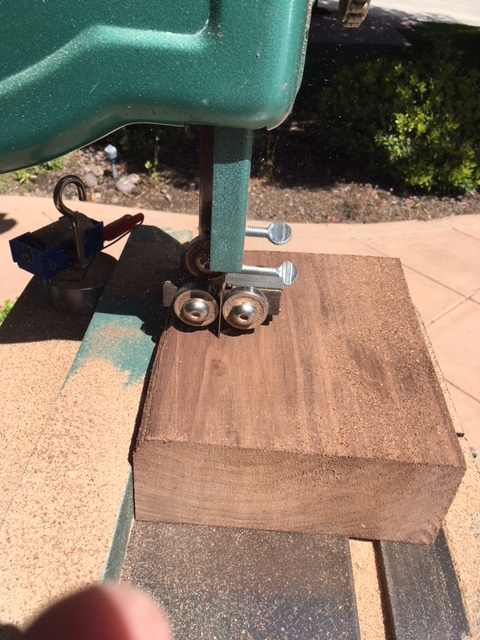

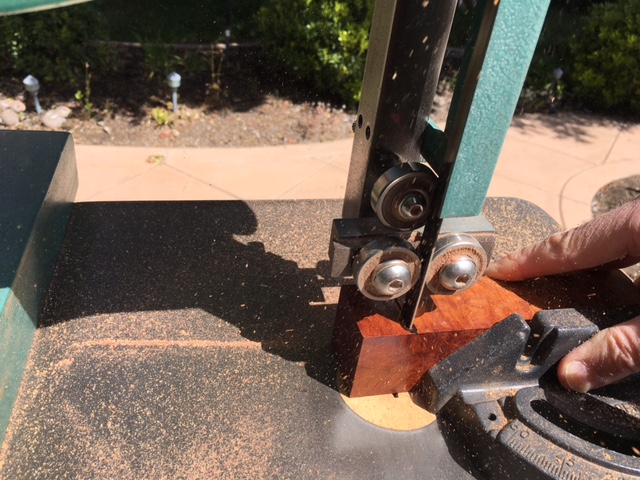

    Cutting and Gluing Wood

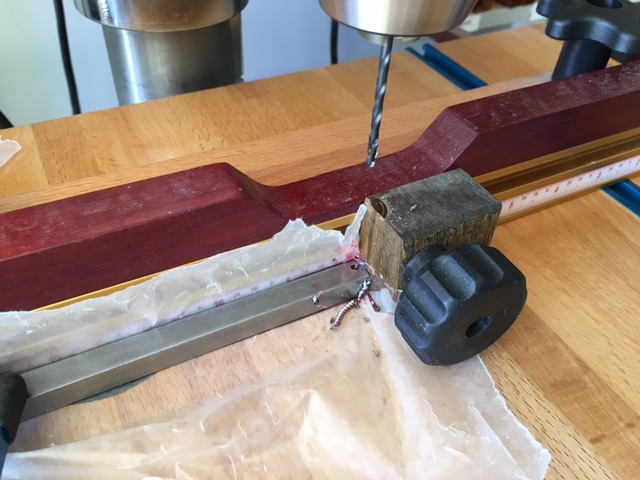

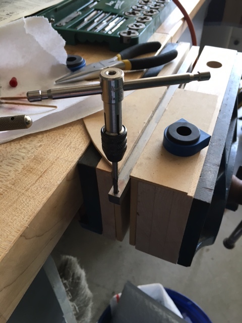

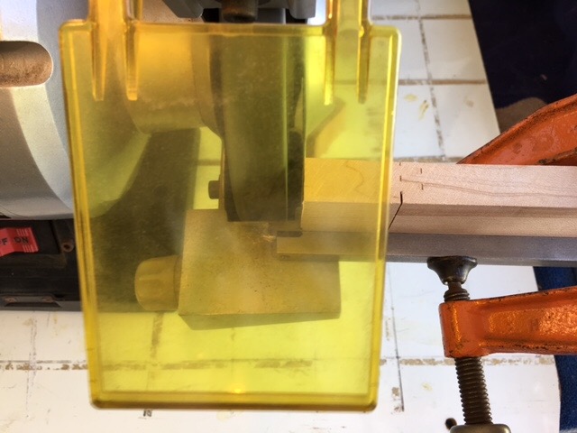

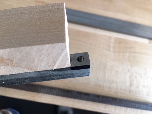

    Drilling, Tapping and Grinding SS Bar

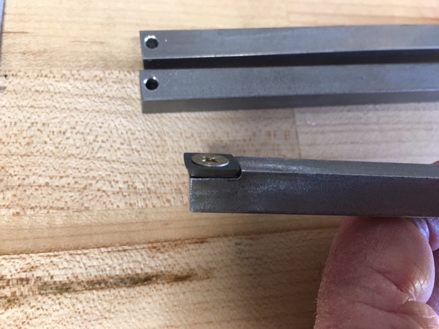

    Attaching Carbide Insert

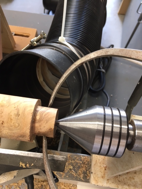

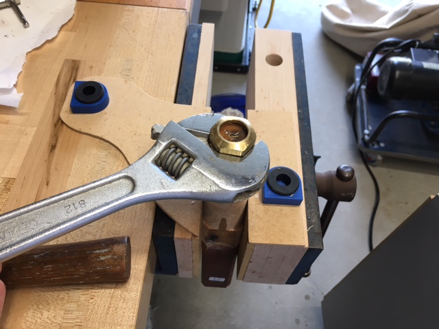

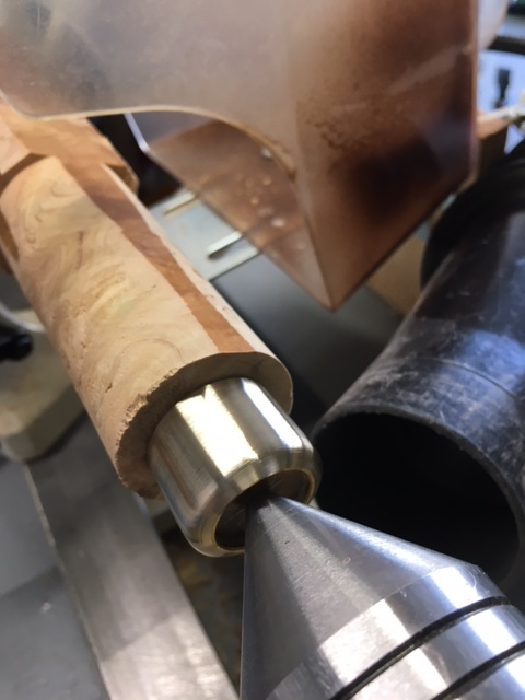

    Turning Handle front for Brass Nut

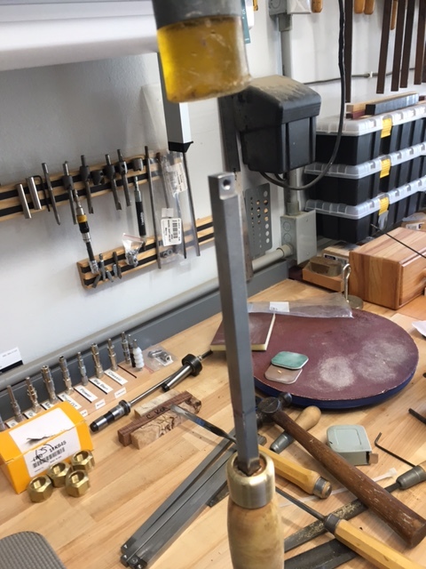

    Inserting Shaft into Handle
