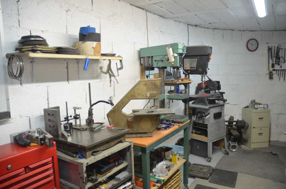

ID:	15523 This is the only picture that I have of my workshop from the early 1960s.
    It was in a wooden box previously used by furniture shippers, and was very crowded. Unfortunately the little homemade mill is not visible, it was hiding behind the one converted to vertical. The subject of the photo was really an engine dynamometer that I built from a torque convertor, not the machine tools.

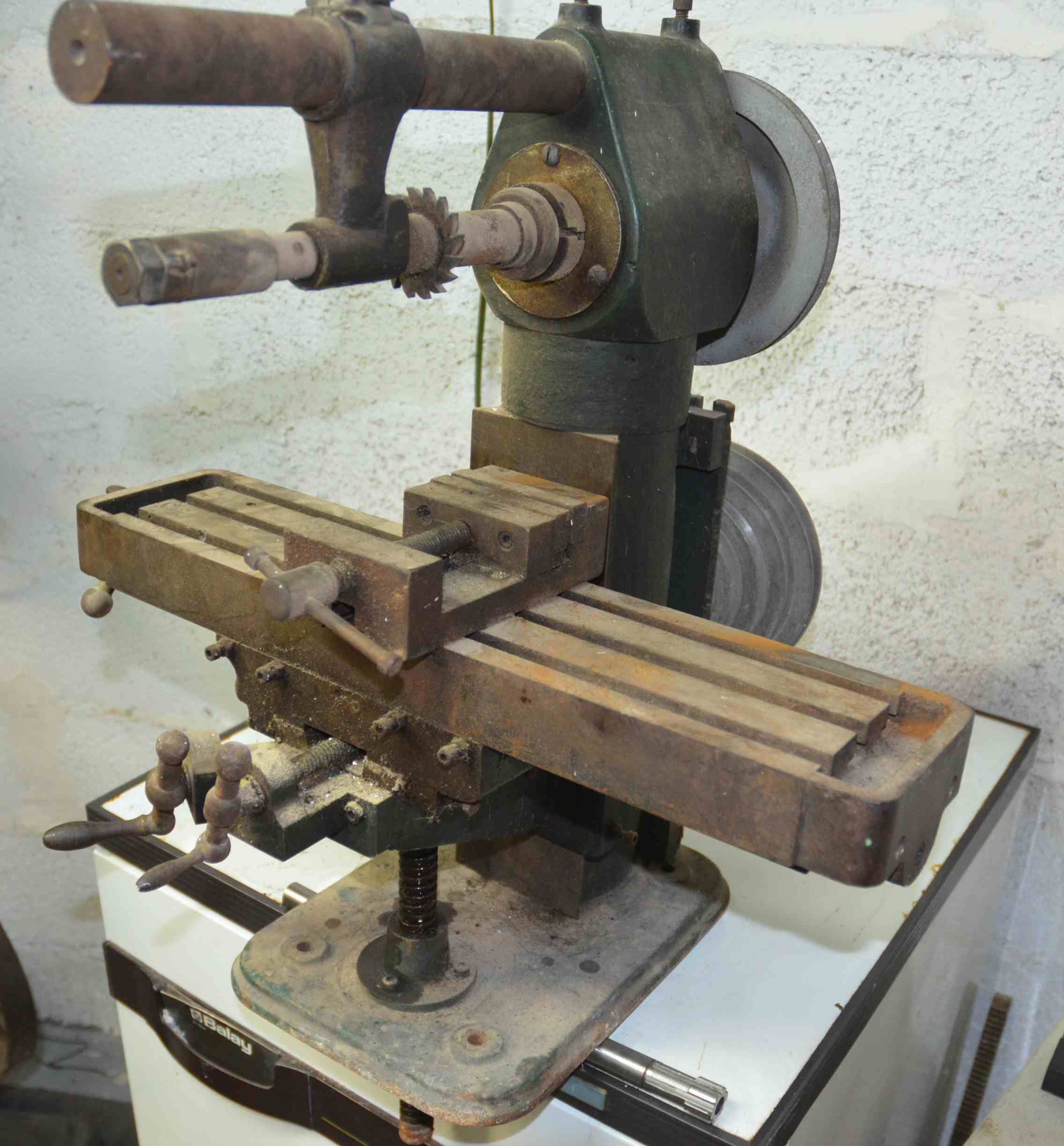

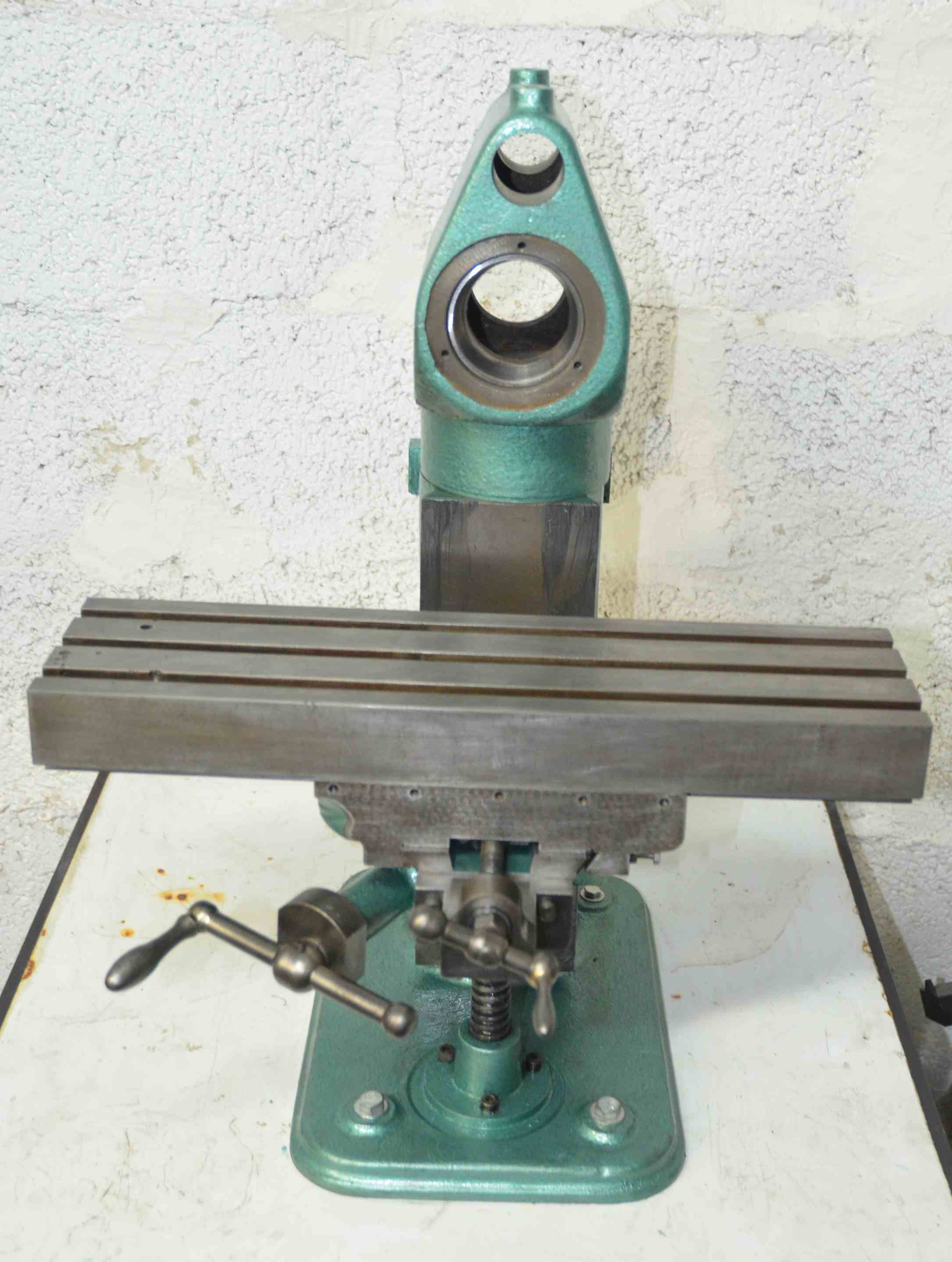

    It stayed there until a few months ago when I got the idea that I could turn it into a small surface grinder, maybe not high precision but useful nonetheless. When I first got it up on a bench it looked in a pretty sorry state, rusty etc. I wasn't very hopeful. Here are a couple of photos as it was.
Name:	Mill 50years unused.jpg
ID:	15525 Click image for larger version.
Name:	Mill Column 50years unused.jpg

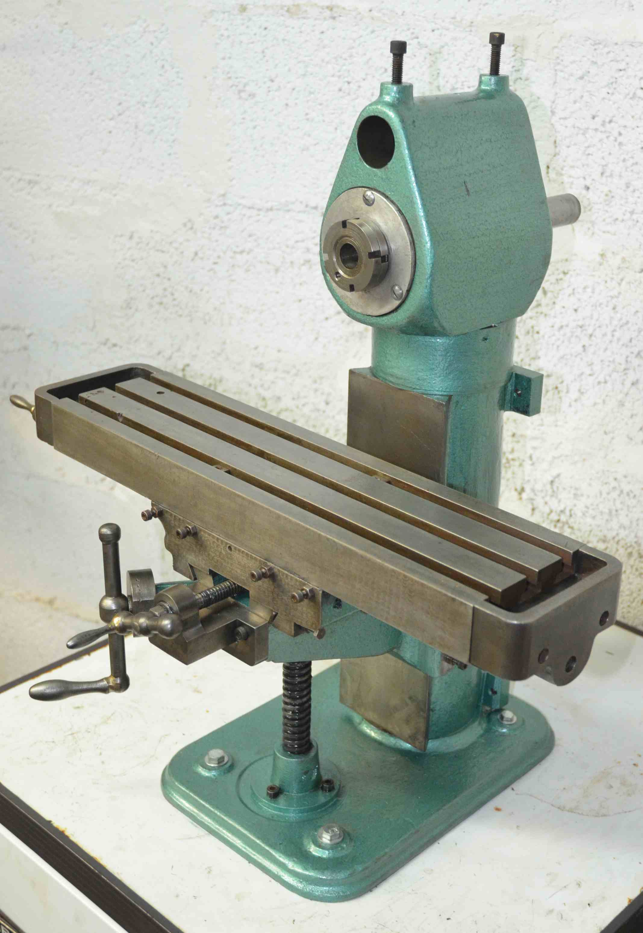

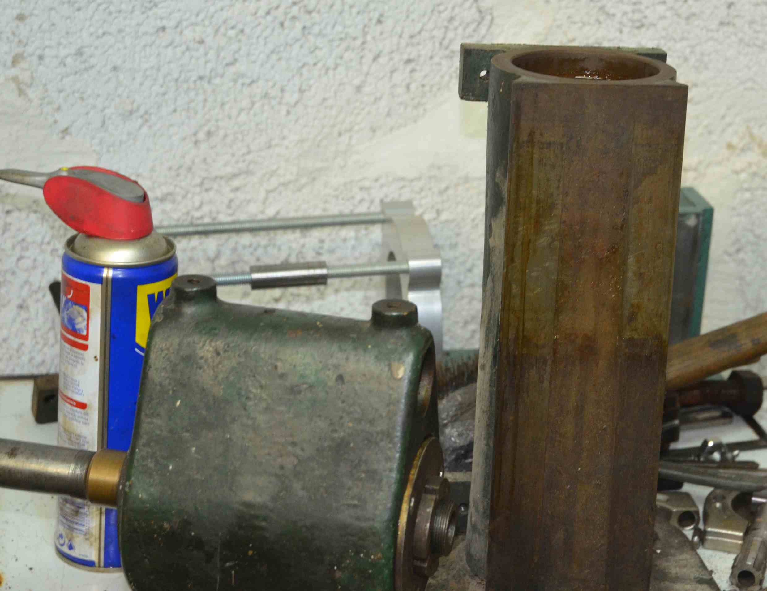

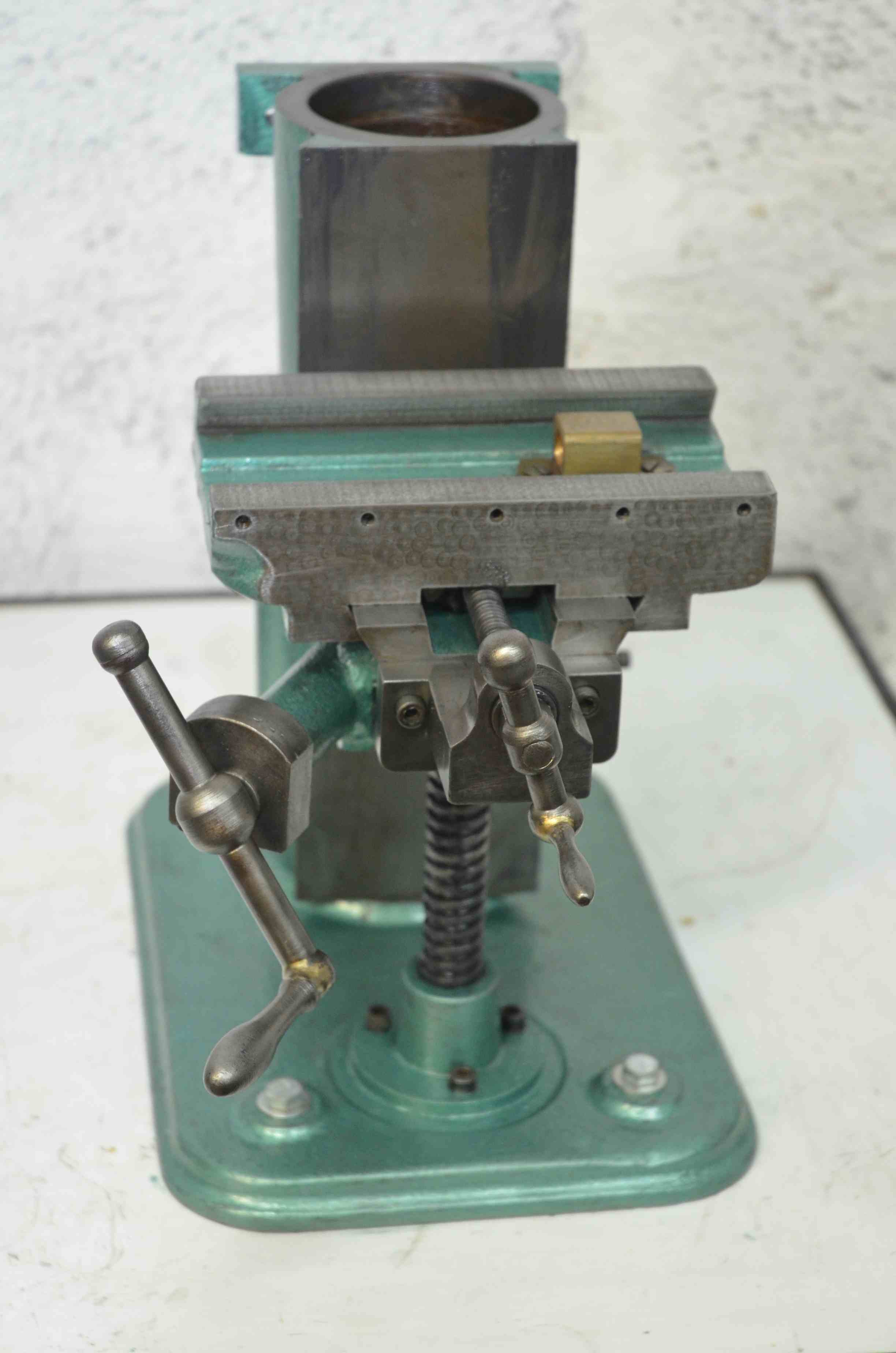

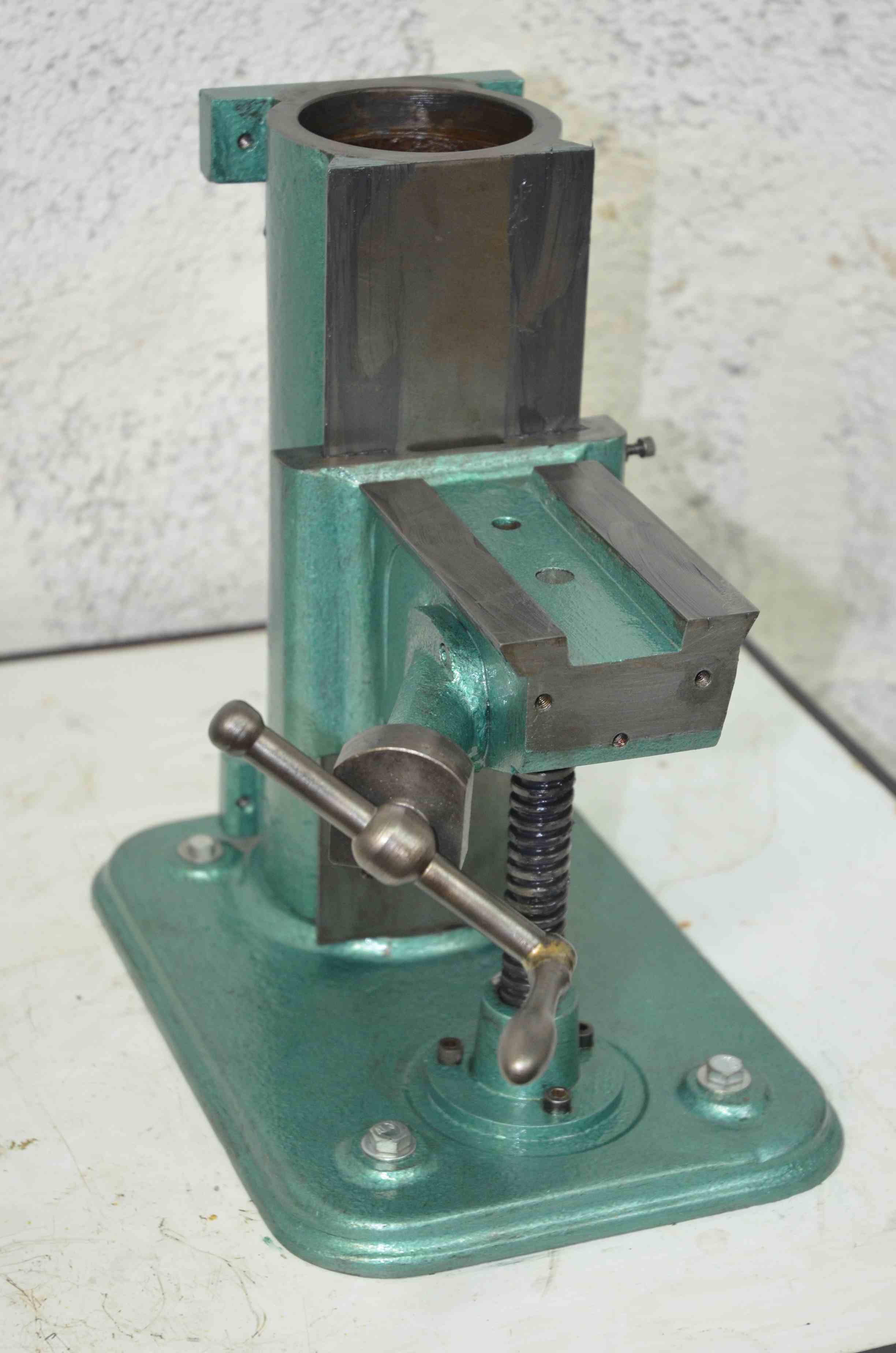

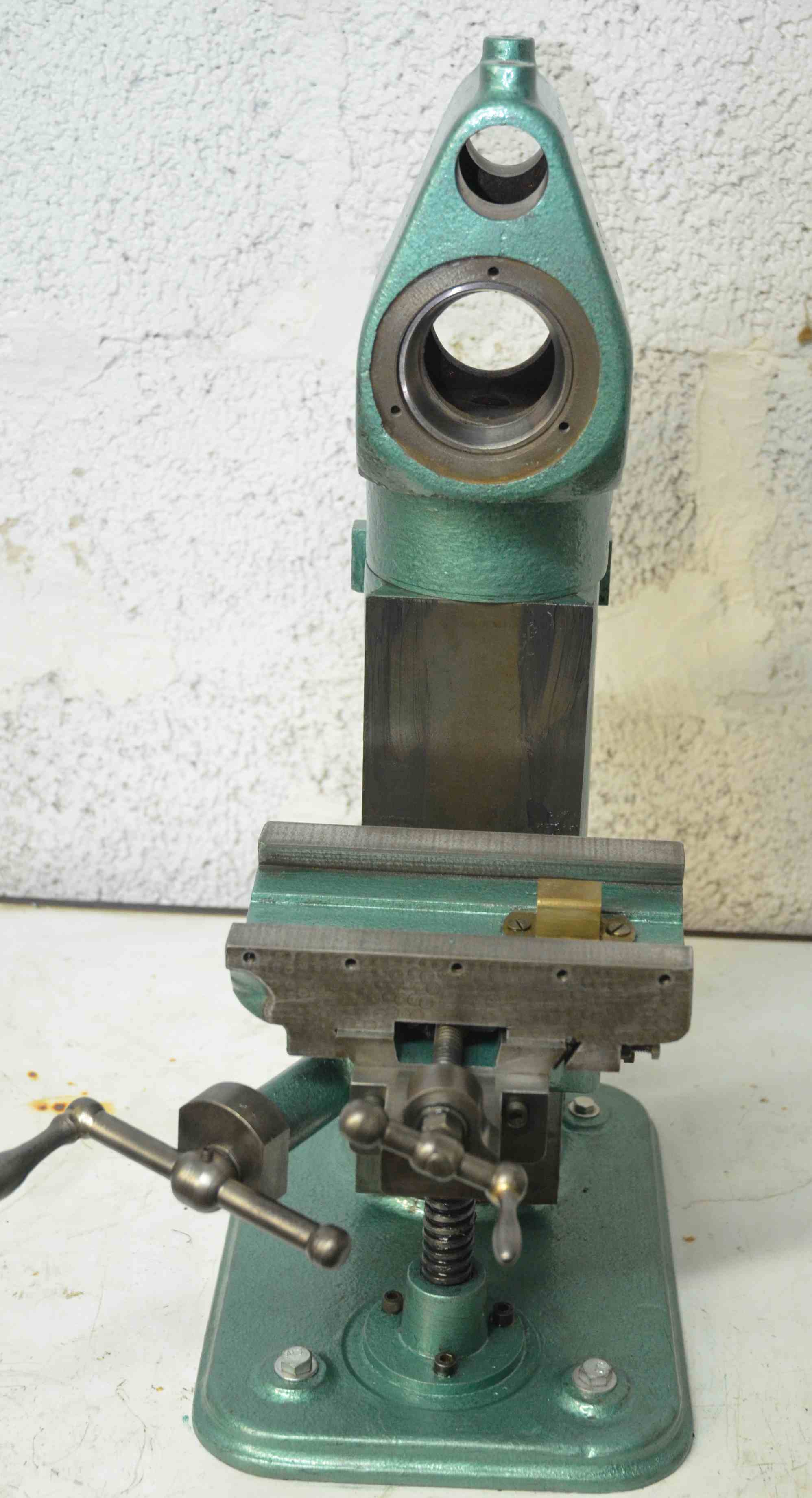

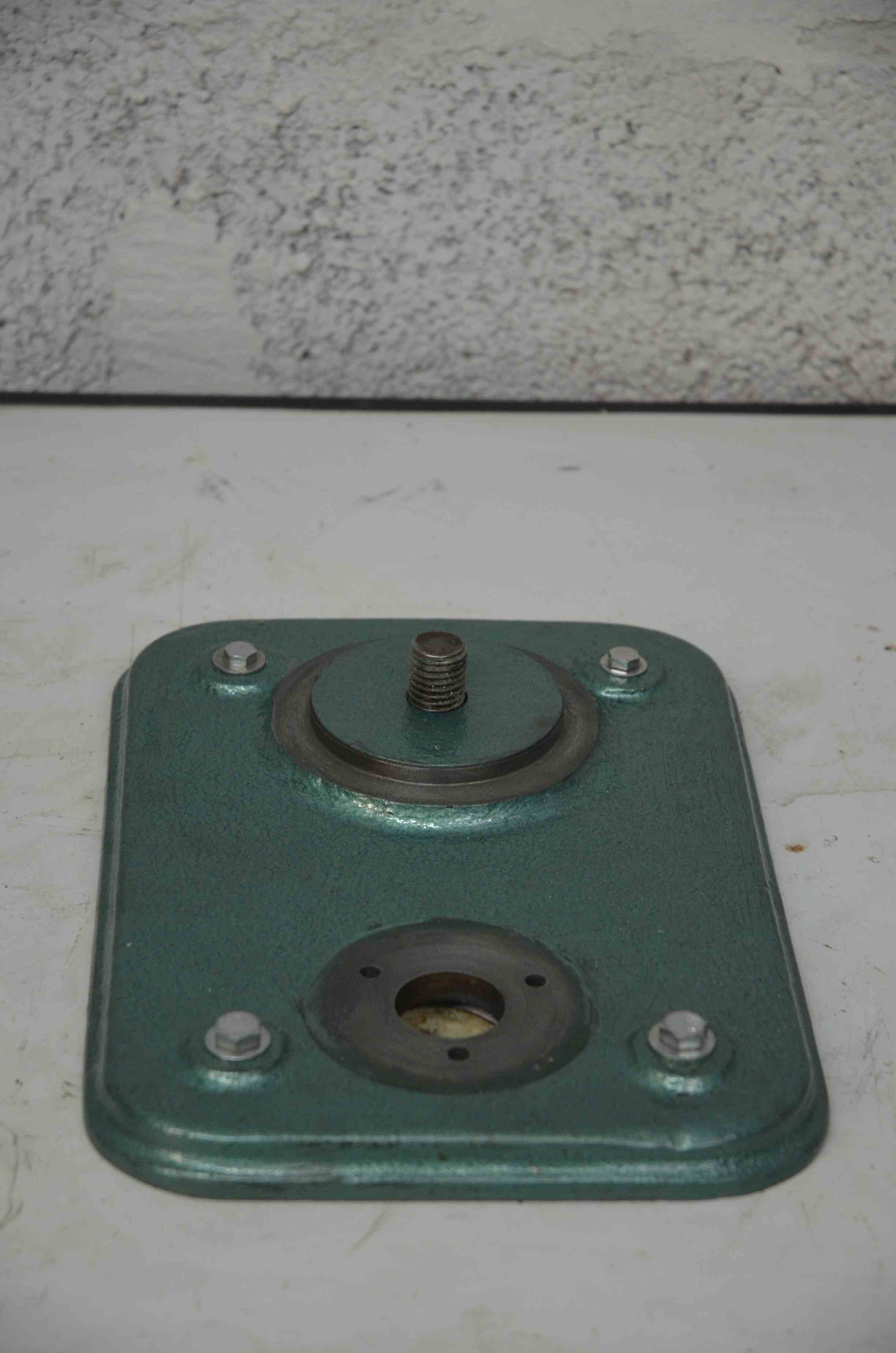

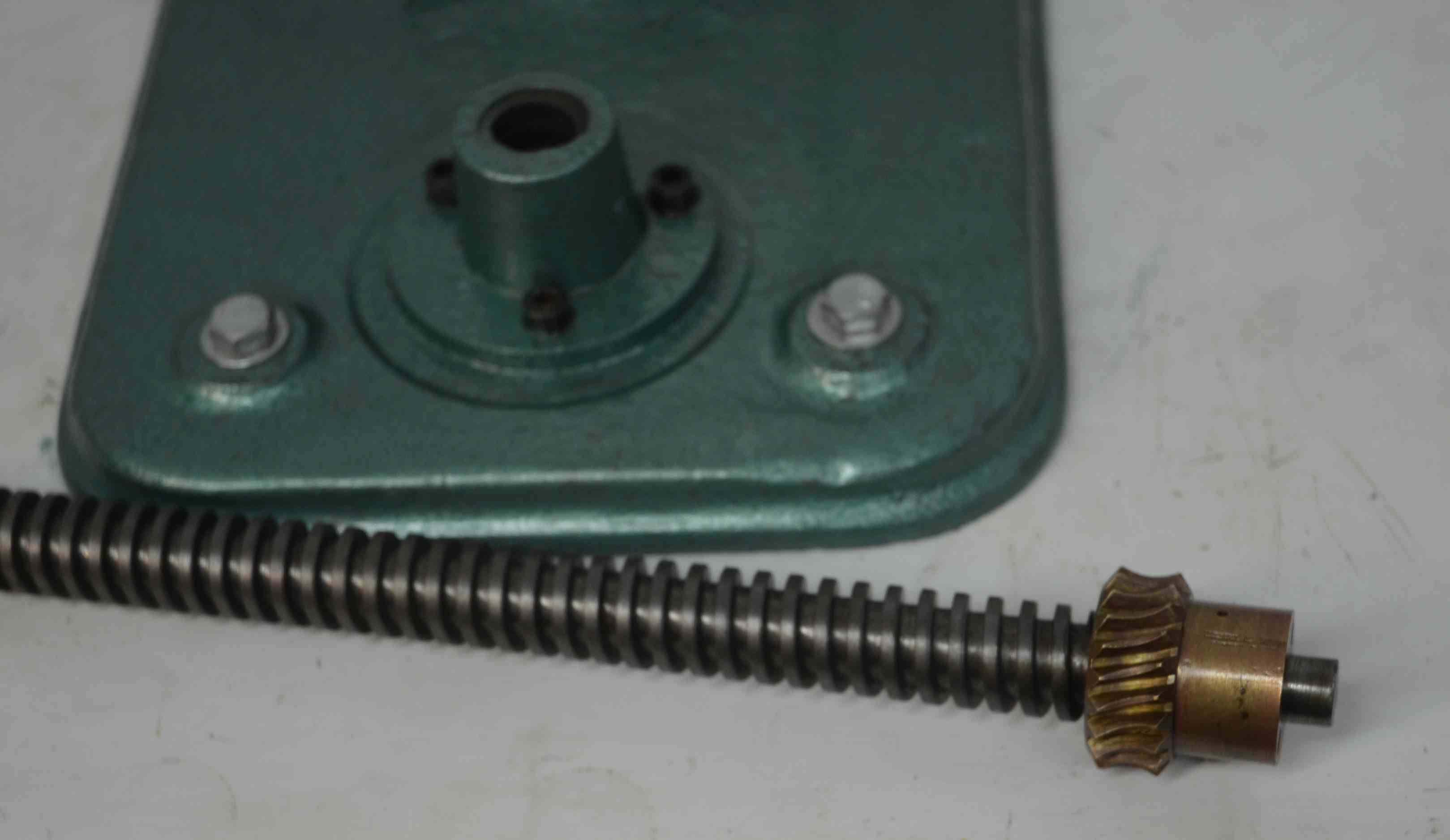

    However, it was actually in pretty good nick. What looked at first sight to be rust etc. just turned out to be decades worth of grime congealed on the protective grease that I covered it in back in 1971 in preparation for its long sea voyage. The following is a succession of photos during the new build up after cleaning. I think that the sequence shows the construction pretty well, without much explanation. Before assembly I thought that it would be a good idea to check everything for flatness and squareness so that with better machinery now I could correct any original errors. Much to my surprise there was nothing that needed re-machining.

    Finally mocked up to see how it might look as a surface grinder.

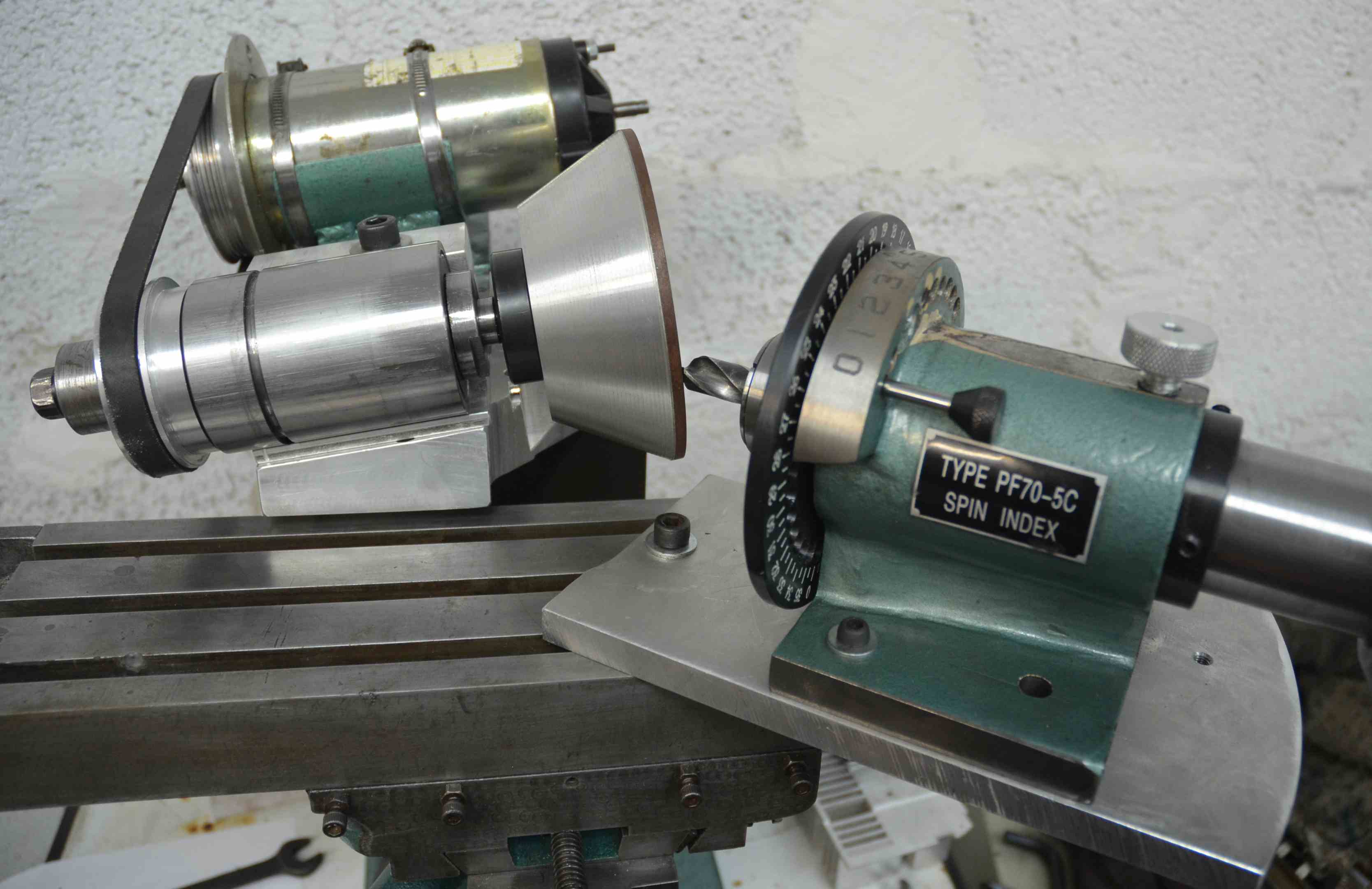

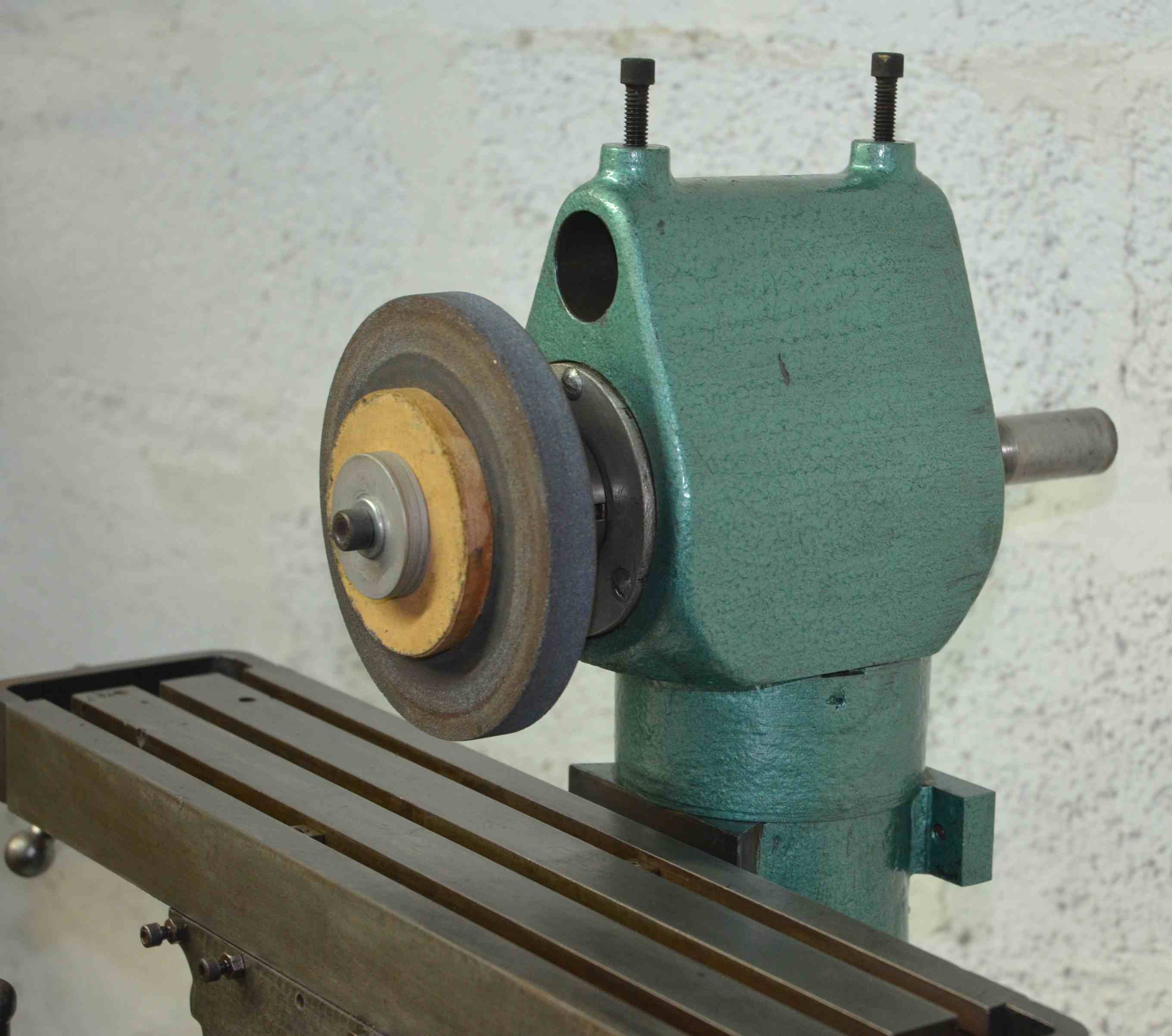

    I haven't actually finished it off or tested it as a surface grinder because it occurred to me that if I swapped the head with my lathe tool post grinder, and added a spin indexer I could have a very capable Tool and Cutter grinder. I did that and it works a treat, but that will have to be the subject of another post. In the meantime here is a teaser.
