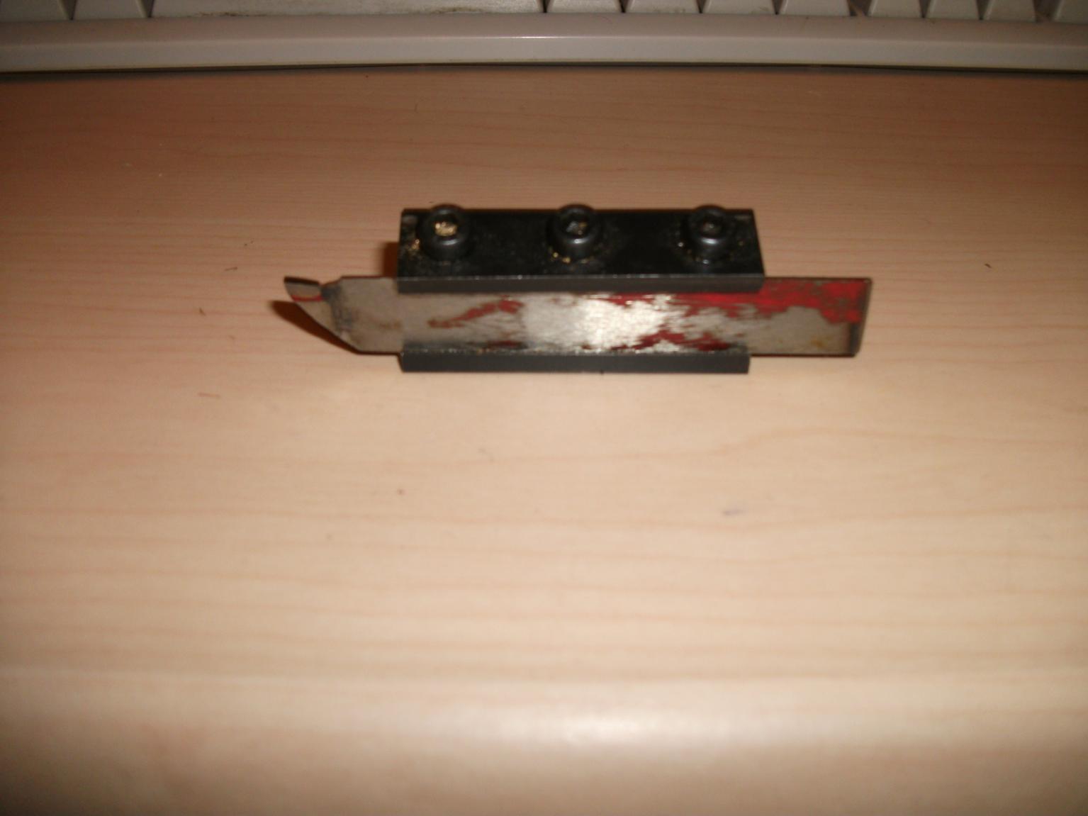

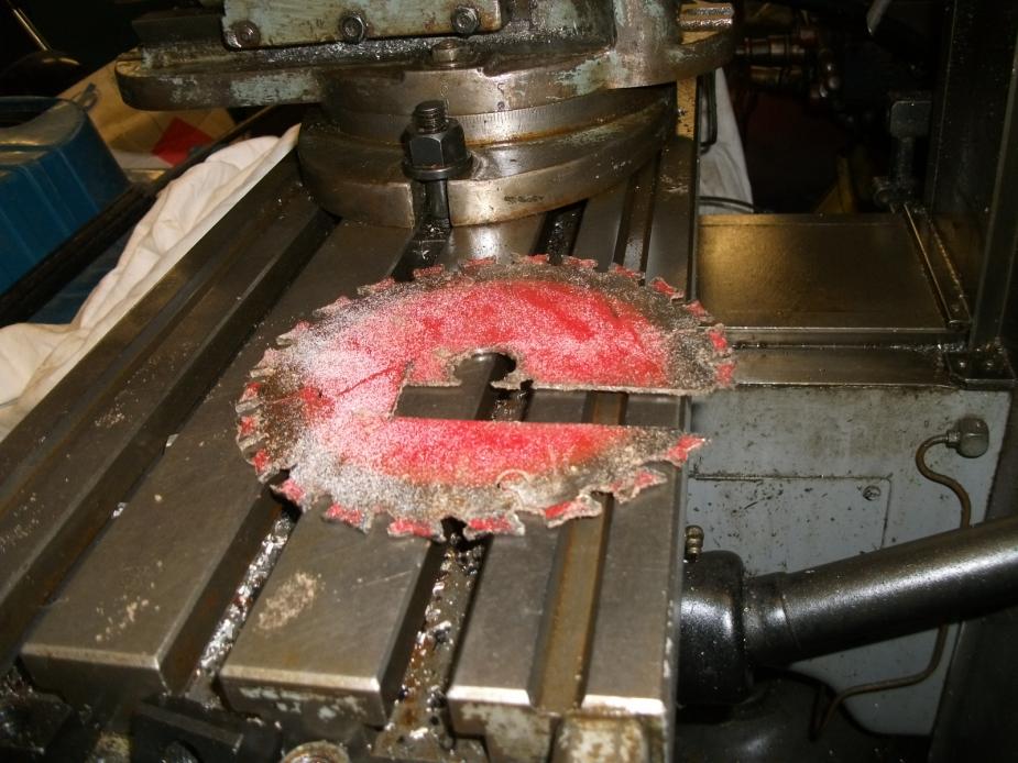

    home made parting tool
    heres a simlpe cheap carbide parting tool made from old tct saw blades they can be easily sharpened on a green grindstone
