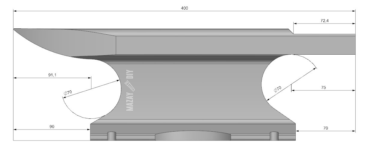

Anvil Dimensions (height = 140 mm):
Attachment 43184
