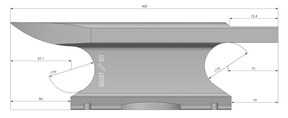

    How to turn Railroad track into homemade anvil with angle grinder?
    Anvil Dimensions (height = 140 mm):
