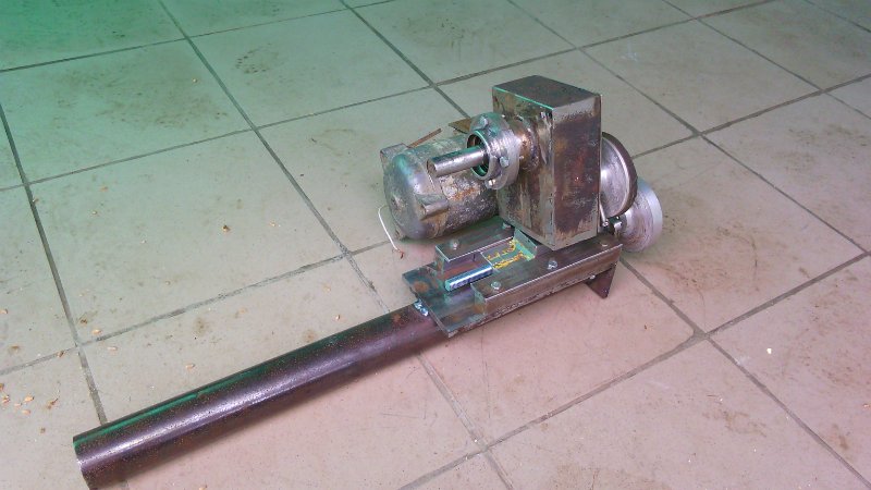

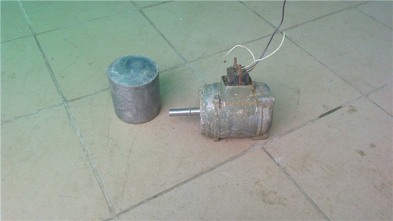

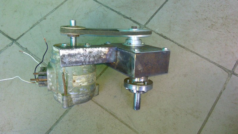

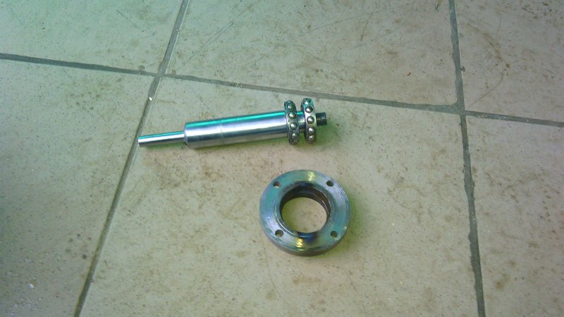

The molten aluminum and manufactured workpiece diameter 100 mm. Also found motor for milling 350W 2000 rpm/
Attachment 8498
Attachment 8498

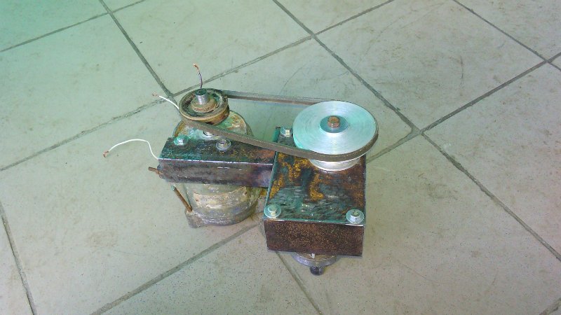

Installed motor
Attachment 8523
Attachment 8524

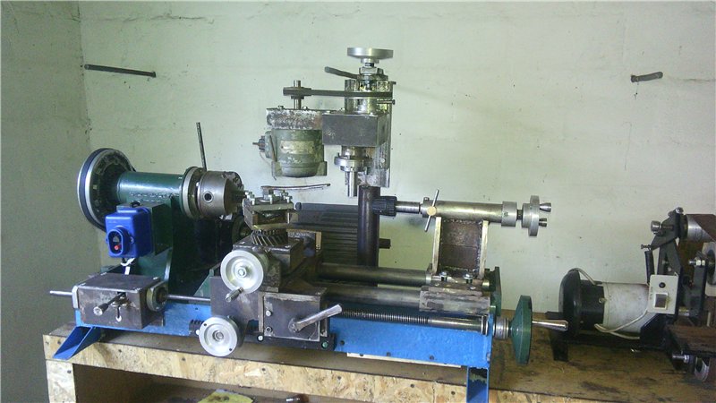

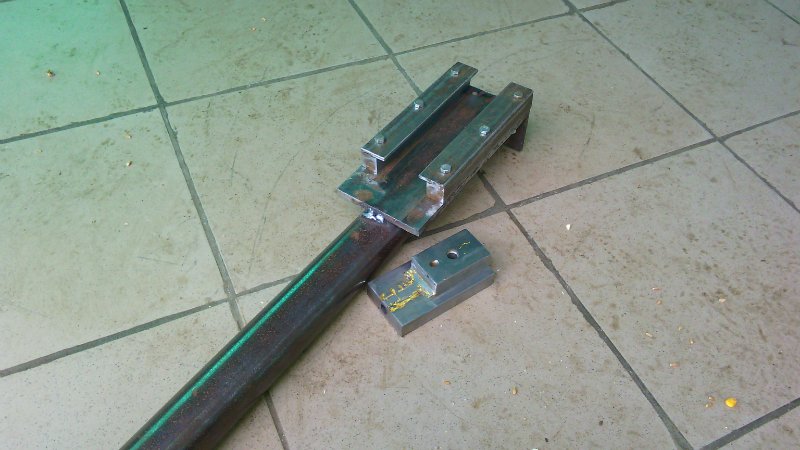

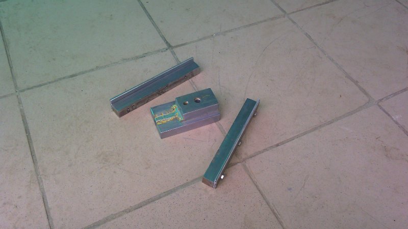

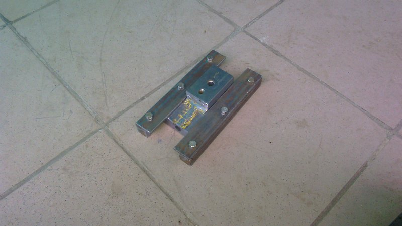

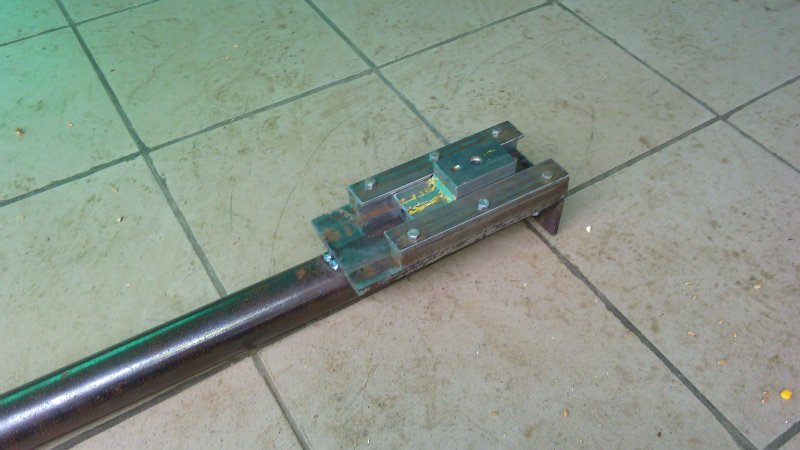

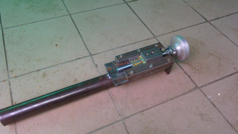

Vertical rack for milling.
Attachment 8552
Attachment 8553
Attachment 8554
Attachment 8555
Attachment 8556
Attachment 8557

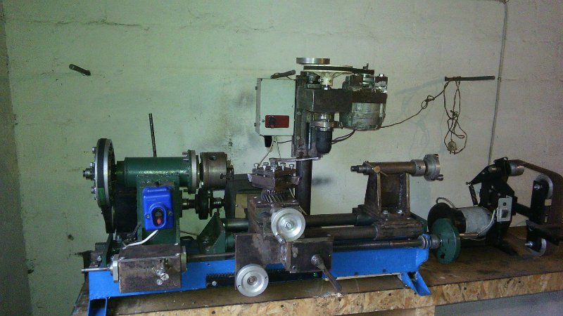

Installed milling attachment
Attachment 8578

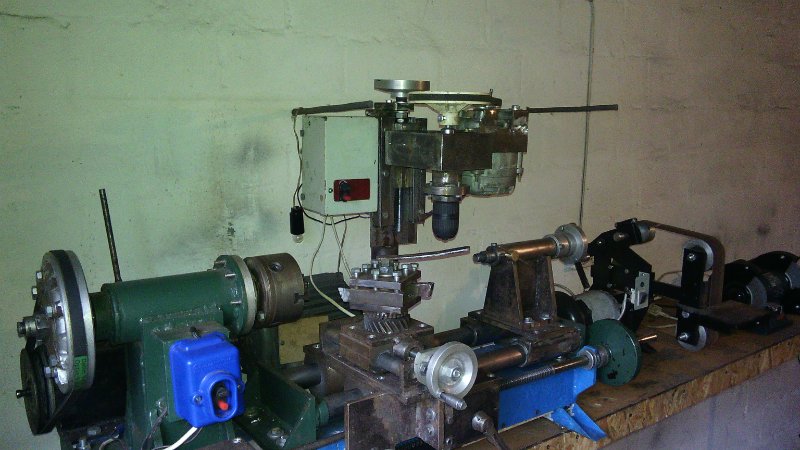

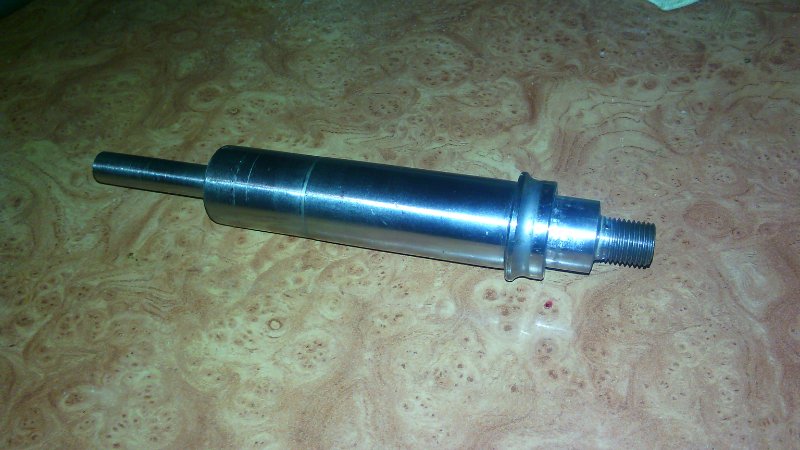

Hi. Fully developed a new design, new motor and set it on the right. Gear box broke, it was made of cast iron rather than steel. So now a spindle and pulley.
Attachment 8692
Attachment 8693
Attachment 8694

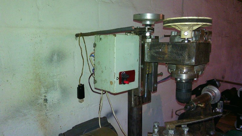

Box with electronics.
Attachment 8695
Attachment 8696

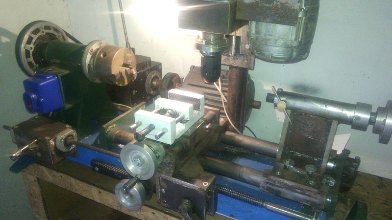

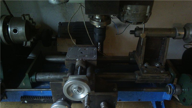

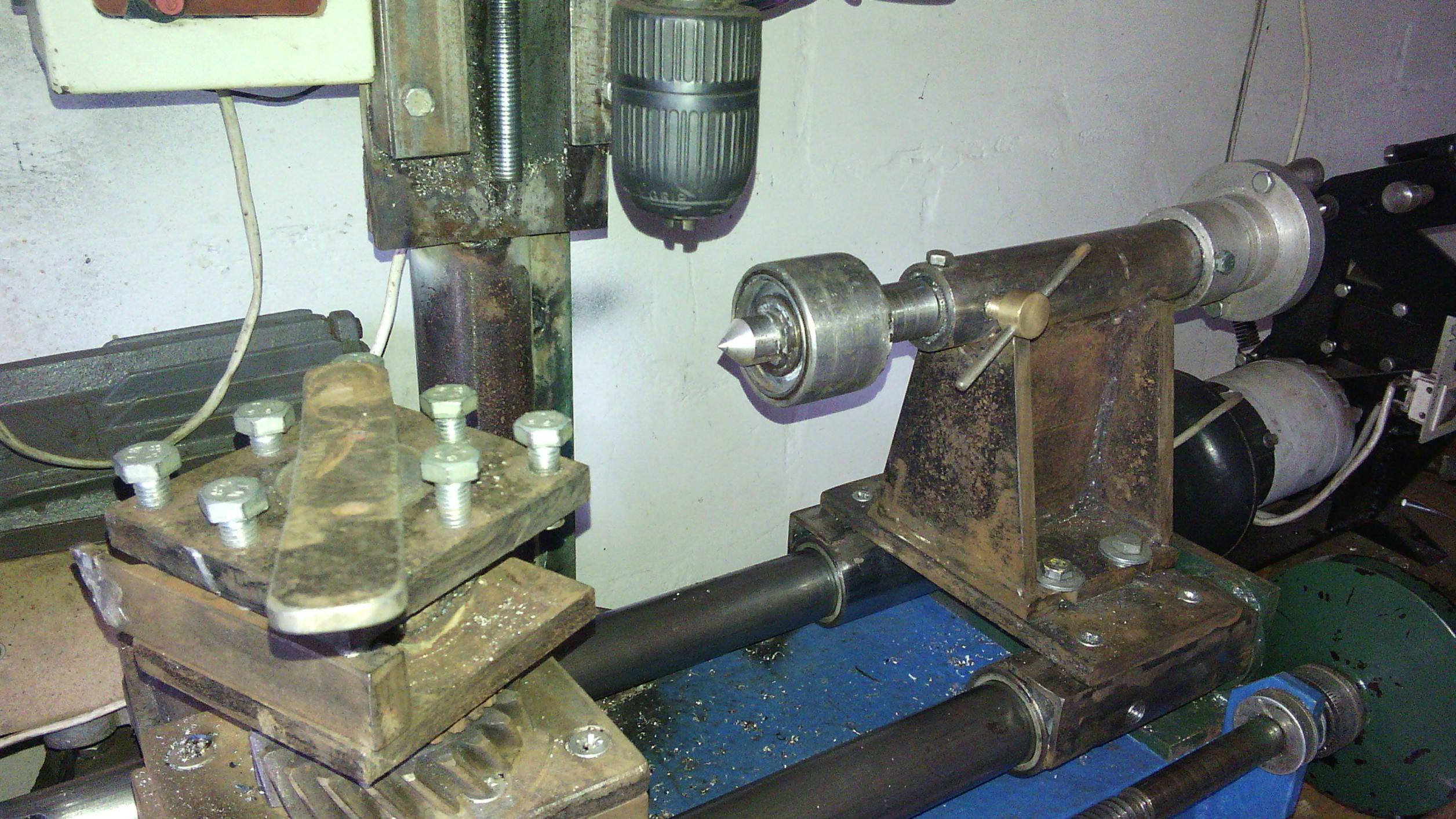

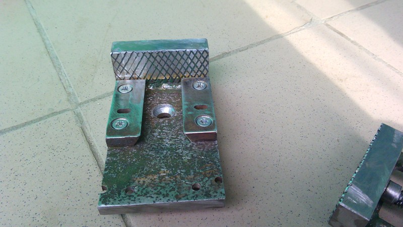

Today started first milling. Milling platform caliper, later to be installed vise.
Attachment 8796

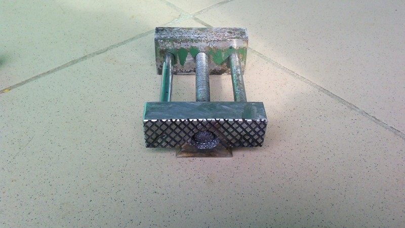

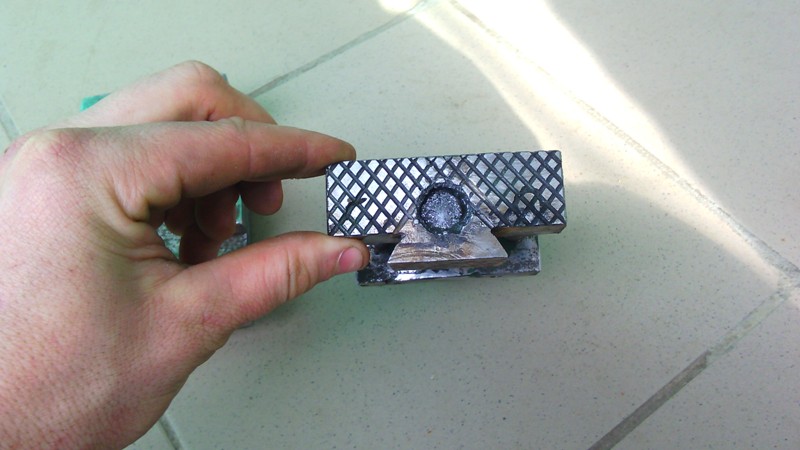

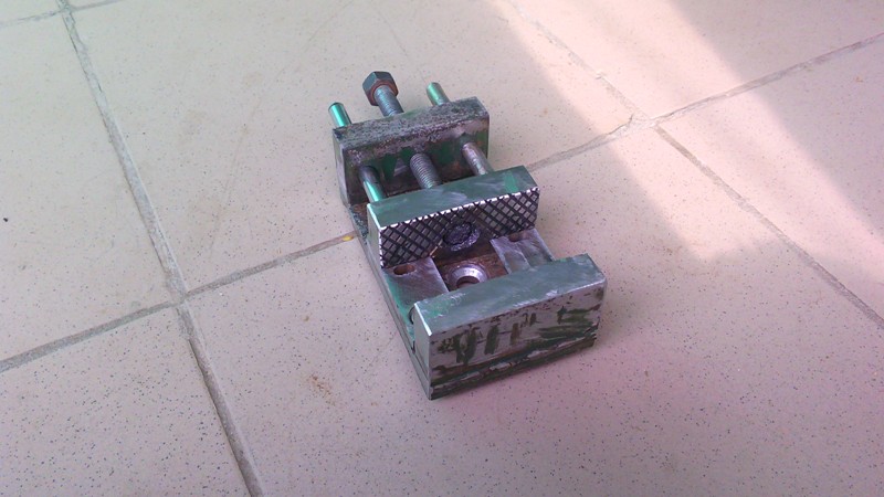

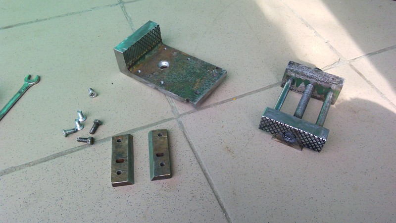

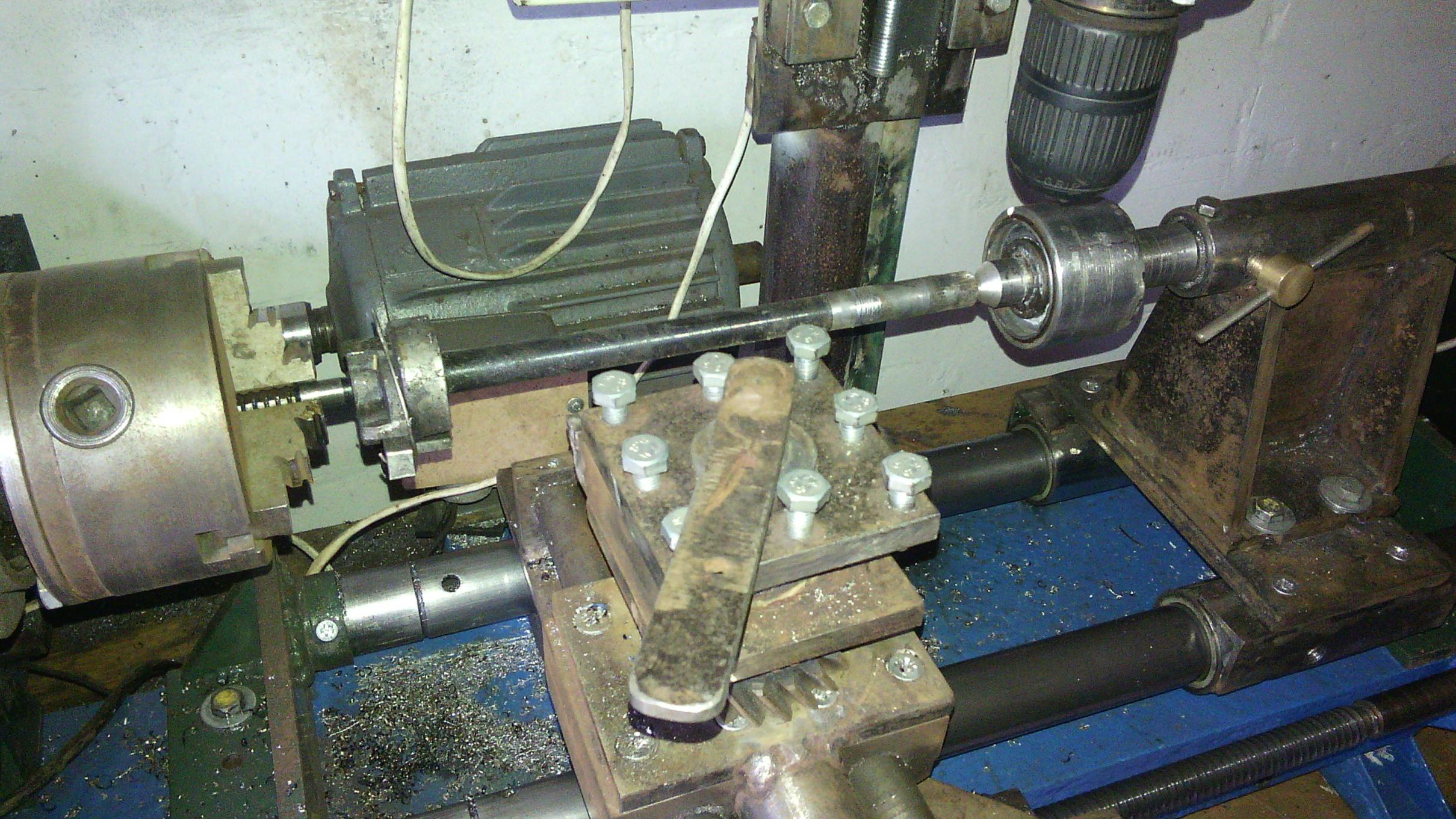

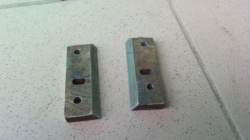

Homemade milling vise
Attachment 8984 Attachment 8985 Attachment 8986 Attachment 8987 Attachment 8988 Attachment 8989 Attachment 8990

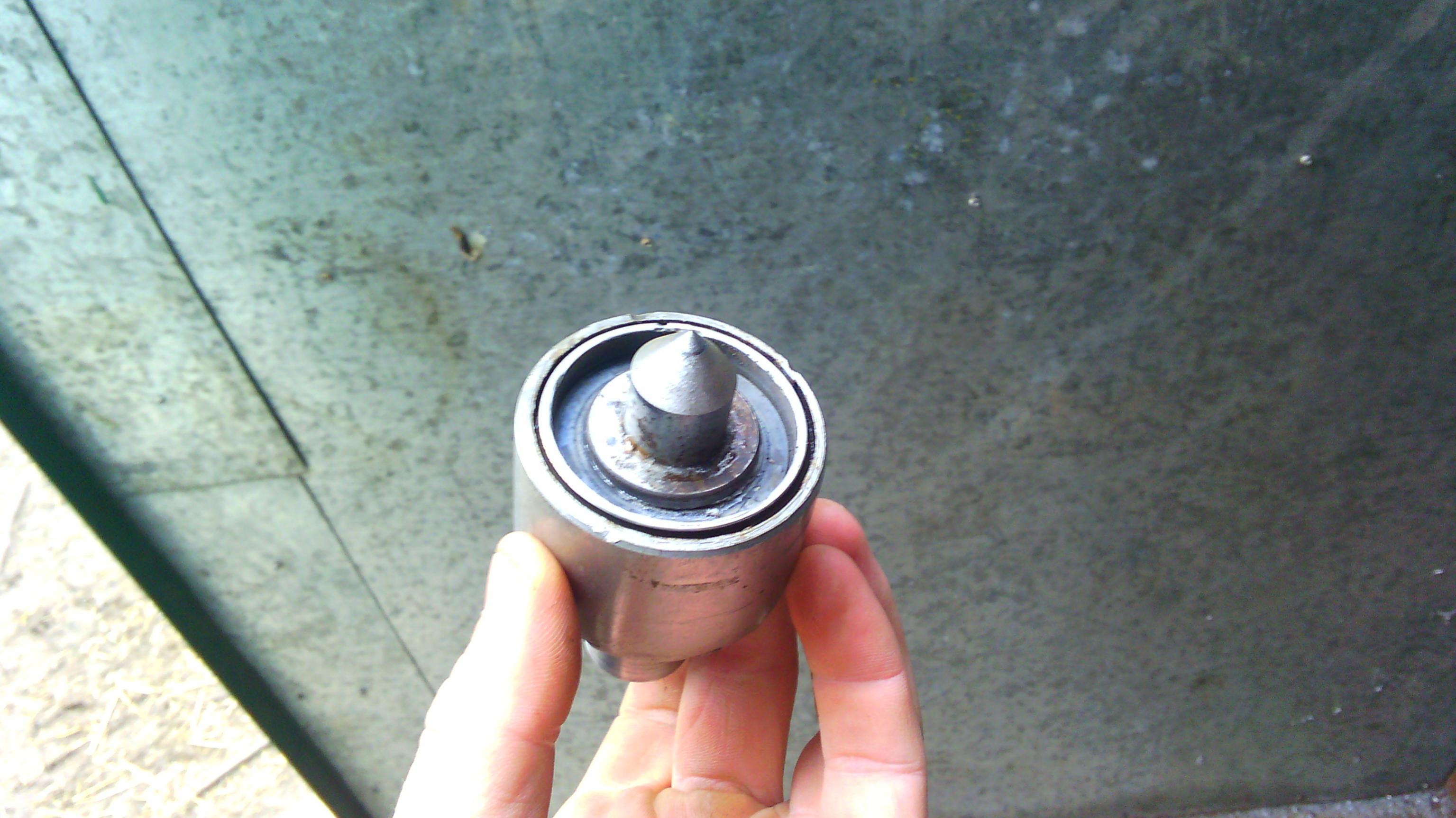

Rotating tailstock centre
Attachment 9070Attachment 9071Attachment 9072
The maximum length of 30 cm details
