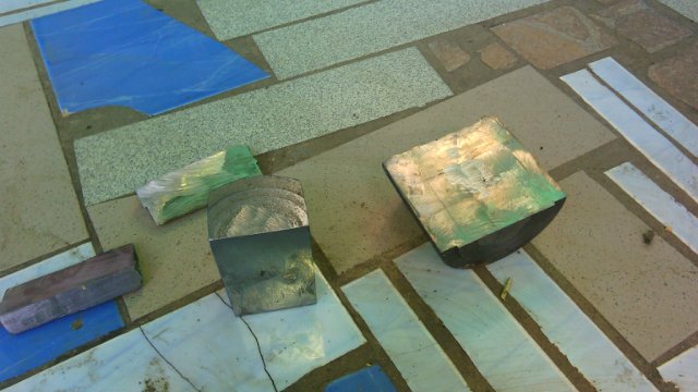

Hello. I want to share my project. This lathe machine for metal, construction began six months ago. I'll start my story about the front pastern. For the construction of boxes used sheet metal 10 mm.
Attachment 6884
Attachment 6885
Attachment 6886
Attachment 6884
Attachment 6885
Attachment 6886

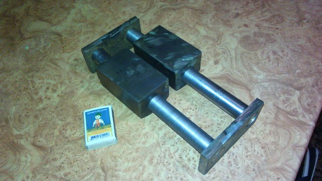

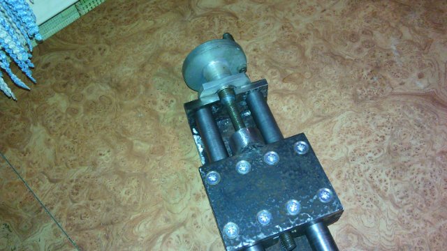

The process of creating front pastern
https://www.youtube.com/watch?v=E-As4tECwcQ
Fasteners for steel rod and iron bushings. Rods diameter 36mm, length 54 cm, diameter bushings 75mm.
Attachment 6887
Attachment 6888
Attachment 6889
Attachment 6890
Attachment 6891
Attachment 6892
Attachment 6893

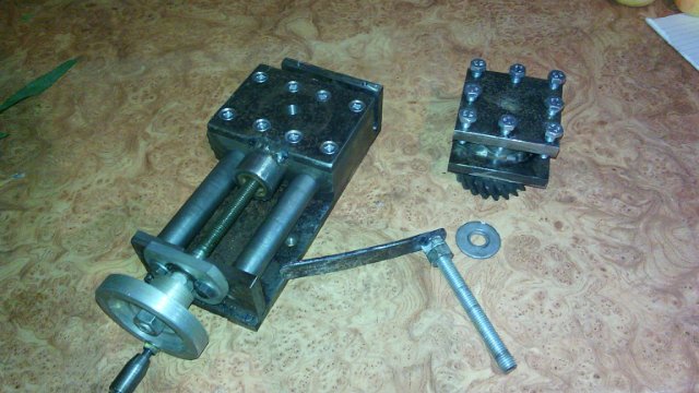

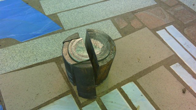

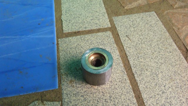

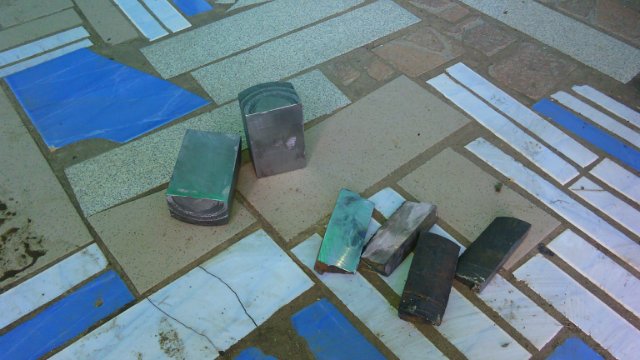

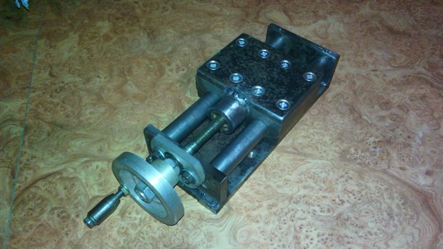

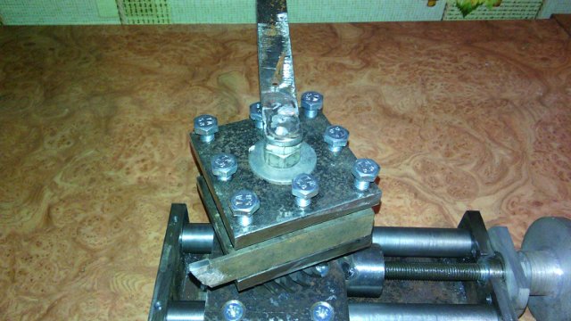

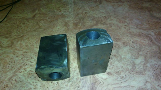

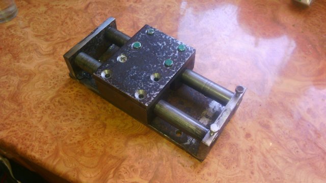

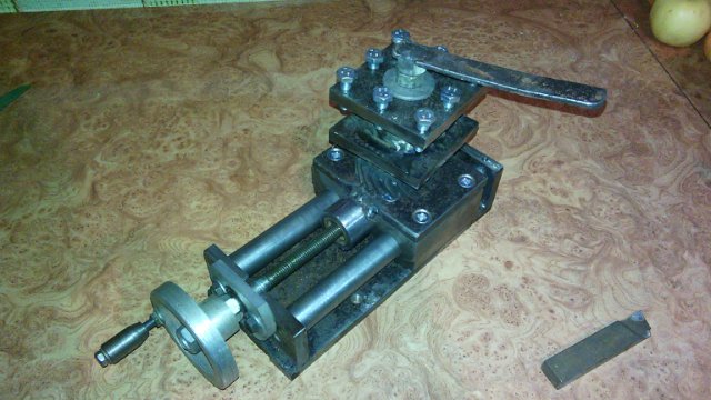

Caliper with Tool carriers. Steel rods have a diameter of 22 mm, bushings are made of cast iron.
Attachment 6966
Attachment 6967
Attachment 6968
Attachment 6969
Attachment 6970
Attachment 6971
bronze nut
Attachment 6972
Attachment 6973
Attachment 6974
Attachment 6975

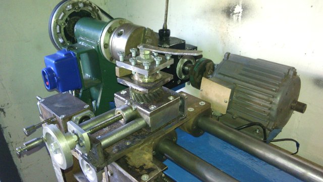

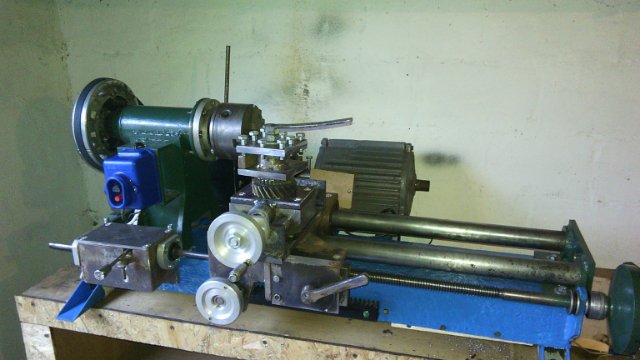

Lathe machine launched the first shavings. Make Kaprolon bushing for the tailstock.
