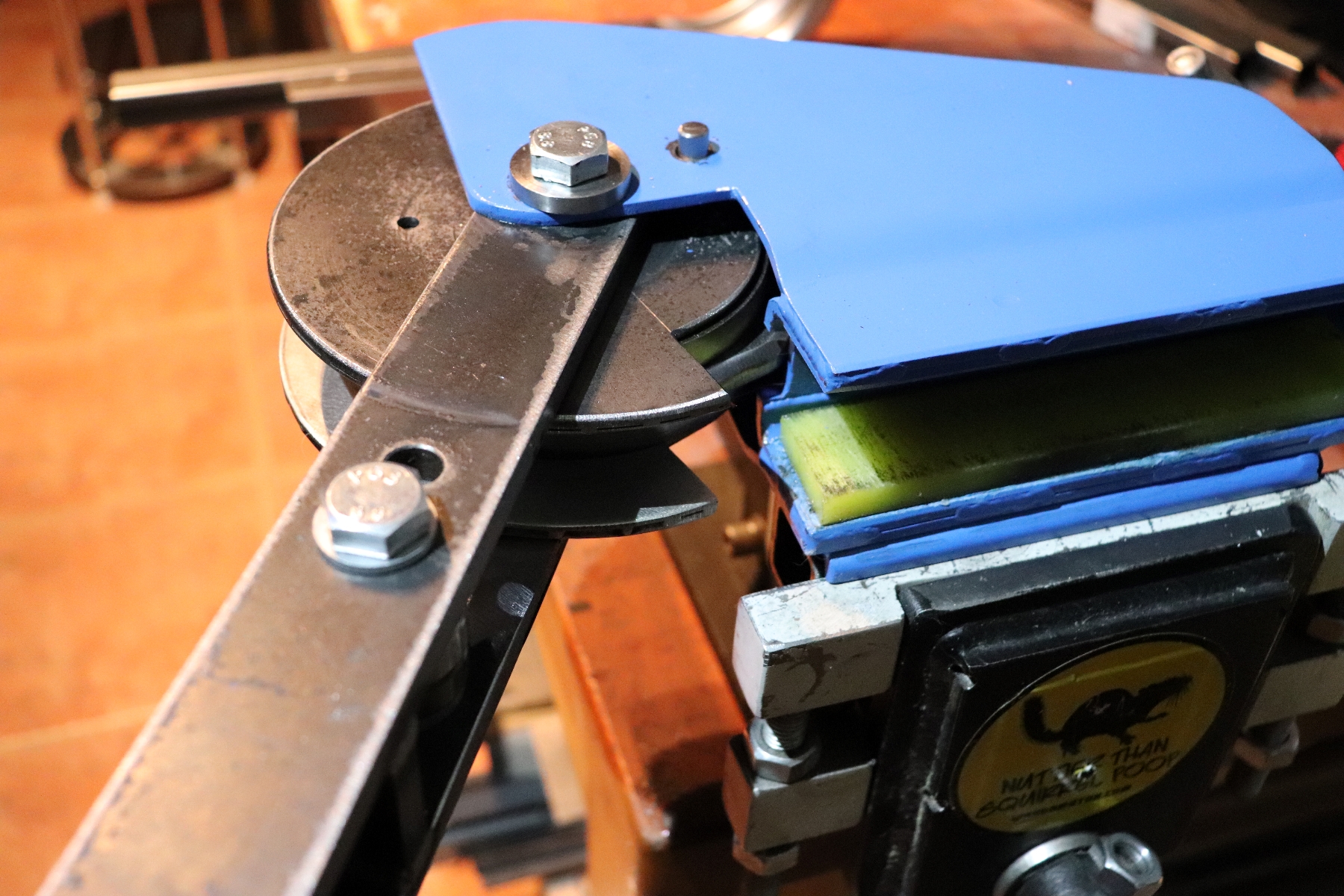

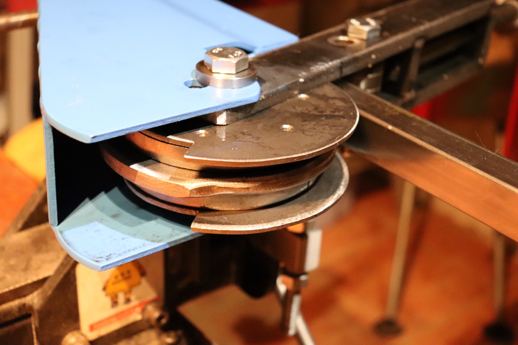

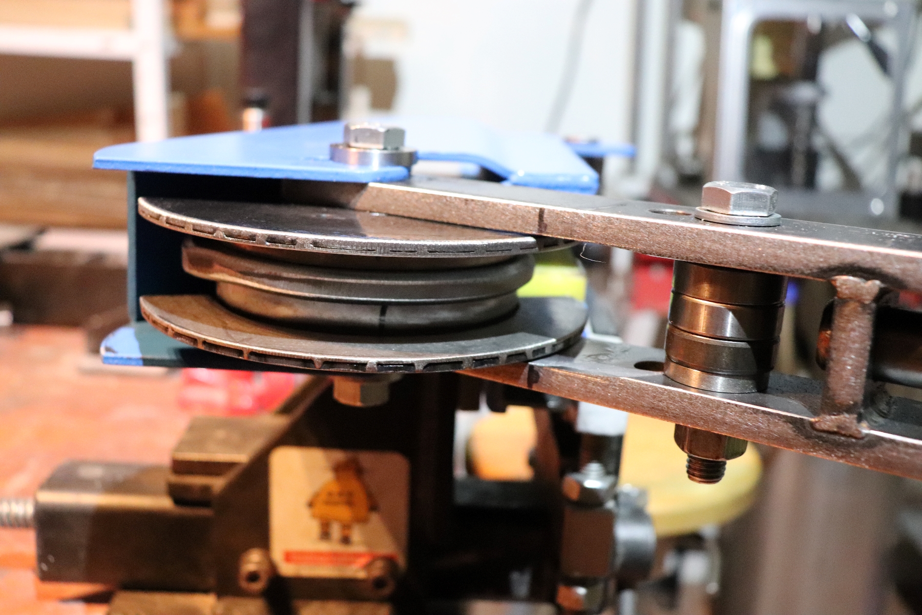

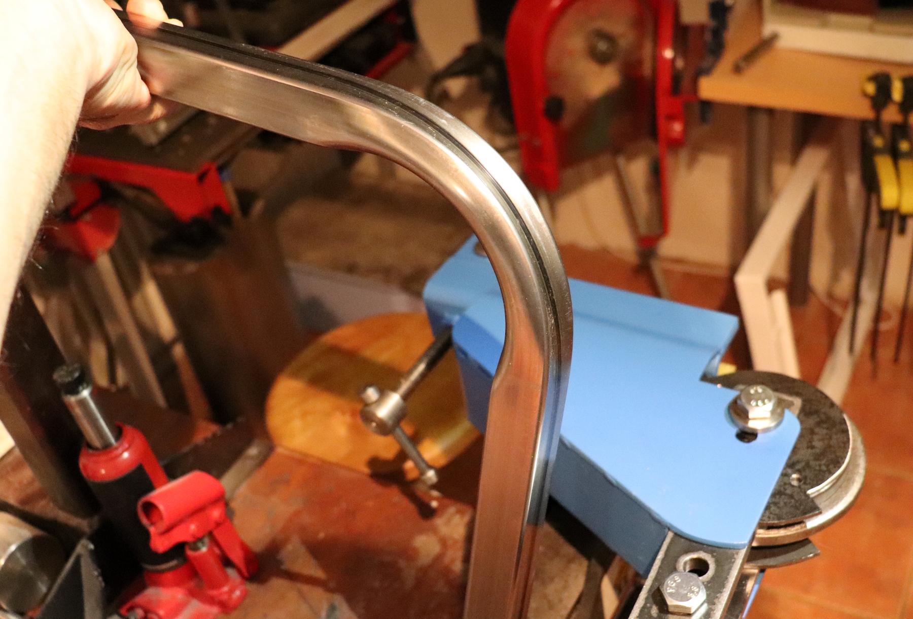

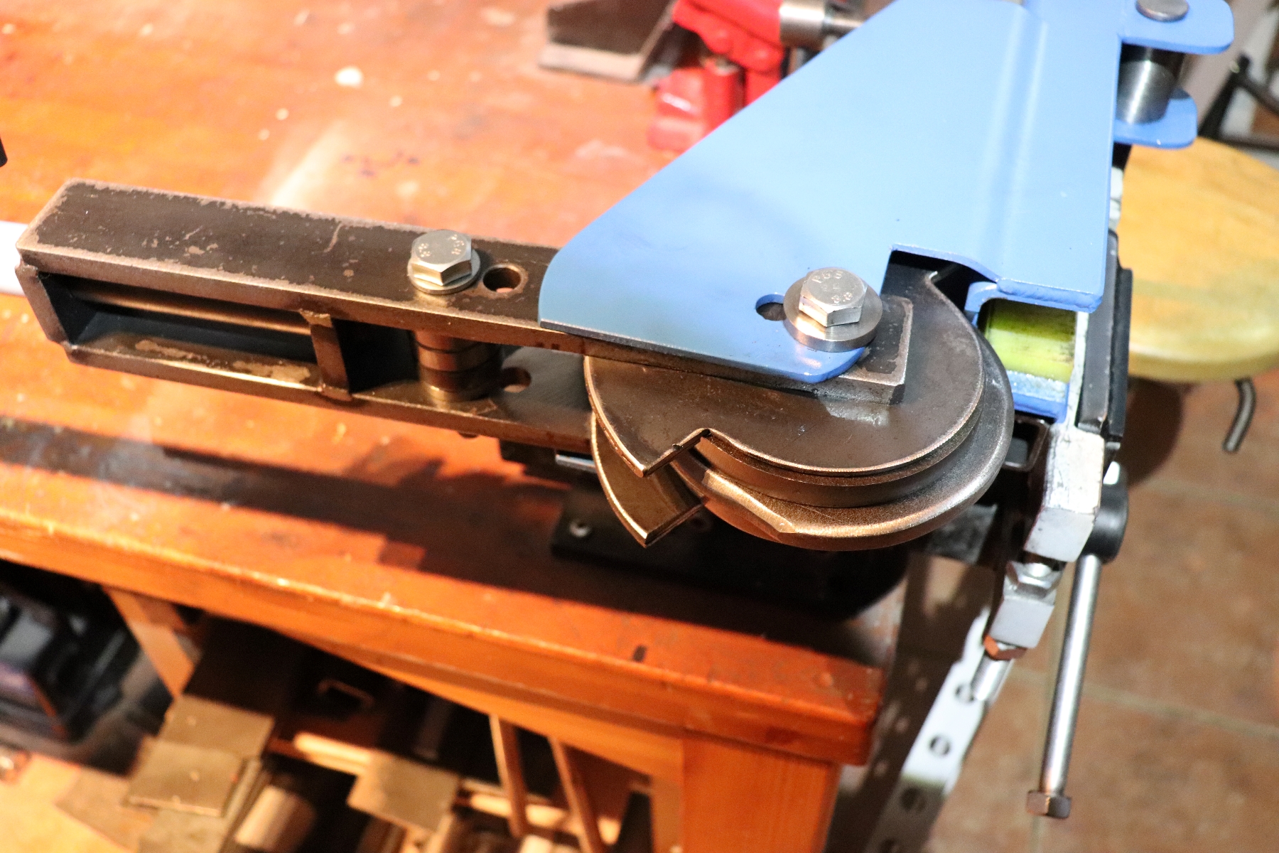

    This is my homemade manual square tube bender:
    Makes 0-90 degree bends to 25mm ( 1" )- 30mm square tubes.
    Bending radius is 50mm ( 2" )
    Way that i used for making die, works with round tubes / pipes too.
    Tool:
    Result:
    Homemade manual square tube bender-1.jpgHomemade manual square tube bender-3.jpg
    Fast to use, and somewhat easy and cheap to make.
    Die is made from 10mm and 4mm plate.
    Arm for the bender made from 50mm x 10mm flat bar and 20mm axle
    Body of the bender is 5mm plate and 50 x 50 x 5mm square tube.

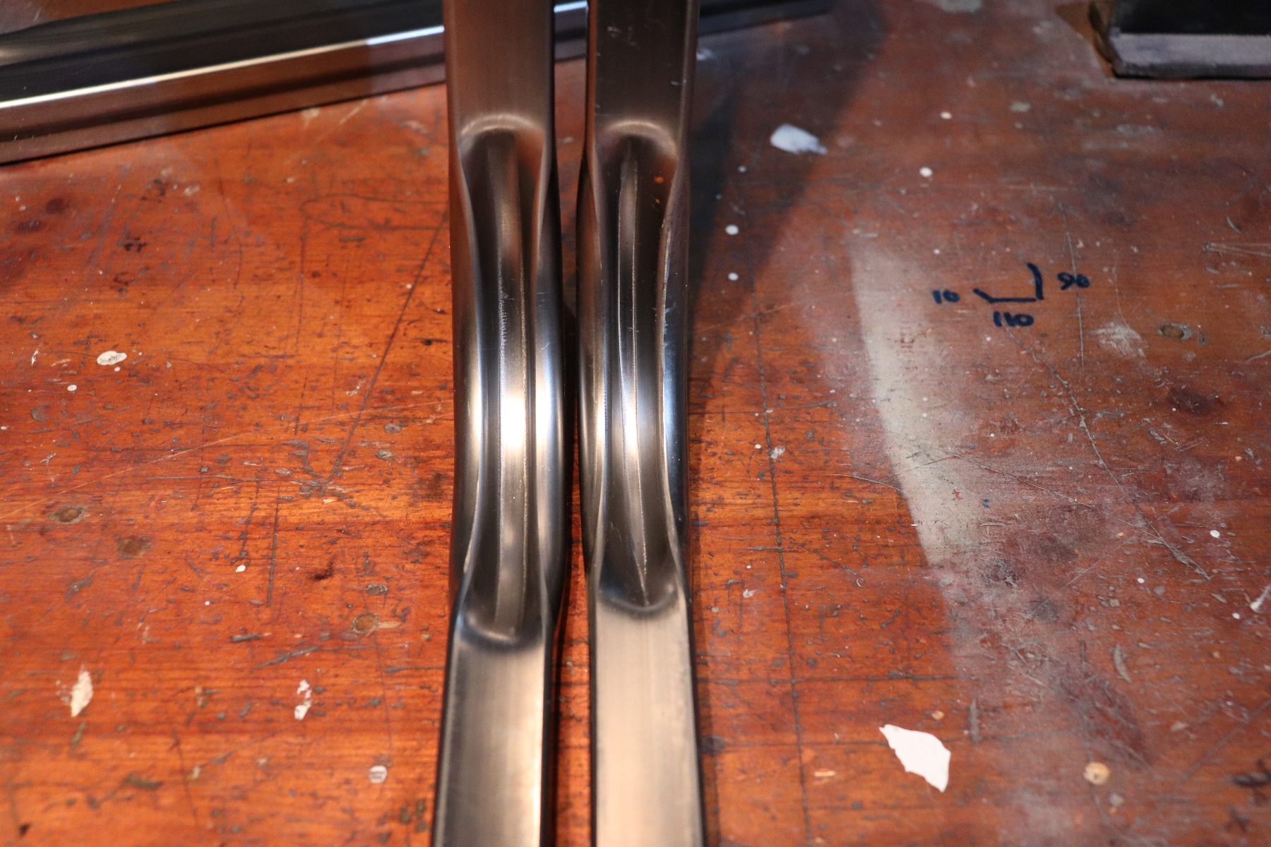

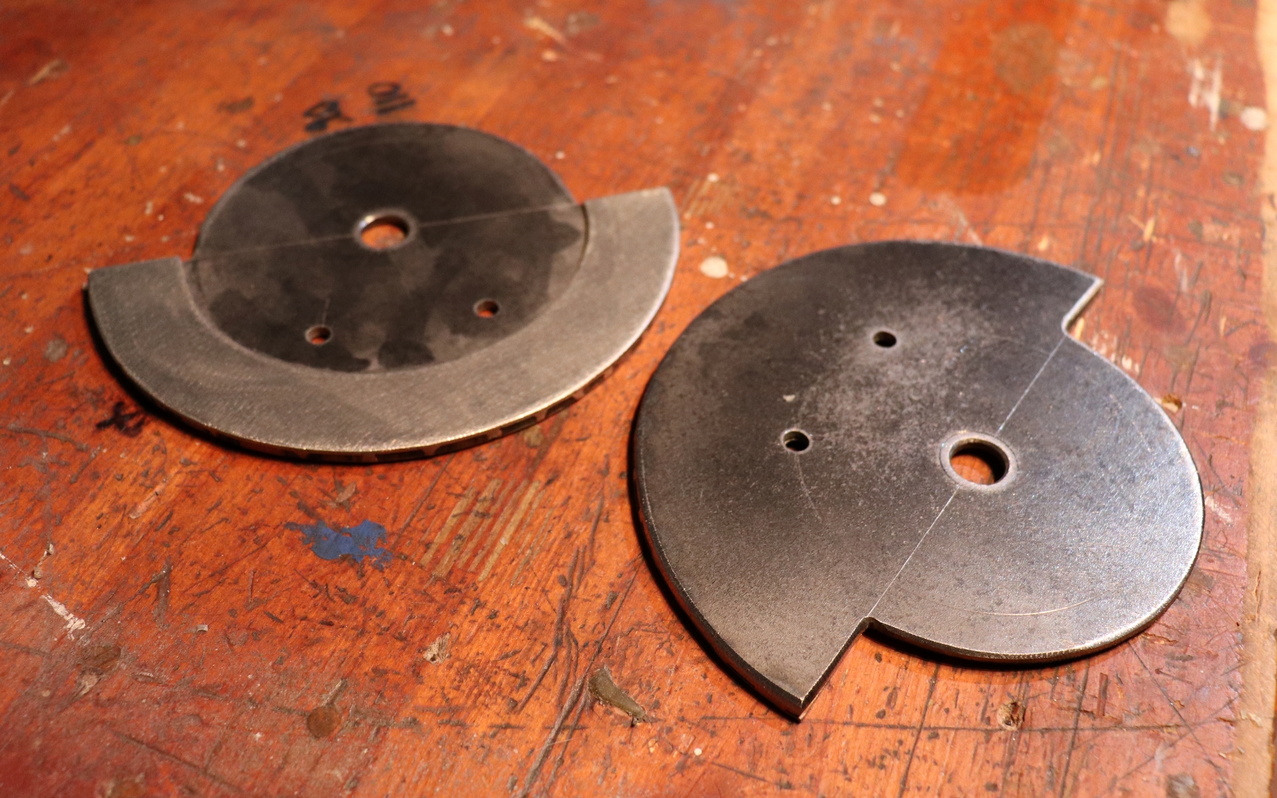

    Because it was easy to re-shape center plate of the die.
    I grinded half of it to 55mm dia. 90 degree bend needs only 180 degree from the die, so now i can use that same die for making bends with two different "slot" depths. (55mm and 60mm dia. / 5mm or 10mm deep slot )
    Homemade manual square tube bender-1.jpg Homemade manual square tube bender-2.jpg

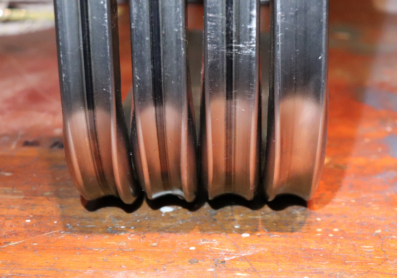

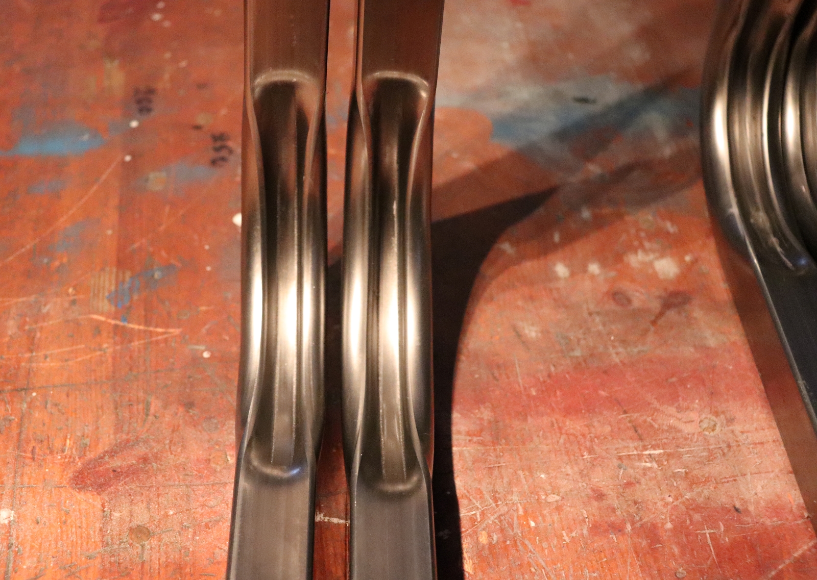

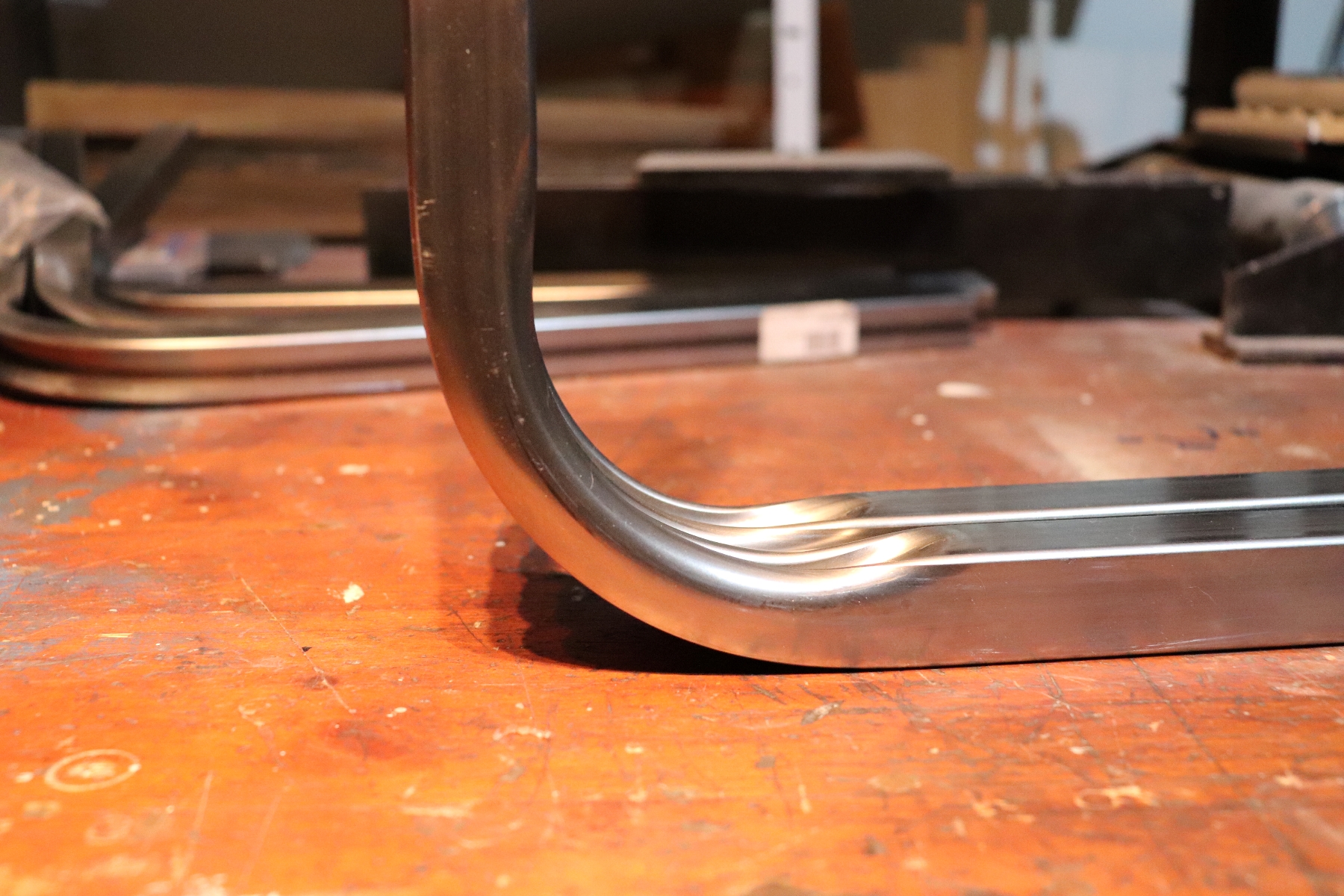

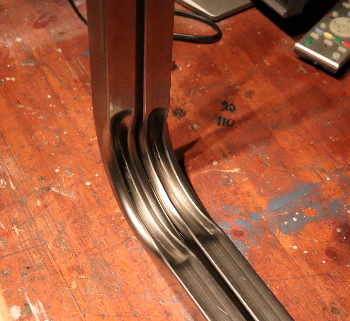

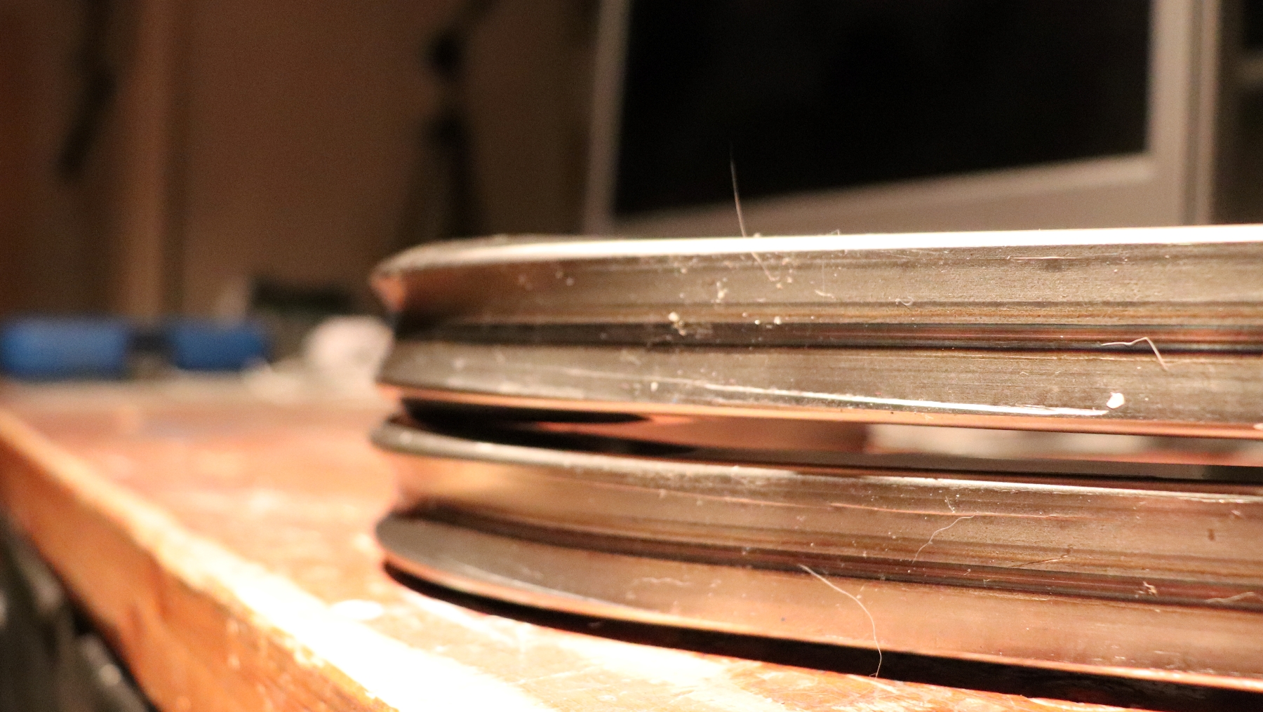

    Comparison:
    Left is with the larger dia / deeper slot.
    Right is with the larger dia / deeper slot. ( my opinion is that right one is little smoother ?)

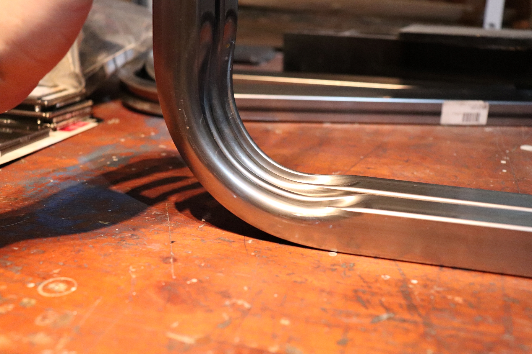

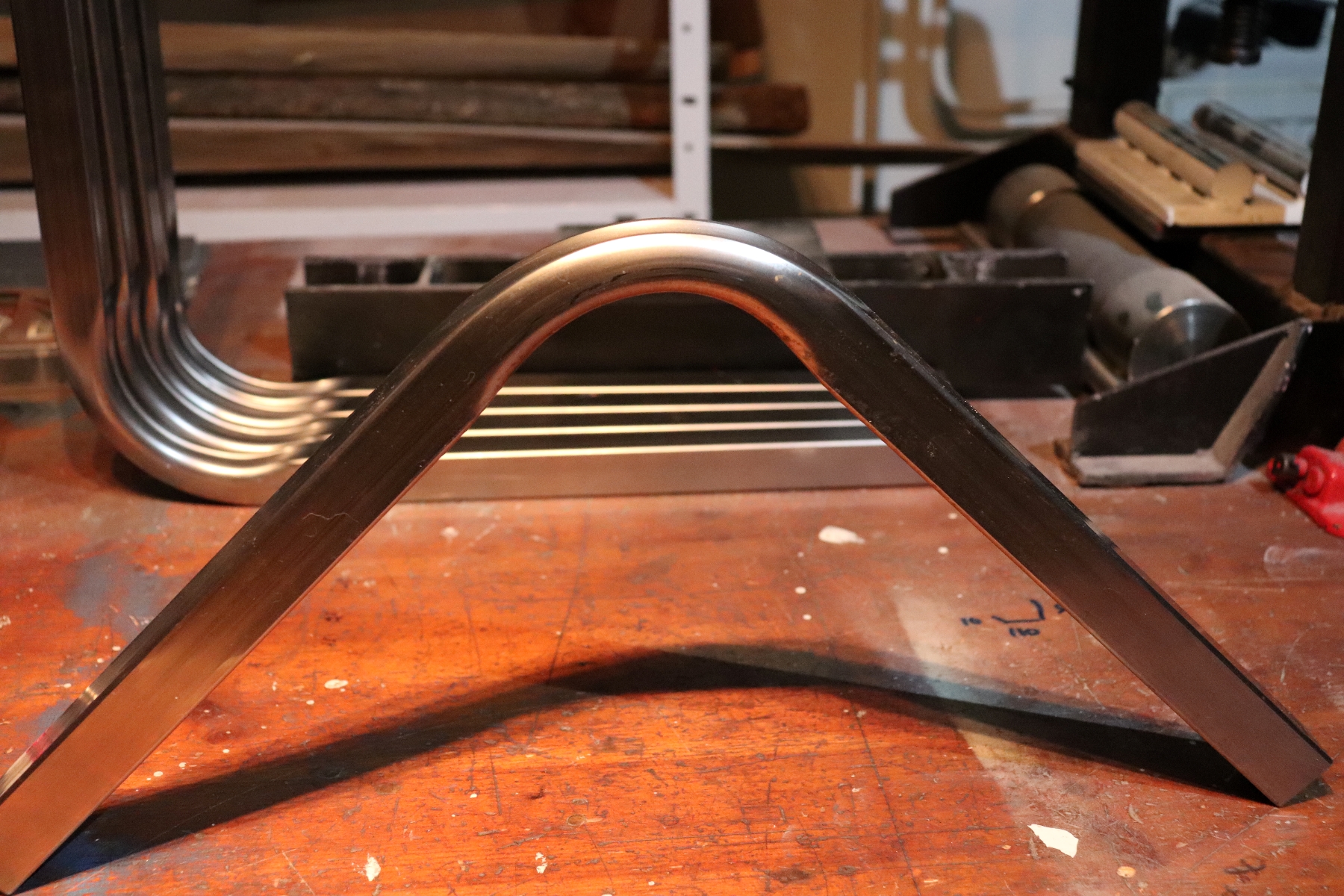

    I failed to get sharp picture from that side. Sorry
    Upper one is with the deeper slot.
    Deeper slot reguires more power to be used during bending, but result is maybe little smoother,
    caliber says that max widht of the bend tube is 30mm ( with 25mm tube).
    When using shallow slot, max widht is 32mm.
    Also it "feels" that bend made with the deeper slot handles more weight before it starts to bend in use.
    ( when used as in shelf bracket for example )
    But i tested that just by pressing and bending them with my hands against the floor, so i can't say for sure.
    So, difference's are somewhat minimal, maybe i'll find out after couple hundreds of bends is there any big difference.
    One thing is sure, that square tube bend like this, handles more weight than mitered and weld joint, before it starts to bend.
    Also bending is much faster procedure, and gives similar results every time.

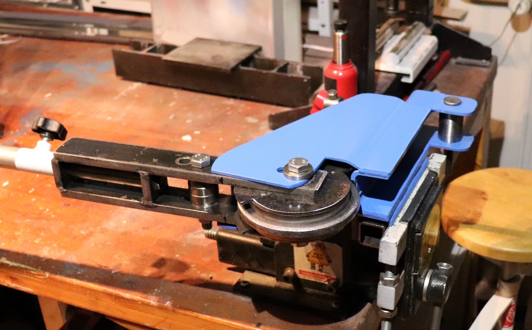

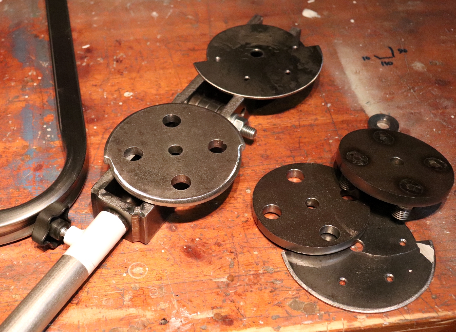

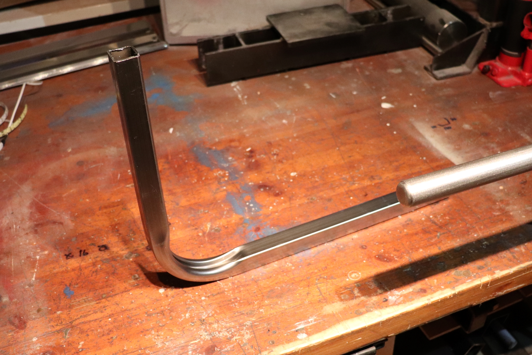

    And here is the final improvements / tests.
    I made another set of " side support plates ".
    Now i used 75mm radius, originally those we're made using 65mm radius.
    Also i welded curves from the 1,5mm plate to the edges, to get gap between supports and tube smaller.
    Now internal widht of the die, when bending 25mm x 25mm ( 1" ) square tubing, is 27mm.
    I made test bends with the new supports using both slot depths, 5mm and 10mm.

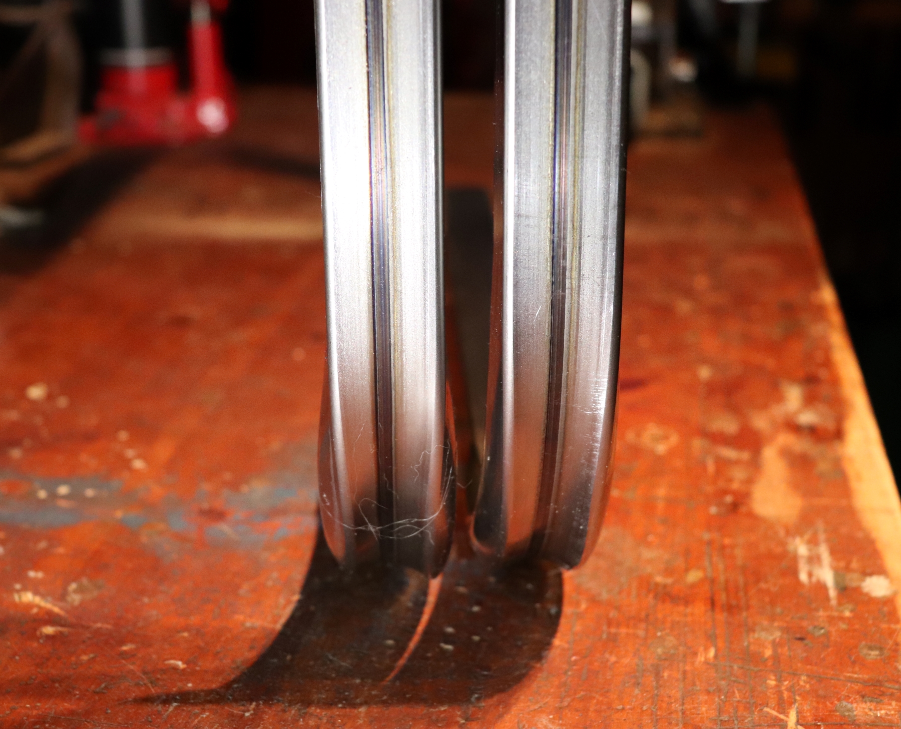

    From the left.
    Shallow slot, with original support plates... Deeper slot with original support plates...
    Shallow slot with new support plates... Deeper slot with new support plates.
    There is no huge difference.
    But deeper slot with new, wider support plates, gives smoother results and stays closer to original dimensions, than others.
    Measured thickness from the radius side is 20mm and widht 27mm, also shape stays similar from the whole bent area.
    Because deeper slots gives best results, here is the comparison between them.
    Left is with the wider support, right is with the original one
    Also, it feels that deeper slot with wider support is also easiest to bend..
    But reason can also be just that i founded better way to use my body for pressing than first times.
    Thanks for checking this out.

    Are you noticing any flex in the side plates or are they staying tight against the center die.
