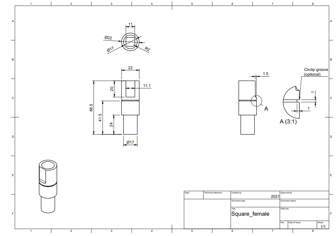

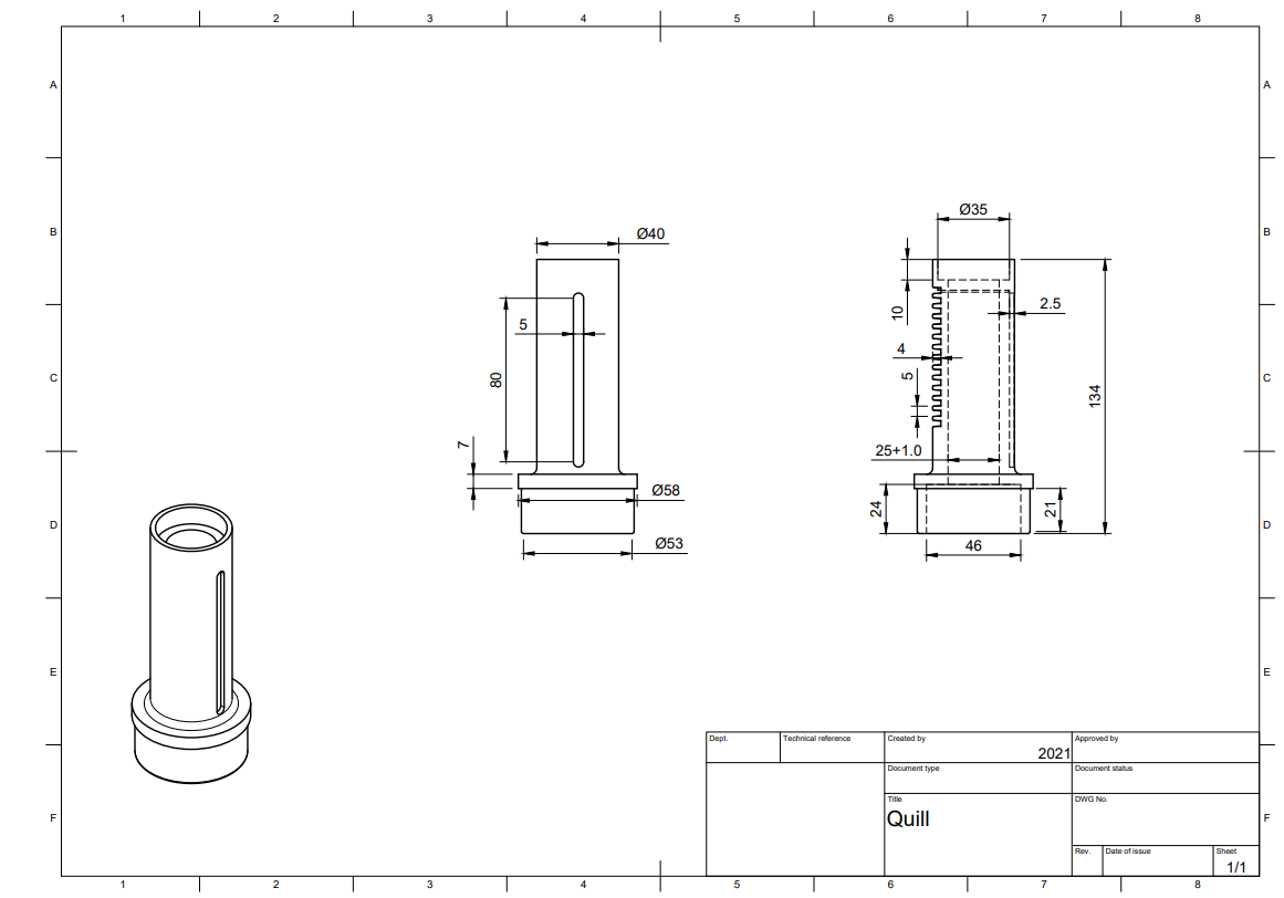

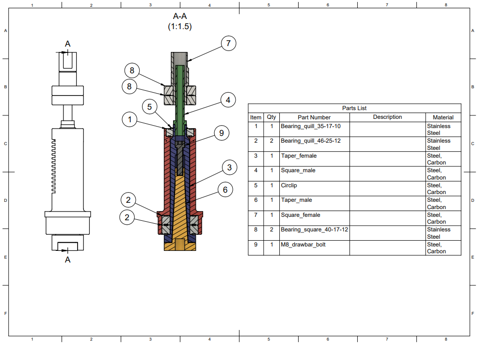

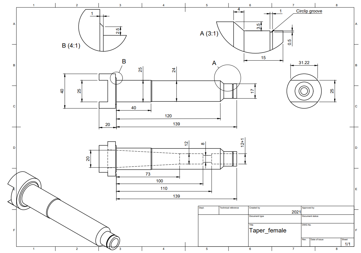

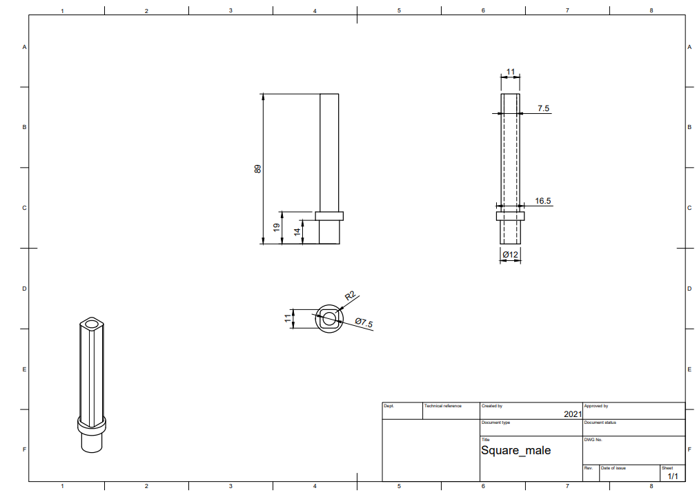

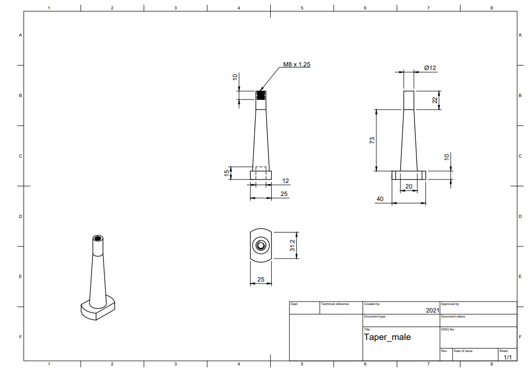

    Homemade milling spindle PLANS
    In this video I show you the plans and CAD-drawings from my homemade milling spindle which can also be downloaded
    Attached Thumbnails Attached Thumbnails Homemade milling spindle PLANS-quill-drawing.png   Homemade milling spindle PLANS-square_female-drawing.png   Homemade milling spindle PLANS-square_male-drawing.png   Homemade milling spindle PLANS-taper_male-drawing.png   Homemade milling spindle PLANS-taper_female-drawing.png

    I have been searching for a design like this for some time. This could be adapted for use as a milling spindle for a small lathe. I have been using a Unimat cartridge spindle but it is limited in vertical travel to about 1”. I want to at least double that to allow for deeper drilling.

    Thanks for the comments! This spindle gives me a vertical travel of aprox. 50mm (2").

    I did put it in a 350W benchdrill from the brand Ferm. Combined with a selfmade milling table it will allow me to do light-duty milling work. I am going to do some small adjustments to make it work with a 500W motor.
