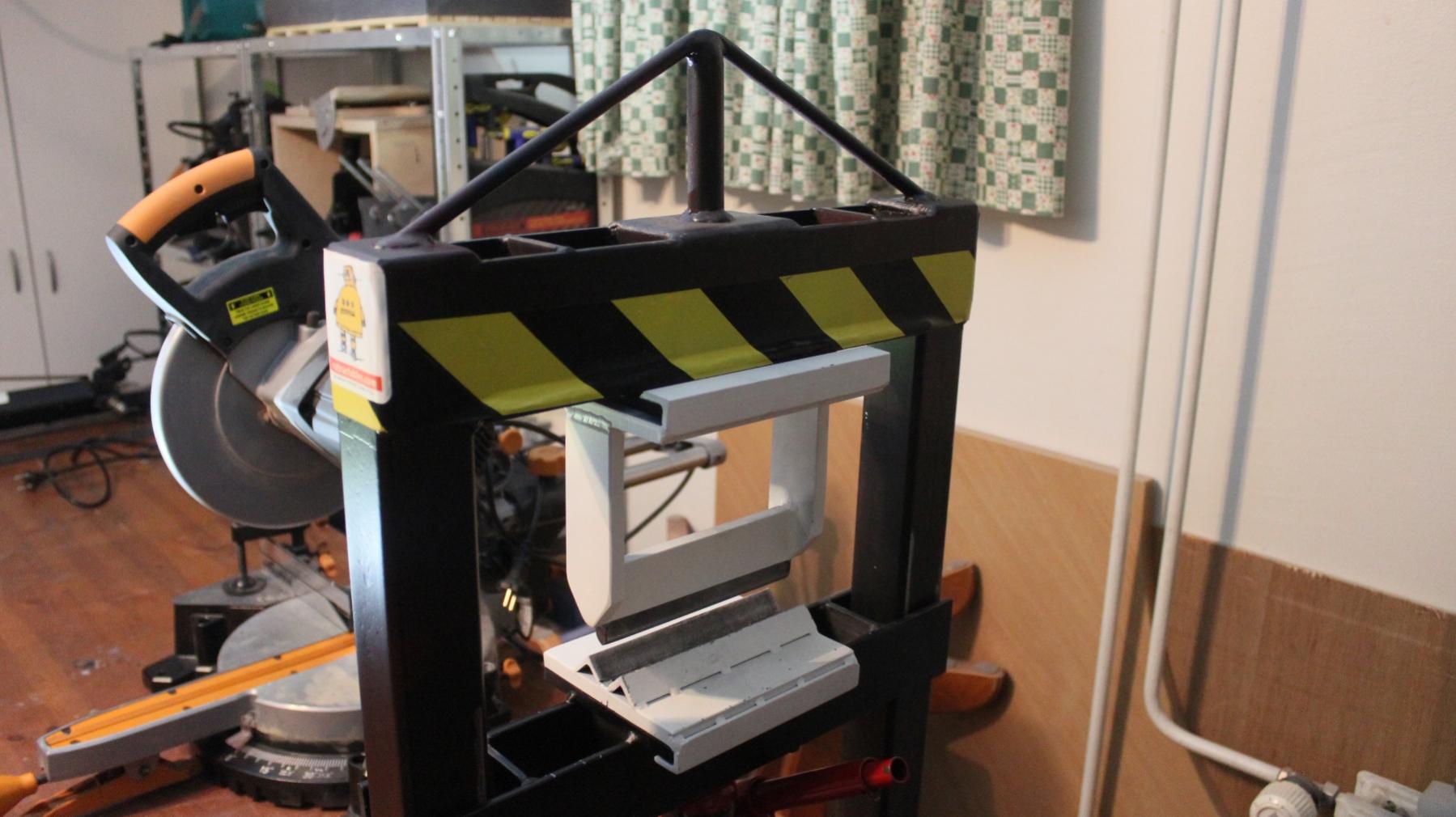

    Made a press.
    Later im going to add brake and rolling possibilities to it, that's why i placed jack down.
    "sled" takes support from the cylinder of the jack, that makes it to travel straight.

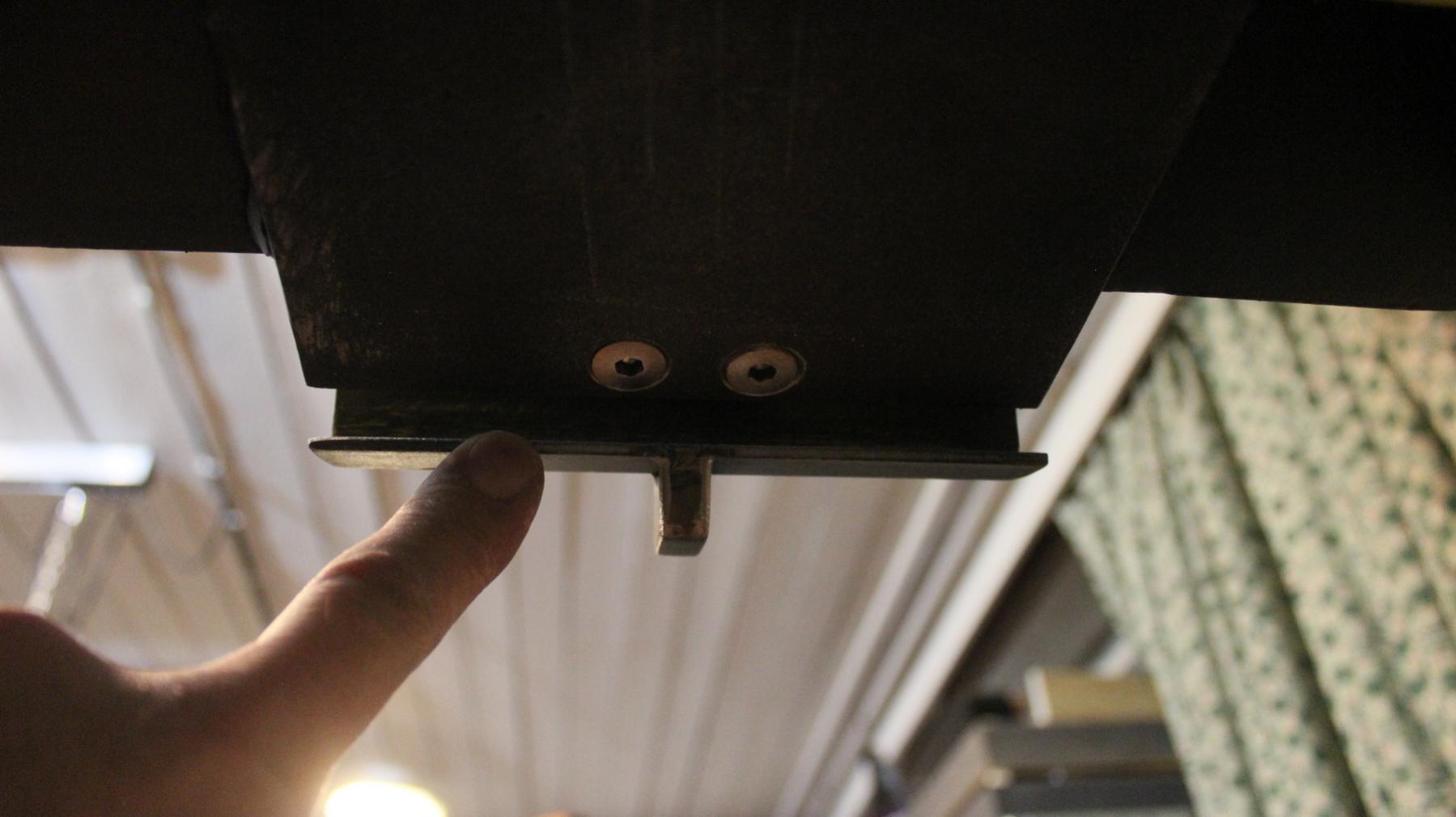

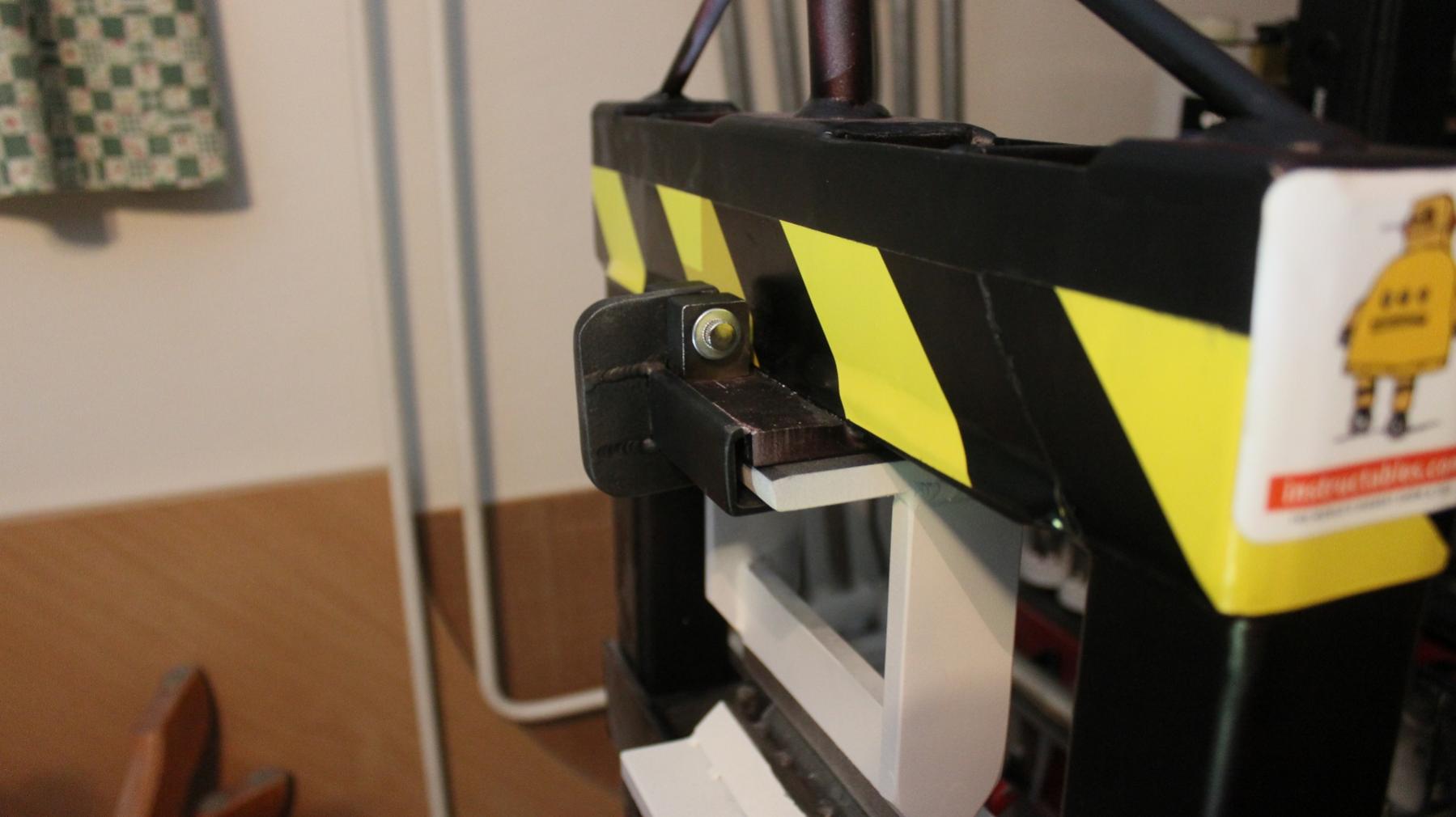

    Latch on the back is bolted to the press frame..

    Bending brake.
    Opening in the blade allows me to bend u-shaped parts.
    Another blade without opening, for thicker materials.
