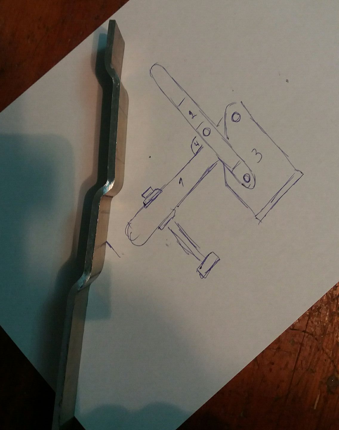

Btw. Made first parts to my "No weld quick action hold down clamps". Brake seems to work just like i hoped.
Attachment 21484

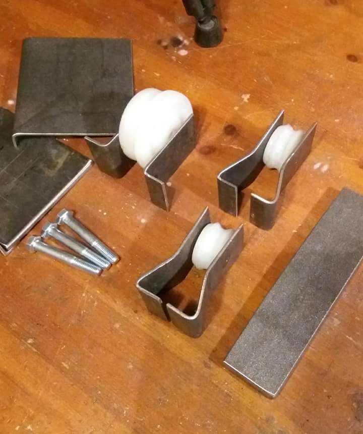

Decided to make simple pipe bending attachment first.
Parts. Video coming little later.

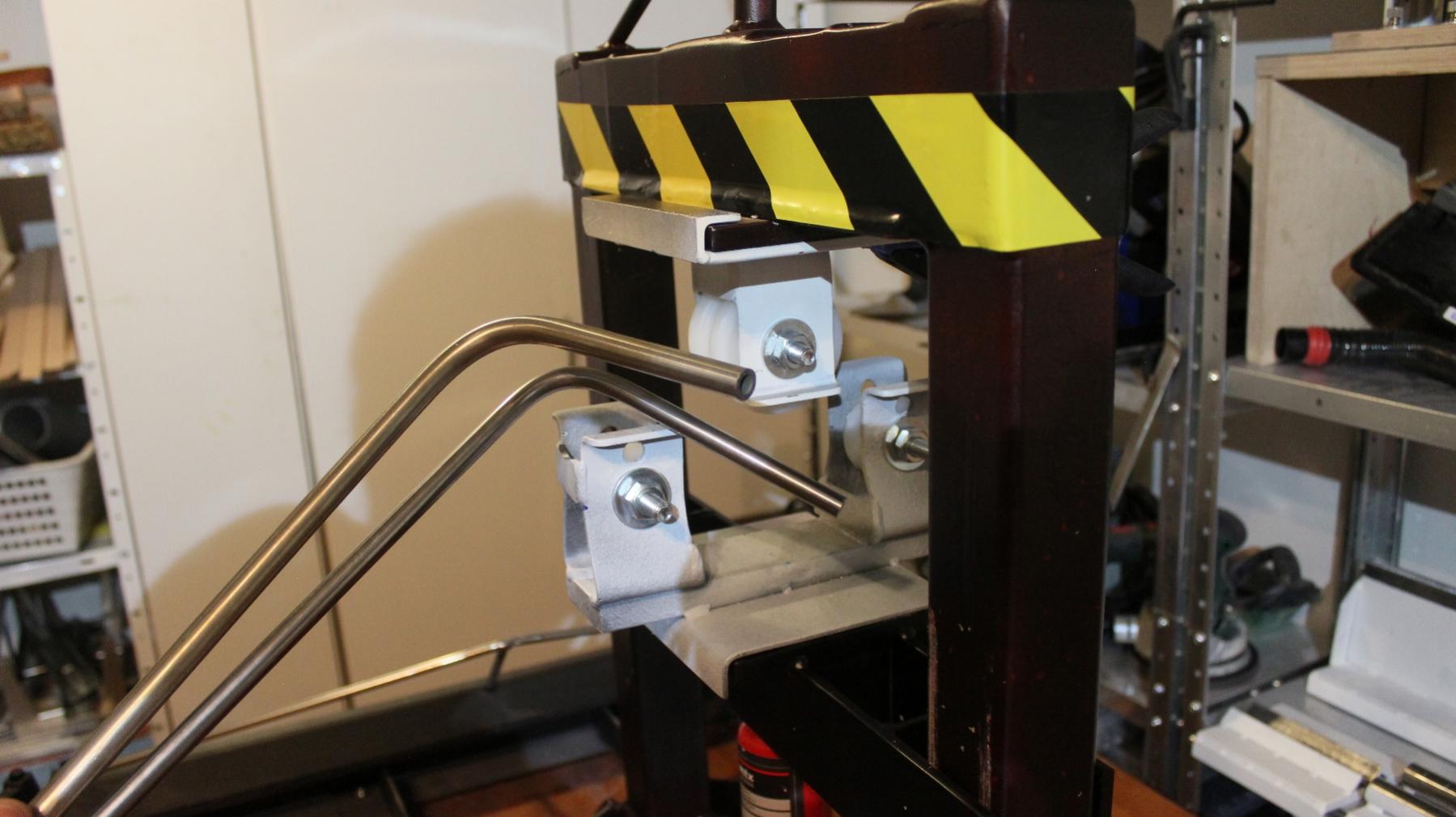

Seems to work nicely.
Attachment 21505
This is for 12mm pipe. And just a prototype.

Simple pipe bending attachment.
Material:
Surplus steel, nylon replacement heads from the dead blow hammer, bolts.
Attachment 21530
https://www.youtube.com/watch?v=TkHh...ature=youtu.be
It can be used to bend pipes and rods to 12mm diameter. ( grooves on the dies are with 12mm diameter )
Same idea works with bigger pipes too, radius of the center die needs to be bigger than this one tough.
