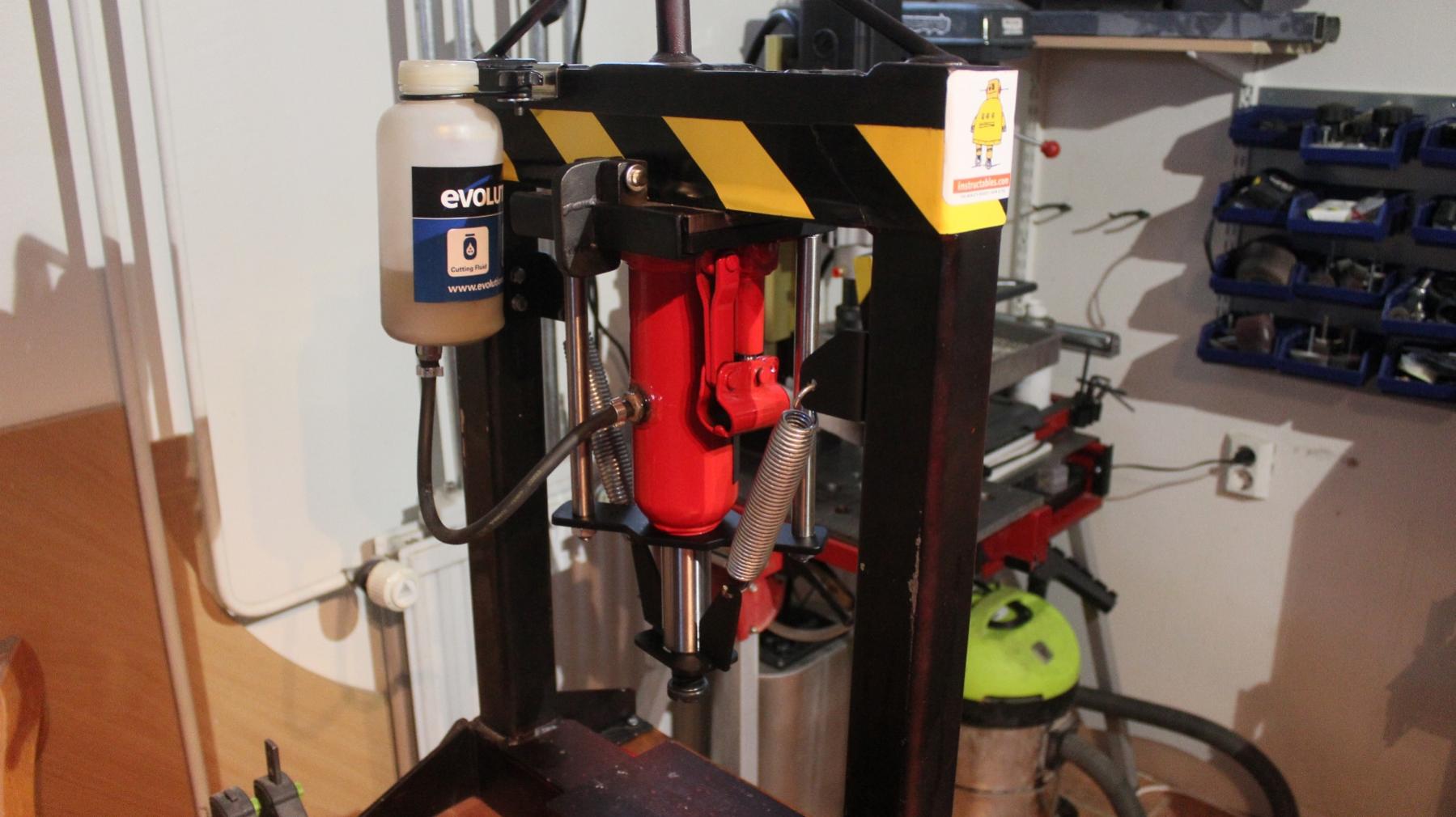

Finger dies.
1,2 and 3" wide dies. Gives somewhat enough possibilities to mix needed widht.
10mm plate with 20mm x 20mm bar on both sides.
Dies are placed between bars and secured with M8 bolts.
Intentionally too long bolts, i like its easier to tighten/ loosen over long bolts with ratched.
Dies are also 10mm plate. Bending edge is grinded to 45 degree angle from both sides and slightly rounded, to avoid deep marks on workpiece.
Attachment 22822
Material is mild steel, and dies medium carbon steel AISI 1029
Made this tool some time ago. Its for drilling to the edges of the plates.
Attachment 22844
I marked placement of the holes before welding. Straightened the baseplate with press after welding.
Then drilled 6.8mm holes
Attachment 22845
Threaded with M8 tap.
Attachment 22846
Cleaned and painted.
Attachment 22847
