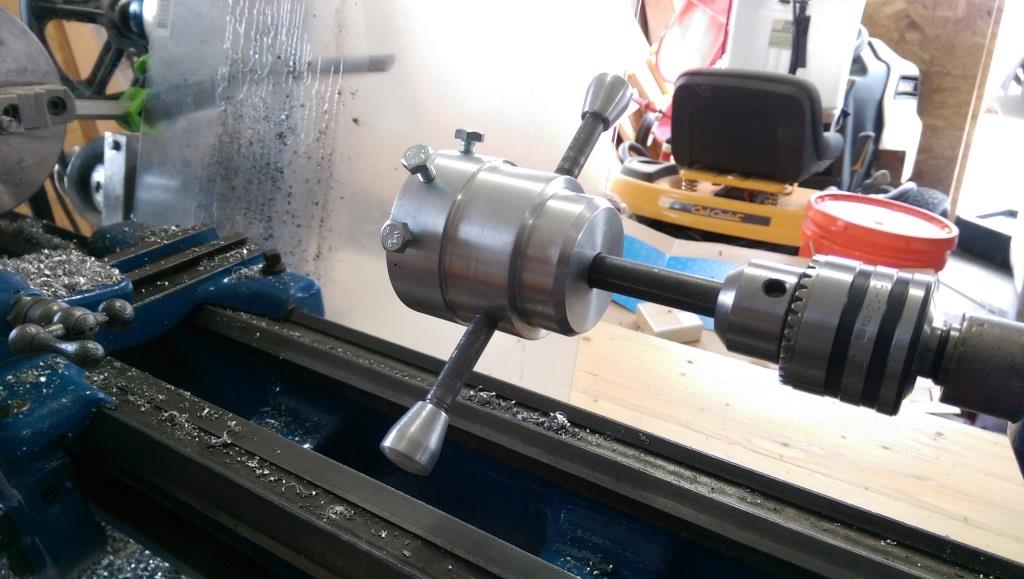

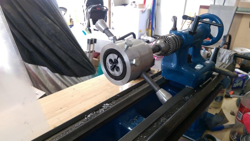

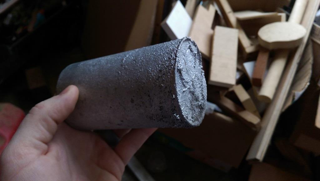

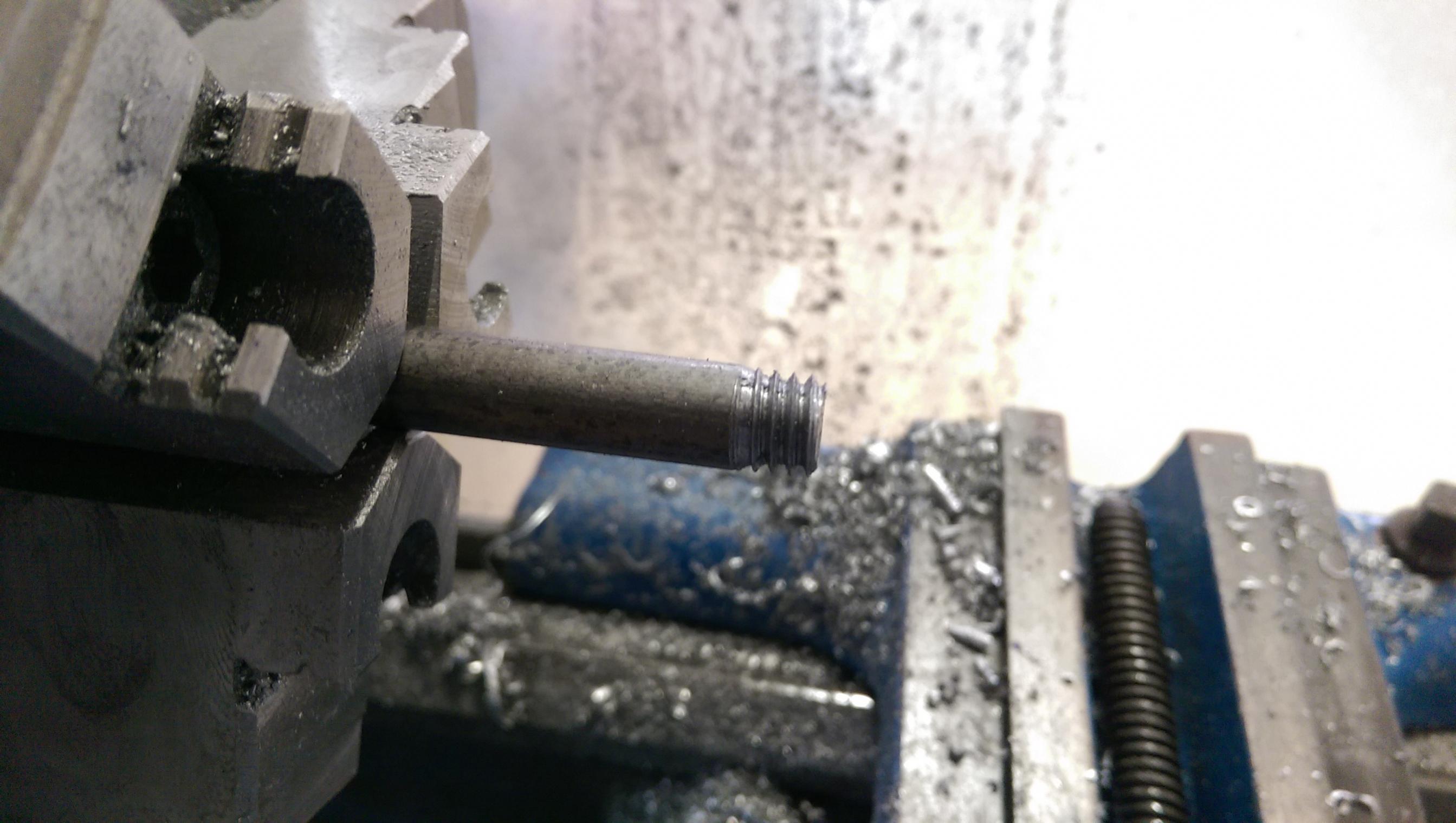

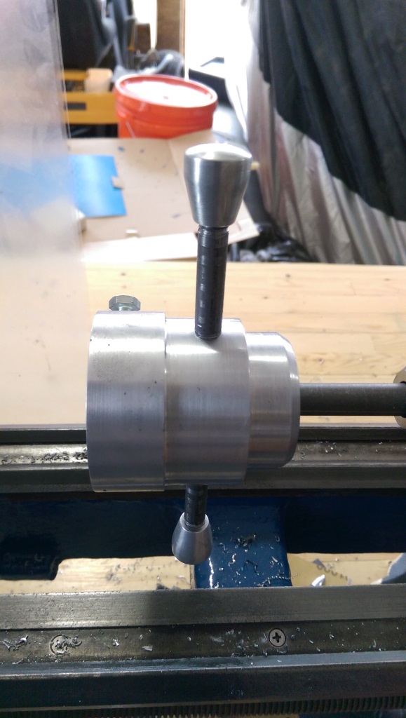

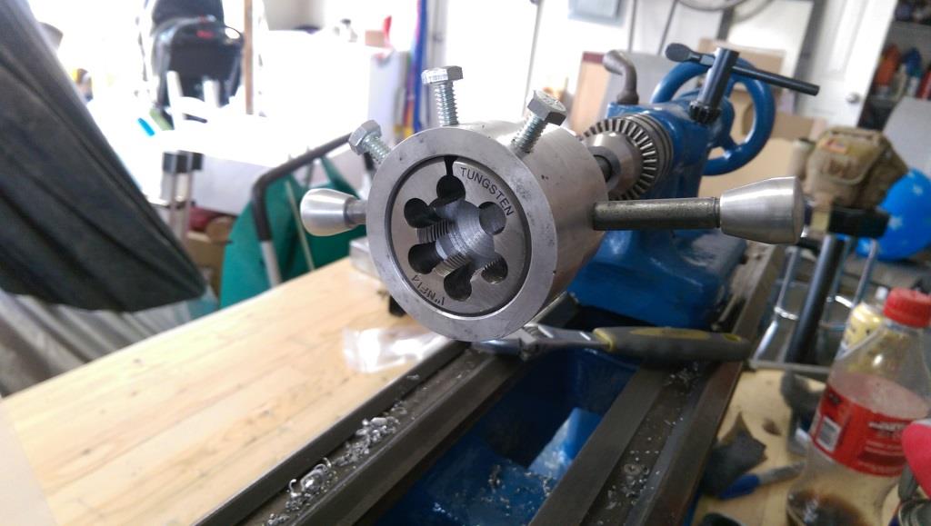

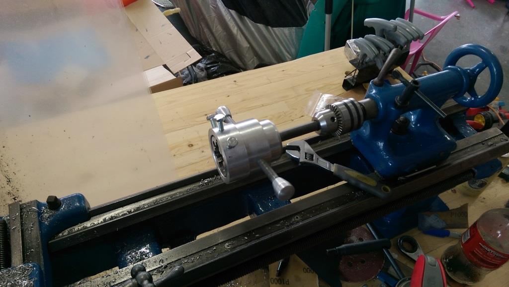

    Guys, this is my tailstock die holder I made over the weekend. It doesn't have the finesse of others I have seen, but it seems to work ok. I started with a cast aluminum blank that I made from scraps. It is counter bored to receive both small and large round dies. It uses the adaptor that came with my tap/die set to hold the smaller dies. The holder slides on a shaft clamped in the drill chuck with handles for hand rotation.

    Looks really impressive, having machined the rough cast aluminum so beautifully I would really have liked to see the handles cleaned up and polished. (Sorry I am being hyper critical) It looks really good. And obviously works well, I am impressed.

    Are all dies the same outside diameter? the three bolts hold tight the die as apposed to centering it.? How do you secure the holder to the lathe? Threaded rod?

    The holder has a 1/2" through hole. It can slide and rotate on the 1/2" shaft clamped in the chuck. To operate, I push the tailstock close to the piece, then slide the die holder against the work piece, and then rotate the holder to begin threading. The holder spins and not the spindle. It works just like a T-handle die holder except it uses the tailstock as a guide to ensure the die travels concentric with the work piece. In theory, I could hold the die holder still and power the spindle for small pieces, but I haven't tried that yet.

    Quote Originally Posted by mr95gst View Post
    Bartw,
    If you do, be sure to remove those handles and substitute recessed setscrews for the screws holding the die. If you don't and it hangs up you'll have a first rate knuckle smasher.
    Folks do what you suggest but with a dead smooth die holder. Fed by hand, all you need do when it hangs up or reaches the shoulder is release it and let it spin on the TS support bar. But, if it has any protuberances, watch out!
    Regards, Marv

    Bartw Dies are generally 2" 1.5" and 1" in diameter or they are 1" and 1.5" hex. Hex dies are most usually for re-threading or chasing the threads
    the 3 bolt system was developed to both hold the die and the pointed center bolt of the 3 can be used to gently spread a die ever so slightly to allow a thread to be a thou. or 2 larger in diameter to achieve a tighter fit as in a tapped blind hole and stud assembly.
    Converse to this in better quality dies there will be a small slotted adjustment screw which limits the amount a die may be compressed.
    I in the past have backed those screws out just a tad on some of my older worn dies trying to extend their life usability

    I have always use the tail stock to hold my die holder square to the spindle and rotate the spindle by hand whilst supporting the handle of the die holder against a bar located in the tool holder, this allows me to have my right hand free to keep pressure on the die whilst rotating the spindle with my left hand, once the threaded section of the spindle comes through the die I support it with a live centre in the tail stock. I tend to power the spindle in reverse in order to back off the die from the threaded section on the spindle, if you want to cut the thread by powering the spindle make sure you have a hand on the clutch lever in case the spindle locks up on the die.
    Good luck, your die holder still looks great.
