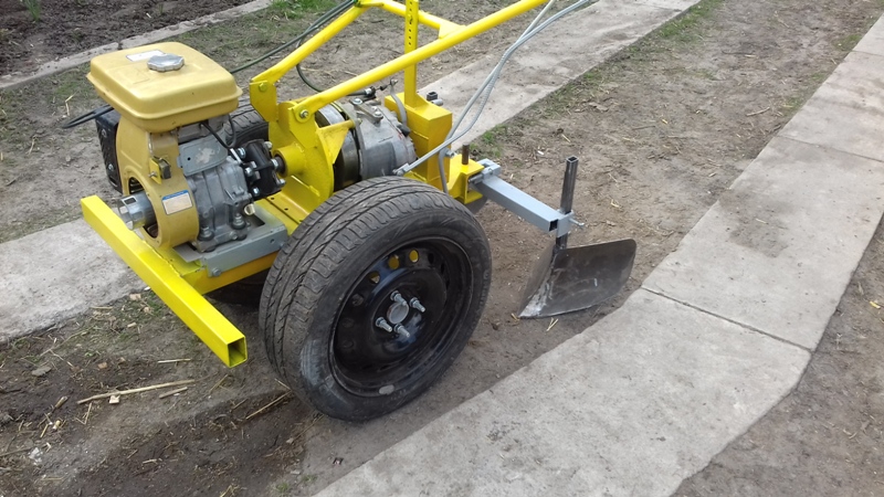

Excellent work as usual sir! Congratulations on a job well done. Do I see a Ural transmission? Bob from 🇨🇦
I only see 1 one thing I might comment on and this is just from a personal perspective having ran 2 wheeled tractors in the past that nearly ran me down.
the reverse gear if possible should be made so that in order to back up the clutch should be designed so that you must hold it engaged.
This is quite bothersome to have to constantly hold a clutch in forward position but when reversing it is a matter of safety a linkage could be made to over center in the forward position to allow constant engagement but would not over center in reverse this also would mean a strong enough spring to hold the clutch disengaged would be need in the linkage
Just an observation not a criticism you have built an amazing little tractor just like all of your other projects.

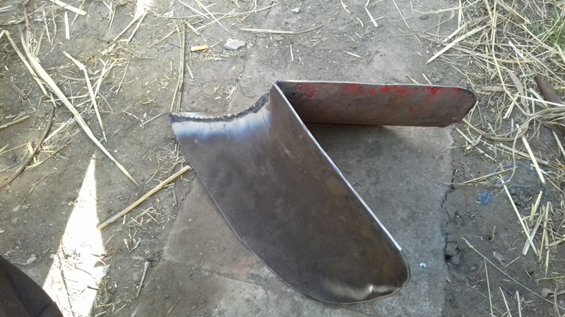

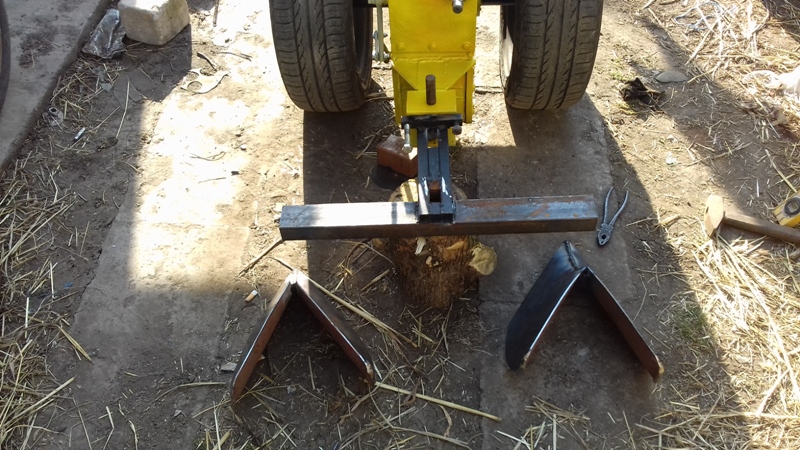

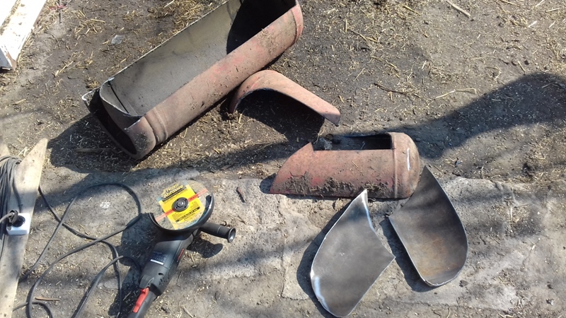

Making a plow from an old propane balloon
Attachment 29140 Attachment 29141 Attachment 29142Attachment 29143

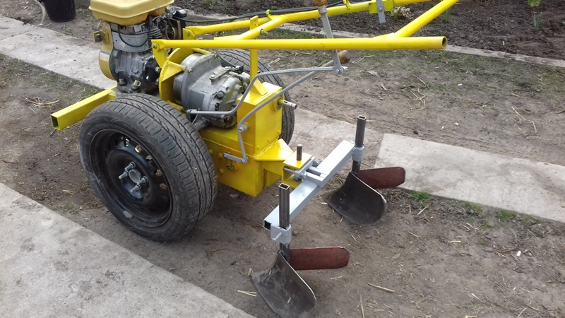

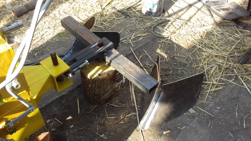

Soon the first tests
Attachment 29190 Attachment 29191
