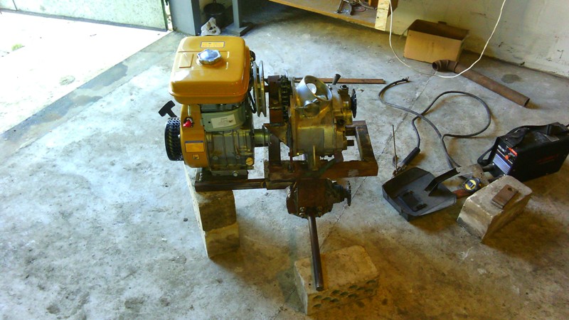

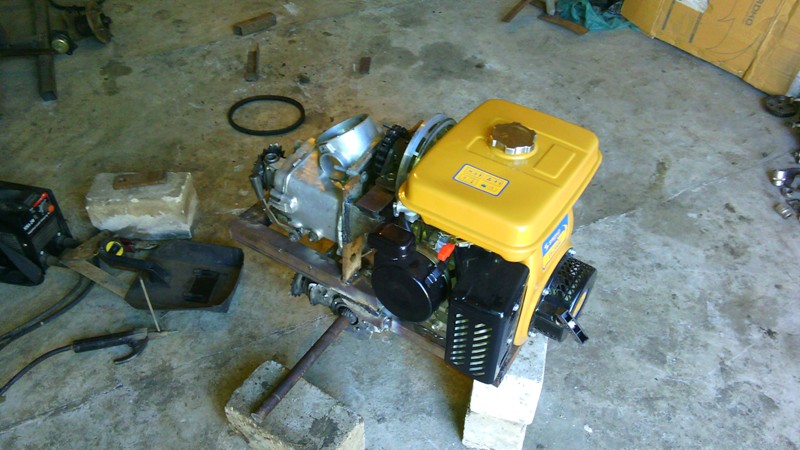

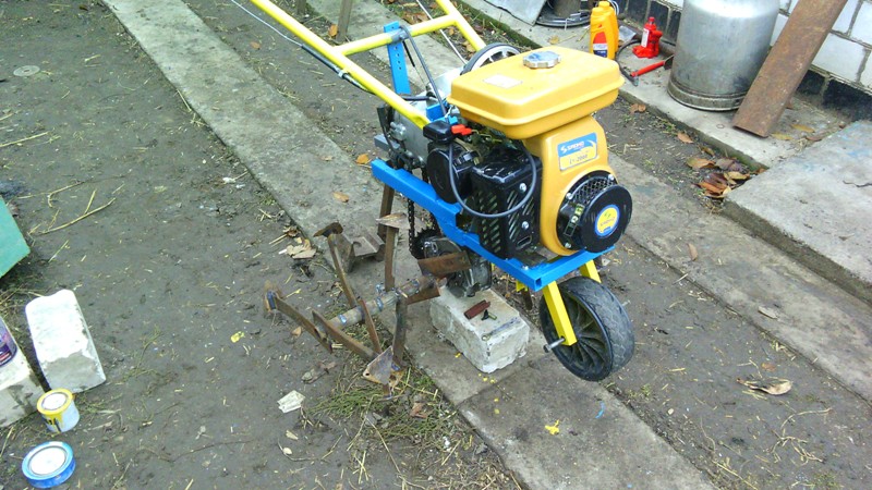

Hi. Fashioned Assistant to work in the garden and on the land. Transmission and gearbox of the motorcycle "Dnepr".
Attachment 9077

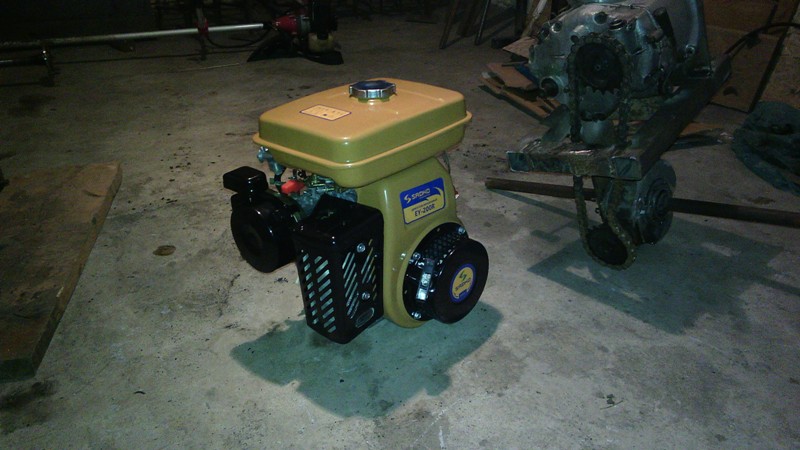

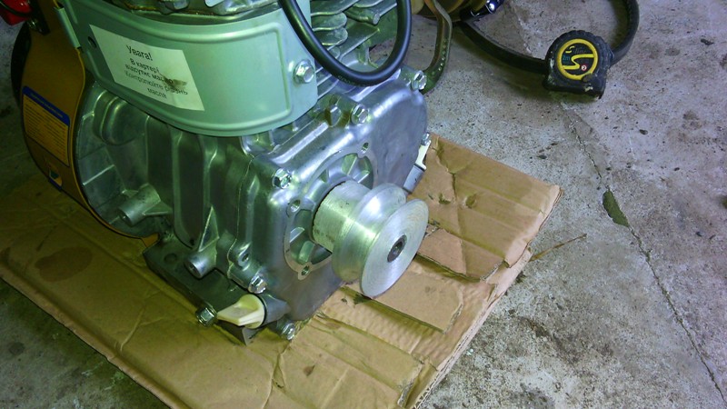

Chinese gasoline engine has 180 cubic centimeters and 5 horsepower. Other parts scrap it.
Attachment 9078
Attachment 9077
Attachment 9078

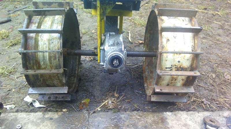

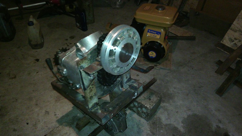

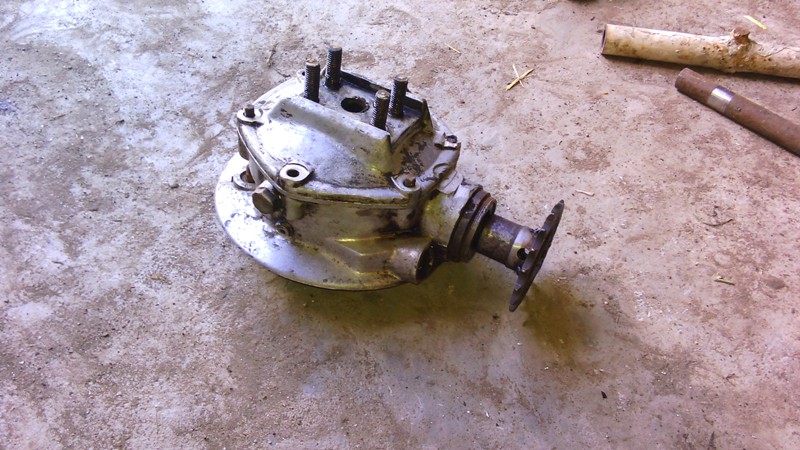

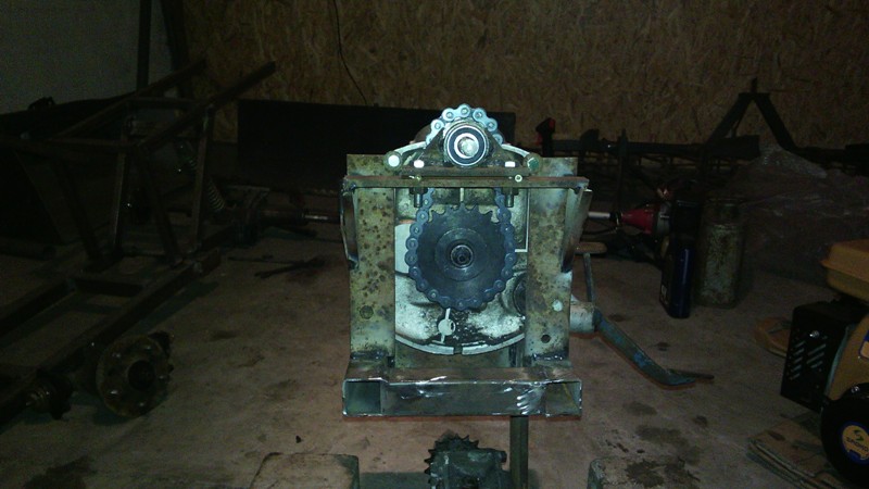

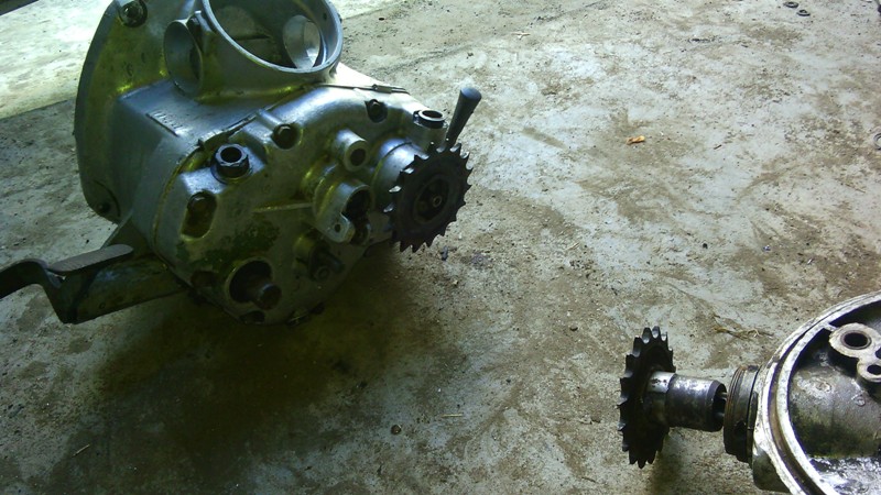

This gearbox and transmission of the motorcycle.
Attachment 9079 Attachment 9080

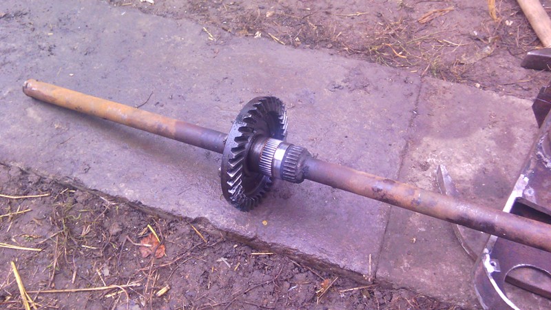

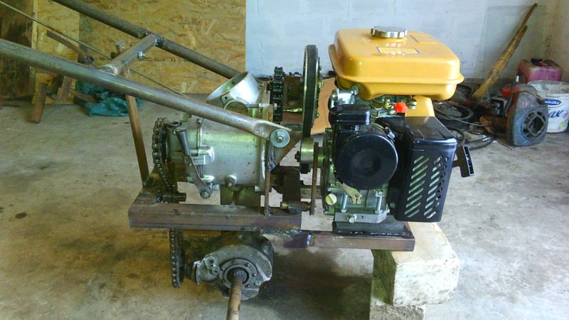

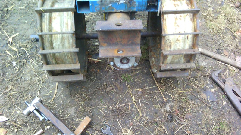

In reducer gears on a lathe was made hole and welded axle.
Attachment 9081

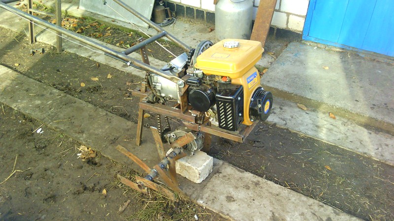

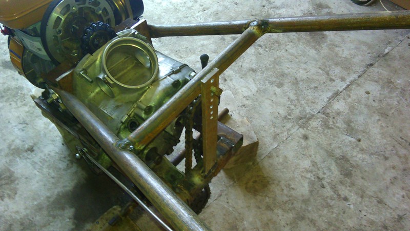

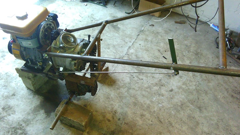

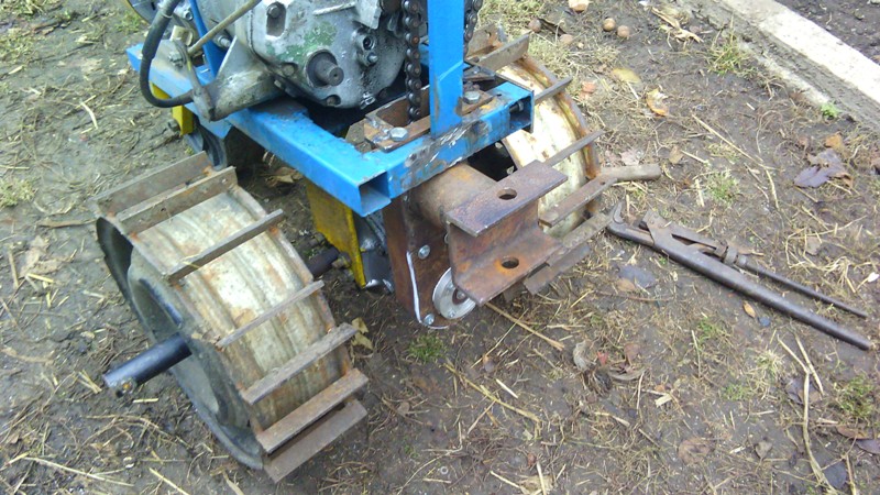

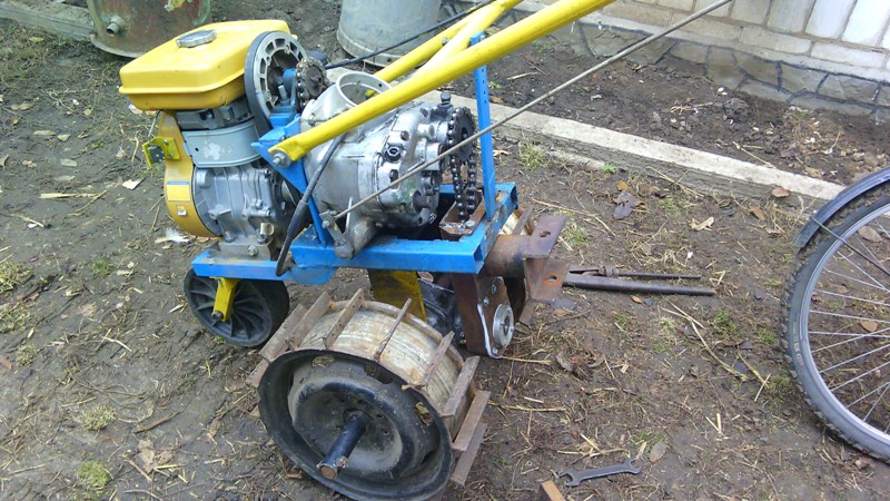

The frame is welded from profile pipes 40x40 and 20x30.
Attachment 9082 Attachment 9083Attachment 9084 Attachment 9085 Attachment 9086

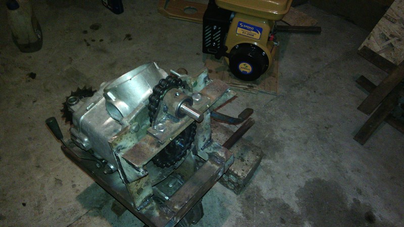

The drive from the engine belt. The total reduction between the engine and gearbox 4.2.
Attachment 9087 Attachment 9088 Attachment 9089

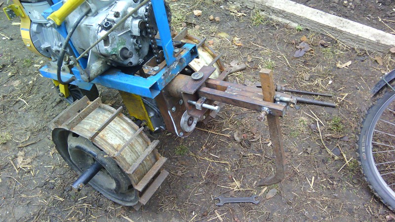

During cultivation plow is used as a brake.
Attachment 9101 Attachment 9102 Attachment 9103 Attachment 9104

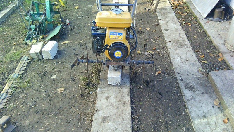

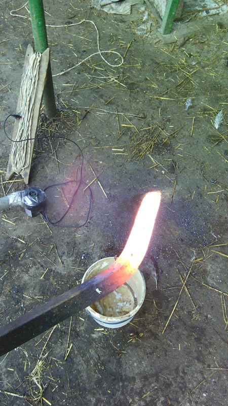

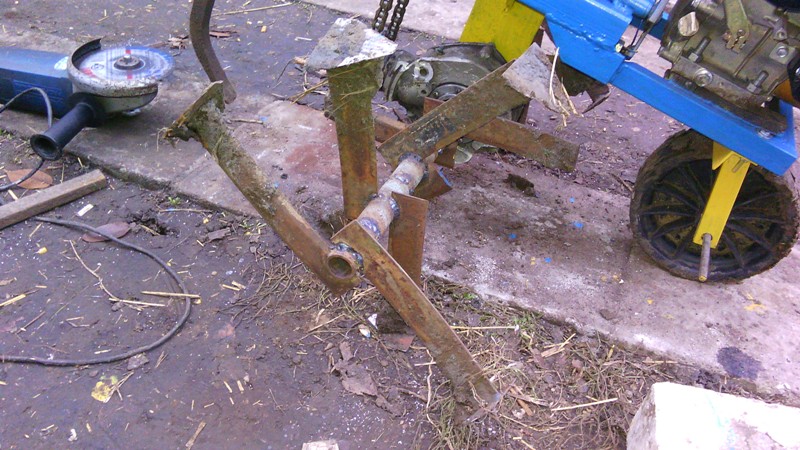

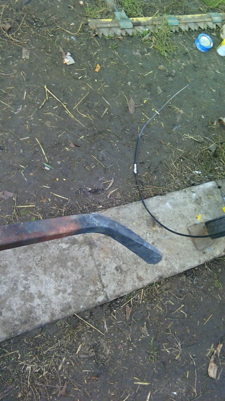

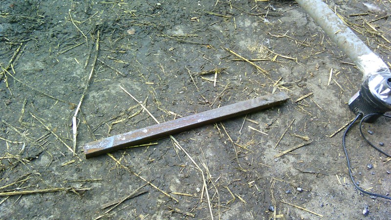

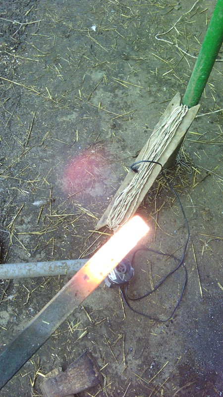

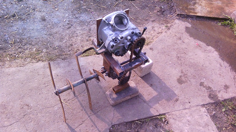

Knives for cultivation are made of car springs
Attachment 9105
It looks axis
Attachment 9106

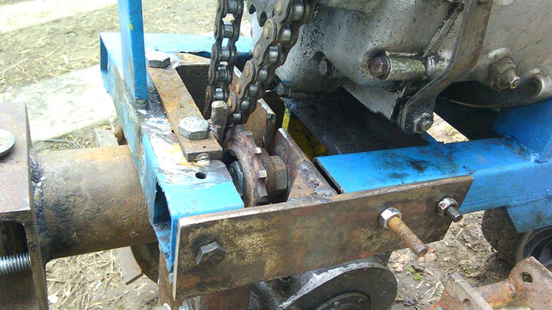

chain Tensioner
Attachment 9107

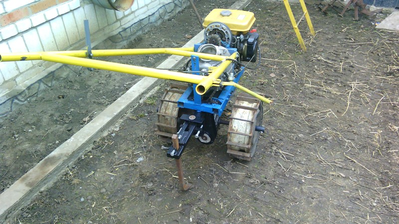

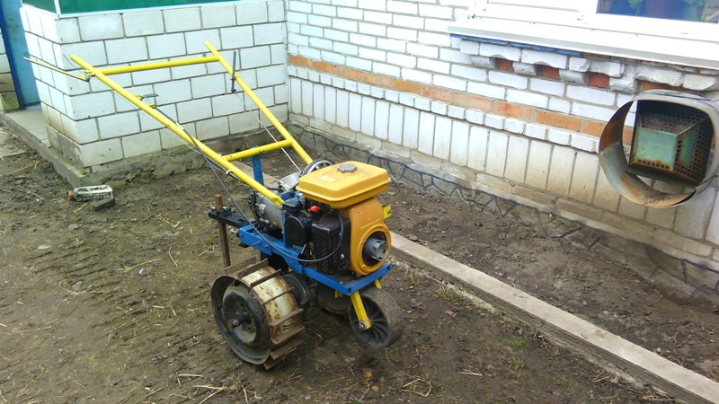

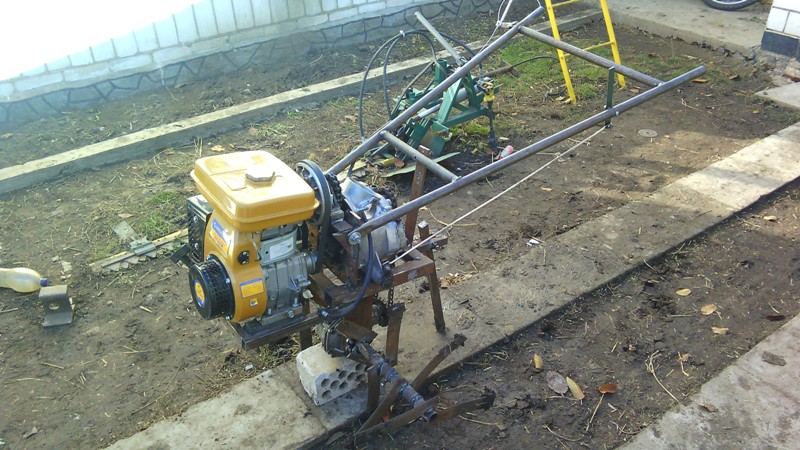

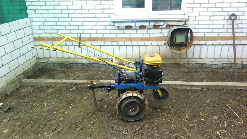

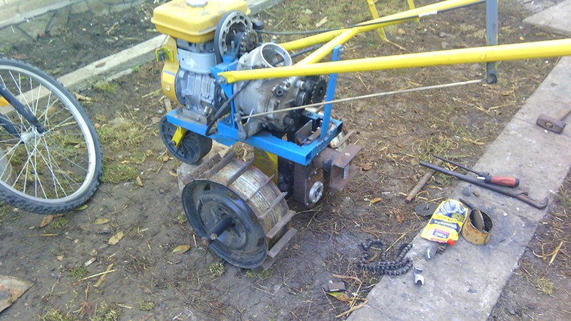

The finished product looks like.
Attachment 9113 Attachment 9114 Attachment 9115
walk-behind tractor will be used for cultivations, planting and digging potatoes and other work on the farm.
