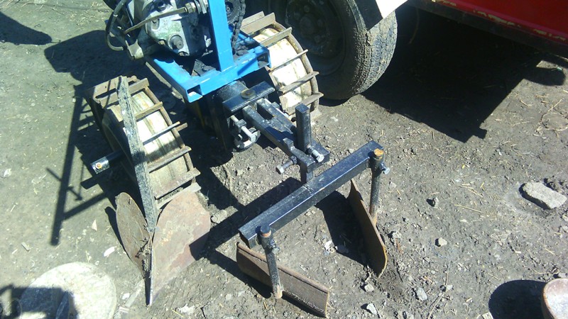

Characteristics walk-behing tractor
In 3600 rev/min engine to the wheels R12
* 1 - 5.4 km/h
* 2 - 8.6 km/h
* 3 - 11.5 km/h
* 4 - 15.1 km/h
* R - 5.3 km/h
Cultivation
* 1 - 51 rev/min
* 2 - 81 rev/min
* 3 - 112 rev/min
* 4 - 144 rev/min

Produced equipment for planting potatoes.
Attachment 10031
