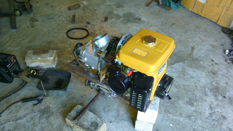

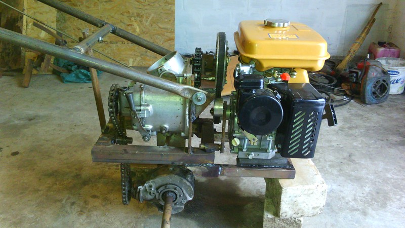

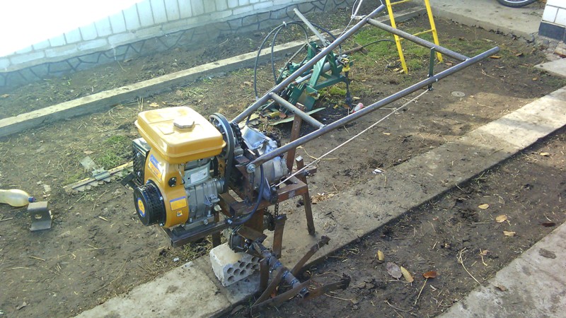

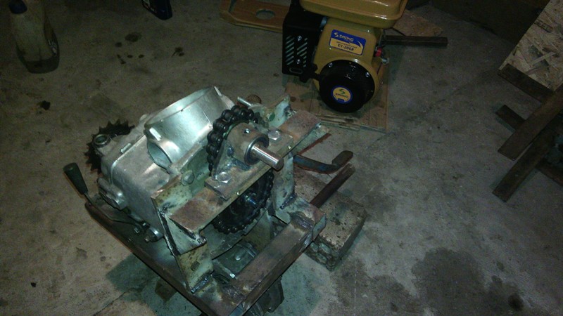

    Hi. Fashioned Assistant to work in the garden and on the land. Transmission and gearbox of the motorcycle "Dnepr".

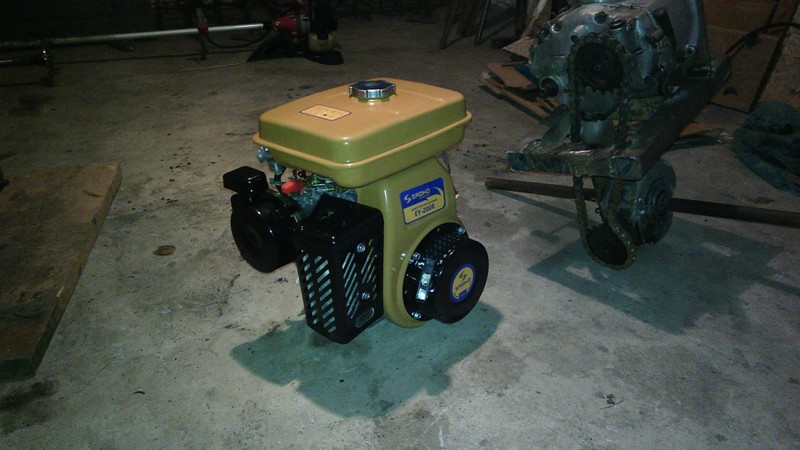

    Chinese gasoline engine has 180 cubic centimeters and 5 horsepower. Other parts scrap it.

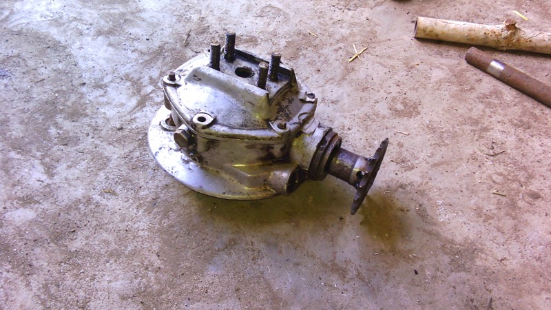

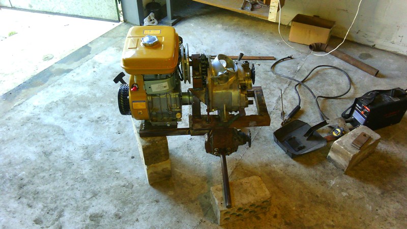

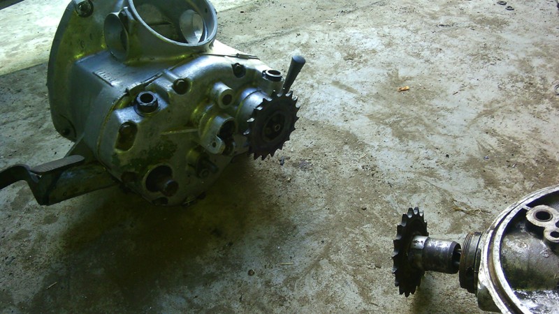

    This gearbox and transmission of the motorcycle.
    Homemade walk-behind tractor-img_20140818_123712.jpg Homemade walk-behind tractor-img_20140818_140353.jpg

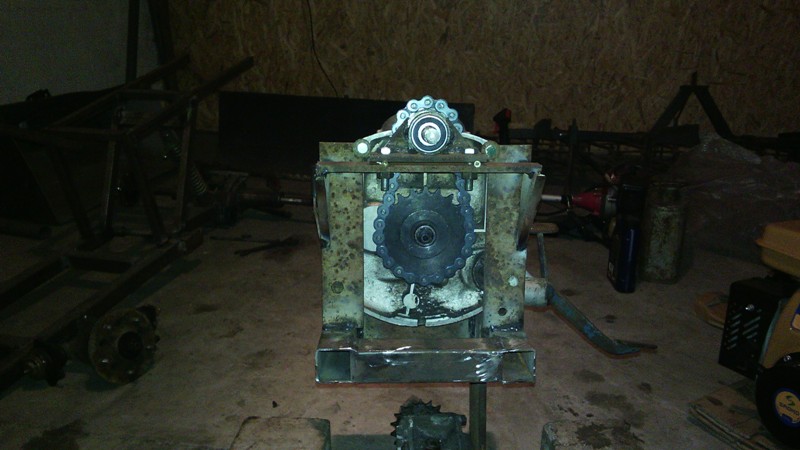

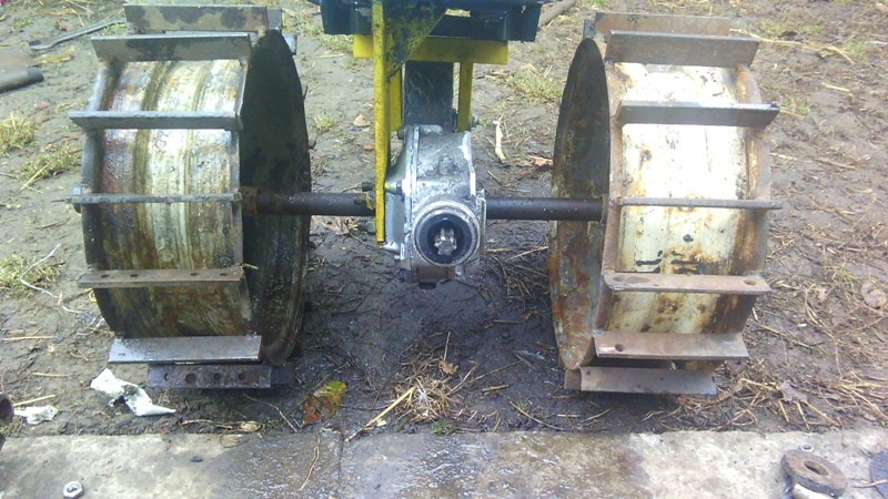

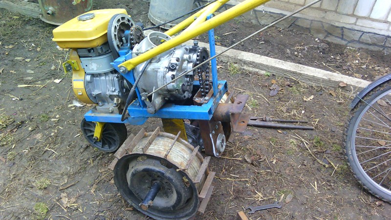

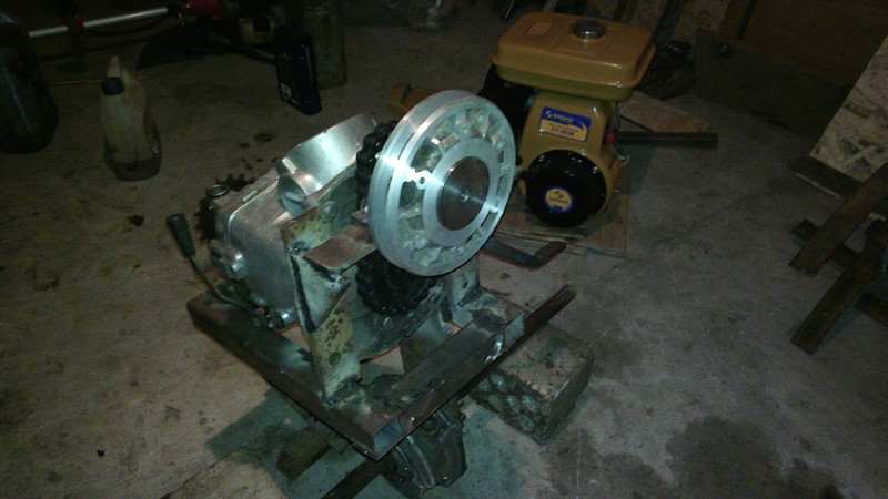

    In reducer gears on a lathe was made hole and welded axle.

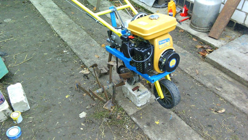

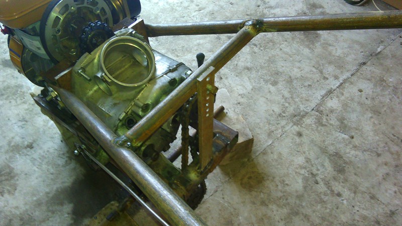

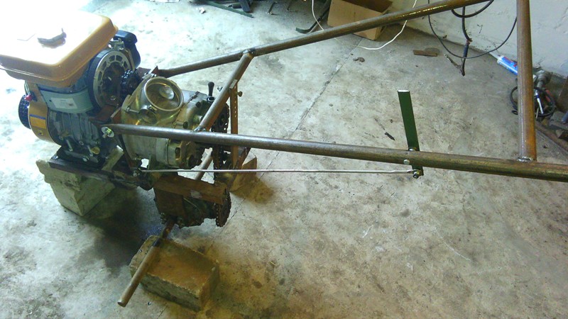

    The frame is welded from profile pipes 40x40 and 20x30.
    Homemade walk-behind tractor-img_20140930_160946.jpg Homemade walk-behind tractor-img_20141018_193514.jpgHomemade walk-behind tractor-img_20141018_193546.jpg Homemade walk-behind tractor-img_20141018_193623.jpg Homemade walk-behind tractor-img_20141017_142207.jpg

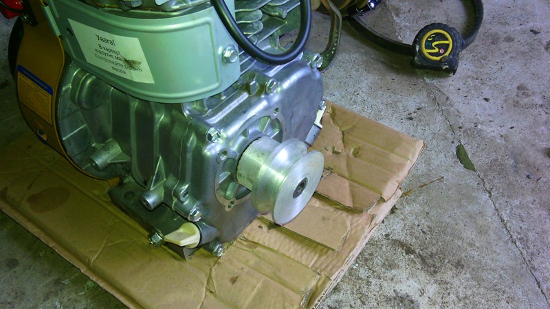

    The drive from the engine belt. The total reduction between the engine and gearbox 4.2.

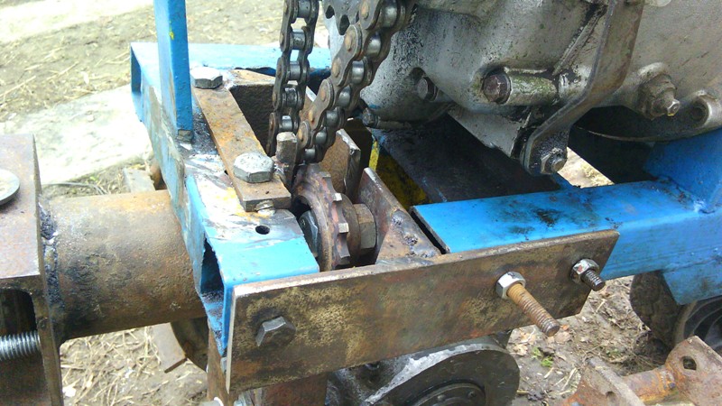

    Coupling off tension straps.
    Homemade walk-behind tractor-img_20141024_110704.jpg Homemade walk-behind tractor-img_20141104_122719.jpg Homemade walk-behind tractor-img_20141104_122731.jpg Homemade walk-behind tractor-img_20141104_122755.jpg Homemade walk-behind tractor-img_20141107_160226.jpg

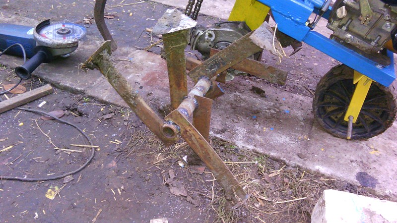

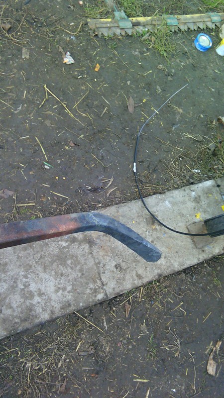

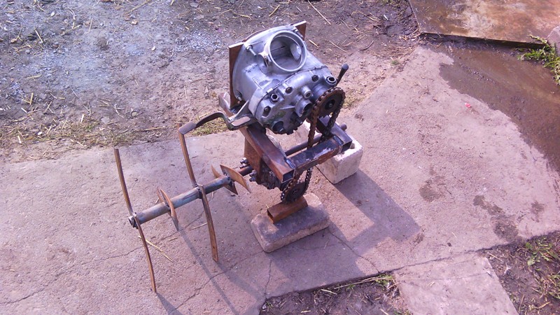

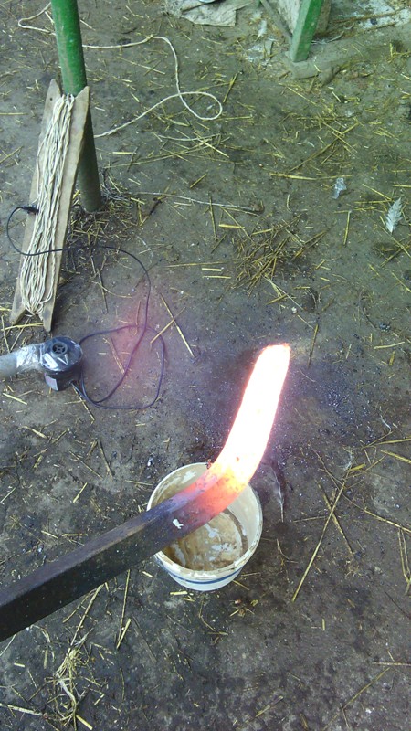

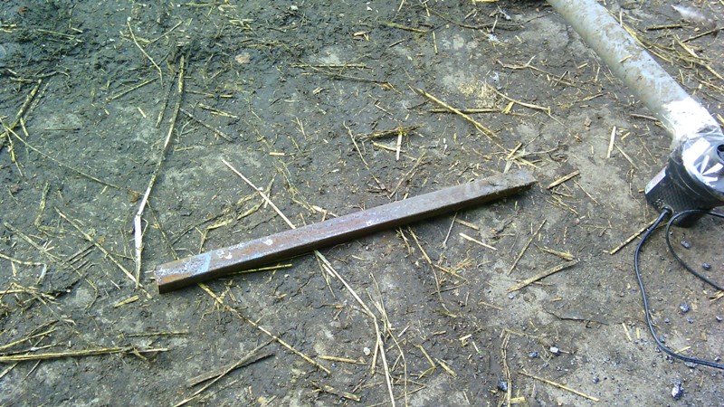

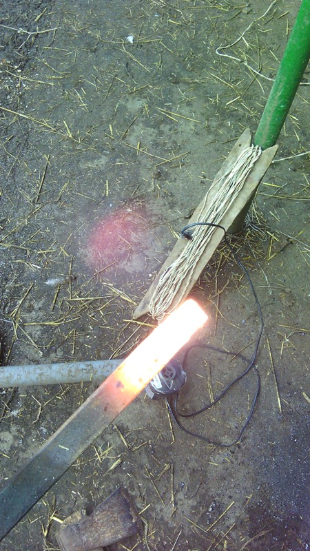

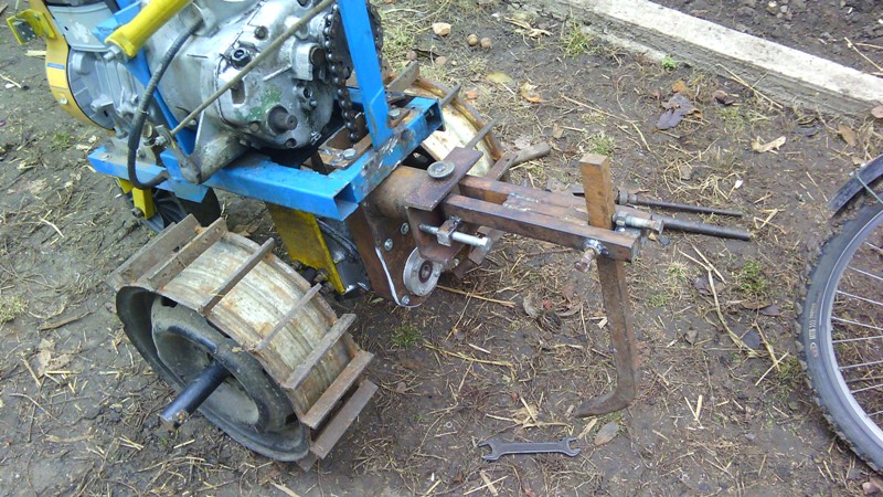

    Knives for cultivation are made of car springs

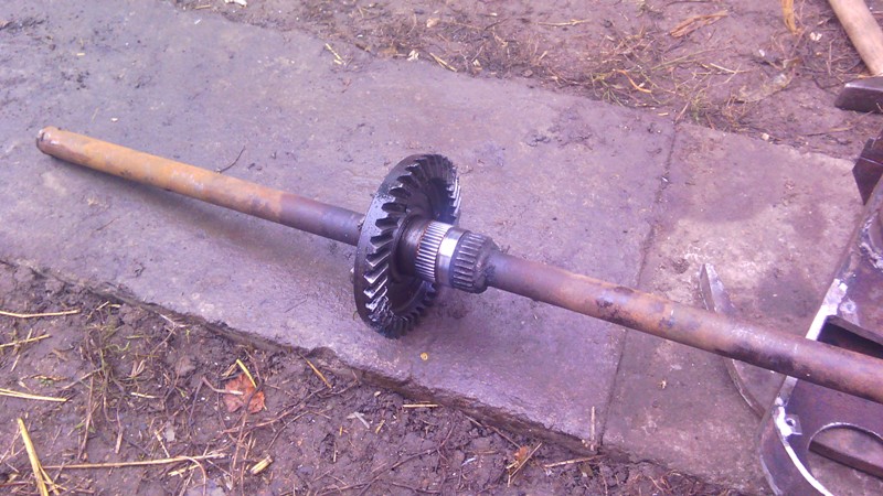

    It looks axis
    chain Tensioner
    In order to during cultivation, dirt does not fall on the circuit I made protection.
    Homemade walk-behind tractor-img_20151104_082653.jpg Homemade walk-behind tractor-img_20151107_140836.jpg Homemade walk-behind tractor-img_20151107_140852.jpg Homemade walk-behind tractor-img_20151107_140944.jpg Homemade walk-behind tractor-img_20151107_141019.jpg

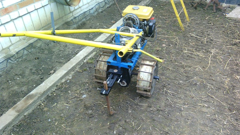

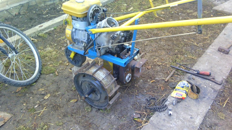

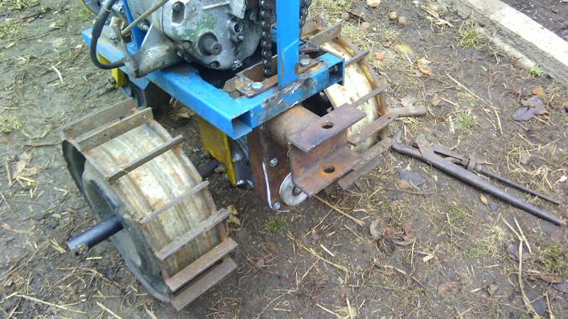

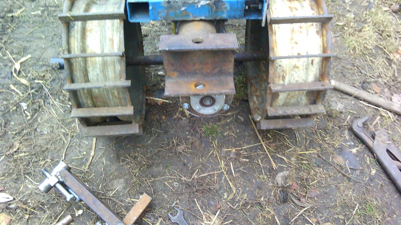

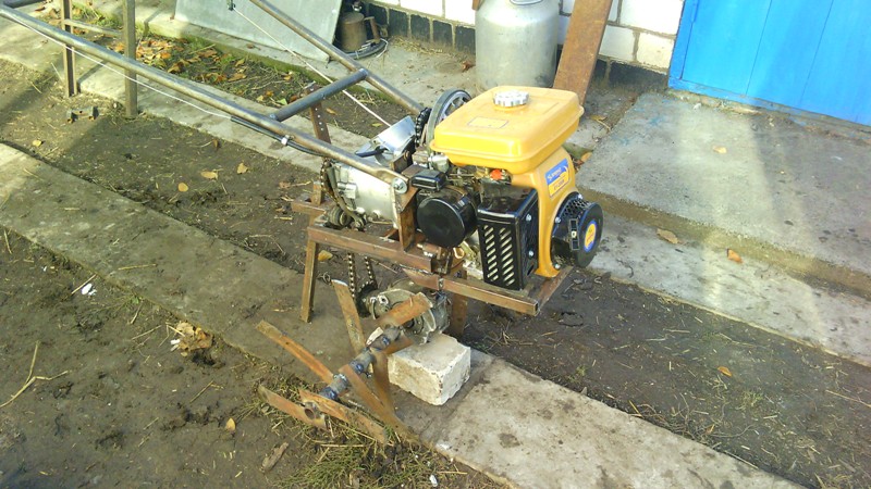

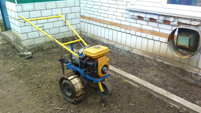

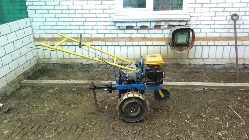

    The finished product looks like.
    Homemade walk-behind tractor-img_20160313_121441.jpg Homemade walk-behind tractor-img_20160313_121458.jpg Homemade walk-behind tractor-img_20160313_121511.jpg
    walk-behind tractor will be used for cultivations, planting and digging potatoes and other work on the farm.

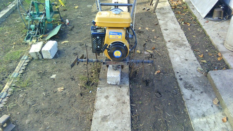

    During cultivation plow is used as a brake.
    Homemade walk-behind tractor-img_20141109_141027.jpg Homemade walk-behind tractor-img_20141109_143612.jpg Homemade walk-behind tractor-img_20141109_144928.jpg Homemade walk-behind tractor-img_20141109_150640.jpg

    Good looking machine, looks professional. Want to see video of it being used.
