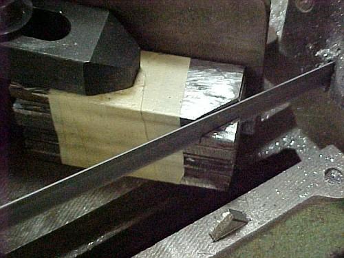

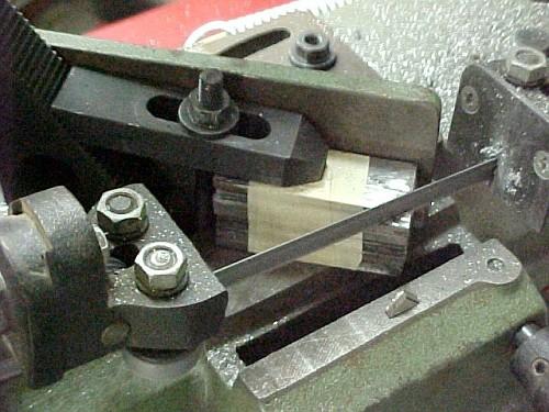

I have used milling clamps in my H/V for years... Some set-ups are impossible to clamp with the original clamp. The T-nut slips right into the slot for the clamp slider. I have thought about drilling and tapping a few holes for the clamp bolts, just haven't had the need to do so yet. I can usually get most set-ups clamped using the existing slot.
http://www.shopfloortalk.com/forums/...3&d=1265850282
With the milling clamps I knocked the corners off this stack in less then 10 minutes...
