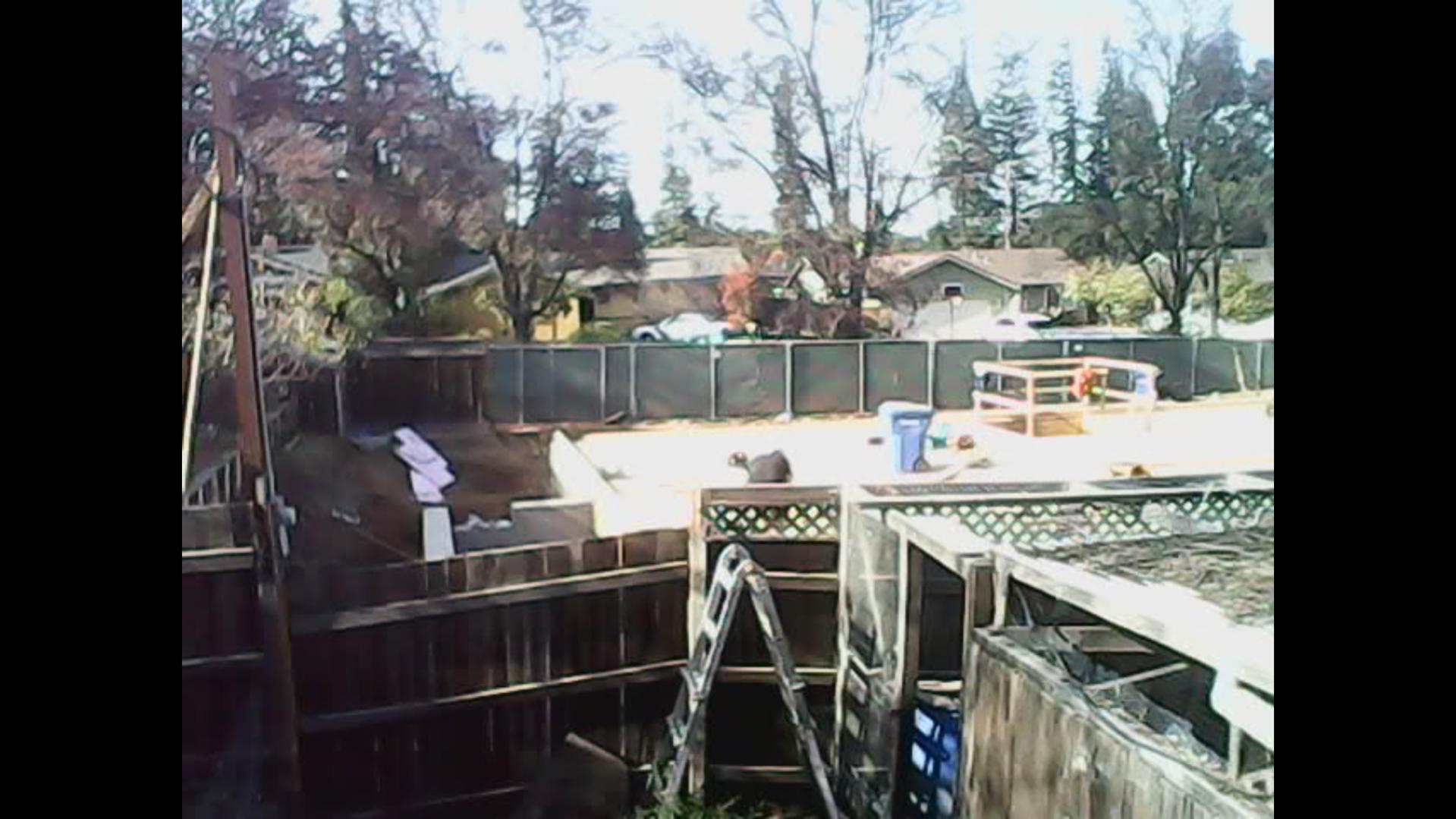

The guys are currently pounding dirt and tossing boards around so I can't photograph until later anyway.

Photo or it didn't happen. :thumbsup:
Bit of a breeze up there right now so I can't keep it above the fence for long. But...
Attachment 32099
