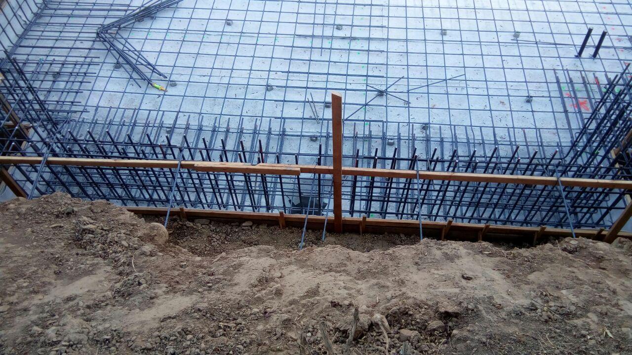

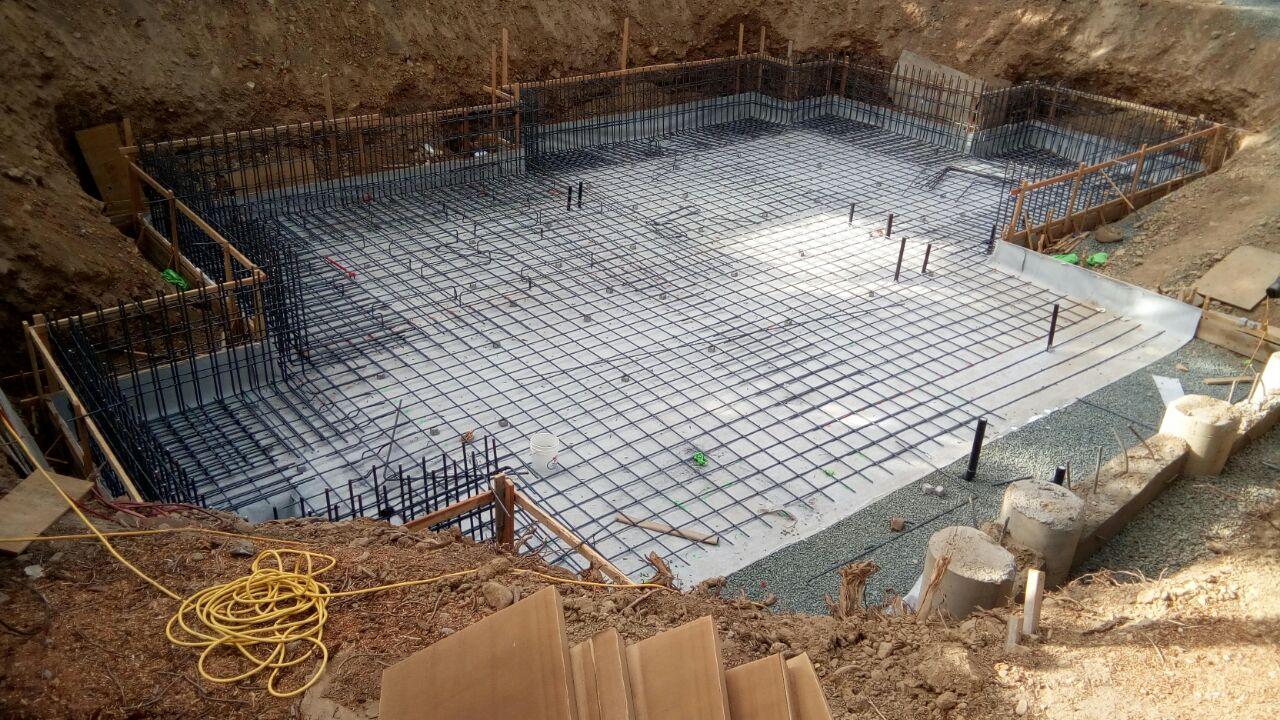

They have these 4 pits, one on each side of the building. The rectangular area slopes down and then there's the pit in the moddle. Odd piles?
Attachment 31026
Attachment 31026
Is that rebar grid pattern on the floor about 8" square or is it 12" square?
the pattern on the vertical pattern looks to be about 6 x6 if so that would make the foundation about 10" thick and from the looks of them about 3 ft high
I'm noticing taller verticals at the corners as well
as for the holes the one shown looks to be about a foot in diameter. Does it go down about 3 feet or more and slightly bell out at the bottom or could you tell?
I've seen anchor piles like those on slab pours where the building's foundation is poured above the basement floor, but if you were to ask me I would say they are cost cutting by not pouring a beam below the floor
14' deep! They intend a daylight basement and lower level?

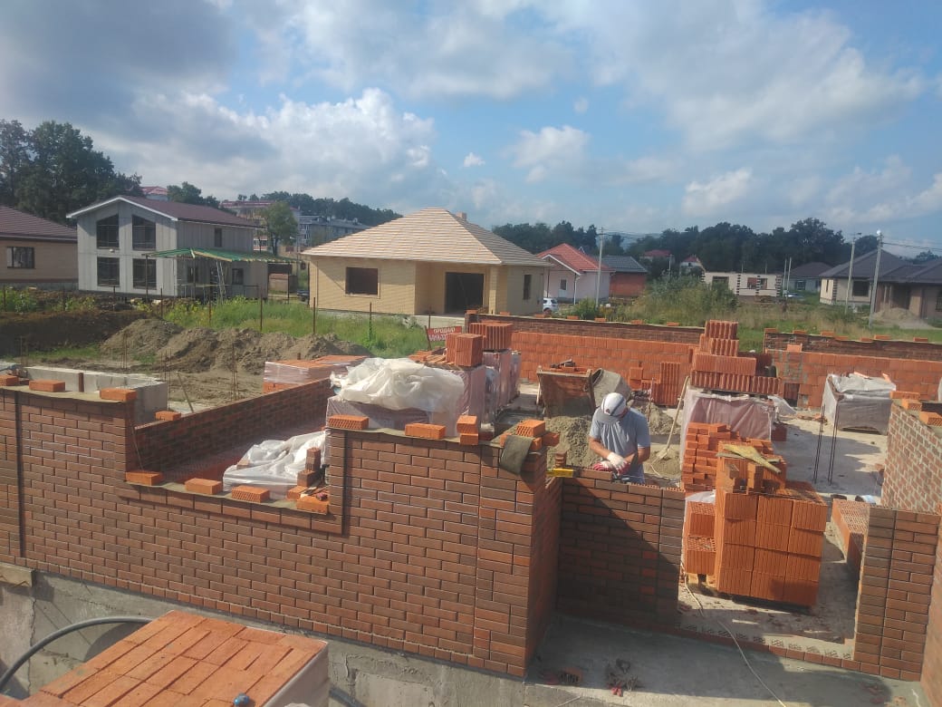

By the way, for contrast here's the progress on OUR new house.
Attachment 31029
We DO have one issue with our house the contractor is working on, the structural engineer wants the kitchen window moved away from the corner of the house. The problem is the kitchen is somewhat long and narrow as kitchens often are. Moving the window puts it over a counter or makes the window a lot smaller. The contractor said it should be sorted out by Monday and until then that particular wall is paused below window sill height.
I like that nice brickwork.
The contractor gets a bonus when he's done, assuming we sell this house without problems. I guess if we fall into The Pit then the people next door bought it for retail. :)
Please Universe, no falling into the pit until we have a house to move to. :)

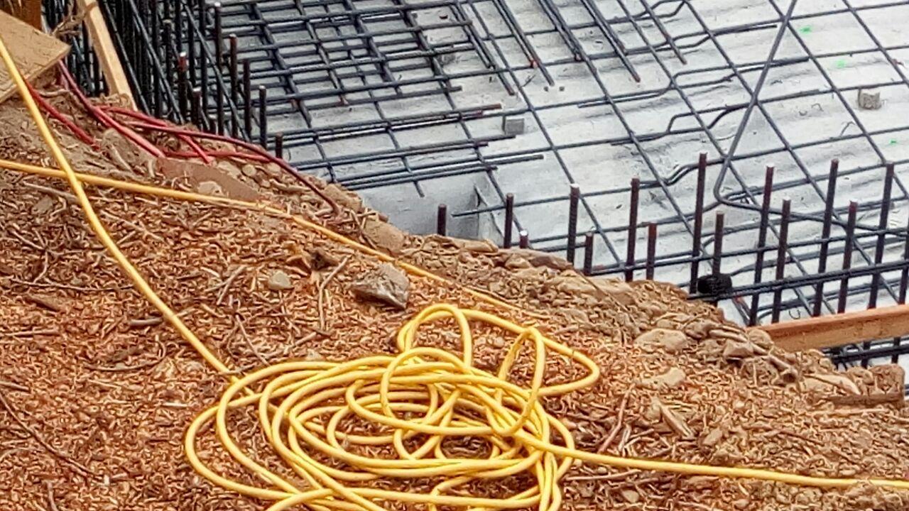

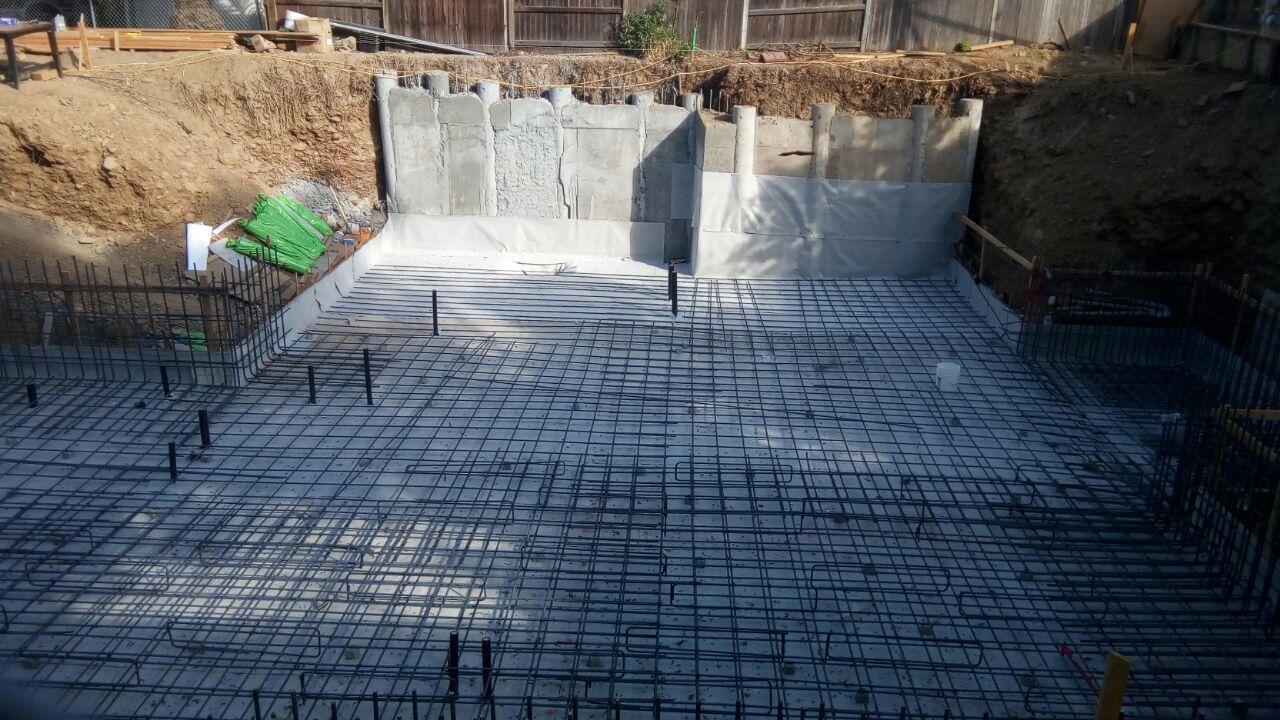

Here's today's Pit photos. They're adding another layer of rebar over the first so it's going to be a VERY thick floor!
Also cutting rebar out from over those side pits, so I guess they will be sumps for the rain/seepage pumps. There's also a pit in the front for the sewage pump.
Attachment 31031
Attachment 31032
Today they draped the wall and are advancing the rear in that dierction
