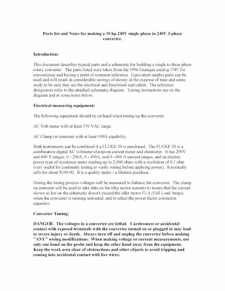

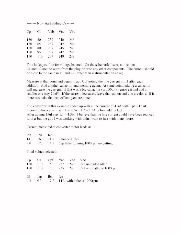

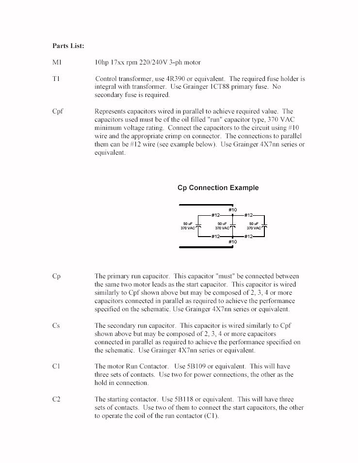

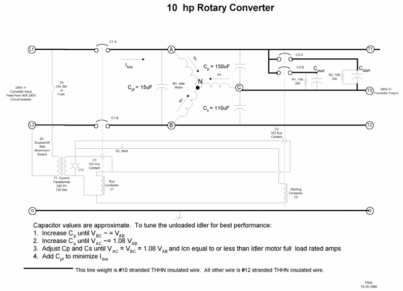

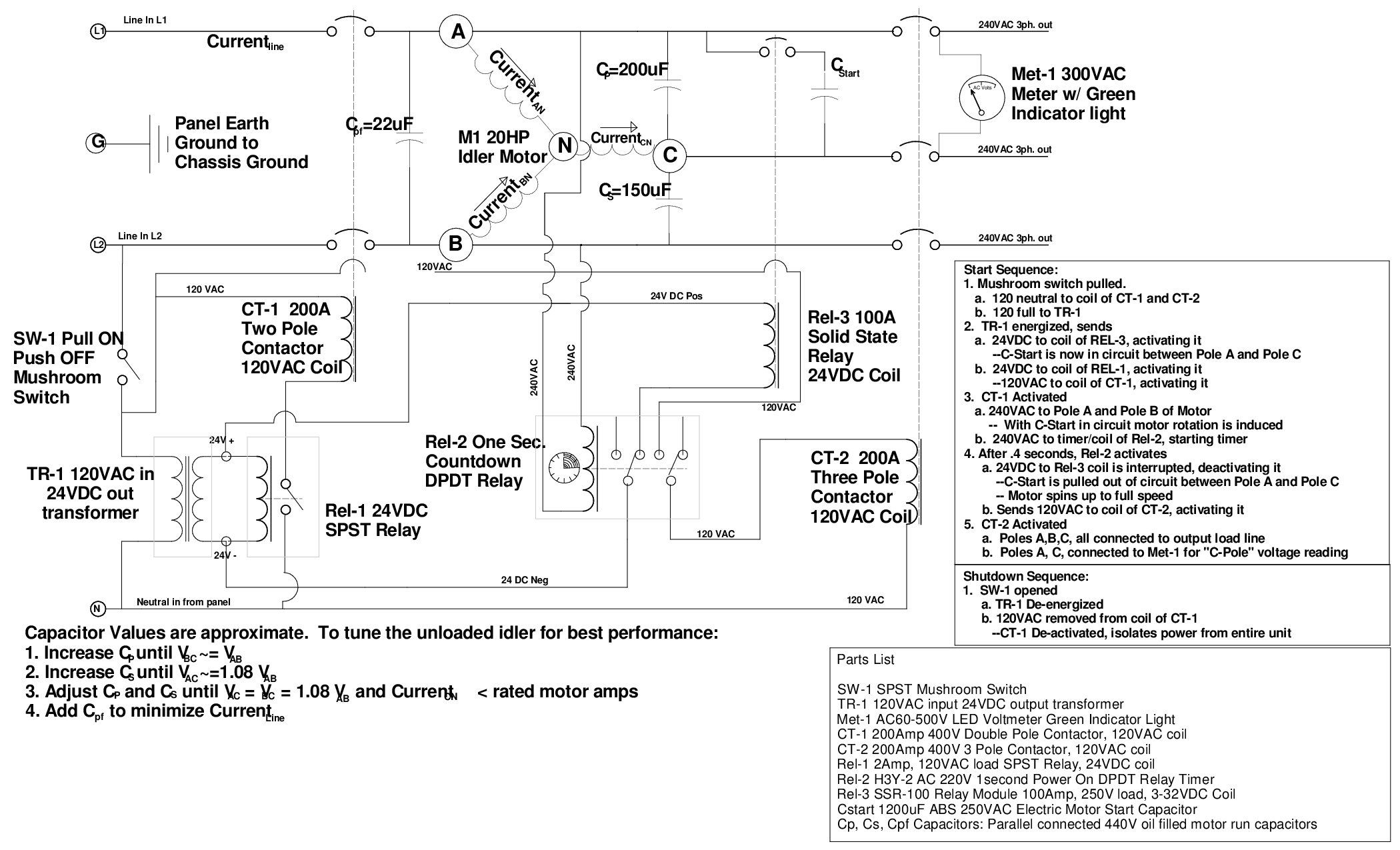

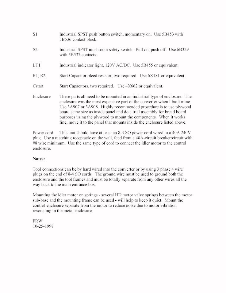

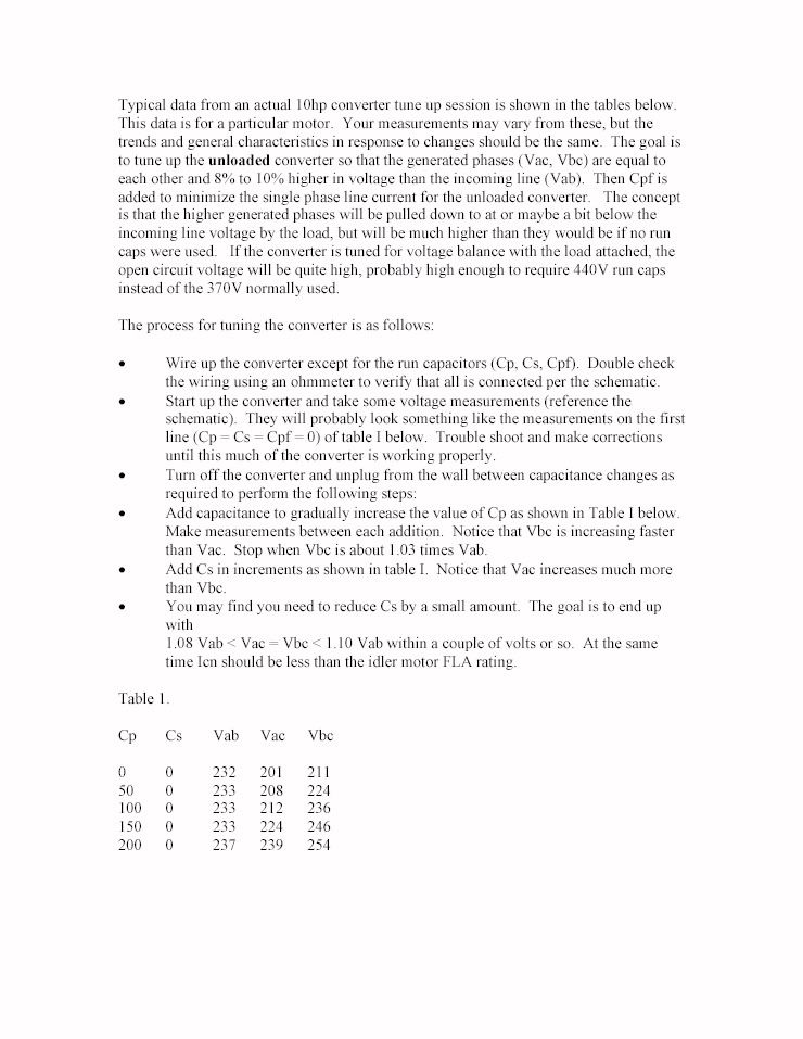

Plans and schematics:Attachment 32299Attachment 32300Attachment 32301Attachment 32302Attachment 32303Attachment 32304Attachment 32305
