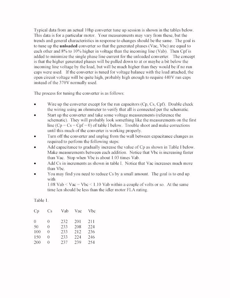

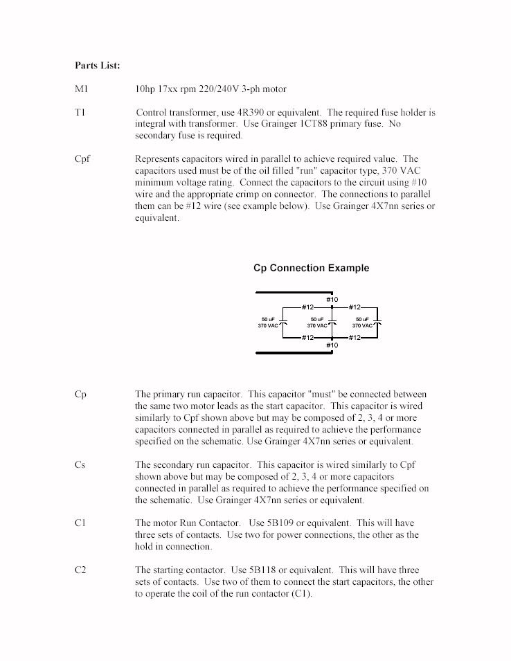

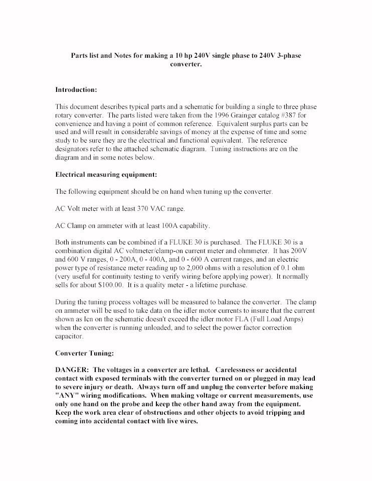

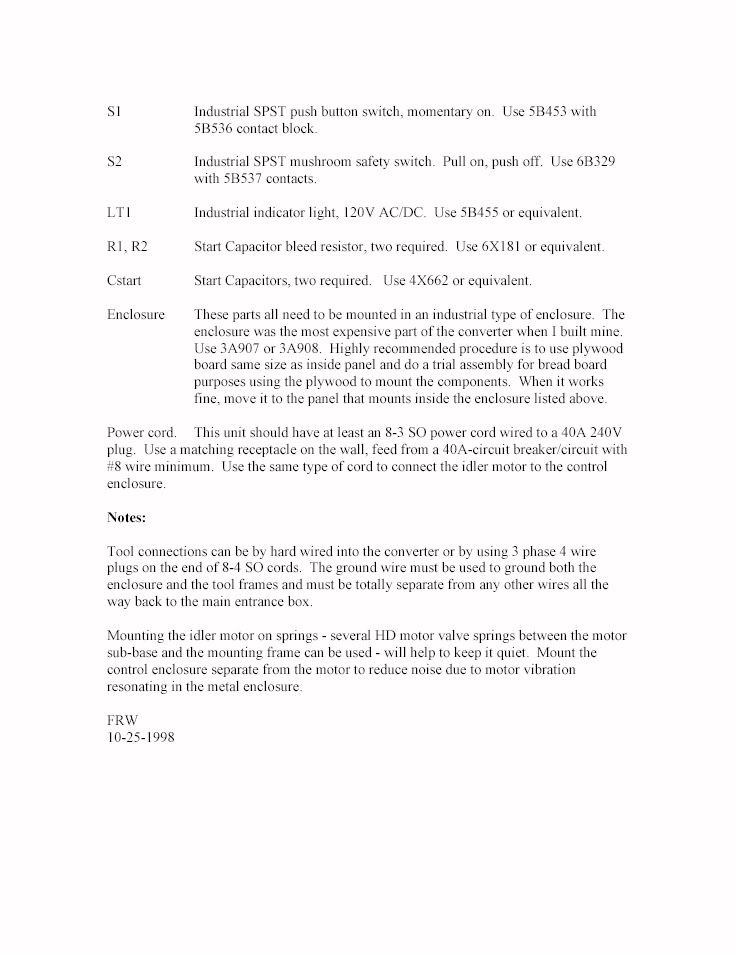

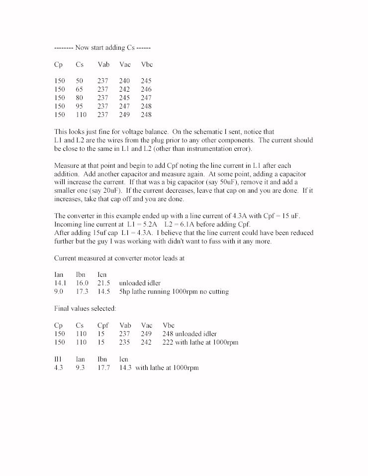

    Plans and schematics:How to Build a Rotary Phase Converter-20hp-schematic.pngHow to Build a Rotary Phase Converter-fitchwcon.gifHow to Build a Rotary Phase Converter-fitcht01.jpgHow to Build a Rotary Phase Converter-fitcht02.jpgHow to Build a Rotary Phase Converter-fitcht03.jpgHow to Build a Rotary Phase Converter-fitcht04.jpgHow to Build a Rotary Phase Converter-fitcht05.jpg

    Balancing the phases with no load connected wont do much, as any change in the load that your "floater" motor sees would require different capacitors. Better to balance with your largest tool motor running.

    I appreciate any honest feedback. Positive or not.
    I don't have much frame of reference for how the bearings ought to sound. it's really not terribly loud in reality I wonder if maybe the microphone picked it up more than it should.
    I'm no real expert on the engineering of it. The write up I was following recommended the balancing to be done under no load and give the generated leg 1.08x the voltage of the other legs. It seems legit enough to me. But I can't really say for sure how it will act under heavy load. I know that with the unit running and powering a 5 horse motor that the generated leg voltage dropped from 153 down to about 148. So it seems like under the unit's full load it's going to be in the vicinity of 140. Which is really all we're shooting for right?
    In any case, I don't have any three phase motors big enough to really test it under its full load. But it's going to be used to power a 15 horse screw compressor. So I guess we'll find out just how efficient it is.

    Bob you should be able to get some indication of how well it will respond to balance loading if you have a way to use additive resistance loading to any 2 of the output legs. Spin up load L1 & L2 take a reading of voltage for both legs and amperage draw then connect L1 & L3 the false leg to the same load take readings then repeat for L2 & L3 By the time you have completed the balancing you may find that you will even have capacitors across L1 & L2 to balance the incoming line voltages due to imbalanced loading elsewhere through out your supply IE the refrigerator starting up or someone using a Hair dryer.
