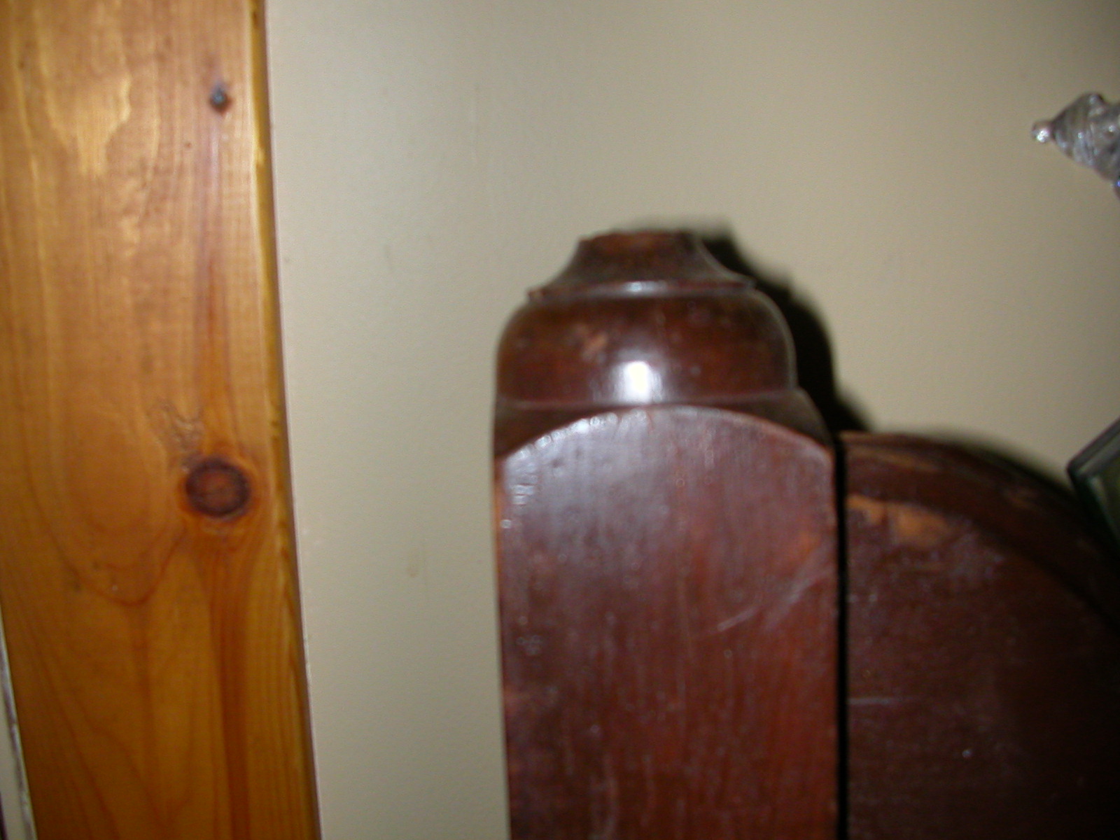

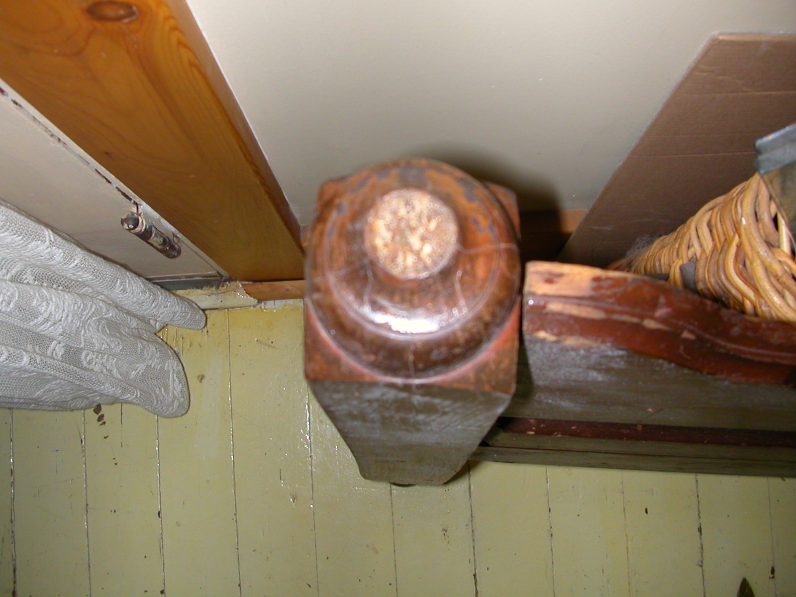

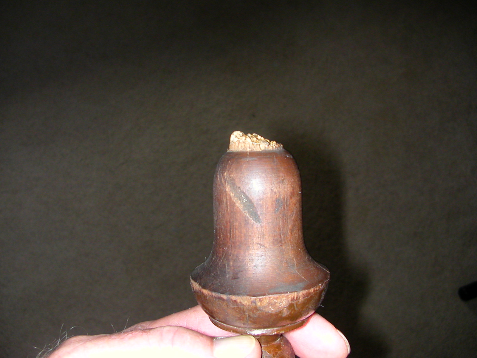

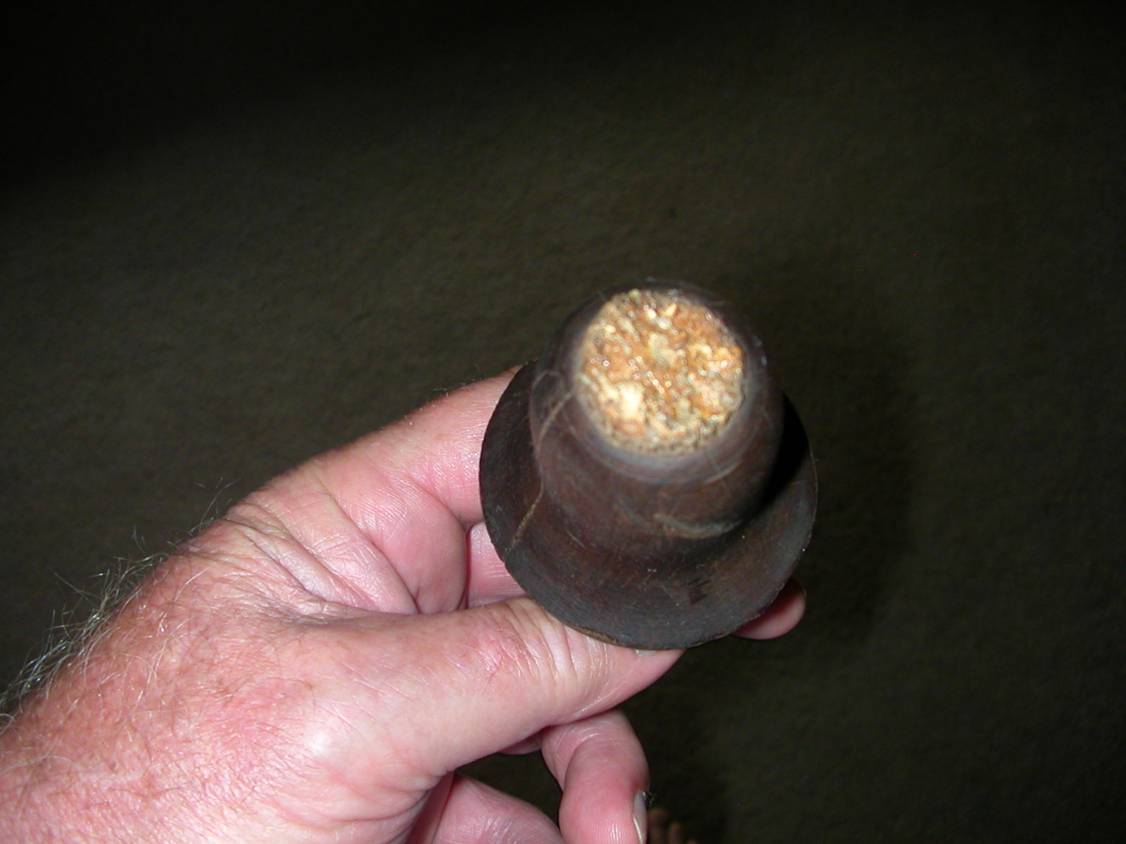

    I have a broken bed post. I want to drill a hole for a dowel on each piece so I can glue it back together. I would like to hear any ideas as to how to go about this.
    How can I center my drill-dscn7449.jpgHow can I center my drill-dscn7450.jpgHow can I center my drill-dscn7451.jpgHow can I center my drill-dscn7452.jpg
    I might make a box with no bottom and a thick top (2 pieces of 3/4?) that fit the diameter of the broken parts and a hole on center to keep me centered and straight.

    Your wife or girl may be able to help you. Ask for an old lipstick. Put a glob on one of the pieces, as close to center as possible. Dry fit them together and carefully take them apart again. There will be a lipstick mark that will match for both pieces. Drill a hole carefully in both marks, being sure to keep plumb. Place your dowel on and dry fit again to make sure, and then glue it all up.

    I did furniture repairs professionally full time for 8 years, new and used. One of my thoughts for this would be what 'awright' suggested. Line them up and drill down thru both. I'd use a 1/8 inch bit for it. One very important thing is look closely at each side of the break and get rid of any splinters that are bent over because they will prevent getting them fully back together. They make dowel alignment pins but that won't work on this rough surface presisely enough. If they don't line up when you dry fit them after you are done drilling your holes; I suggest you not enlarge one of the holes as some have suggested here. I would shave or trim down a portion of the dowel so they will line up better. One advantage I had when I did this work was I was able to match the wood grain, colors and finish precisely. If you drill down thru the top of the finial you will have the small hole in the top left...fill that with a small piece of wooden BBQ skewer or whittle down a small plug that fits the hole, a drop of Elmers of wood glue and plug the hole. The trick to this is leave the plug protrude out the top until the glue has dried, then trim it down until it's level. Wet your finger , rub it a touch and the dirt from your fingertip should make it dissapear, then rub it with a candle, the wax will seal it and blend it in. For the glue, Elmers (polyvinyl) or a wood glue should be fine, epoxy would also be OK....it depends on what you are comfortable with. If you have to shave down the dowel a lot then a thin shim on the opposite side will fill it in but I do not think you need to bother with that. Get it to dry fit tightly before you glue it and you'll be fine. If it does not want to dry fit properly then take the time to get the correct fit. If the dowel is loose in both hole then add some fine sawdust to the glue, it will help bridge the gap. Good luck with it.

    Well, I finally decide to do this and get it out of my way. I roughly marked center and hand drilled the bottom for a good fit for the dowel. Theh I did the same on the top piece, but wallered the hole out a bit. lathered it up with gorrilla wood glue and clamped it . It centered up OK and doesn't even look too bad
