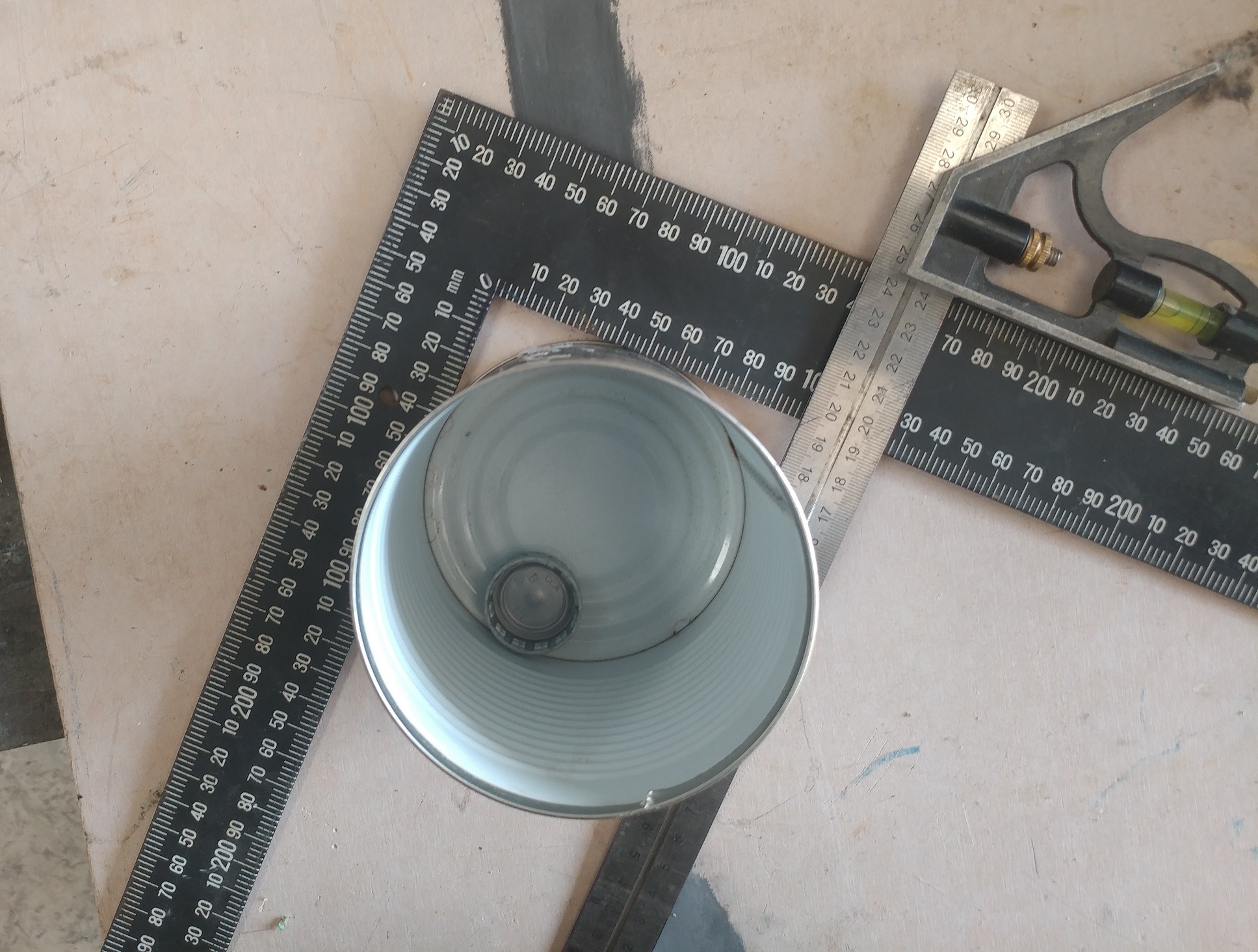

    I can't recall where I saw this, but hopefully it helps someone in the future...
    using a framing square, and a sliding square, I can measure the diameter of things accurate enough to do belt length calculations.
    refer to the 2 example photos showing the method.....

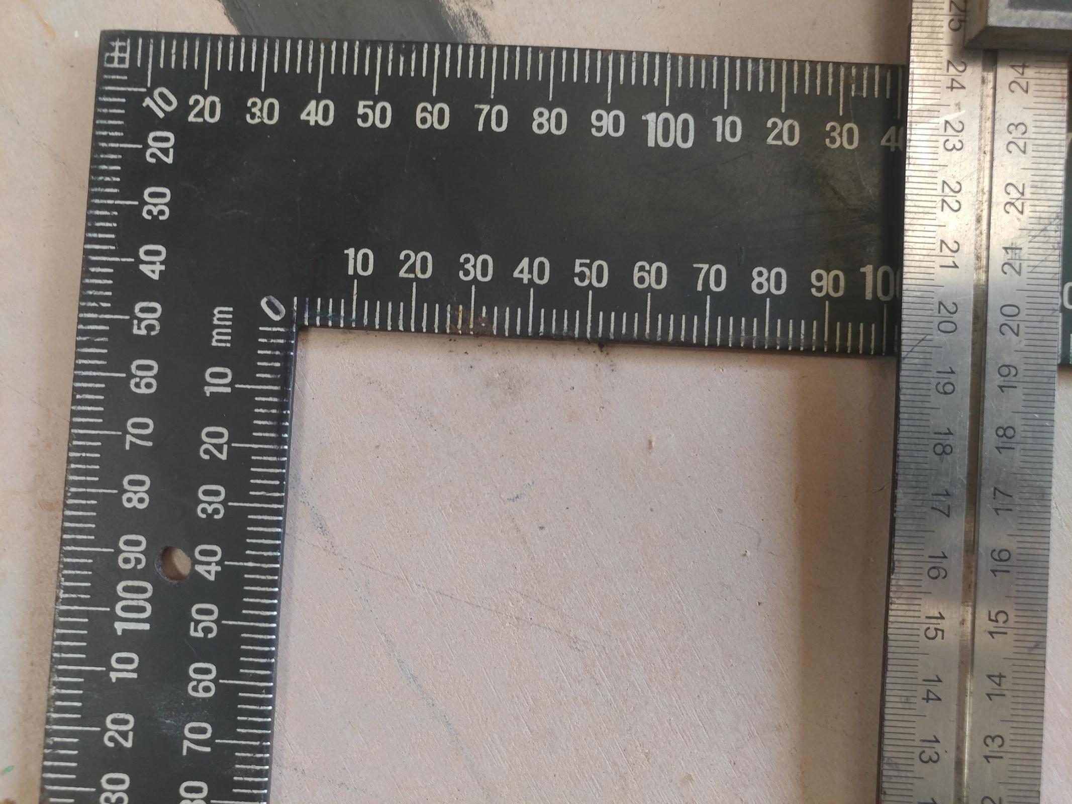

    use a sliding square and the inside edge of the framing square as legs of a caliper - keep the sliding square in proper contact with the other leg of the framing square.how I measure across a large diameter-measure_example_l50.jpg
    read off the value from the inner scale (or use another measuring tool to get the value)

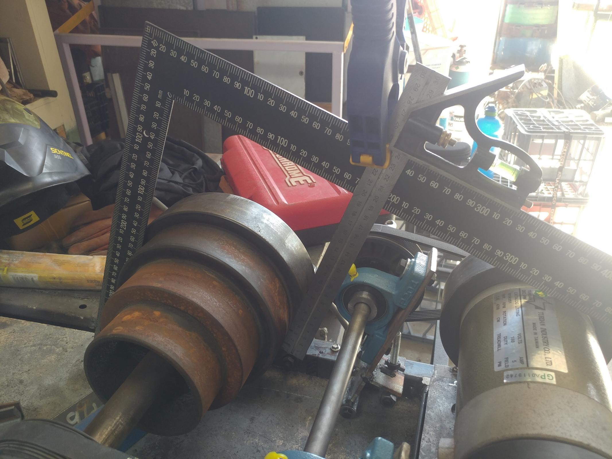

    and here the method is used for measuring the diameter of a lathe countershaft cone pulley...
    you can see the use of a spring clamp to hold everything in place to get a better measurement
    FWIW, I used a similar method to measure the headstock pulley diameters on the lathe, but instead of a framing square, I used another sliding square, set at 200mm, then simply subtracted the value on the ruler from 200mm to get the true pulley diameter. (no photos, sorry)
