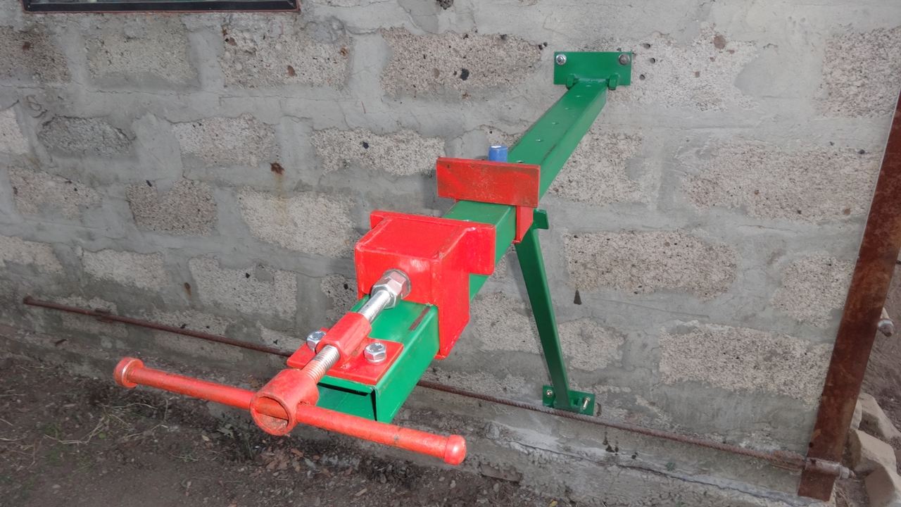

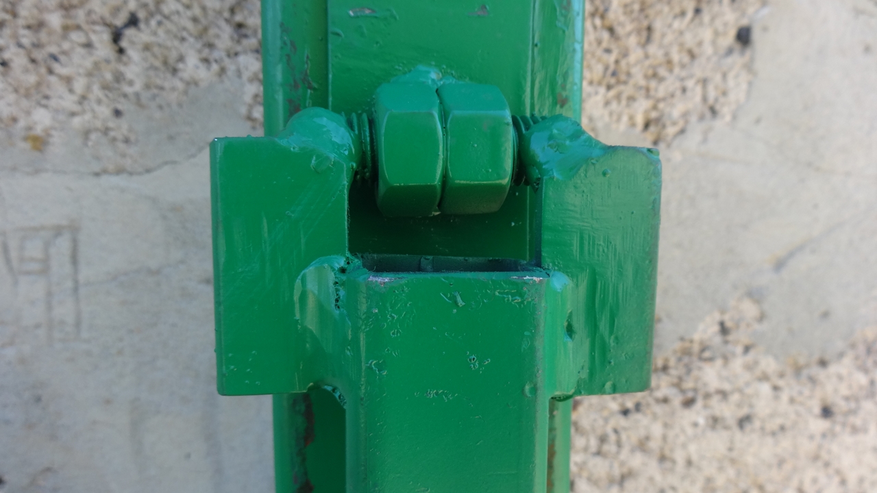

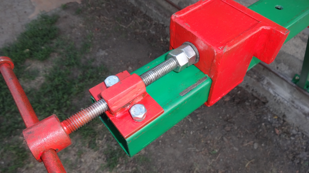

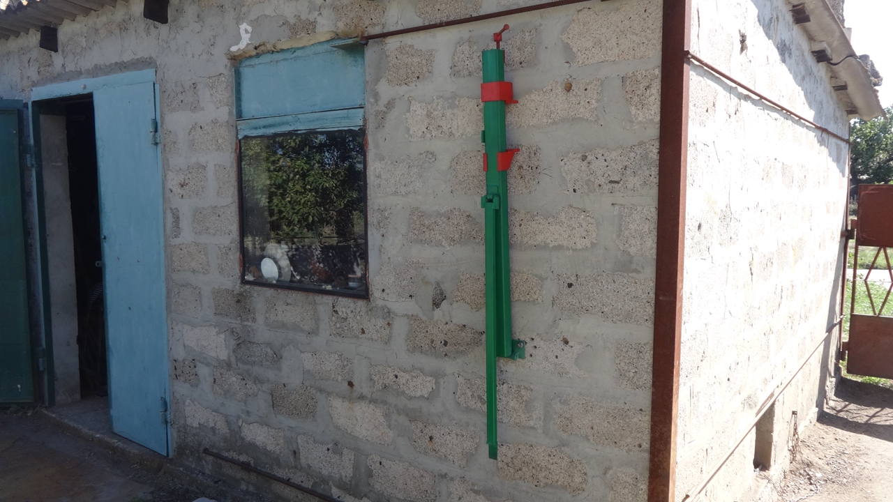

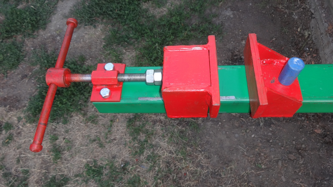

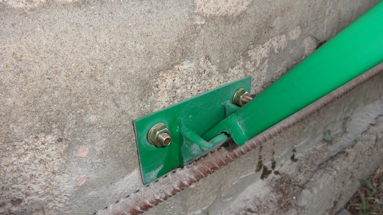

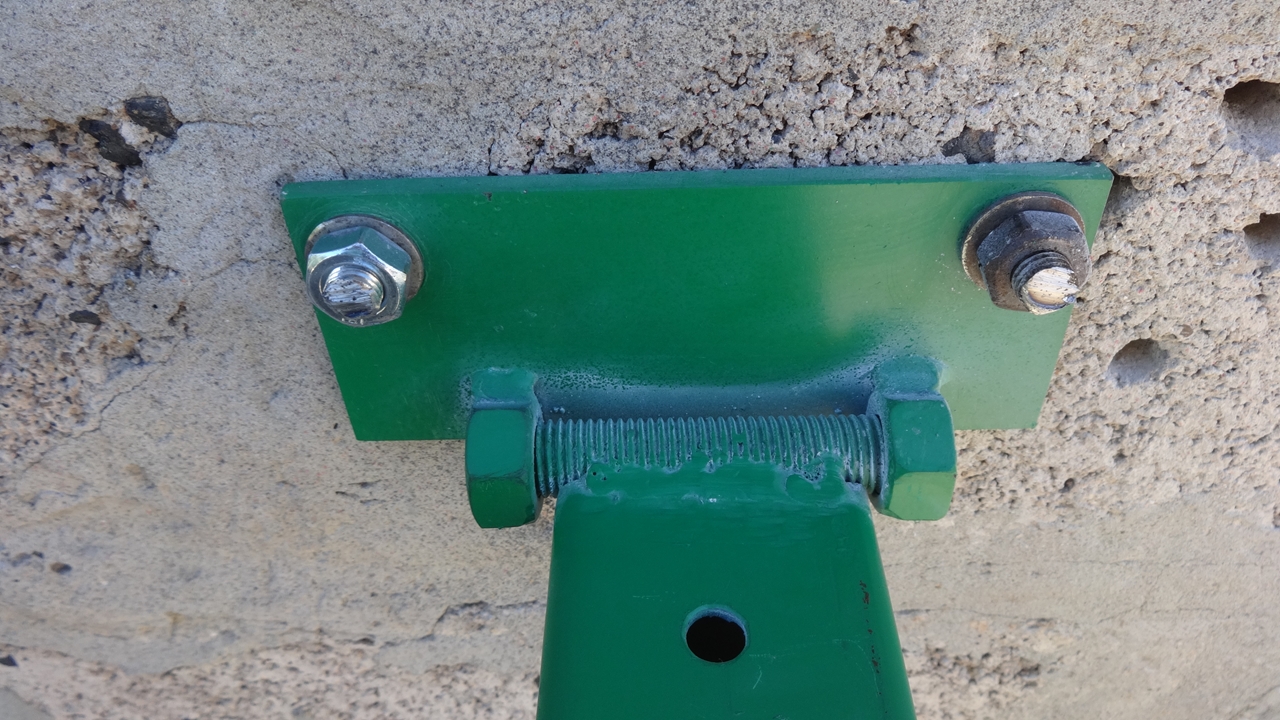

    In this video I will show you how I made a super vise for cutting metal sheet. This vise is very comfortable! With this vise it is easy to cut sheet metal.
    Here is a photo
    How to Make a Great Vise for Cutting Metal Sheets-dsc05029.jpg How to Make a Great Vise for Cutting Metal Sheets-dsc05030.jpg
    How to Make a Great Vise for Cutting Metal Sheets-dsc05021.jpg How to Make a Great Vise for Cutting Metal Sheets-dsc05019.jpg
    How to Make a Great Vise for Cutting Metal Sheets-dsc05034.jpg How to Make a Great Vise for Cutting Metal Sheets-dsc05025.jpg

    good tool.. i will be making a 3 leged version for my back yard.

    You will like using that vice a lot more than working on the ground.

    Nice idea Nice job Just the color not so pretty

    Using threaded rod and nuts as a hinge is brilliant.
