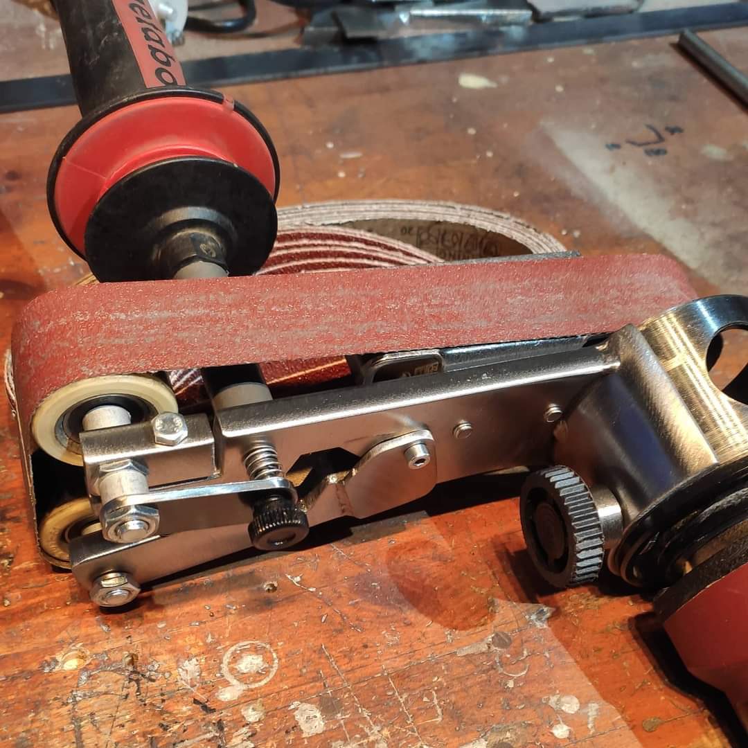

    Just some finishing ( choosed to polish it ),
    And part 2 is done.

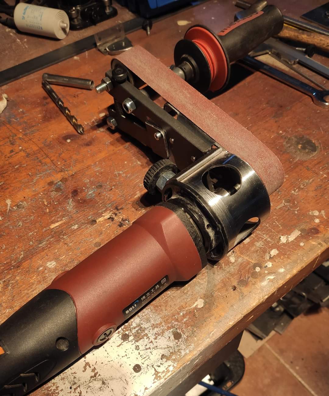

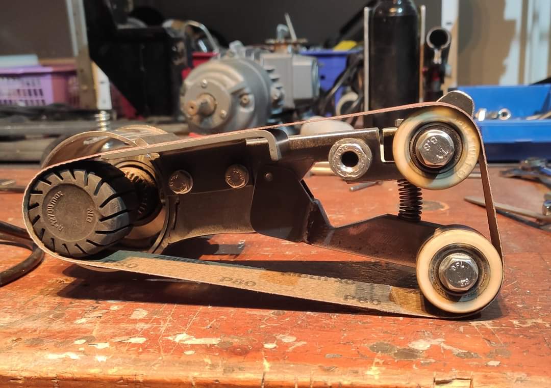

    Finished belt sander attachment.

    Preview:
    Video about making the part 2: Belt sander attachment
    This build is now ready.

    Part 1 is about turning die grinder to palm router kind of tool.
    Part 2 uses casing made in Part 1 as an connection piece and Chuck guard.
