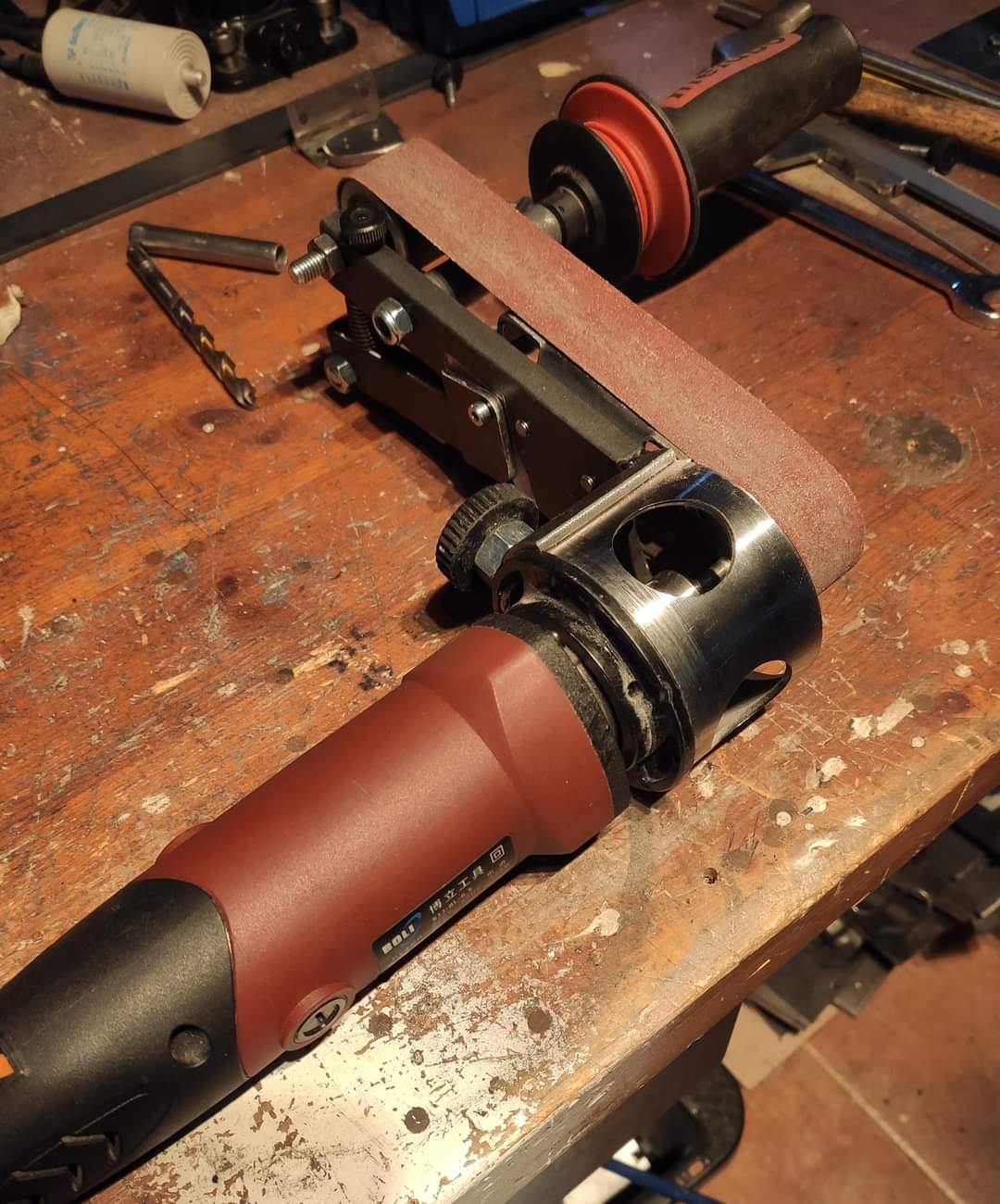

Just some finishing ( choosed to polish it ),
And part 2 is done.
Attachment 36896
Video comes later.

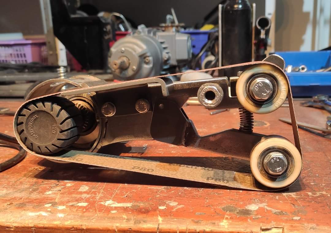

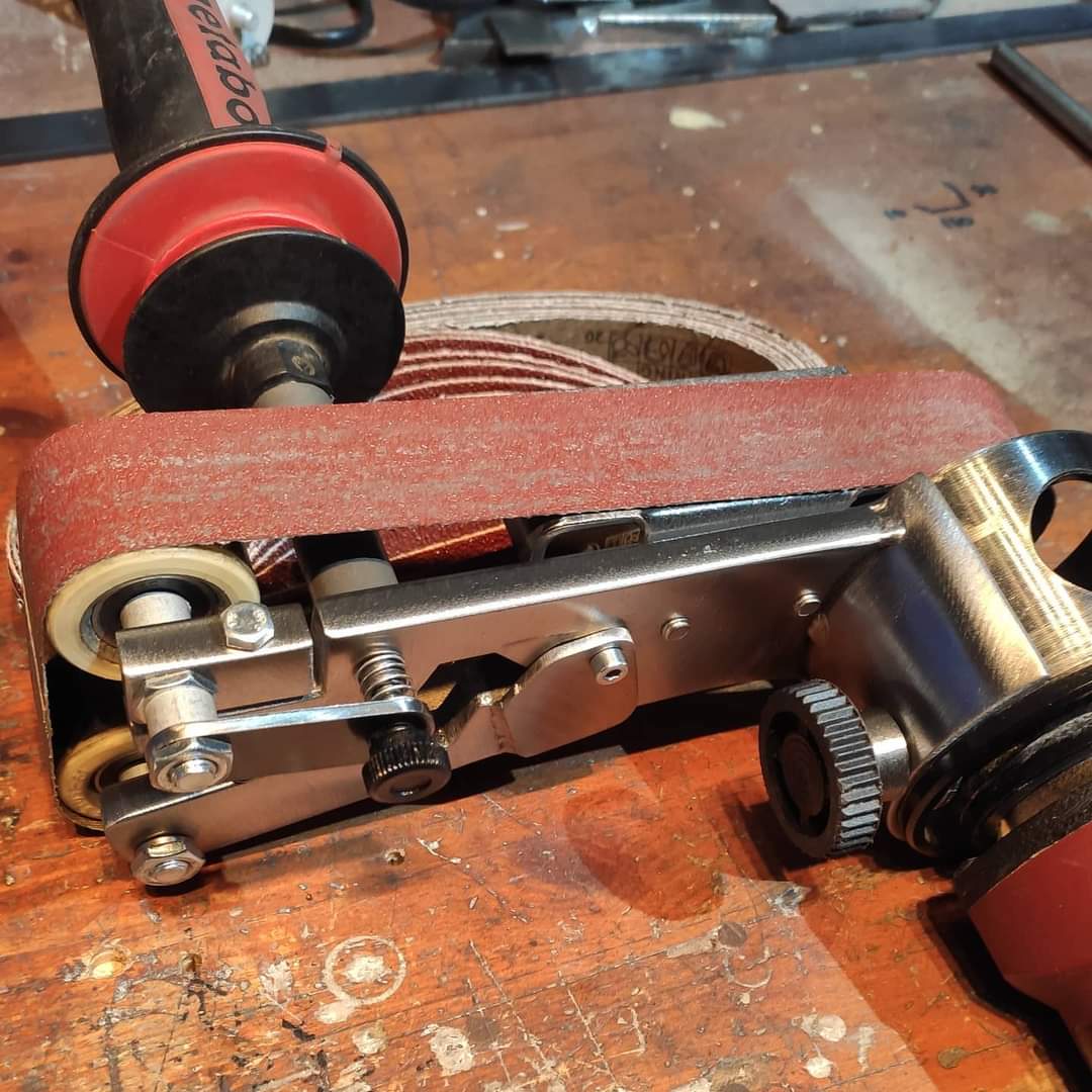

Finished belt sander attachment.
Attachment 36932
Preview:
https://youtu.be/NRLW5jcq23c
Video about making the part 2: Belt sander attachment
https://youtu.be/1_DC3-UFmeI
This build is now ready.
