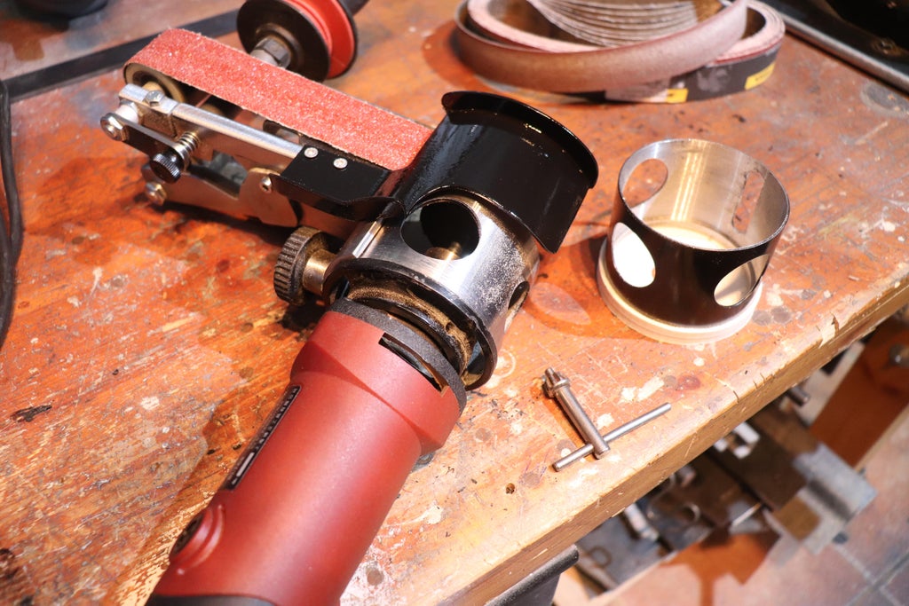

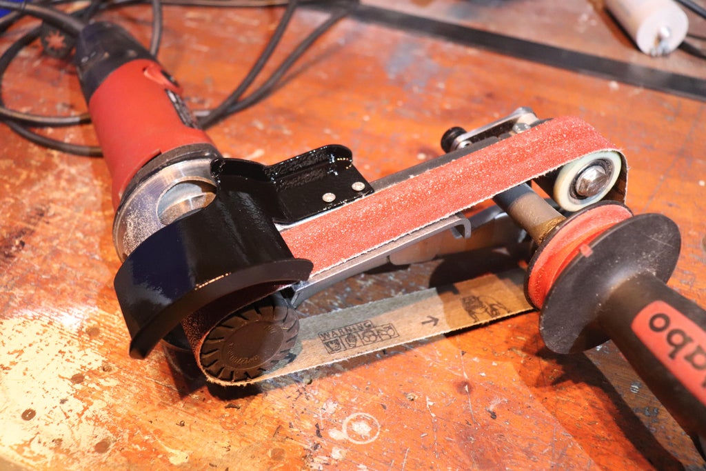

Made a belt guard too.
Its fastened to the belt sander body with two m3 screws.
Attachment 36962
Attachment 36963
Attachment 36962
Attachment 36963
More detailed info about making: https://www.instructables.com/Die-Grinder-to-Multitool/

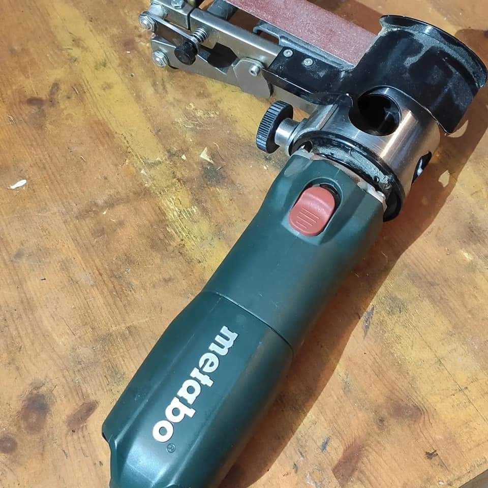

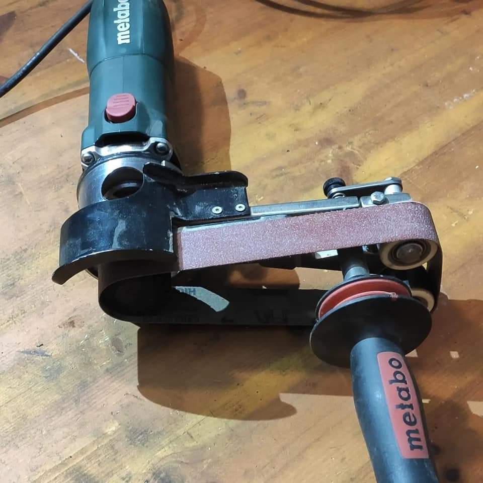

Modified it to fit 710w Metabo. More power makes it more useful.
Attachment 40924
Attachment 40925

A very simple yet ingenious at the same time. It looks like it is reasonably easy to assemble. Thanks so much for posting this one.
Yes. Its very easy & fast to assemble. That Metabo has groove in the neck. Locking screw is located to that groove.
Attachment 40930
It takes less than ten seconds to attach or deattach attachment.
