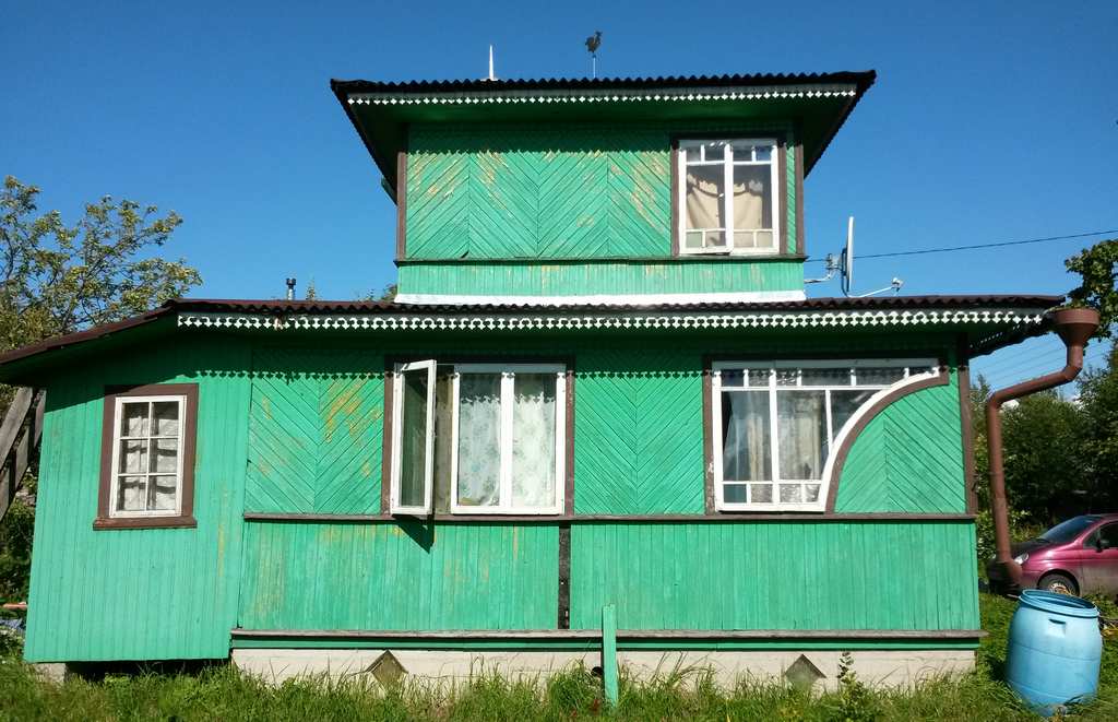

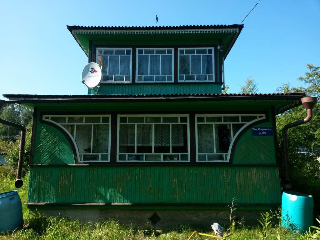

So it looks like "Dacha":
Attachment 18077Attachment 18078

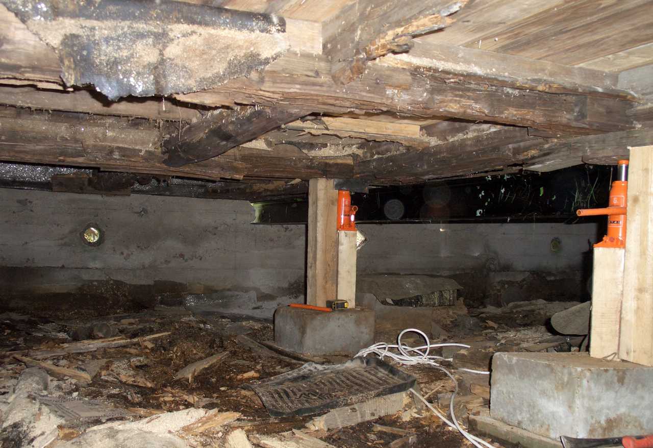

So it was before the repair:
Attachment 18080 Attachment 18081

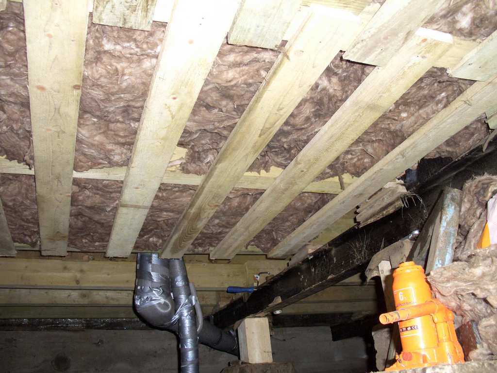

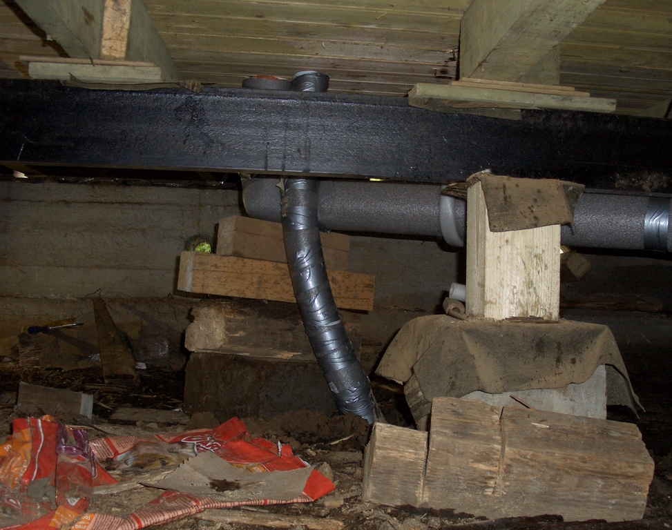

Start of repair - steel channel bar is installed:
Attachment 18082
During the repair:
Attachment 18083Attachment 18084Attachment 18085
Finished work at home:
- replacement of decayed lower wooden beams, the floor is laid on them.
- to strengthen the bearing structure of the house there are two steel channels 20 feet long each
- insulated floor with mineral wool 6 inches thick
- insulated the walls of the house with mineral wool 4 inches thick
