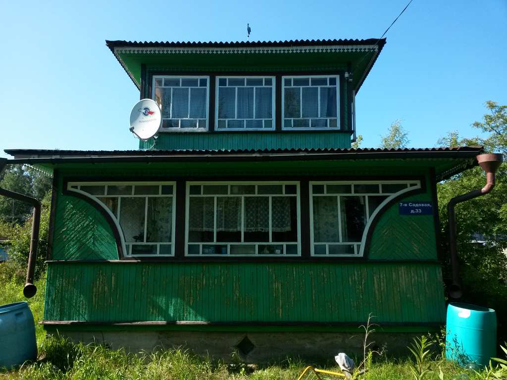

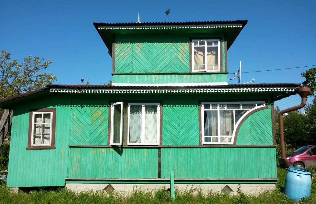

    So it looks like "Dacha":
    I am engaged in repair of a small old country house.-dacha-01.jpgI am engaged in repair of a small old country house.-dacha-02.jpg

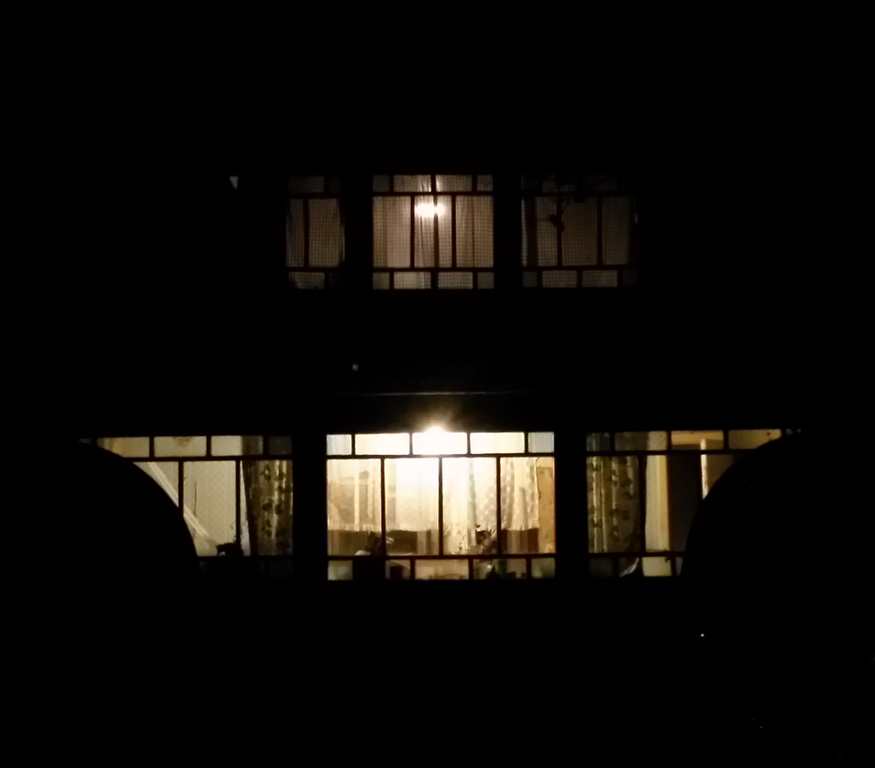

    And looks like at night:

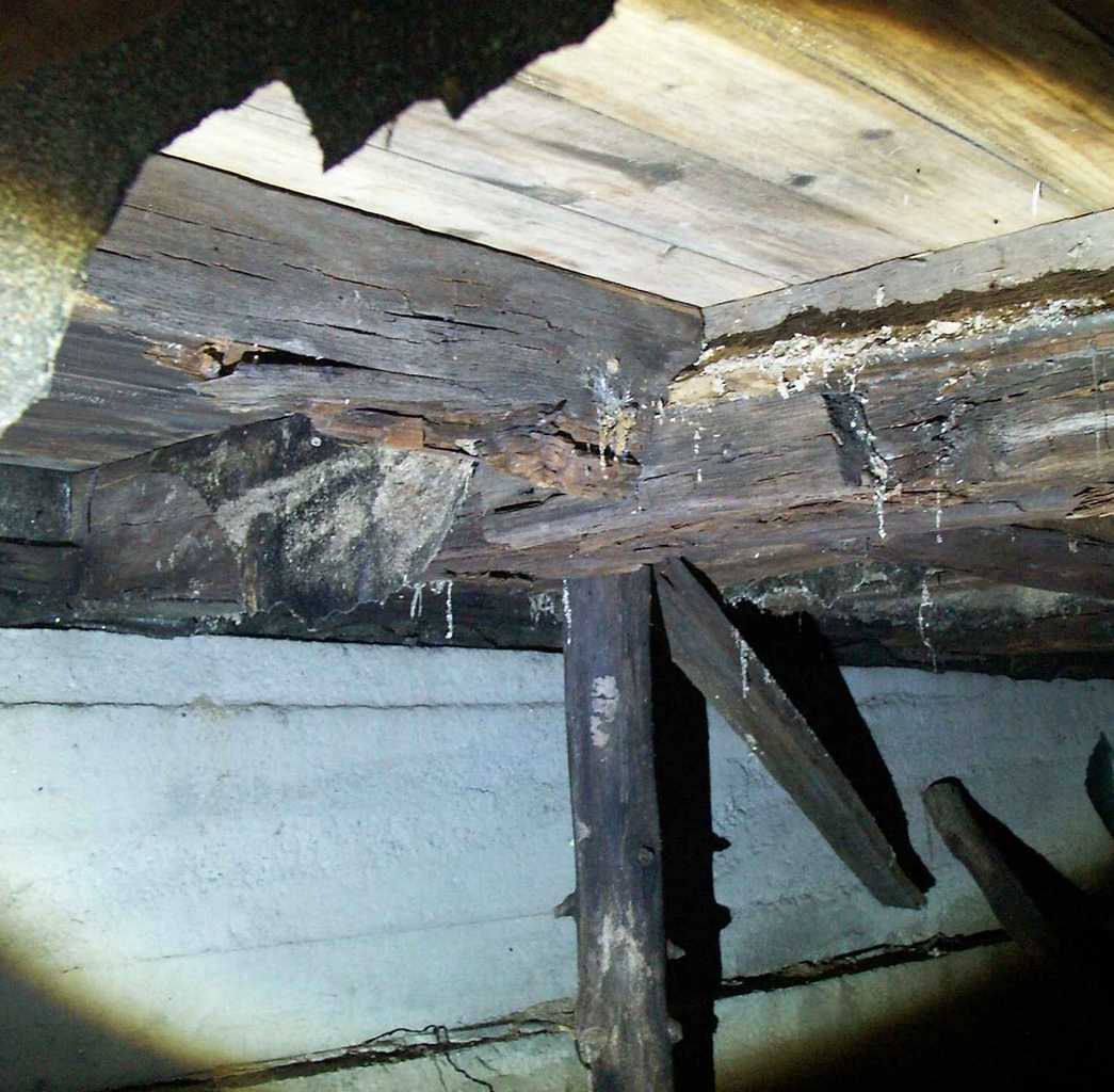

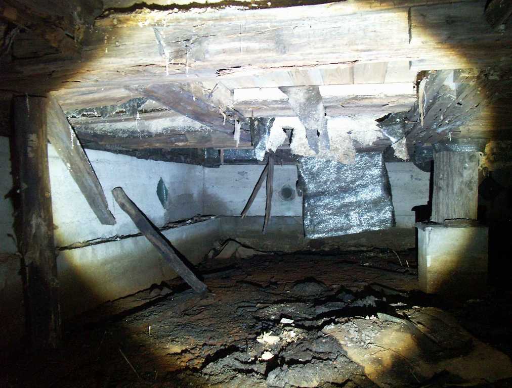

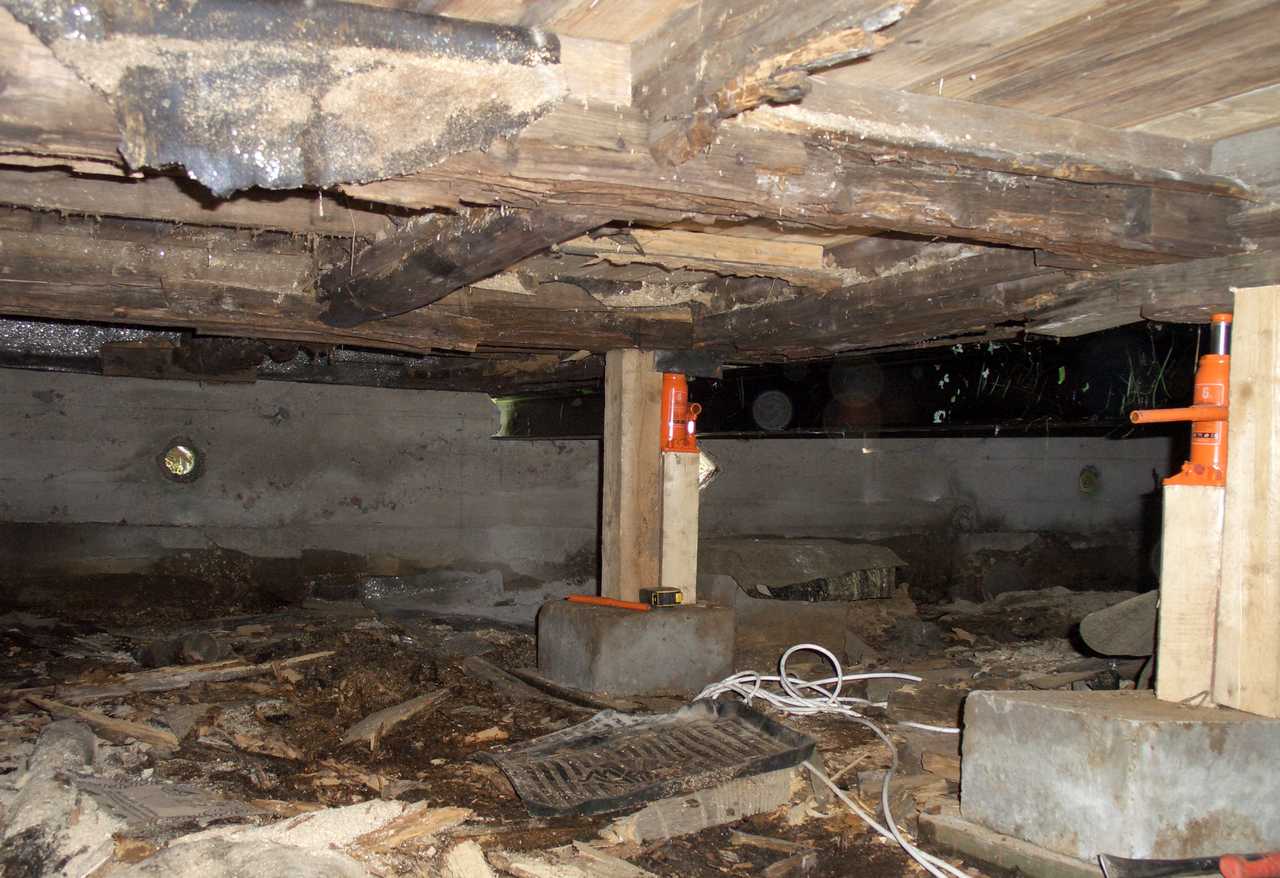

    So it was before the repair:
    I am engaged in repair of a small old country house.-3.jpg I am engaged in repair of a small old country house.-4.jpg

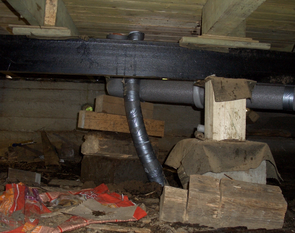

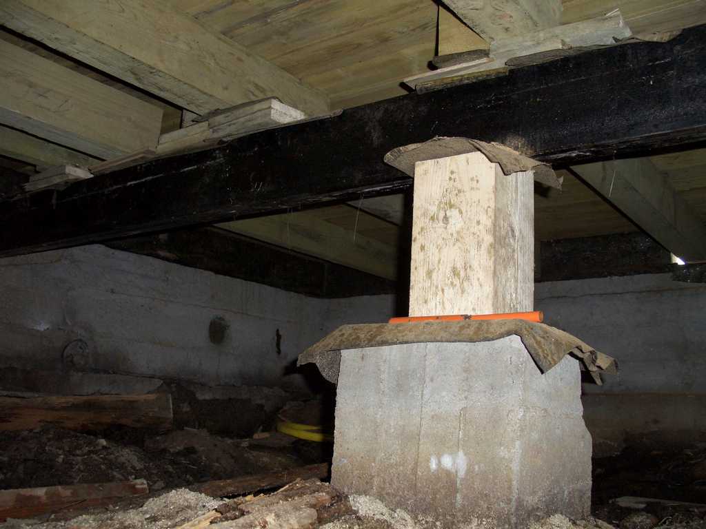

    Start of repair - steel channel bar is installed:

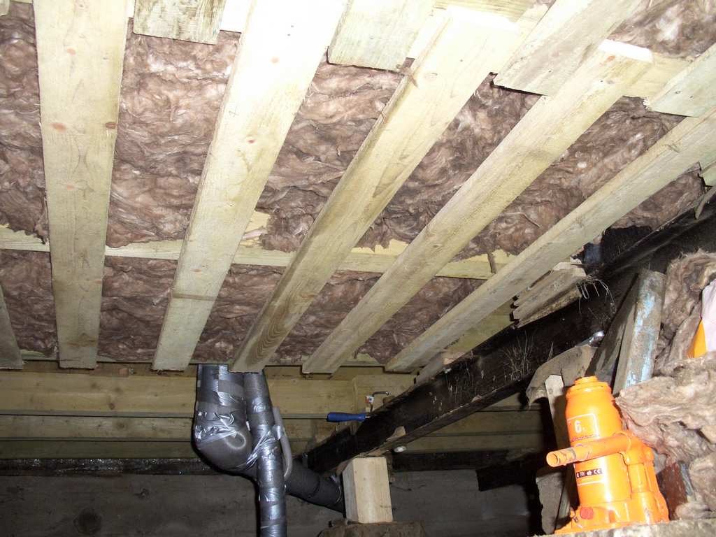

    During the repair:
    I am engaged in repair of a small old country house.-dacha-04.jpgI am engaged in repair of a small old country house.-dacha-05.jpgI am engaged in repair of a small old country house.-dacha-06.jpg

    - replacement of decayed lower wooden beams, the floor is laid on them.
    - to strengthen the bearing structure of the house there are two steel channels 20 feet long each
    - insulated floor with mineral wool 6 inches thick
    - insulated the walls of the house with mineral wool 4 inches thick
    - water supply to the house, washing with a tap and washing machine
    - plastic windows with double-glazed windows are installed

    Looks like a serious renovation! Those unusually-shaped windows are beautiful.
