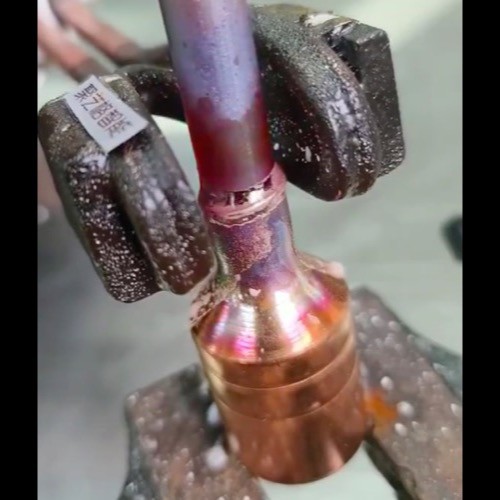

    What they are not explaining well is to allow the bolt head to cool before trying to turn it this allows the heat to radiate through the length of the bolt and some of the strength to return. If trying to remove the bolt while the head is still red hot it will twist off almost every time.

    I have one of those and it's AWESOME.

    Looks to me that they are tightening initially.
