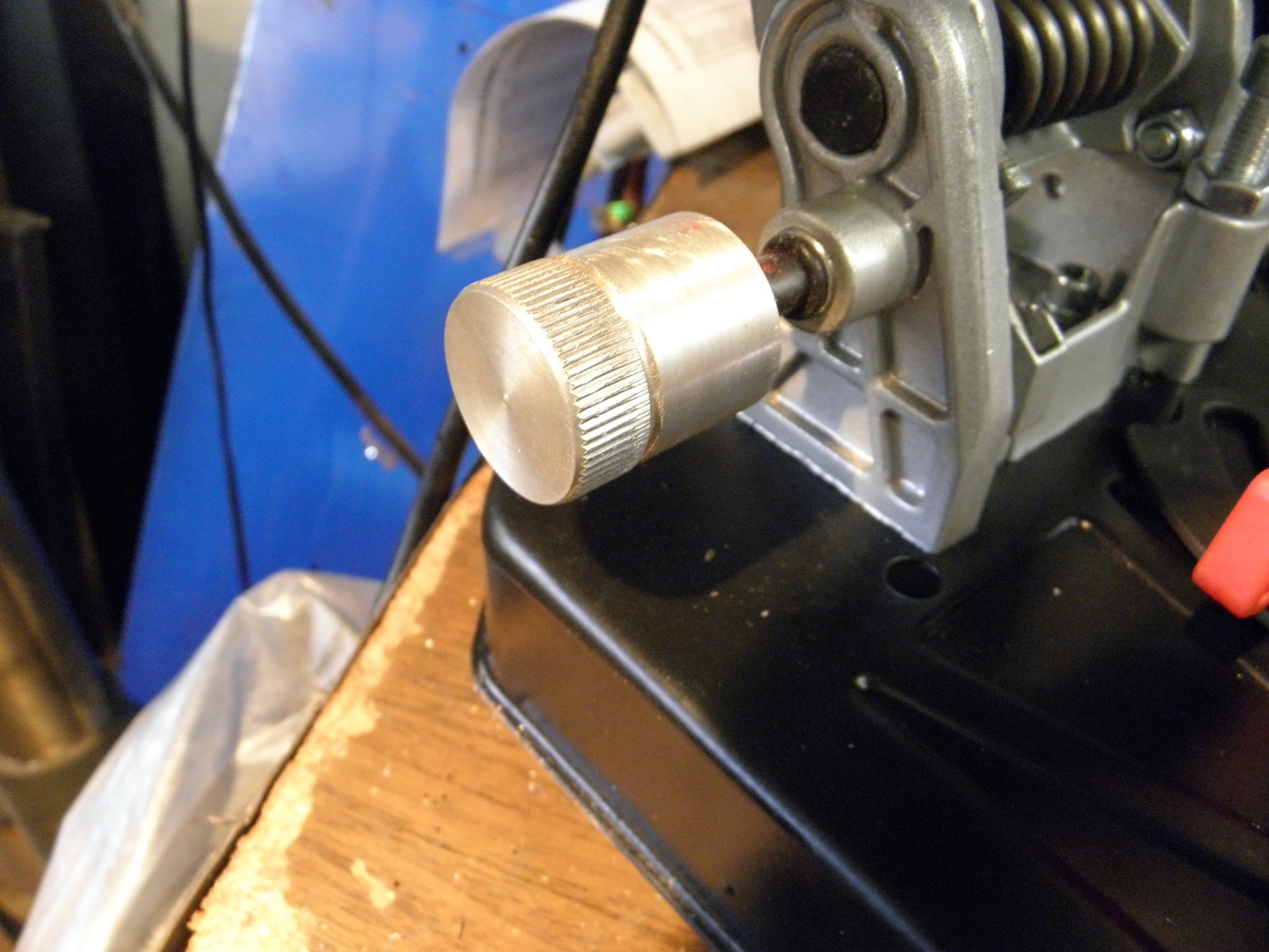

    Ironton 7 1/2 " metal cutting chop saw---- handle modification. made from steel.
    Ironton 7 1/2 " metal cutting chop saw modifications-p5040029.jpgIronton 7 1/2 " metal cutting chop saw modifications-p5040028.jpg

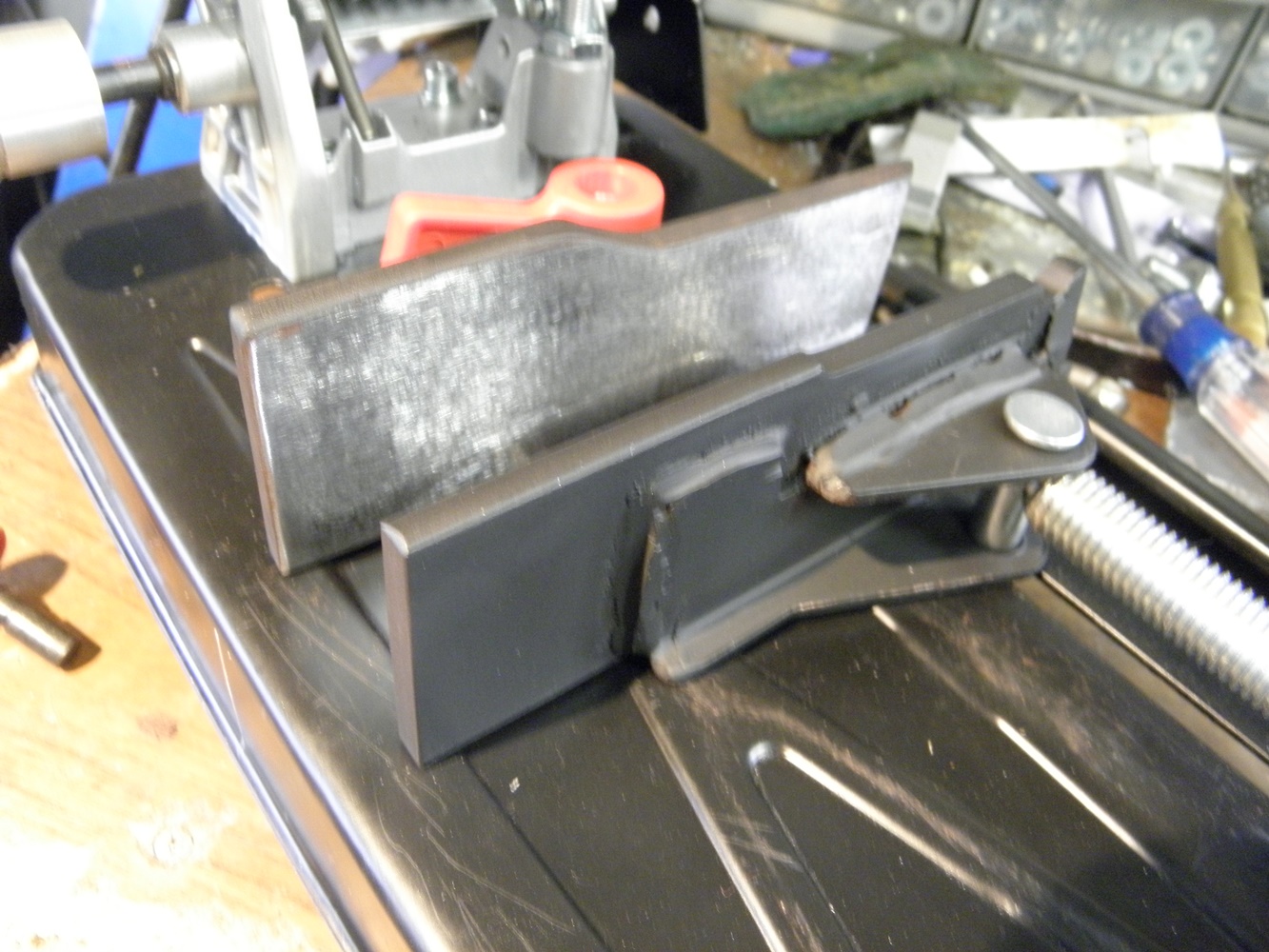

    Ironton 7 1/2 " metal cutting chop saw---- Jaw Modification
    Ironton 7 1/2 " metal cutting chop saw---- Jaw Modification. Made from cold rolled steel.

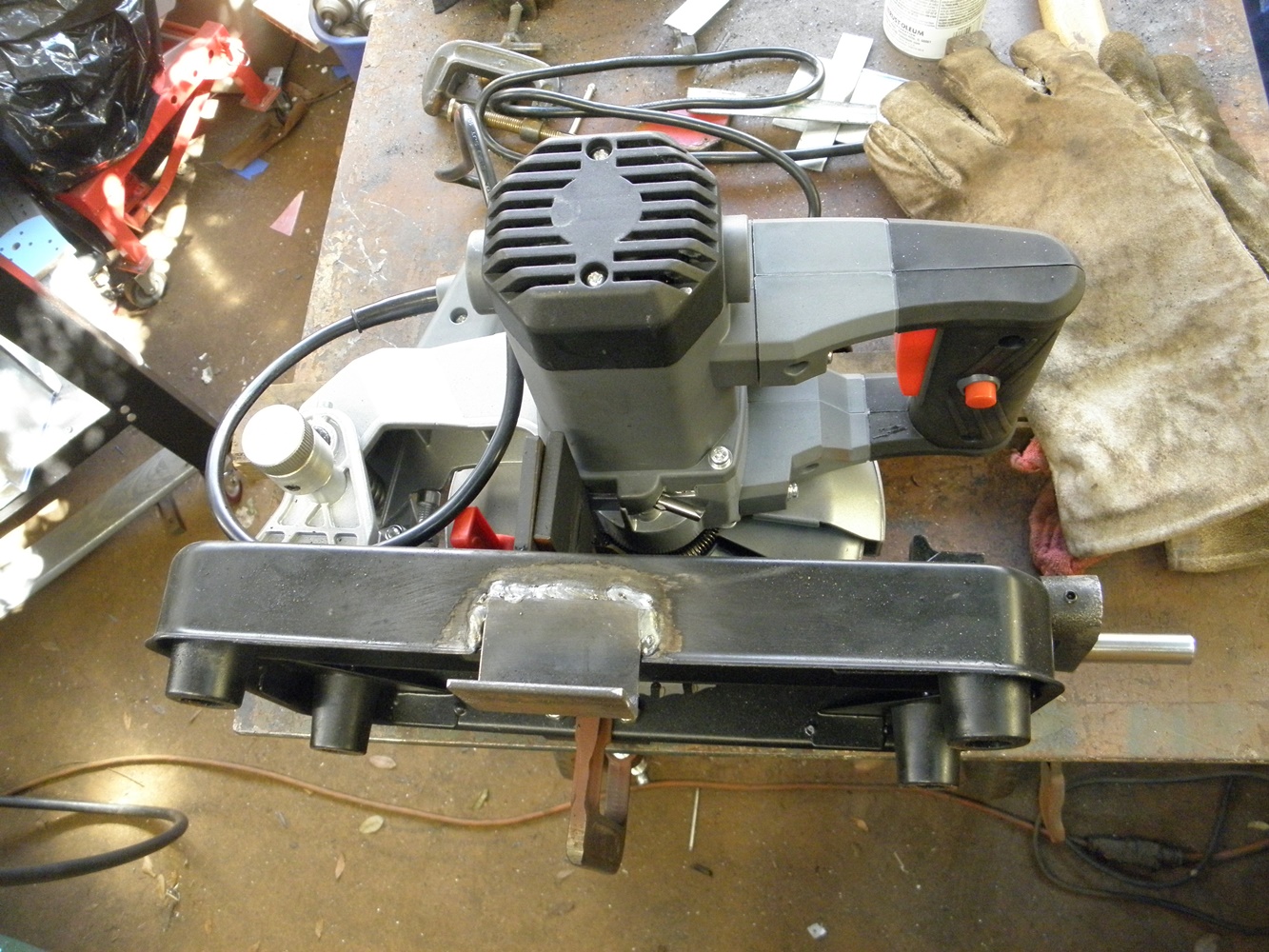

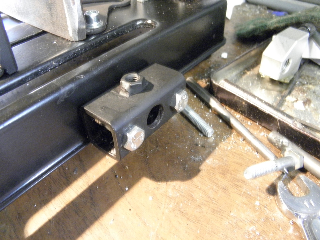

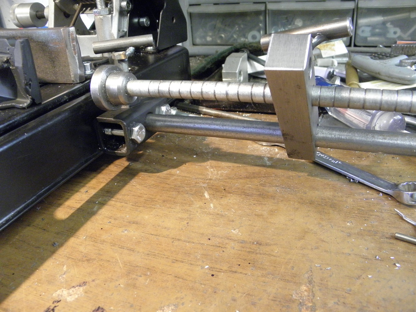

    Ironton 7 1/2 " metal cutting chop saw---- Material stop foot.
    Ironton 7 1/2 " metal cutting chop saw---- Material stop foot. Made from square tube and rod cold rolled steel.

    Very useful for cutting multiple small parts! Did mine a little while back. Should probably be part of these saws.

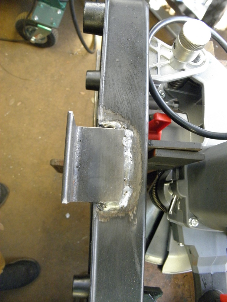

    Ironton 7 1/2 " metal cutting chop saw---- Hold down foot.
    Ironton 7 1/2 " metal cutting chop saw---- Hold down foot. Made from angle iron.

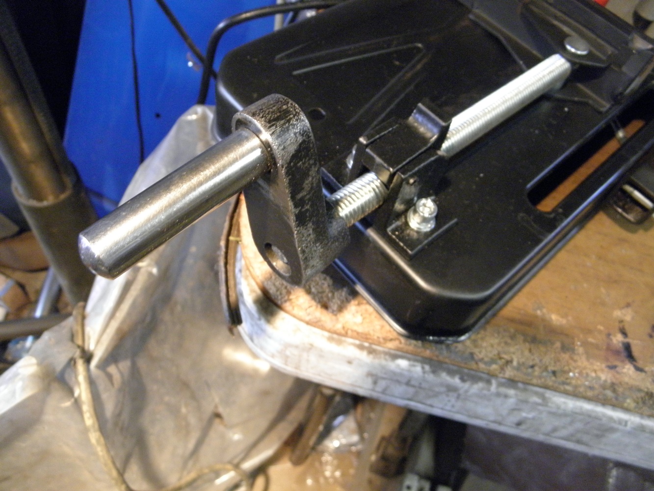

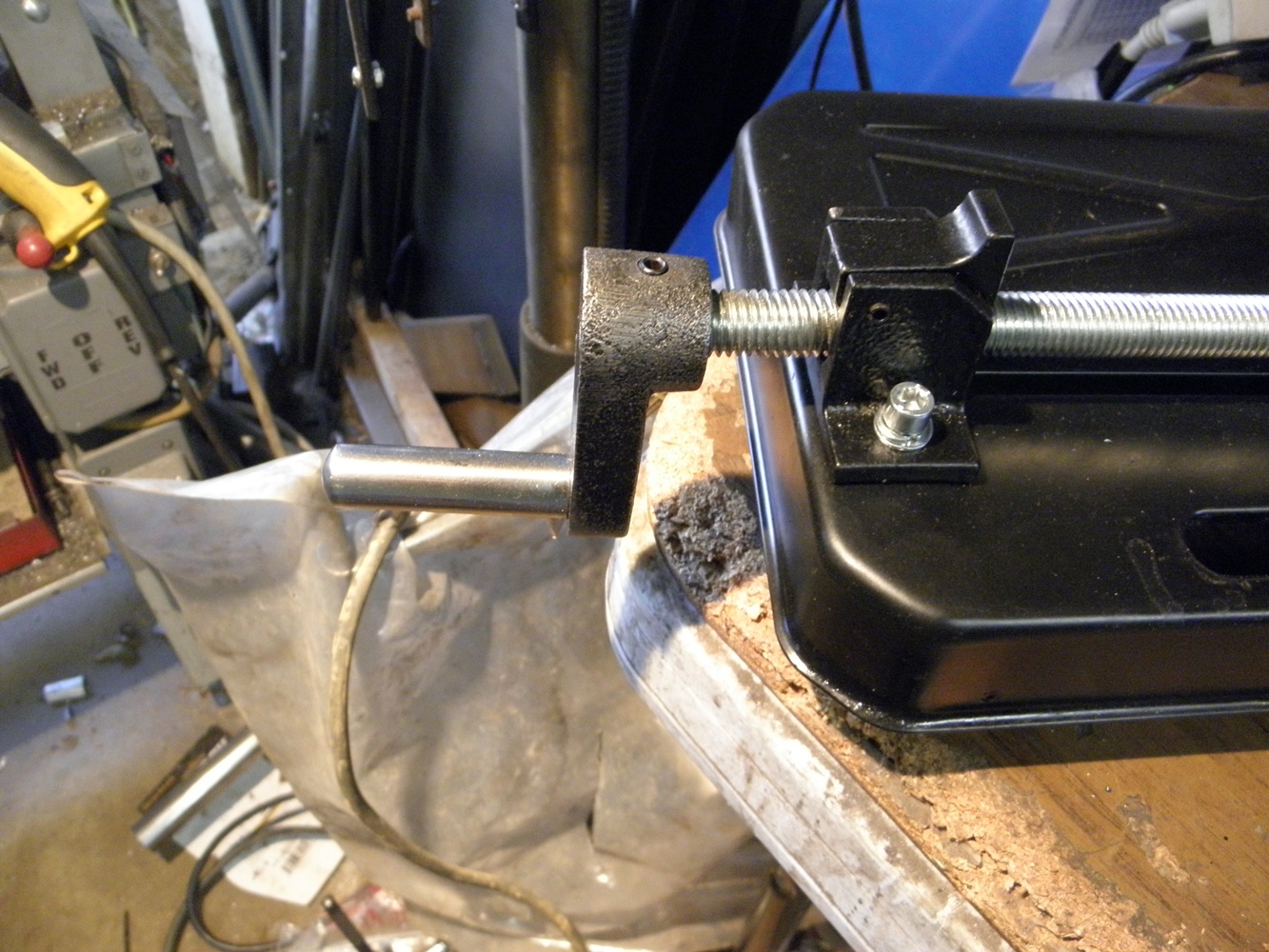

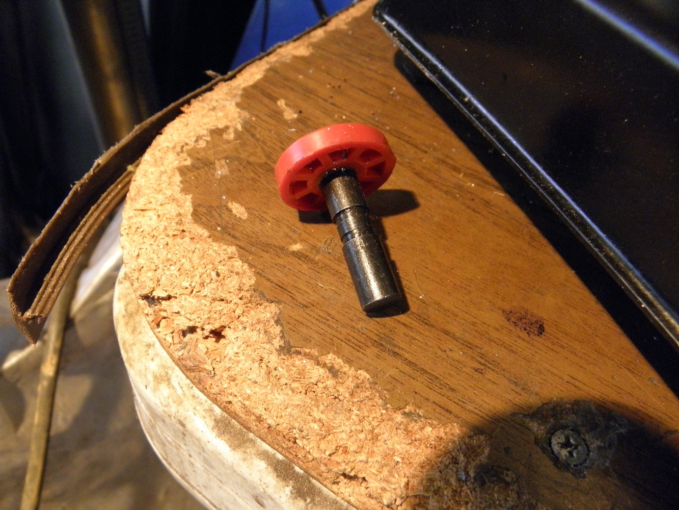

    Ironton 7 1/2 " metal cutting chop saw---- Lock down pin.
    Ironton 7 1/2 " metal cutting chop saw---- Lock down pin. Made from aluminum and steel rod.

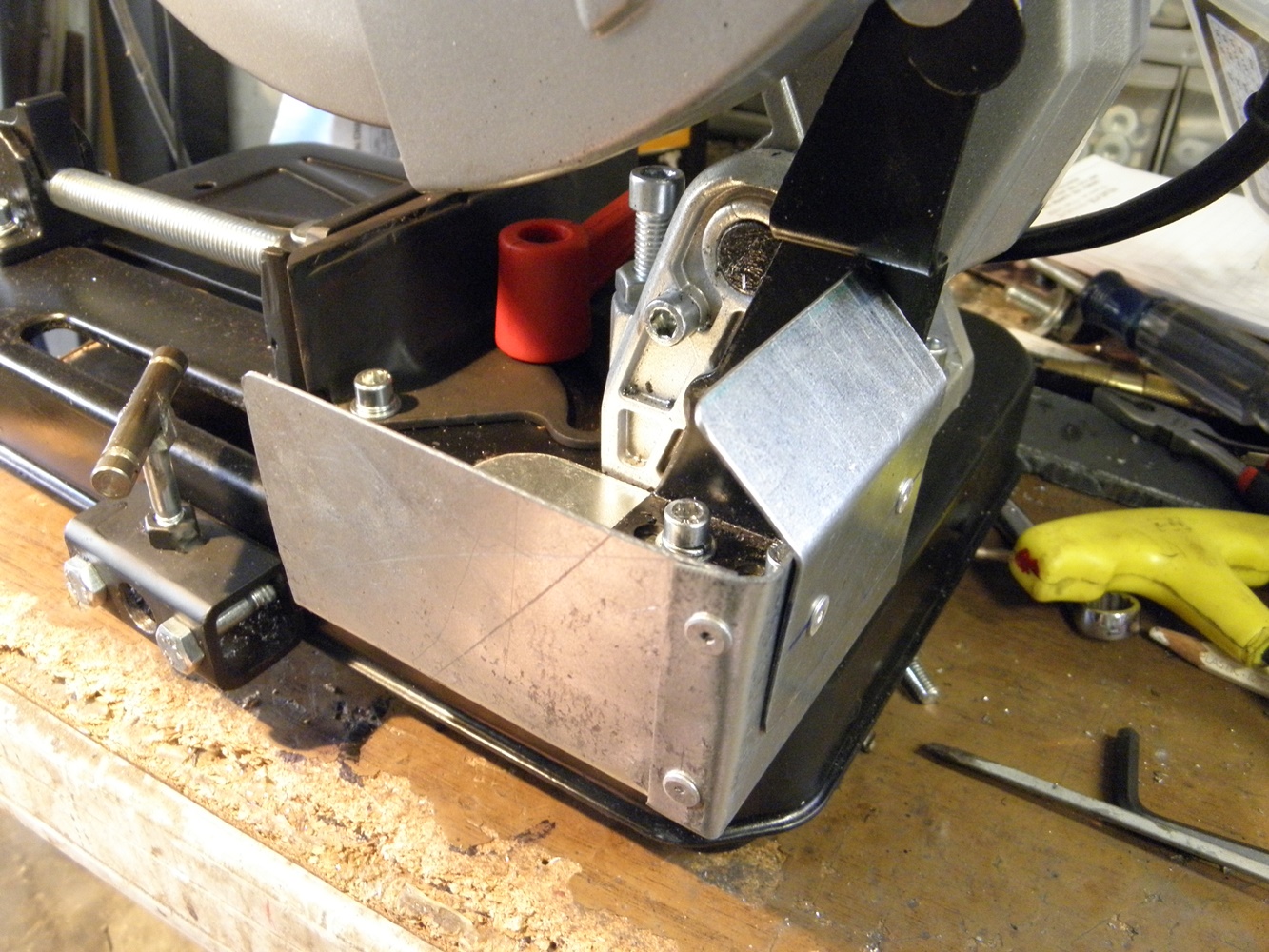

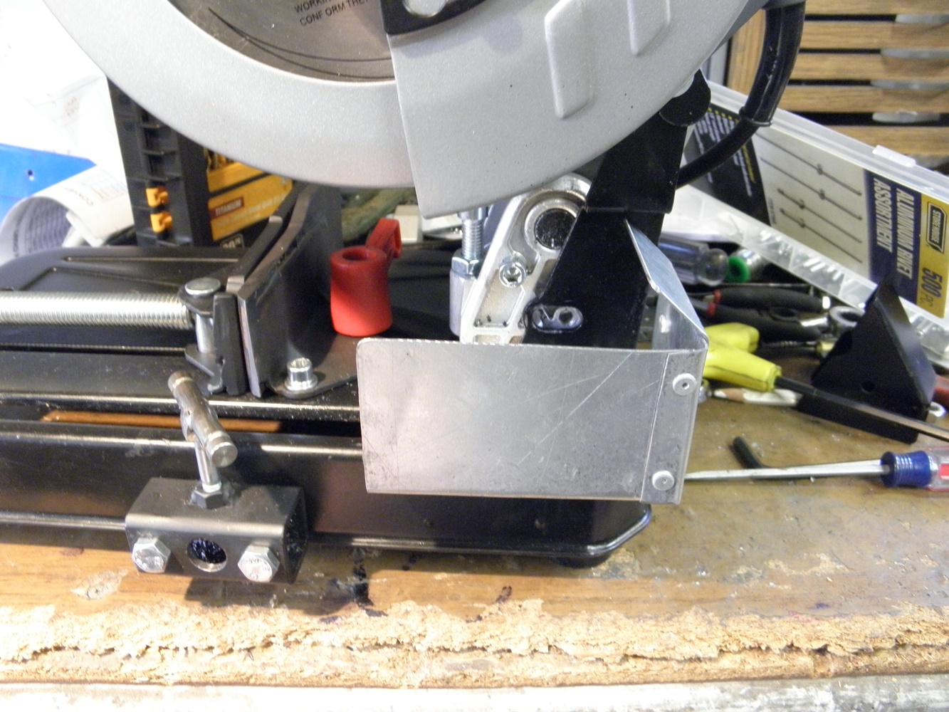

    Ironton 7 1/2 " metal cutting chop saw----Metal shavings Containment pan.
    Ironton 7 1/2 " metal cutting chop saw----Metal shavings containment pan.

    The only way to truly contain those nasty chips is to put a tent over it! lol
    In fact, I did something similar. I have an Evolution saw and use it outside only because my metal shop shares duty with 3 of my antique cars. A few times it was raining and I REALLY needed to use it so I put a small tarp over it just as I pulled the trigger and made the cut. It did the job! No old Chevy's harmed and I got the metal cut.
    I was thinking of maybe putting something together more permanent and made of clear vinyl or plastic. Just another idea I have floating around in my head...

    Thanked 20 Times in 14 Posts
