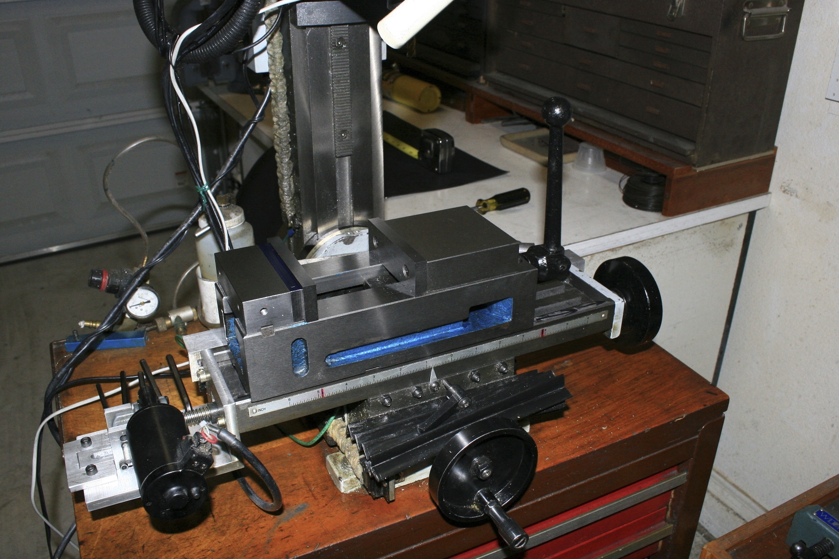

    I wanted to try this for a long time but most of what I read indicated that even a 4" Kurt style vise was too big for the Mini Mill.
    The vise shown:
    https://www.amazon.com/gp/product/B0...?ie=UTF8&psc=1
    Fits the Mini Mill and is quite useable even with the loss of a little head room.
    Another feature is the lack of an extended base for mounting. This vise may be mounted vertically if needed.

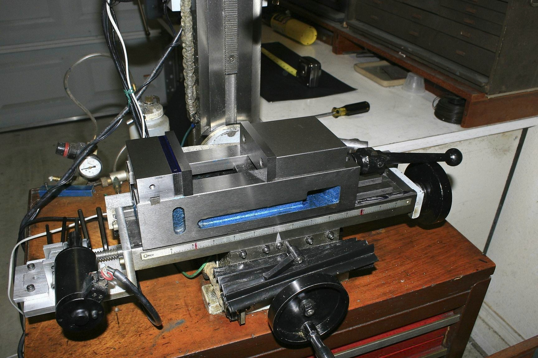

    Picture 0 shows the vise mounted along the X-axis. I do not have a picture of it mounted along the Y-axis.

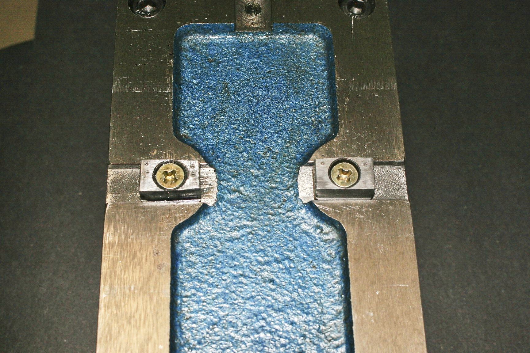

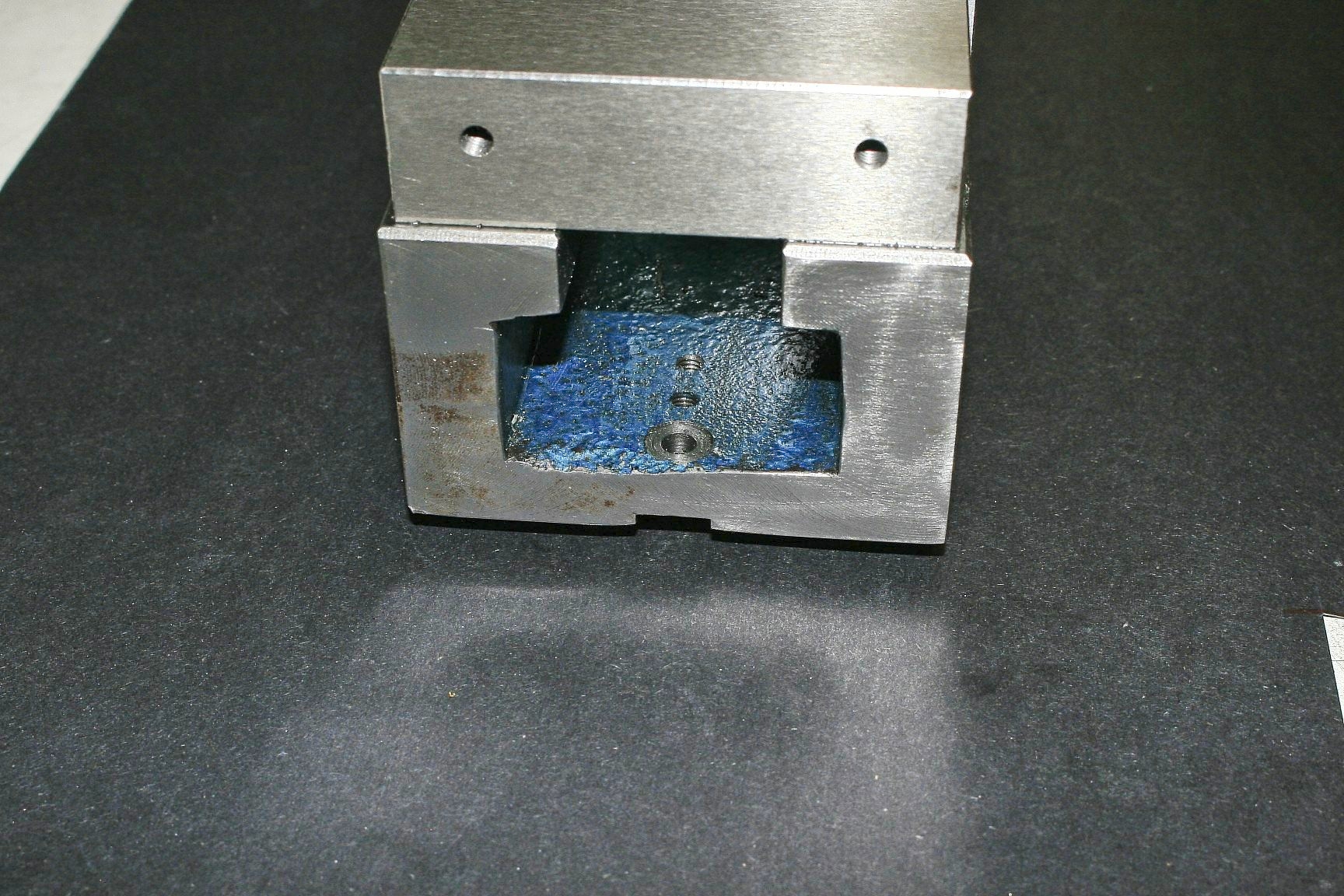

    In my setup I wanted a "quick change" mounting so I could switch out the vise for one of my other vises. The supplied keys were too large to fit my T-slots so I filed just a bit more than half the height so they fit my mill but still fit the vise. Proceeding slowly I was able to get a nice fit and maintain a good alignment. While the fit is not a slip fit there is enough clearance so that if the vise is always torqued slightly clockwise while mounting it I was able to file in the keys for an alignment to about .001" in 4" across the fixed jaw. Anything better and I just have to indicate it in. For some reason this seems to work in both the X and Y slots in the vise. (I think I just got lucky). The keys must be positioned exactly the same anytime they are moved from X to Y but I used a center punch to put matching dimples in each key and then on the vise base so they can always be put back in the same position. I still "clock it in" when I install the vise on the mill but it goes so much faster now! (Pics 1 and 2) Oh yes, I did hone the high spots created by the center punching!

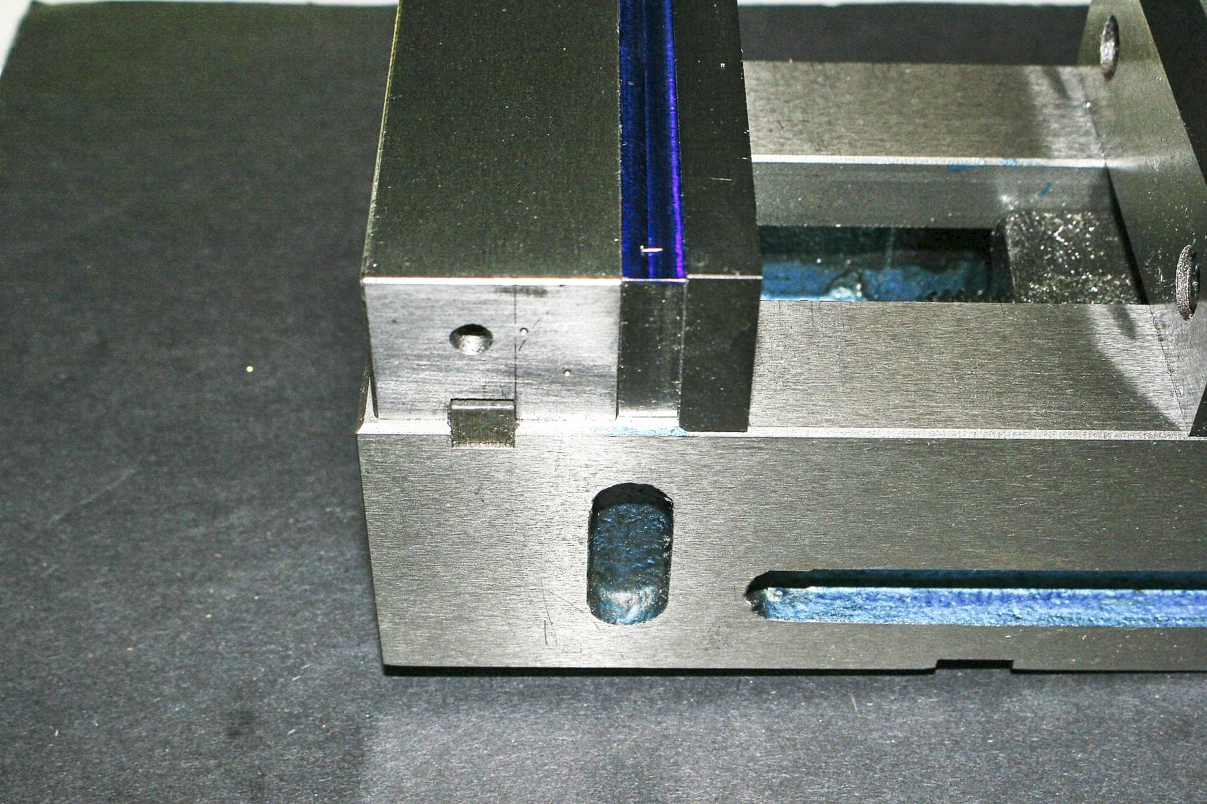

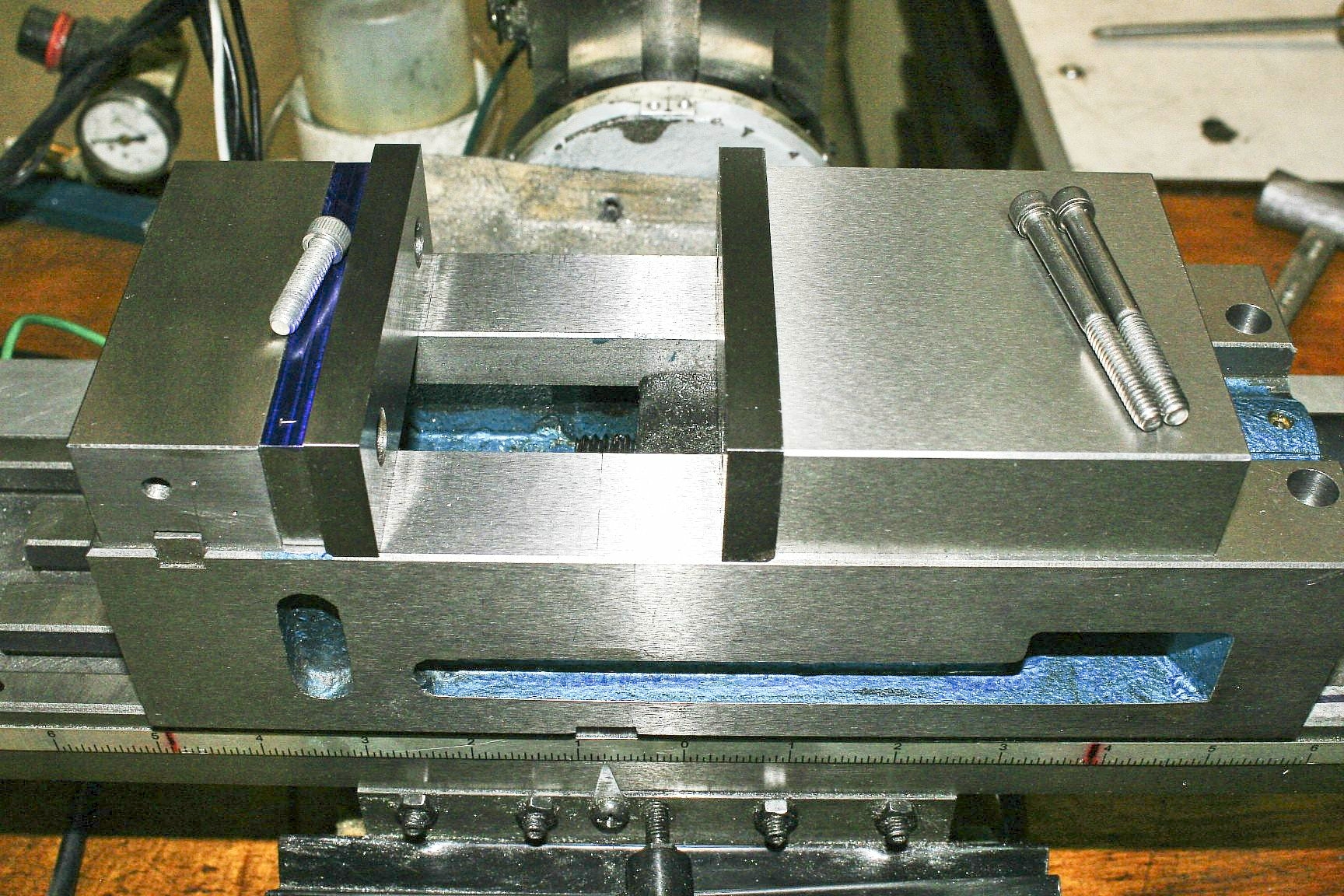

    I use the center T-slot when aligning the vise with the Y axis and that left my spindle with a 3/8 end mill not able to mill the edge of the part in the fixed jaw. To fix that I added a small steel spacer to push the fixed jaw out a bit and now I can reach the edge of the part in the vise. (Pic 3)

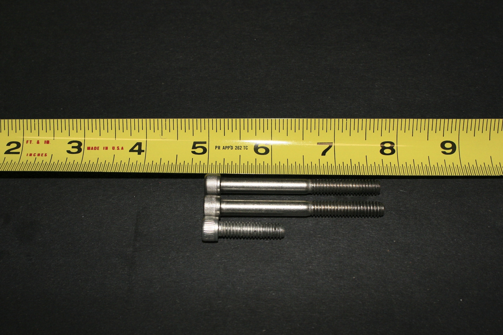

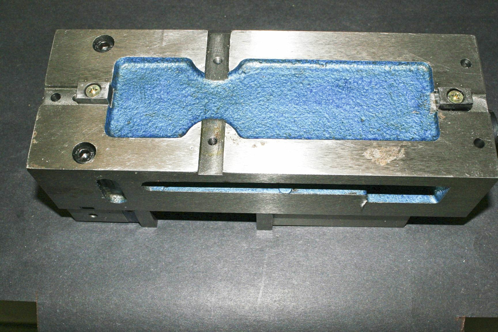

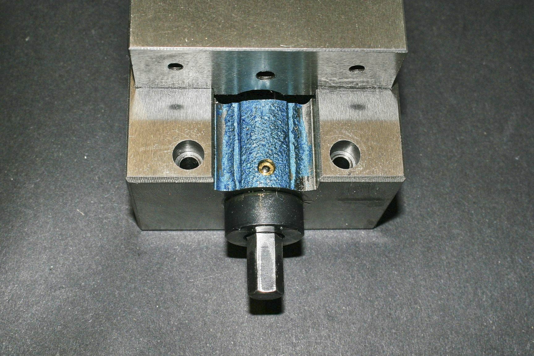

    Now I can use a 4" Kurt style vise on the Mini Mill when it is mounted with the Y-axis. But what If I needed to use the vise mounted onthe X-axis? Well there is a fix for that also. Just be ready to drill your new cast iron vise and void any warranty if there ever was one! I drilled and counter bored two holes in the back side of the vise that would accept 1/4-20 allen cap screws. These holes line up with the T-slots in the milling table and go into standard 1/4-20 T-nuts. For the front of the vise I needed to drill a clearance hole in the base for a 1/4-20 allen head cap screw for it's T-nut. I still use the modified keys to get a course alignment of the vise and then clock it in. That is all there is to it. (Pic 4 and 5)
    One other minor add was the 1/4-20 threaded holes in both ends of the fixed jaw (Picture 3) so I could use my previously made vise stops.Just watch out not to drill into the existing holes already in the fixed jaw.
