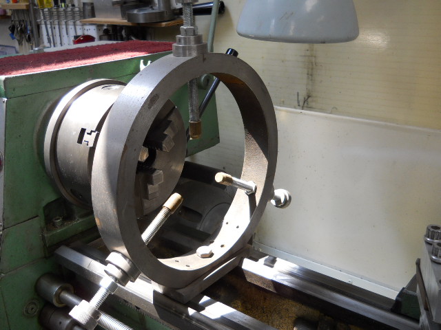

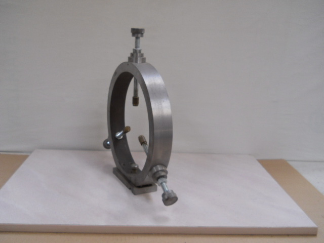

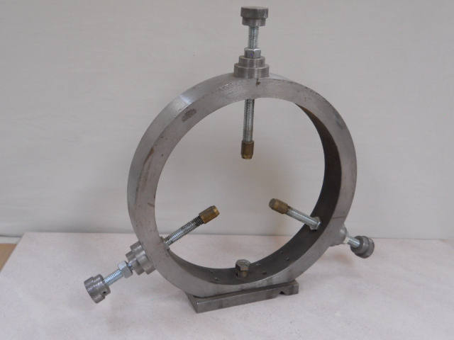

    This tube support was made to square off the ends,ran lathe at slowest speed to prevent tube from creeping out of chuck jaws.
