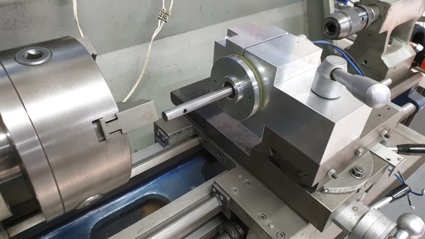

So I often find myself in a bind when wanting to drill an offset hole in a workpiece. Drilling from the tailstock only allows for holes drilled dead center in the workpiece. I have had this idea floating around in my head for some time now, so decided to get going and see whether it would work.
The idea was to mount a drill in place of the toolpost. However, mounting a normal handdrill was a bit of a mission and I wanted something dedicated to the lathe.

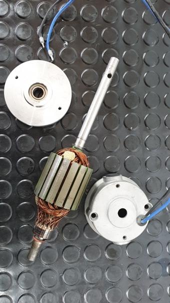

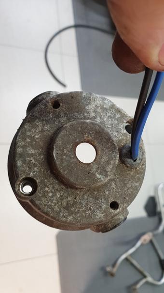

First off was to source a motor, so I paid a visit to our local gate automation go-to guy, who kindly donated a motor from and old Centurion D5 gate motor.

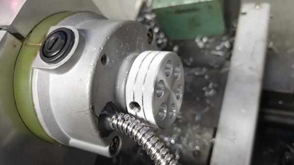

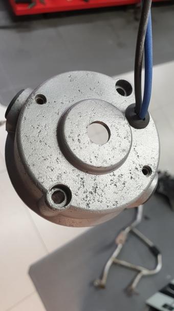

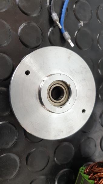

The motor needed a few measurements and modifications, since the mounting method would change completely. The motor was stripped and cleaned.
Attachment 31139 Attachment 31140
The front face (top left) which was originally square with 4 mounting holes in the corners, was turned down to just a tad smaller than the motor body.
Attachment 31141 Attachment 31142

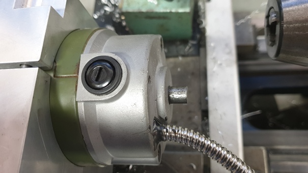

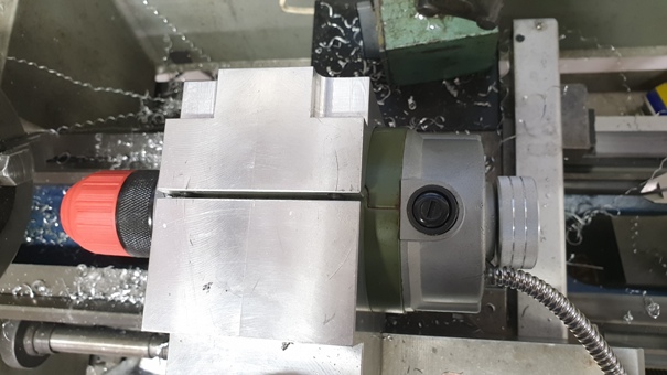

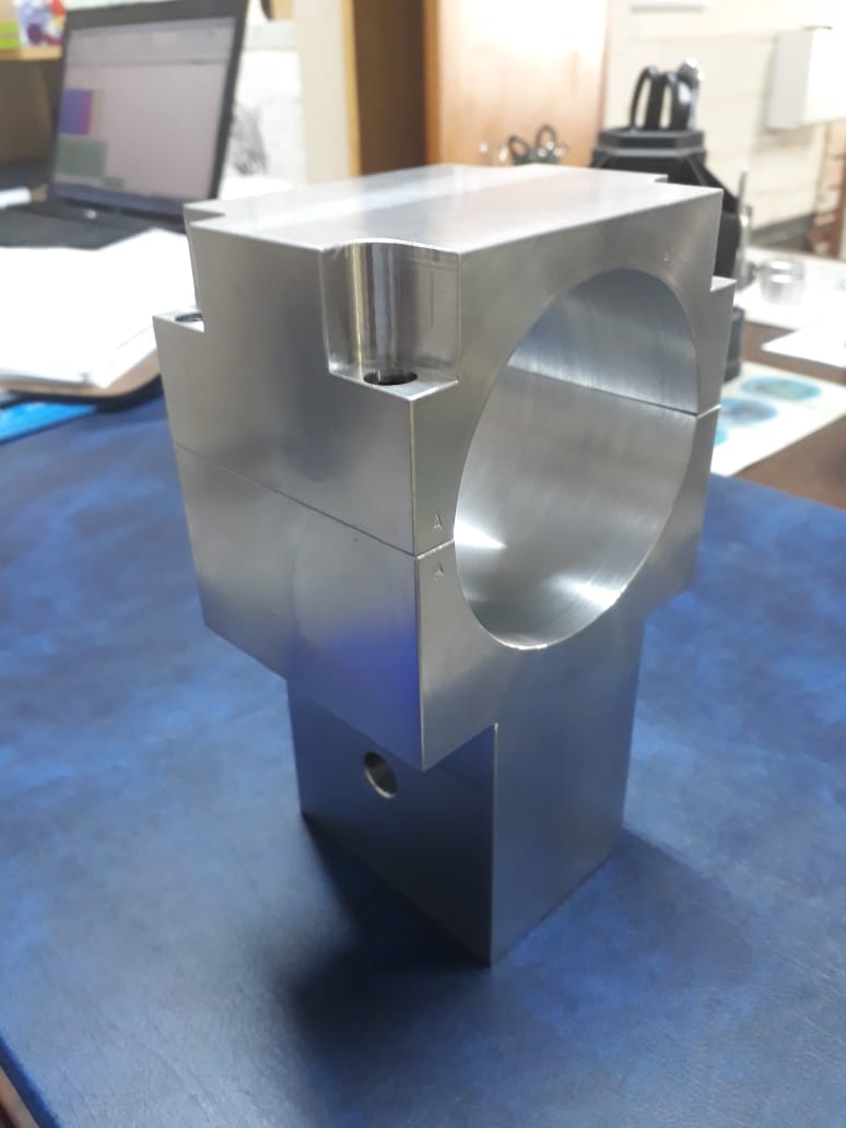

Then, with measurements in hand, I paid a visit to my friendly machine shop that made the new mounting for the toolpost.

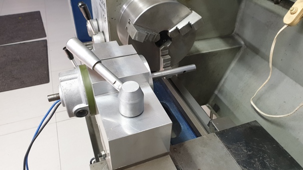

Attachment 31143

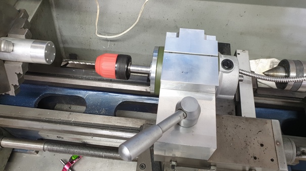

Machined so that it can be flipped over and still be dead center, it fits onto the lathe in place of the toolpost like this.
Attachment 31144
Or like this
Attachment 31145

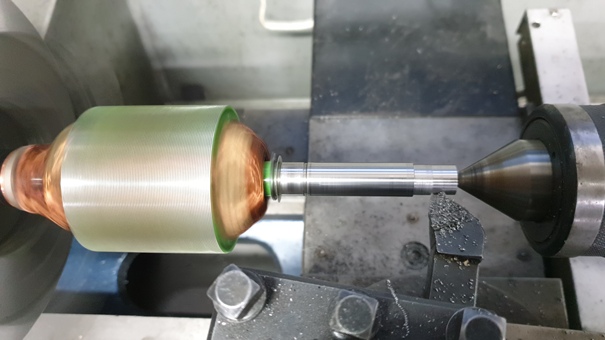

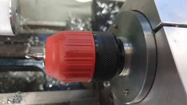

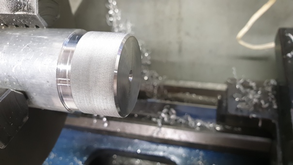

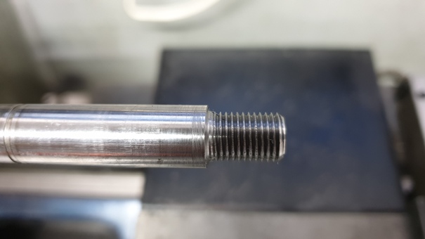

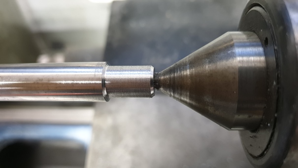

Next was to cut the shaft shorter and turn it down
Attachment 31146
Attachment 31147
to accommodate a 3/8 X 24 thread.
Attachment 31148

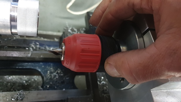

Onto which a keyless chuck has been mounted.
Attachment 31149

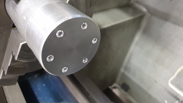

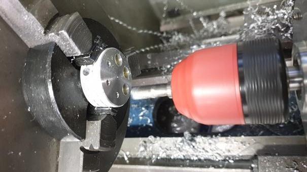

I can now drill holes like this. :D :cool:
Attachment 31150

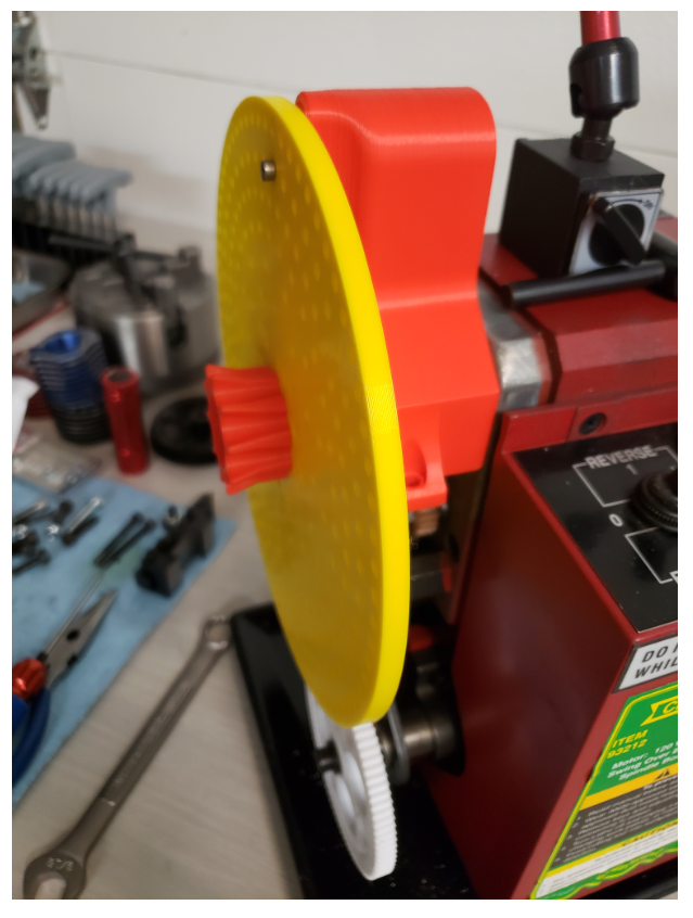

Next up is to get my indexing wheel sorted.
