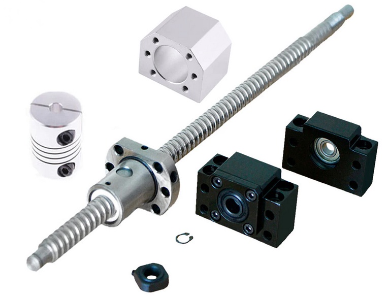

Definitely not serious; I just couldn't resist... Actually, I'd consider this upgrade for my Taiwanese 12 x 36, especially if the LH ball screw was available.
[edit]
I just checked at Thompson; they list a 5/8"LH w/ 0.2 lead, 6' long [https://www.thomsonlinear.com/en/product/190-9099]
The nut [https://www.thomsonlinear.com/en/product/8106-448-037] needs a screw-on flange [https://www.thomsonlinear.com/en/product/8105-448-002]. You'd have to machine the shaft to fit, and I haven't researched the fixed & floating bearing options.
Many thanks for that. BTW your links returned "product not found" responses but if I copied and pasted the PNs from your links in their search box it had no problem finding them. The screw on nut mounting is like I have on the Z axis of my mill, it would have been much easier to fit on the lathe than the flanged nut that I got.
Mariano found some LH versions of the same size on Aliexpress. I'll order one. here is the link for anyone else who is interested.
https://www.aliexpress.com/item/1005...archweb201603_
...the sizes being 16 & 20 mm diameter?
sometimes hard to understand Chinese specs
