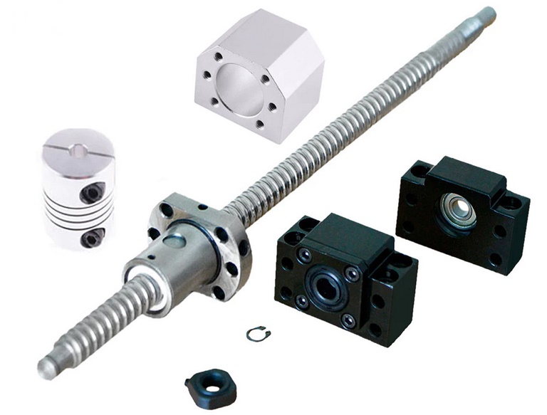

    Its project is interesting, it is a pity that you will have to get used to the inverted advance of the cross slide (not that this is the end of the world). A search on a famous chinese sales website could have helped before the purchase...

    I am at a loss to decide if this is a serious comment or not.
    Definitely not serious; I just couldn't resist... Actually, I'd consider this upgrade for my Taiwanese 12 x 36, especially if the LH ball screw was available.
    [edit]
    I just checked at Thompson; they list a 5/8"LH w/ 0.2 lead, 6' long [https://www.thomsonlinear.com/en/product/190-9099]
    The nut [https://www.thomsonlinear.com/en/product/8106-448-037] needs a screw-on flange [https://www.thomsonlinear.com/en/product/8105-448-002]. You'd have to machine the shaft to fit, and I haven't researched the fixed & floating bearing options.

    Quote Originally Posted by machining 4 all View Post
    I am getting used to it, slowly. The truth is that I never gave any thought to the hand of the thread, I just ordered a screw assembly. Since then I have searched for LH versions without success.

    Quote Originally Posted by dagrizz View Post
    Many thanks for that. BTW your links returned "product not found" responses but if I copied and pasted the PNs from your links in their search box it had no problem finding them. The screw on nut mounting is like I have on the Z axis of my mill, it would have been much easier to fit on the lathe than the flanged nut that I got.

    Mariano found some LH versions of the same size on Aliexpress. I'll order one. here is the link for anyone else who is interested.
    https://www.aliexpress.com/item/1005...archweb201603_

    ...the sizes being 16 & 20 mm diameter?
    sometimes hard to understand Chinese specs
    1605 and 2005 seem to be fairly standard specifications from what I have seen. !6 or 20 mm as you surmise, both with 5 mm pitch.
