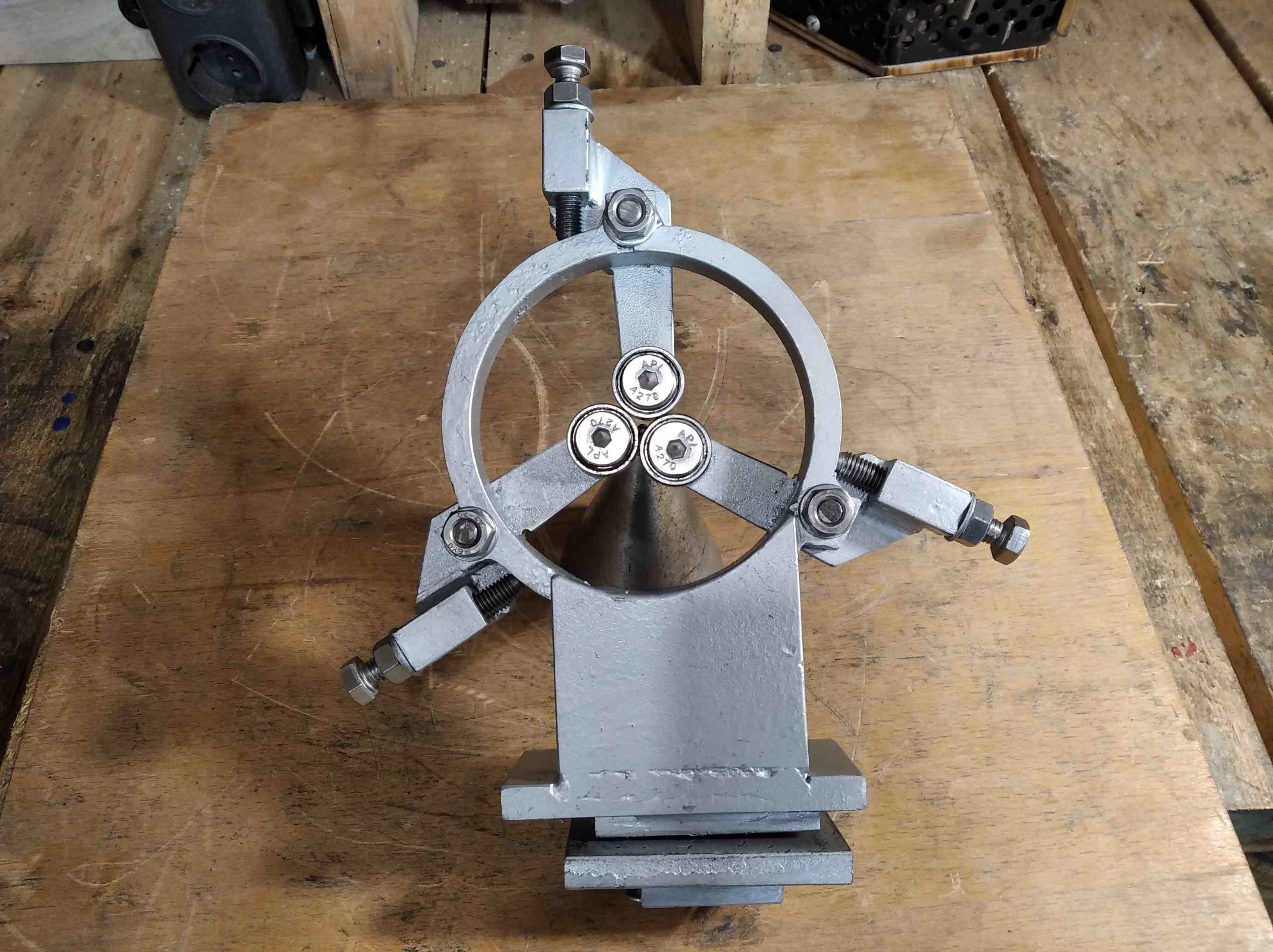

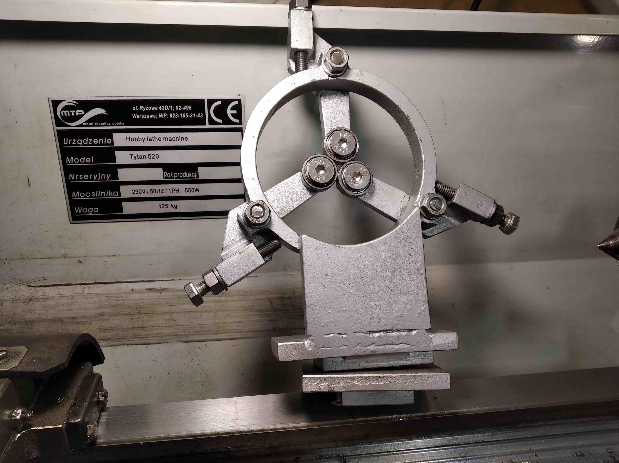

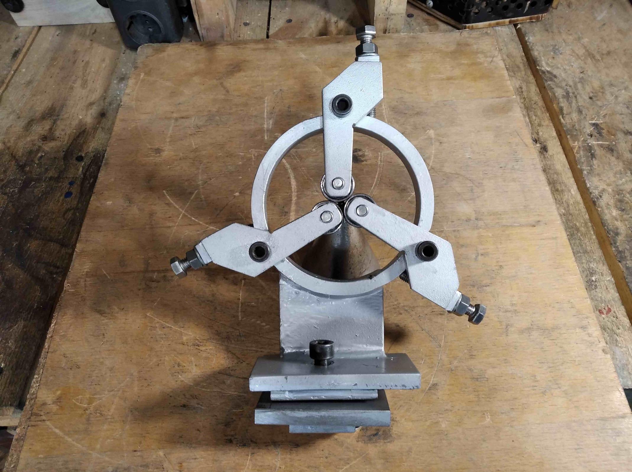

    I will show you the rest of my authorship.

    This looks good. I have been wanting to make a fixed steady for goodness knows how long and this gives me an idea for a simple effective build.

    That is one nice build. Certainly nice to see a different approach to an age old device.

    I really like it; especially by leverage taking place of small diameter fine threads for accurate adjustment! Brilliant, no question. And the frame, a section of heavier wall pipe/ tubing, points out many alternatives to heavy castings.
    Again, Terrific concept. In one way, not surprising, you do such good fabrication work on those sanders and grinders.

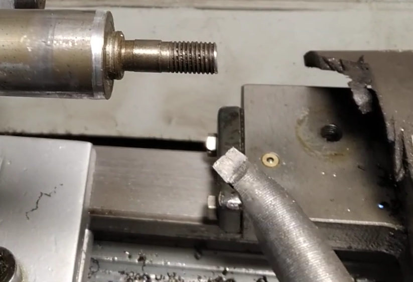

    Does anyone know why the lathe tool had that texture from the toolpost to the shaped cutter? While I was watching it in use, I kept wondering what would have made those marks and are they there for some particular reason, or are they just an artifact of the manufacturing process? I thought it was a spring in the video's thumbnail, which begat many more questions. Oh, and the steady rest is very nice, too.

    Quote Originally Posted by schuylergrace View Post
    Hard to know what period you refer to, out of 15 minutes of video. Hover cursor at the general frames in question and the time is displayed. Closest thing I see resembling a spring occurs turning OD of the spud outboard of the steady rest; it's cutting through crests of threaded portion. Change in profile and surface finish makes helix of thread root a bit more visible.
    About half-way through, when he starts machining parts, I noticed the tool he is using, not the part he's making, has what looks like machining marks running around its circumference from the tool post out to where the cutter is ground. The texture is almost like the tool was 3D printed. I'm guessing it may have been cast, and those are marks from where the mold was originally carved out. It doesn't have anything to do with the piece he's making, just something odd I saw and couldn't figure out.

    Isn't it just coarse feed turning marks? Guess he DIYed the tool out of square stock, turned a taper to it,
    then torched the tip and bent it before he finally brazed a carbide tip on it?

    Quote Originally Posted by DIYSwede View Post

    Ooooooh, the cutter! Little too focused on the work; typical for me.
    But DIYSwede has explanation of what is uber plausible. That taper and finish marks fit right in with hand generated cutter movement.

    I'll bet that's it! The bend threw me for a loop, but you're probably right. I guess I was trying to think too hard about it. I wondered why I smelled bacon burning...
