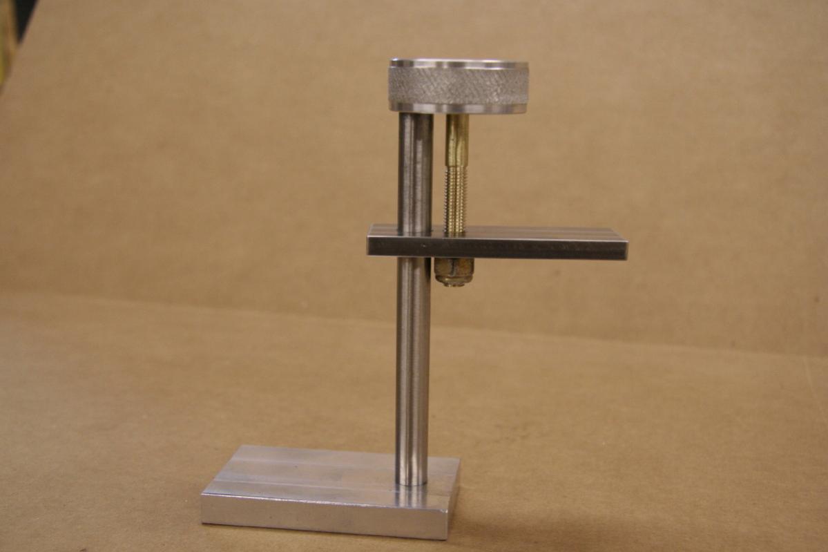

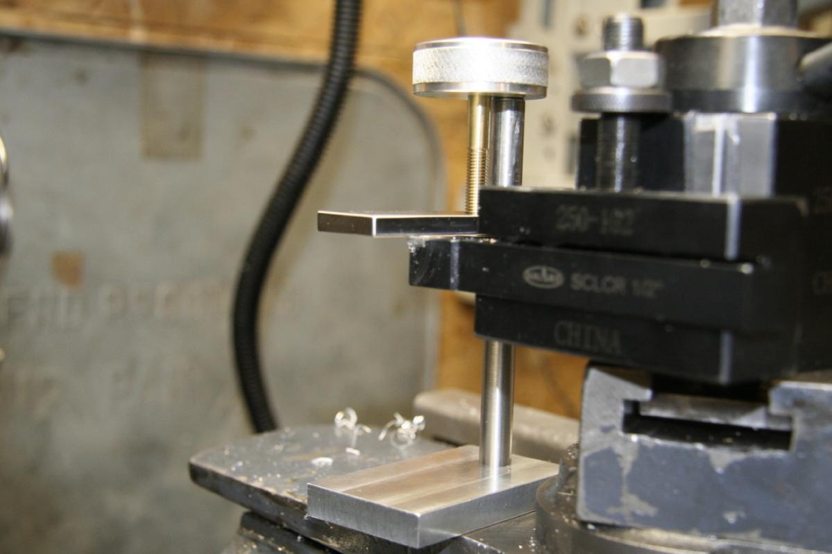

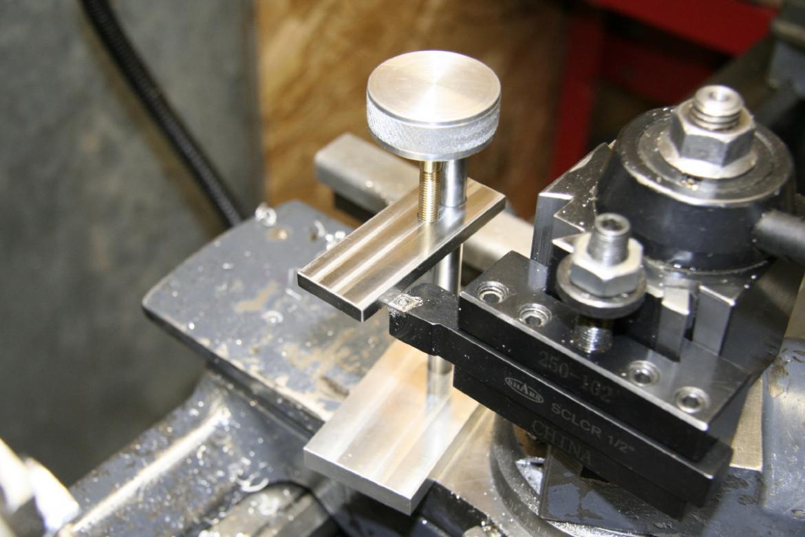

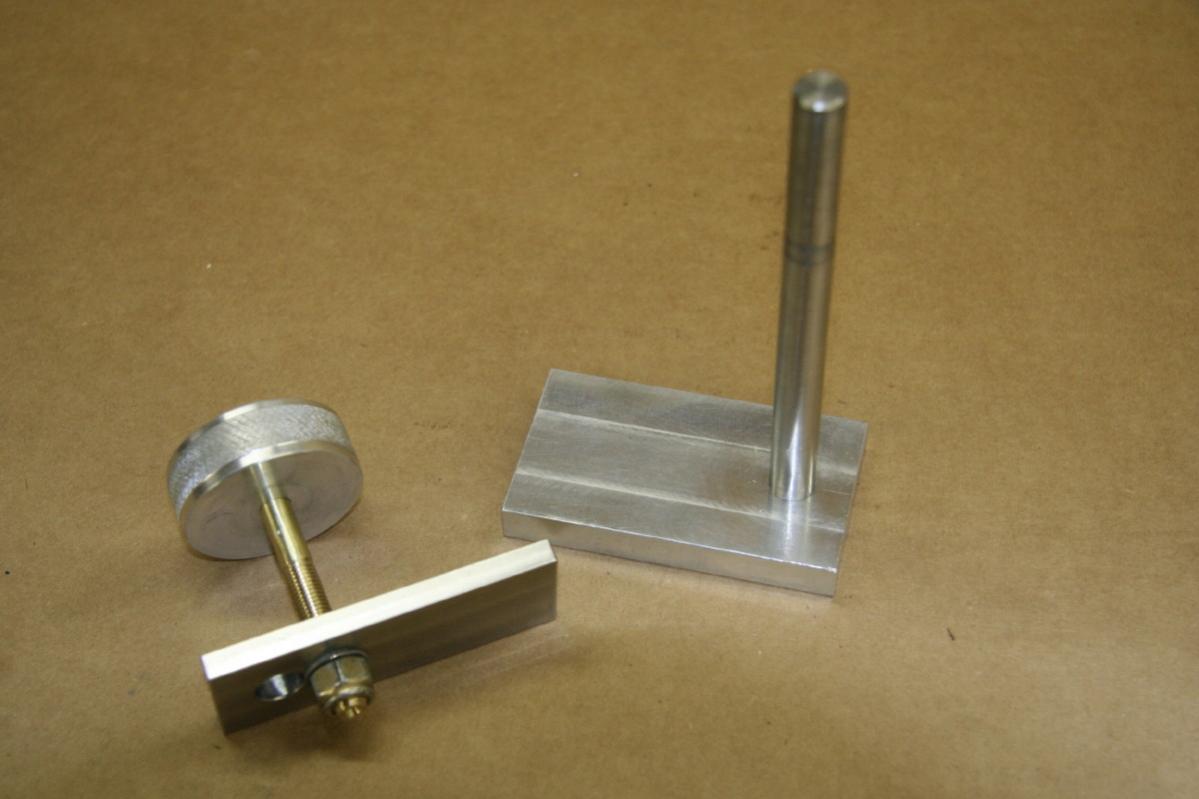

    My new Lathe Tool Height setting gage. 6061 Alu base & knob, stainless rod 3/8" & height bar, Brass 1/4" rod, 1/4-28 Nylok nut. I got tired of eyeballing the height. Made from the scrap box.Lathe Tool Height Setting Gage-lathetoolgage1_1.jpgLathe Tool Height Setting Gage-lathetoolgage2_1.jpgLathe Tool Height Setting Gage-lathetoolgage3_1.jpgLathe Tool Height Setting Gage-lathetoolgage4_1.jpg

    Forgive me if I missed something but is it adjustable? If so why would it need to be?
