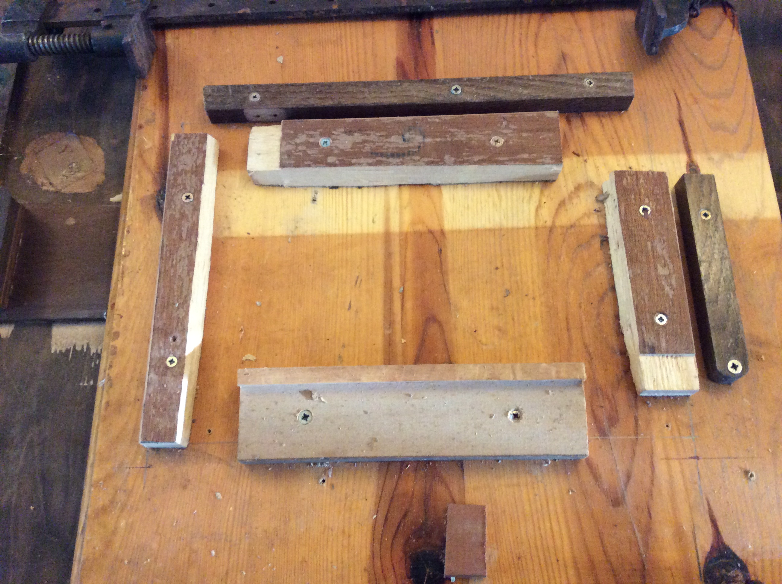

To ease the difficulties I made a jig to hold the sides vertical and square to each other
Attachment 41189

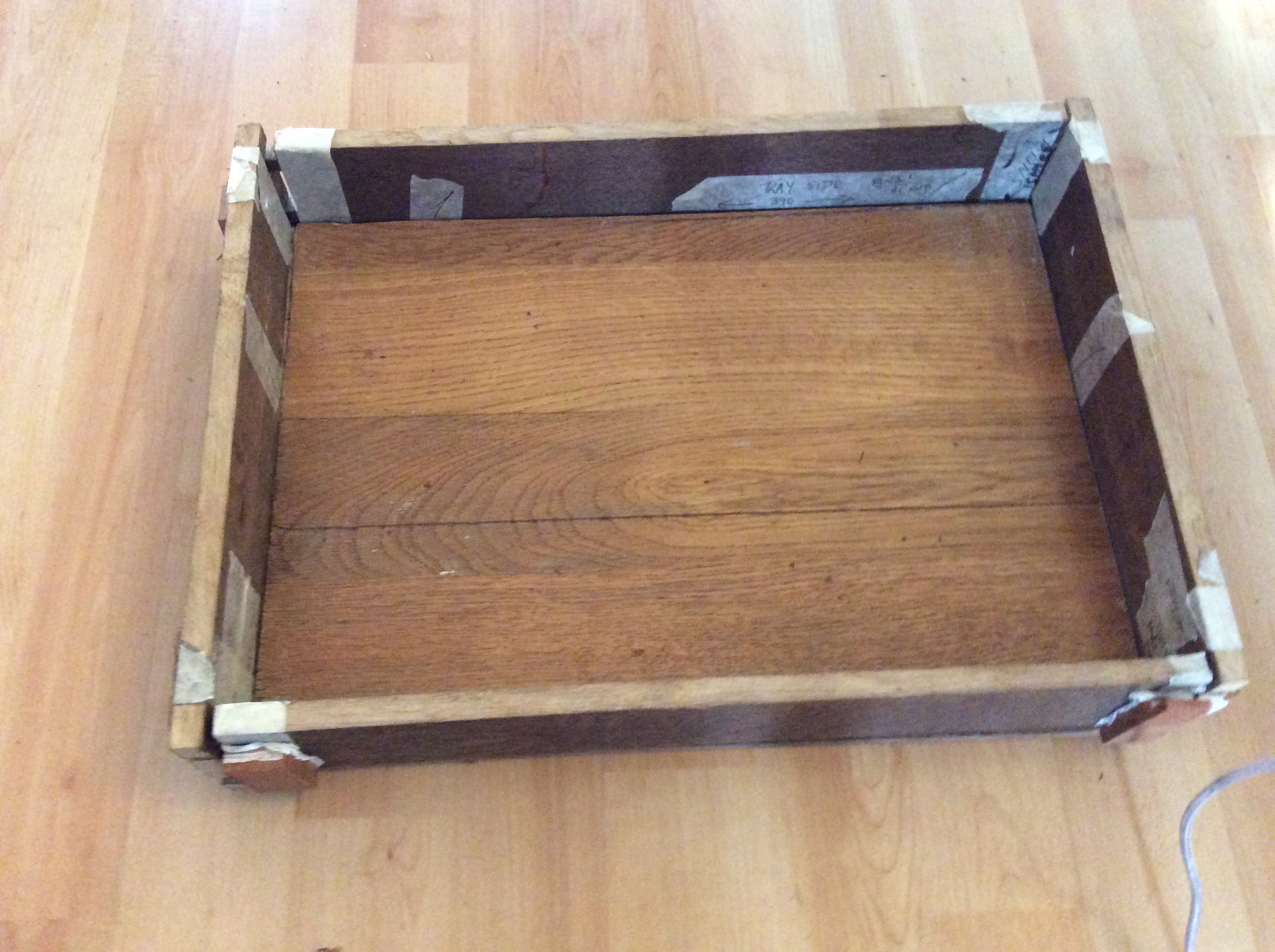

Next, the carcass is tried in the jig. You can see masking tape all over the place. This helps to orient the pieces, and lots of instructions have been written on them prior to cutting, which I MUST read, or I will do something wrong and have to cut some more material. The tape also protects against glue stain. And on that subject, I wear disposable gloves. Or the stains on fingers last for days.
Attachment 41190

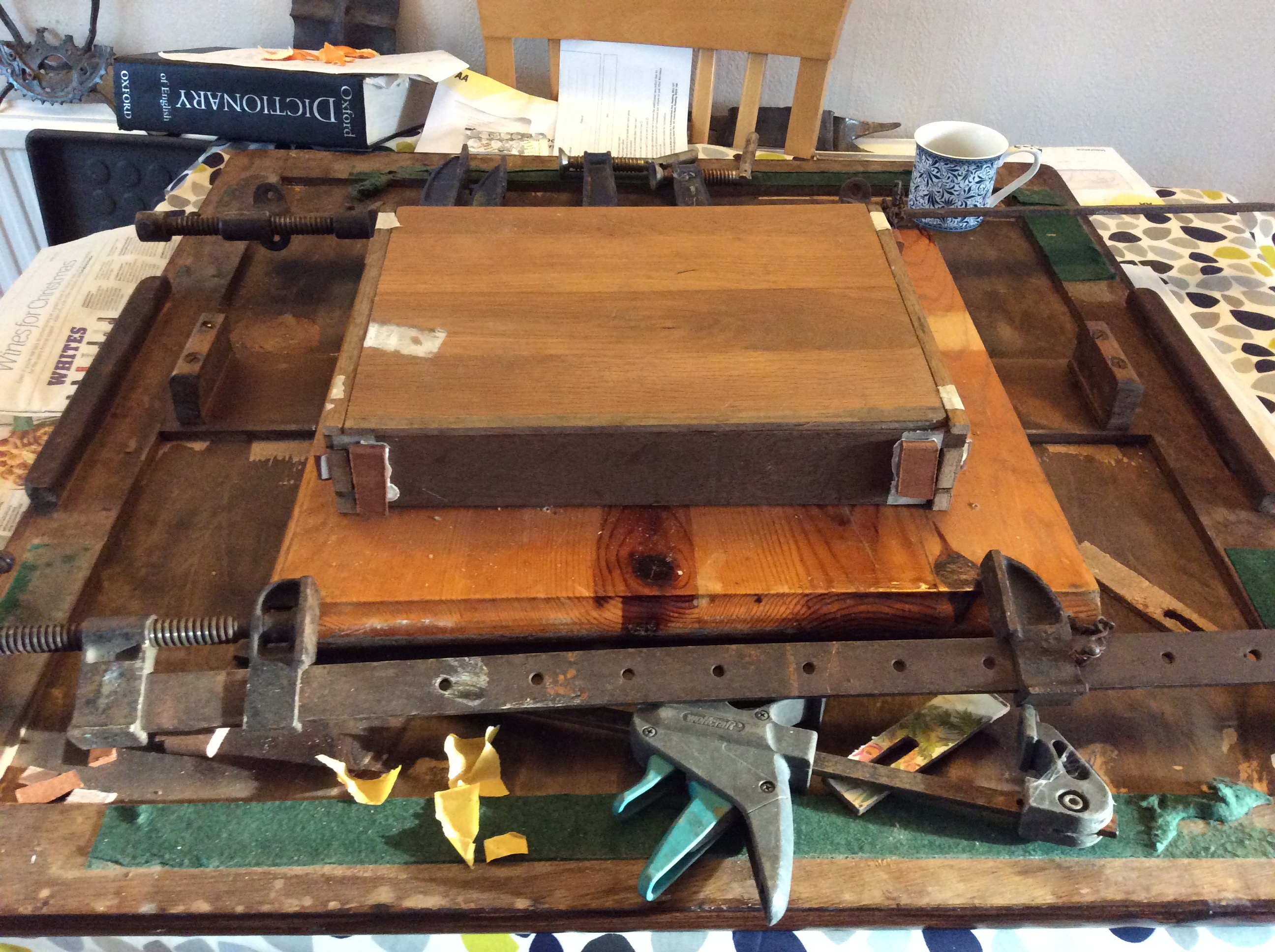

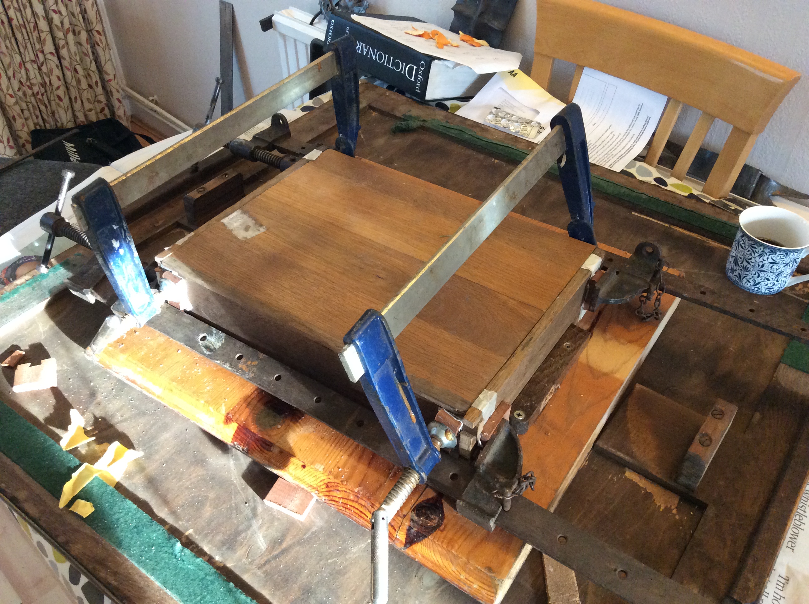

I had two goes at positioning the clamps. I have attached pads to the sides using double sided tape.
Attachment 41192
That was a dry run.
Now glue has been applied, clamps set, and fingers crossed.
