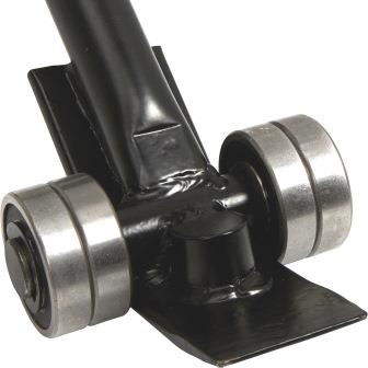

    This exact same tool is available from Northern Tool for $66 - $79 (depending on sale).

    Hi Saltfever, yes very similar - but not available in Tasmania that I could find.
    I had found that image and used it (and others) as inspiration for my build.
    I deviated from it in the following ways: rectangular tubing replaces the bumper and the round tubing (stronger lever arm and smaller parts count), and simpler to make the end fit around the axle. The toe and heel are also made thicker. 1/2" thick compared to what looks like 3/8". Also, I don't reduce down the toe quite as much. Mine finishes up at just under under 1/4" at the tip, less of a knife edge.

    I find the knife edge is very useful for equipment that is flush to the floor. Usually you can grip just enough and lever up the machine to put a small shim under it to create a better gap and gain a better grip. I plan to attach 2 wheels in back of some heavy equipment and fabricate some kind of attachment on to the lever-bar so I can raise the equipment onto the back wheels and steer equipment around the shop. The product is made in China and most likely importers all over the world have it in their catalog somewhere. Great video quality . . . nice job.
