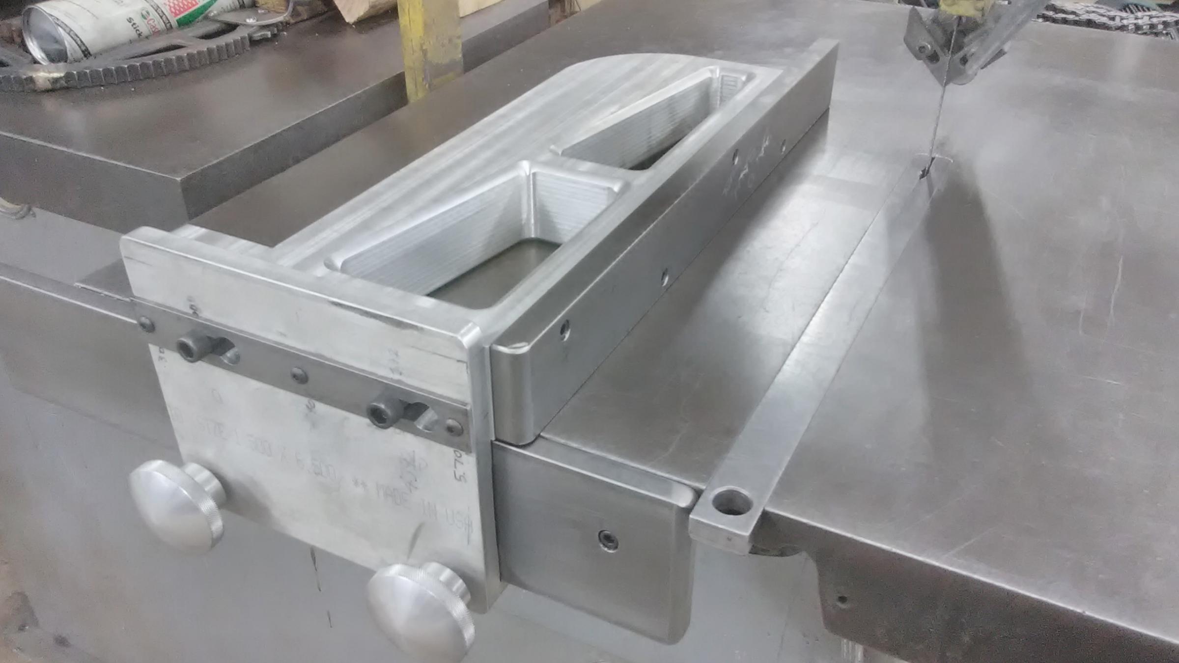

I have order for 16 swing bolts 2" diameter, 18" long. I've made these twice before. They've freehanded them for decades. My second piece, umm no thanks. I'll clamp a bar of CRS to table. OK, but tedious setup. First op center drilled each end carefully, only way to get decent 2" threads in 2" thick stock, supported by centers, dog driven.
All remnant and drop material. Aluminum
rescued from waterjetted plate of unrelated levers.
Cold rolled rail and face.
Attachment 28824
Sliding along front rail, position secures very
well via knob clamp screws. This view has cap screws in
key slots and strip washer. That allows easy removal, whereas
blade obstructs each side.

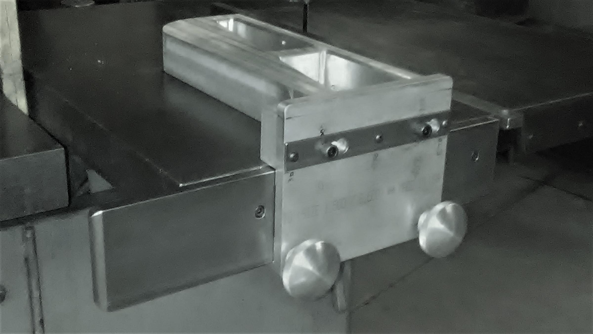

Attachment 28825
Parallel sides make setups far
easier to machine. Ultimately will saw big radius off to
natural, space saving angle. Interior wedges
sawn by drilling, passing band blade through
and rewelding. Done, just recut blade.

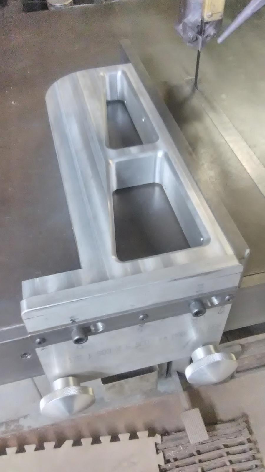

Attachment 28826
Commercial hardware;
cap & set screws, all thread, hand knobs, jam nuts.
Clamps are slightly less spread than set screws.
Set screws, fine threaded, adjust squareness.

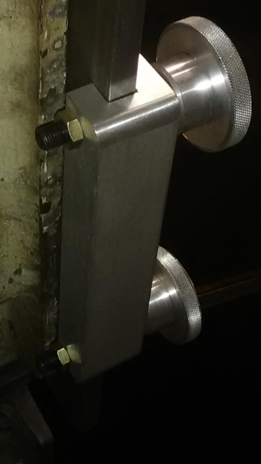

Attachment 28827
No plans. No plans needed other than tape measure.
Motivation,
Factory version just under $1000.00 USD.
Nice; and heavy duty very positive clamping.
