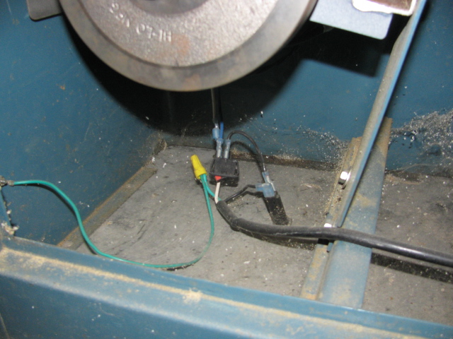

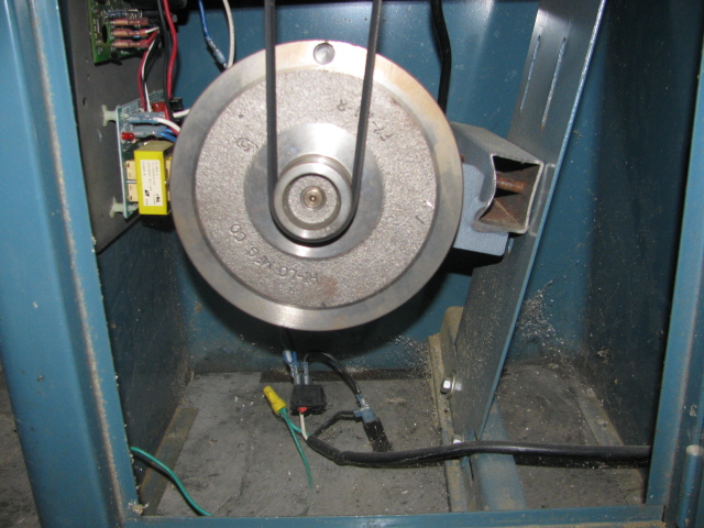

    Great pix jere! Much better idea of what you are talking about here. Now this is just me, and I'm not trying to be prescriptive here, I'd be all over that old motor base plate to build an adapter on it. But that's just because I see the old motor as a liability, sorry. And with the thought of it out of the way modding that base plate would probably mean making a motor mount out of the dc motor mount(basically like Jonathan suggested, but using the old parts) and as long as it's centered and square with the old plate then it's only the depth and having enough shaft of the dc motor sticking out. Bad thing is you're going to have come up with a seal on the motor shaft because of the gears running in an oil bath.
    Then I would drill some good sized holes on the bottom of the main case for air flow and on the bottom to help with the filtering. And take the old end casting and where the embossed(?) parts are, take them out for the other air flow. Drill, cut, whatever, and put screen or whatever over them. Then you can bolt the old motor casing and end back on.
    In my studies on dc it's supposedly a pretty flat power curve so when you run them slow they don't get as weak as an a/c. The only bad thing is the lowered air flow. I wish I'd known about treadmill motors when I did my redo on my bandsaw because every once in a blue moon I do some wood and miss the high speed. With this set up no changing pulleys no muss no fuss potentially.
    Just my deflated 2c.

    Thanks for the new Pics Jere. The more I see the more I tend to agree with C-Bag about using the old housing but I would probably just save the whole motor for later in case parts should show up. The old housing isn't going to be long enough anyway and will need another shroud to build anyway. IMHO I think it will be much easier to build a front plate for the DC motor to match the flange pattern which also might help with your gear alignment and if possible just leave the existing fan on the front of the treadmill motor. You can probably find a piece of 1/4" plate at the scrap yard for cheap and work from there for brackets and such.
    As for lube and chips/dust a shroud could be formed from AL or old sign material to keep the big hunks out and supplement it with your pantyhose idea for finer stuff but it will restrict the airflow. At high speed for wood work it should be fine but prolonged low speed metal work Will generate more heat and have less CFM because of the speed. Have to ponder it a while. For Lube I use white lithium grease for pressure type lubricant as it holds up well and it doesn't take on chips or goobers like oil. Additional concerns would also be about sealing the shaft/air openings on the DC motor from a sump/splash oil system also...even mist would get in there pretty easily and probably wreak havoc.
    Very Cool you found the mfg. date on the housing!! ~PJ

    C-Bag, PJ, thanks very poignant thoughts, all you guys are helping make this project turn out better than I would have done on my own! If all goes as planned I will start cutting layout "chip board" and start cutting metal.
    I bought a section of ¼" plate that was scrap from a fabrication company yesterday. Scrap yards in my area won't sell to the public. (There are 3 within 2 miles of where i live too )If I am dropping off there and find some good pieces I can "trade" .
    I will have to put some more thought on how much or little of the original motor housing I end up using. Fitment issues might just dictate my options too, so I will get started with what I can do.

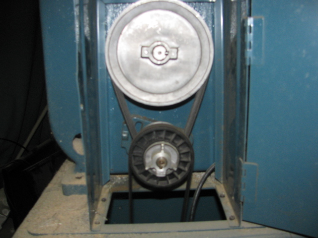

    Here is an explanation of the numbers for the length of belt that you need. This is a Gates number==380J8. 38 meaning the length O.D. in inches,- J, meaning a micro poly-groove V belt and the 8 meaning 8 grooves. Here are some pictures of the treadmill motor setup on my bandsaw, hope this helps. The motor rests on a plate that is hinged and the weight of the motor tightens the belt. Robert Brown. If you have any more questions, please ask. The controls are upside down because that is the shape that fits the top of my saw. If you don't want to use the whole console, I suggest that you get the type of controls that either have a slide type control for speed or a round knob type and then you can relocate the controls elsewhere so that it doesn't ugly up your saw.Looking to add a treadmill motor to a JD Wallace vintage bandsaw.-img_2213.jpgLooking to add a treadmill motor to a JD Wallace vintage bandsaw.-img_2214.jpgLooking to add a treadmill motor to a JD Wallace vintage bandsaw.-img_2215.jpgLooking to add a treadmill motor to a JD Wallace vintage bandsaw.-img_2216.jpg

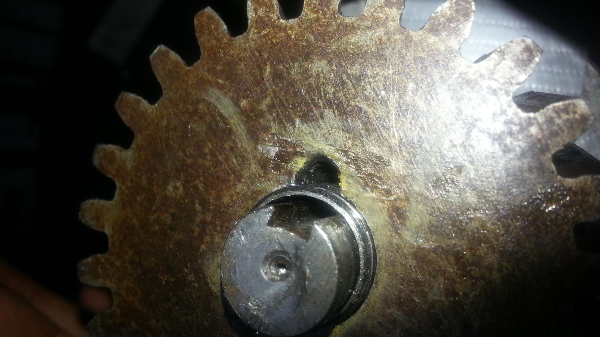

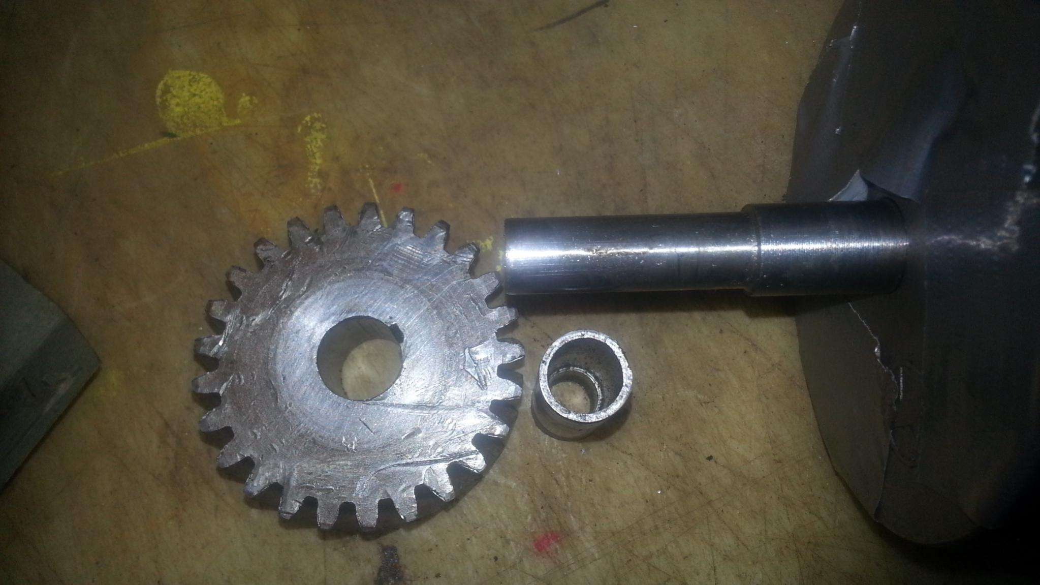

    Thanks Robert that information should come in handy in the future with the belts. With this project I am planning to use the old gear of the bandsaw on the treadmill motor. I pulled off the flywheel/ pulley and I turned an adaptor collar to make up for the difference in the motors shafts diameter. For the controller I am not sure how to get the new plastic to look right with the old cast iron. I have pulled the circuit boards from the original large plastic so that will help give me some options for where to mount the boards. I have been thinking about tucking most of the boards under the hollow stand of the saw. Then maybe soldering in my own switch to increase and decrease the speeds. I haven't gotten to far with that part yet though.
    Looking to add a treadmill motor to a JD Wallace vintage bandsaw.-20150823_165326.jpg
    Looking to add a treadmill motor to a JD Wallace vintage bandsaw.-20150821_040346.jpg
    That spacer is the first useful thing I have turned on my metal lathe. I am a rookie with a metal lathe my only instruction has been from utube videos.
    I found out that there is a taper to the inner diameter of the old gear. The first spacer I turned was loose on one end. The second spacer will need hammered on, and I have to cut a keyway and add set screws? There are three different shaft locking mechanisms between the new and the old. Any idea on which I should use or give preference to?
    I don't know what kind of stock you have laying around or if you also have a mill but since I don't have any key way broaches(yet!) and the more I look at that gear for the motor and your descriptions I'd do a semi major rework. The inner dia. Should not be tapered unless the shaft was tapered. Along with that crude key way and the suspect motor mess it all points to some serious jury riggin'. If you have the stock(and there's room) I'd bore the gear out large enough to make a new sleeve for the gear that has a shoulder on it and weld it to the gear(unless it's brass or something other than steel). That way you can bypass the key way fitments and go with two set screws. The way I do these kind of set screws that are expected to replace a key way is once I know right where they are supposed to be tighten them down so they leave a mark on the shaft and then drill the shaft 1/16" with the same size drill in those spots giving the set screws a recess to bite into. They can't slip that way, but it has to be done last because it's tough to relocate. More 2c poking around in the dark.
