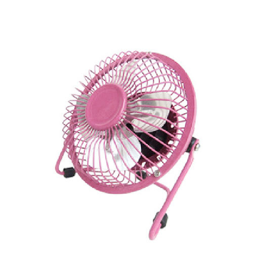

    for cooling I found a small rounded caged metal fan. it is about 4 inches around and looks sort of like the one below
    Looking to add a treadmill motor to a JD Wallace vintage bandsaw.-full-metal-usb360-rotating-small-fan-usb-mini-desk-fan-desktop-fan-450.jpg
    I am thinking about cutting a round hole on the underside of the old motors housing and fitting the above fan inside. then facing the fan so it blows cool air in. or maybe it would be better to have it pull air out?

    The treadmill motors I have, have fans on both ends that slip onto the shaft. I have more than enough shaft on either end to have the gear on one end and maybe enough to stick out of the old housing on the other end to mount the little fan to blow through the casting. Of course you'd need to do like you talked about to hole saw a hole or two in the side of the old case so the air could flow. BTW lots of these mill motors are totally sealed so there would be no worry about dust getting inside. The other bigger nicer motor has some perforations in the rear cover and vents at both end for air circulation. But when I think about the stuff my grinders pick up and blow through them and still keep on chuggin', makes you go hmmm?
