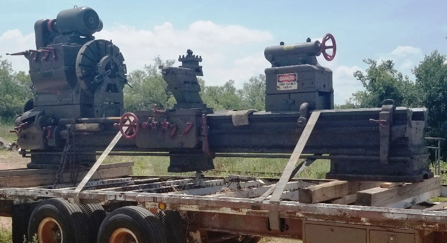

    Did you buy that lathe with the risers already in place, or is that your work?

    Did it come with a high stool?

    The risers were there when I got it. When Toolmaker 51 stopped by one day and got a real good look at it he said he thought they may have been a factory installed option judging by the way the gear train for the lead screw and feed gears was set up.

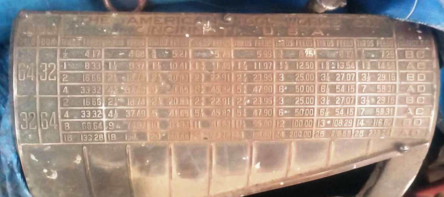

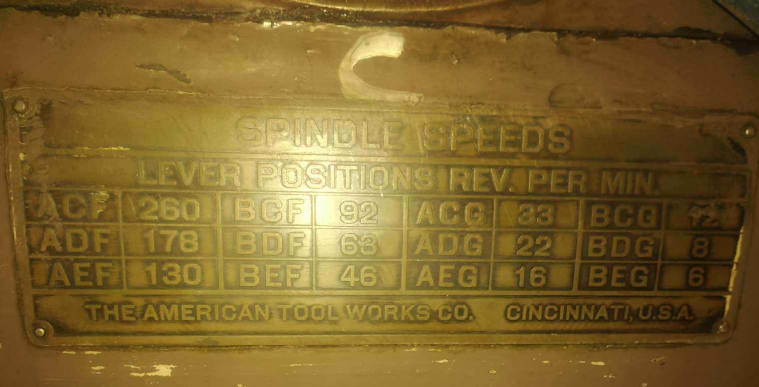

    I has at least as 56" swing and can swing a full 36 inches over the carriage 11 feet between the centers. It came with an 12" steady rest and had a tiny little 8" 3 jaw chuck clamped in the 36?" diameter 4 jaw its fastest RPM is something like 260 and a low of 6 RPM Another strange thing is it can thread from 1/2 thread per inch through 28 TPI with just about every common thread in between

    1/2 TPI. Wow. What’s the typical nominal OD for a 1/2 tpi thread?
  9. #7
    12,613
    2,677
    Thanked 11,103 Times in 5,386 Posts
    Quote Originally Posted by earz View Post
    I don't seem to find the API chart that used to show nominal ODs versus TPI so we might have to try this
    Acme threads might be a reasonable way to come up with an OD for a 1/2 TPI, 2 TPI are typical for ODs ranging from 3 to 5 inches this is where my 14th edition of the machinery's hand book stops. it does give the dimensions for a 1 TPI thread but no mention of typical diameters the Same with my 8th edition Marks standard handbook for Mechanical engineers. Other types of threads seem to bottom out around 3 TPI with some references to 2.5 TPI
    But looking at this another way think of a round grove that is used on larger winch drums called a Lebous grove. The 1/2 TPI would equate to a 2" wire rope and if we were to take half the minimum recommended pulley diameter to be 20 times the diameter of the wire rope as a starting point for a minimum bend radius however 30 to 40 times the diameter of the wire rope is more commonly used in practice for fatigue life, a 20" diameter cylinder would be the smallest the 1/2 TPI would ever be used for
