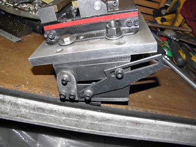

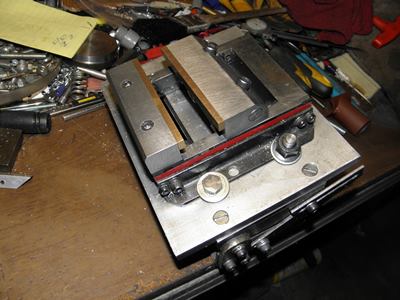

    Machinist Vice on Tilting Table.
    This Vise I made for my mill to hold material very tight. Made from CRS and brass jaws.
    I found the plans on the internet for both some where?
    Machinist Vise on Tilting Table-055.jpgMachinist Vise on Tilting Table-056.jpg

    Hey capainleeward, that's great work! Any chance you can post a few more pics of that vise? I want to build one and have been compiling ideas. TIA

    Well OK DIYer give me a few days and thanks Ken .

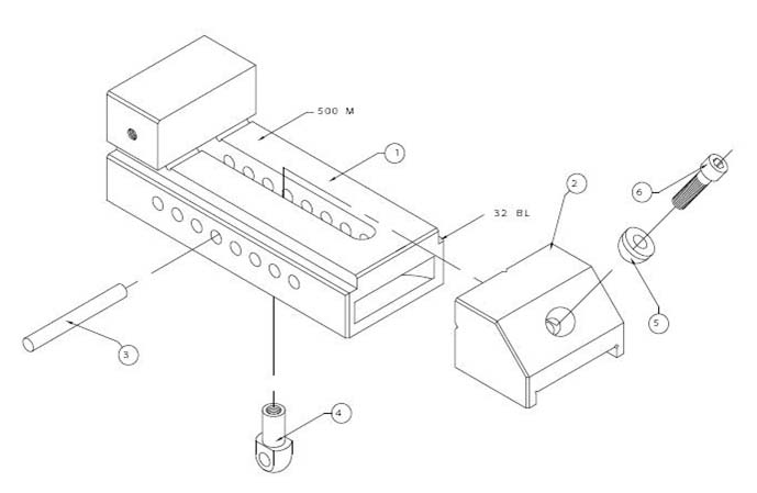

    DIYer Here is the plan for you. Machinist Vise on Tilting Table-machinist-vise.jpg

    Very well done. Thanks for the plan capainleeward.
    Al
