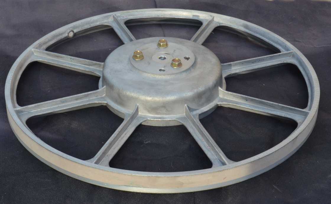

    I had a 25:1 gearbox which looked to be a good way to get the blade speeds suitable for metal cutting, the output of which was a flange with 3 studs. After offering up the rear wheel it became obvious that I only needed to make a spacer to fit the wheel onto the gearbox, no need to make a bearing carrier after all.

    Making bandsaw wheels-spacer-05.jpg Making bandsaw wheels-spacer-06.jpg Making bandsaw wheels-spacer-07.jpg
    Spacer fitted to gearbox and wheel.

    In the original post I forgot to add pix of the wheel mounted on the gearbox, so here are the missing pix.

    Alan, the gearbox is from a Segway. I had a pair of them which were in the scrap box because they each had damaged threads on the wheel mounting flange. They have a ratio of close to 25:1 which with a 1500 rpm motor and 16" wheels gives a blade speed about right for cutting metal. The other gearbox was used on my shock absorber dynamometer detailed in a previous post http://www.homemadetools.net/forum/s...amometer-56478
