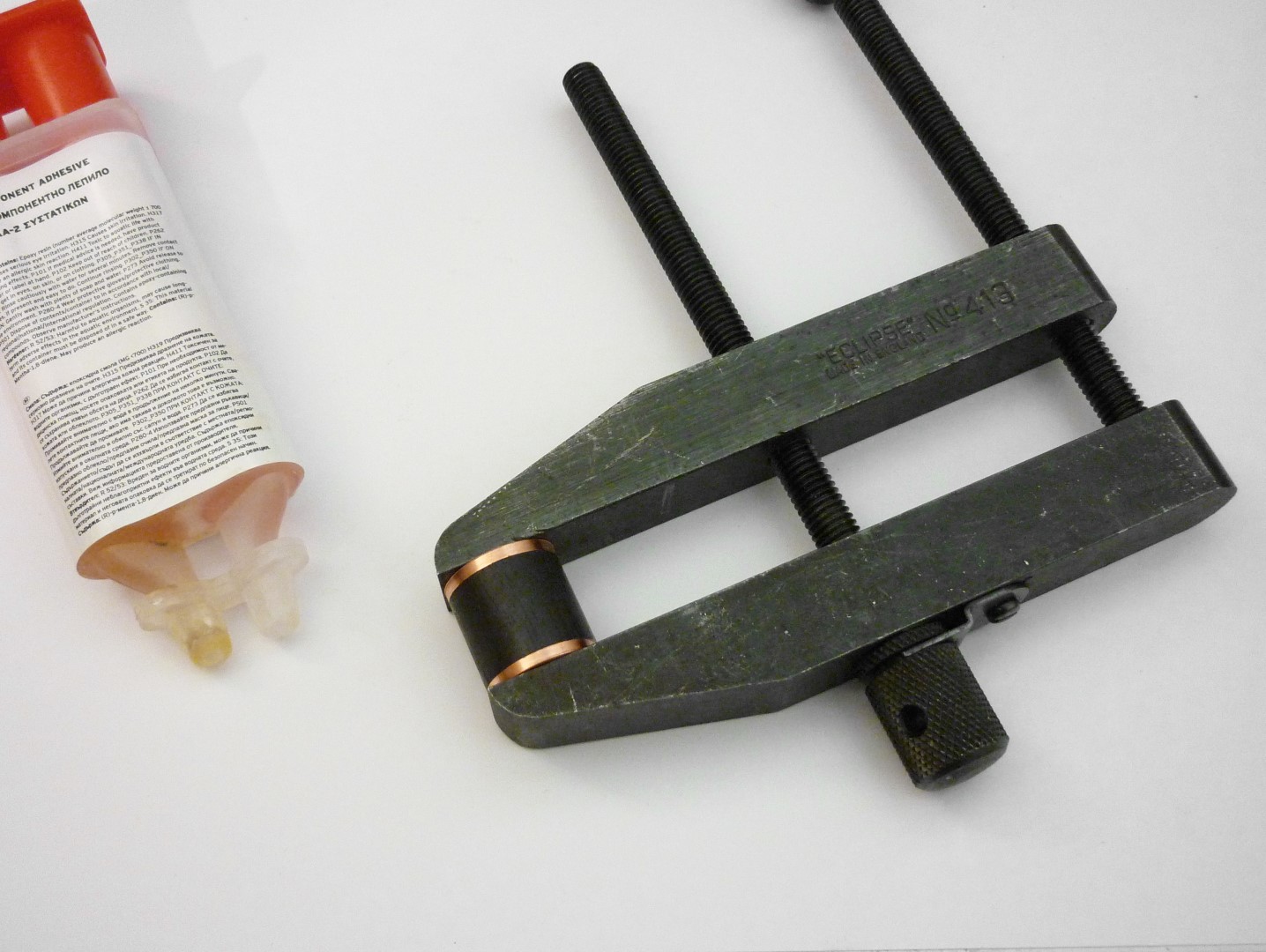

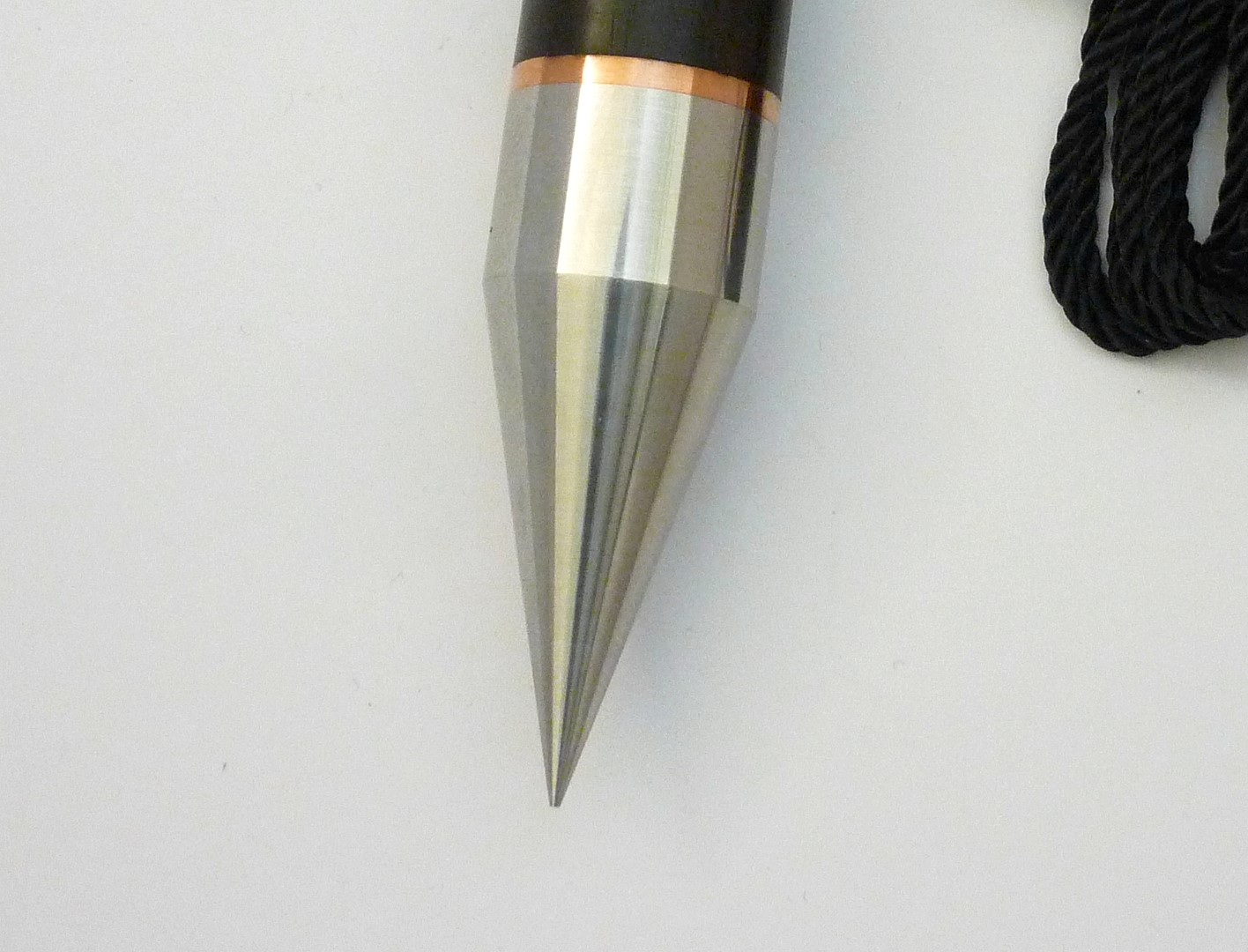

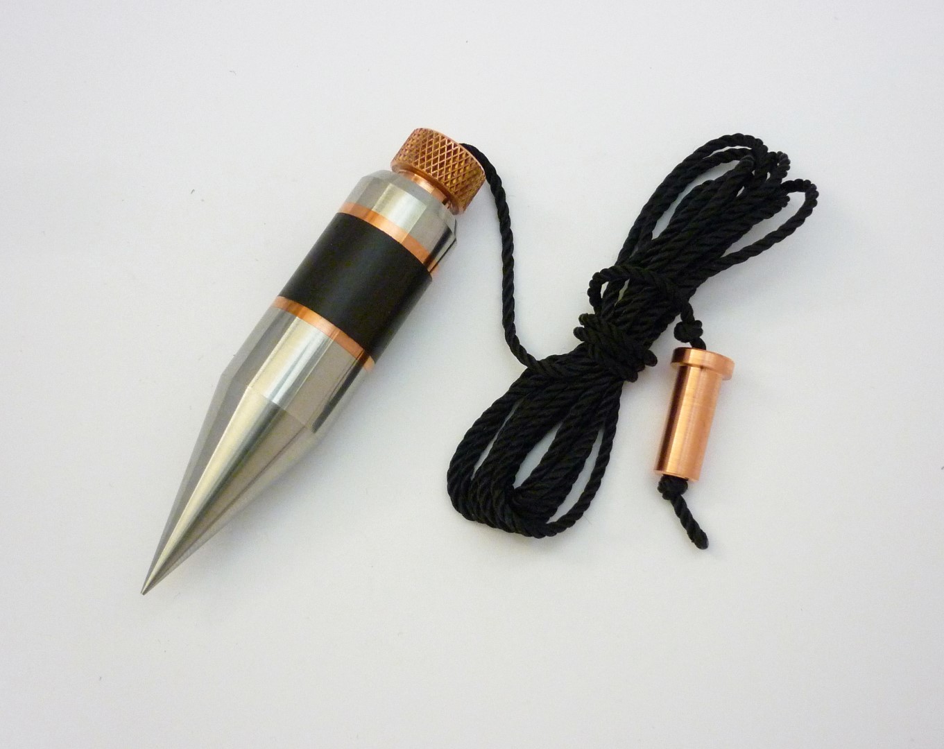

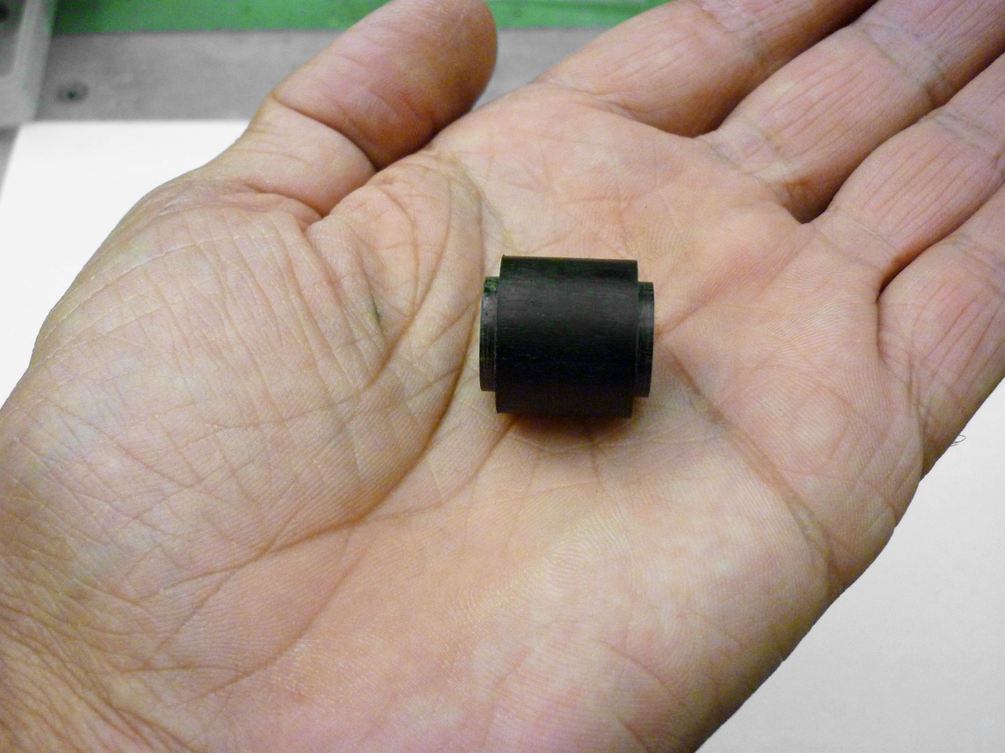

    Although that there are numerous digital tools for checking vertical alignment, a plumb bob still can be a very useful aid in the shop or home.
    I used 304 stainless steel, copper and African blackwood.
    Making a plumb bob-p1070341-large-.jpg Making a plumb bob-p1070363-large-.jpg Making a plumb bob-p1070364-large-.jpg Making a plumb bob-p1070365-large-.jpg Making a plumb bob-p1070564-large-.jpg Making a plumb bob-p1070563-large-.jpg

    Very nice work! Makes my grandad's beat up old brass number look anemic! I'm sure it is a joy to use. Cheers

    Dang you do good work. I don't have a tool box nice enough for that. It must live in a felt lined custom box. 👍

    One of the more awkward jobs to do accurately is marking the exact point over which a plumb bob hangs. Using the actual tip of the bob can damage it, especially if marking concrete, and is just, well, brutish.
    One approach I've seen to this problem is a bob shaped like a horizontal washer with four arrow points that point inward to the center of the annulus. After the bob comes to rest it's lowered carefully onto the stuff to be marked and a pencil mark made at the center of the four points. While it might work, it seems a bit gimmicky plus it wouldn't work well if the surface to be marked is angled.
    IMO, a much better solution would be a plumb bob with interchangeable points. Unscrew the normal, sharp steel point and fit a thin, ultra fine point Sharpie. Then simply lowering the stabilized bob onto the surface would leave a precise mark.
    Maybe I'm overthinking things - a machinist designing a push broom. Perhaps nobody needs to mark the sub-bob point that accurately.
    One approach I've seen to this problem is a bob shaped like a horizontal +washer with four arrow points that point inward to the center of the annulus. After the bob comes to rest it's lowered carefully onto the stuff to be marked and a pencil mark made at the center of the four points. While it might work, it seems a bit gimmicky plus it wouldn't work well if the surface to be marked is angled.
    You said it very wisely, Marv. It is an awkward job, especially when the marking height is greater than our body height. As for the interchangeable tip would be a good feature (commercially made ones have this feature).
