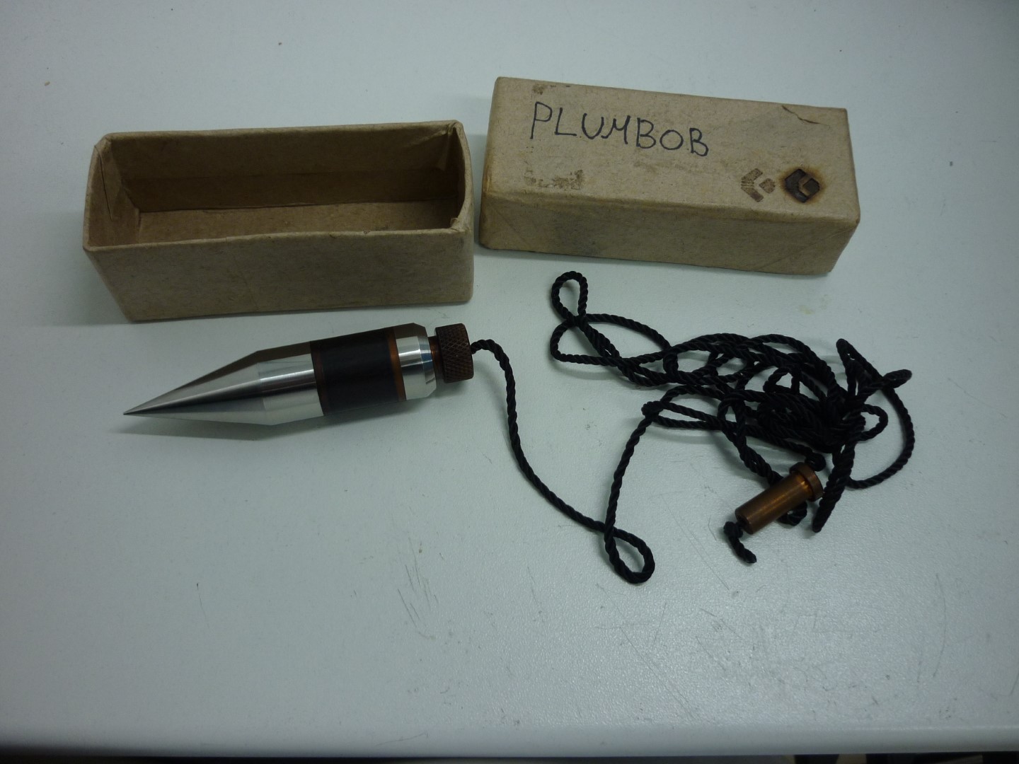

    Thank you Nick, I am happy that you like it! As for the velvet box I'll say...no it's better to show you

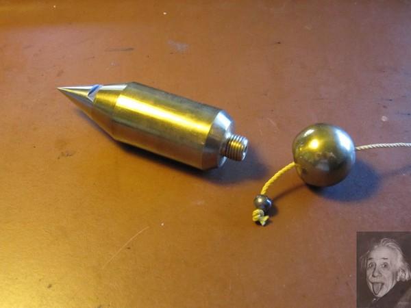

    I made mine with a removable steel tip. If it's damaged, it can be removed and remachined easily. Then I added a nuance...
    I wanted to be sure that the line supporting the bob couldn't influence the way it hangs so the line is tied to a pierced ball that rides in a conical depression inside the spherical end cap. Thus the bob is always free to hang perfectly vertical. In retrospect, given the weight of the final form, this feature is probably unnecessary but I always like to add something special to my designs.

    That's a very nice bob, Marv! I really like the added features, the removable tip and the small ball inside the cap. You've make me started thinking to do the same )

    Titivating plumb bob design is a rich field. Marking the point on the ground directly below the point of the bob is one area.
    Simply dropping the bob is not an attractive option; beyond the risk of damaging the point, there is no guarantee that it will strike directly below the point from which it is suspended.
    One possibility is a circular metal plate mounted right behind the bob point in such a way that when the point hovers over the ground the plate is parallel to the ground and about 12 mm away. The plate has four small holes located orthogonally on a large circle. When paint is sprayed through these holes, four spots on the ground are defined. After the bob is removed, connecting these spots with intersecting lines will exactly define the sub-bob point. Alternatively, a light shined through the holes will permit the ground points to be marked one at a time by hand.
    The ancients used plumb bobs as gravity references in levels and inclinometers. One style of inclinometer stuck into a cannon barrel was used to set elevation as late as the American Civil War.
