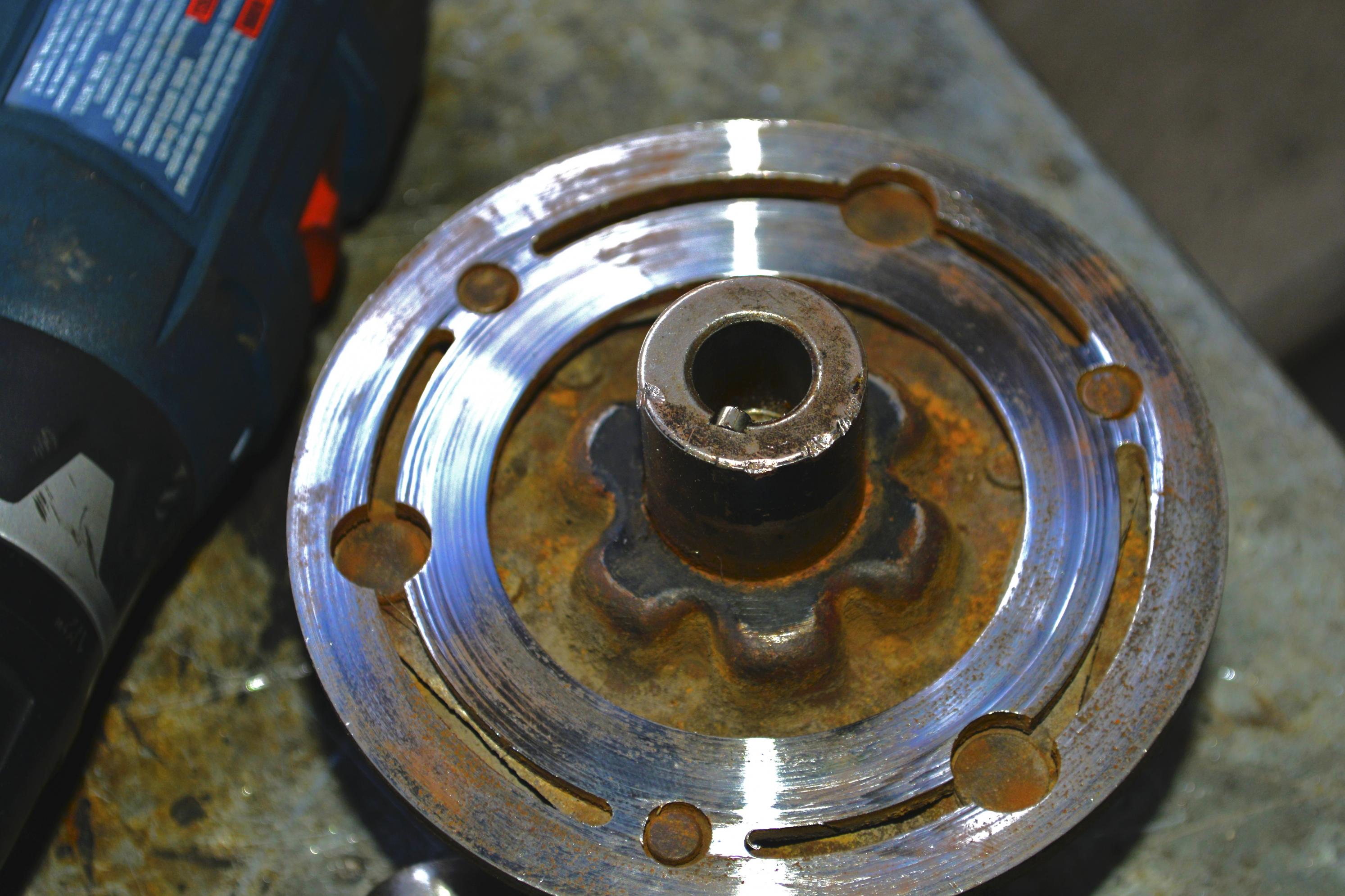

DSC5739 copy Both clutch plates had rust pits and bumps which made it "creep" a little under no-load so put them in the lathe and took just enough off to remove the scale and bumps and not affect the clutch plate-to-clutch plate clearance in the disengaged mod.
